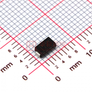

    SMAZ30-13-F - 1.0W SURFACE MOUNT ZENER DIODE - Diodes Incorporated
SMAZ30-13-F 数据手册
SPICE MODELS: SMAZ5V1 SMAZ5V6 SMAZ6V2 SMAZ6V8 SMAZ7V5 SMAZ8V2 SMAZ9V1 SMAZ10 SMAZ12 SMAZ15 SMAZ16 SMAZ18 SMAZ20 SMAZ24 SMAZ27 SMAZ30 SMAZ33 SMAZ36 SMAZ39 SMAZ5V1 - SMAZ39 1.0W SURFACE MOUNT ZENER DIODE Features · · · · · 1.0W Power Dissipation Ideally Suited for Automatic Assembly 5.1V - 39V Nominal Zener Voltage Range Standard VZ Tolerance is ± 5% Lead Free Finish/RoHS Compliant (Note 2) B Dim A B C D SMA Min 2.29 4.00 1.27 0.15 4.80 0.10 0.76 2.01 Max 2.92 4.60 1.63 0.31 5.59 0.20 1.52 2.62 A C Mechanical Data · · · · · · · · Case: SMA Case Material: Molded Plastic. UL Flammability Classification Rating 94V-0 Moisture Sensitivity: Level 1 per J-STD-020C Terminals: Lead Free Plating (Matte Tin Finish). Solderable per MIL-STD-202, Method 208 Marking: Marking & Date Code (See Page 2) Ordering Information: See Page 2 Polarity: Cathode Notch or Cathode Band Weight: 0.064 grams (approximate) D J E G H H G E J All Dimensions in mm Maximum Ratings @TA = 25°C unless otherwise specified Characteristic Zener Current (see Table page 2) Forward Voltage Power Dissipation Derate Above 50°C (Note 1) @IF = 200mA @TA = 50°C Symbol IZM VF Pd RqJT RqJA Tj, TSTG Value Pd / VZ 1.2 1.0 8.0 30 125 -65 to +150 Unit mA V W mW/°C °C/W °C/W °C Typical Thermal Resistance - Junction to Terminal (Note 1) Typical Thermal Resistance - Junction to Ambient (Note 1) Operating and Storage Temperature Range Notes: 1. Device mounted on FR-4 PCB, 1 inch x 0.85 inch x 0.062 inch; pad layout as shown on Diodes Inc. suggested pad layout document AP02001, which can be found on our website at http://www.diodes.com/datasheets/ap02001.pdf. 2. RoHS revision 13.2.2003. Glass and High Temperature Solder Exemptions Applied, see EU Directive Annex Notes 5 and 7. DS18015 Rev. 14 - 2 1 of 4 www.diodes.com SMAZ5V1 - SMAZ39 ã Diodes Incorporated Electrical Characteristics Type Number (Note 4) SMAZ5V1 SMAZ5V6 SMAZ6V2 SMAZ6V8 SMAZ7V5 SMAZ8V2 SMAZ9V1 SMAZ10 SMAZ12 SMAZ15 SMAZ16 SMAZ18 SMAZ20 SMAZ22 SMAZ24 SMAZ27 SMAZ30 SMAZ33 SMAZ36 SMAZ39 Marking Code ZHK ZHL ZHN ZHO ZHQ ZHR ZHT ZHU ZHW ZHZ ZJA ZJF ZJG ZJK ZJL ZJN ZJQ ZJR ZJS ZJT 5.1 5.60 6.20 6.80 7.50 8.20 9.10 10.00 12.00 15.00 16.00 18.00 20.00 22.00 24.00 27.00 30.00 33.00 36.00 39.00 @TA = 25°C unless otherwise noted Test Current IZT Max (V) 5.40 5.88 6.51 7.14 7.88 8.61 9.56 10.50 12.60 15.75 16.80 18.90 21.00 23.10 25.20 28.35 31.50 34.65 37.80 40.95 mA 100 100 100 100 100 100 50 50 50 50 25 25 25 25 25 25 25 25 10 10 Maximum Zener Impedance ZZT @ IZT W 5.0 2.0 2.0 2.0 2.0 2.0 4.0 4.0 7.0 10 15 15 15 15 15 15 15 15 40 40 W 500 250 200 200 450 200 200 200 150 150 150 150 180 180 180 200 250 300 350 450 ZZK @ Zener Voltage Range (Note 3) VZ @ IZT Nom (V) Min (V) 4.84 5.32 5.89 6.46 7.13 7.79 8.65 9.50 11.40 14.25 15.20 17.10 19.00 20.90 22.80 25.65 28.50 31.35 34.20 37.05 Maximum Reverse Current IR @ V R µA 2.5 5.0 5.0 5.0 5.0 5.0 5.0 1.0 1.0 1.0 0.5 0.5 0.5 0.5 0.5 0.5 0.5 0.5 0.5 0.5 V 1.0 2.0 3.0 4.0 5.0 6.0 7.0 7.6 9.1 11.4 12.2 13.7 15.2 16.7 18.2 20.5 22.8 25.1 27.4 29.6 IZK mA 1.0 2.0 2.0 1.0 1.0 1.0 1.0 1.0 1.0 1.0 1.0 1.0 1.0 1.0 1.0 1.0 1.0 1.0 1.0 1.0 IZM Max (Note 1) mA 196 179 161 147 133 122 110 100 83 67 63 56 50 45 42 37 33 30 28 26 Ordering Information (Note 4) Device* SMAZx-13-F Notes: Packaging SMA Shipping 5000/Tape & Reel 1. Device mounted on FR-4 PCB, 1 inch x 0.85 inch x 0.062 inch; pad layout as shown on Diodes Inc. suggested pad layout document AP02001, which can be found on our website at http://www.diodes.com/datasheets/ap02001.pdf. 3. Short duration test pulse used to minimize self-heating effect. 4. For Packaging Details, go to our website at http://www.diodes.com/datasheets/ap02007.pdf. *x = Device Voltage, e.g., SMAZ5V1-13-F. Marking Information YWW XXX XXX = Product type marking code, ex. ZHK = SMAZ5V1 = Manufacturers’ code marking YWW = Date code marking Y = Last digit of year ex: 2 for 2002 WW = Week code 01 to 52 DS18015 Rev. 14 - 2 2 of 4 www.diodes.com SMAZ5V1 - SMAZ39 1.2 1000 SMAZ5V6 f = 1MHz 1.0 CT, TOTAL CAPACITANCE (pF) Ppk PEAK POWER (W) SMAZ12 0.8 100 SMAZ27 0.6 0.4 10 0.2 0 0 50 100 150 175 TA, AMBIENT TEMPERATURE ° C Fig. 1 Power Dissipation vs Ambient Temperature 20 0 1 10 100 200 VR, REVERSE VOLTAGE (V) Fig. 2 Total Capacitance vs Reverse Voltage 2000 1000 Tj = 25° C IFM, PEAK FORWARD CURRENT (A) 10 Tj = 125° C 100 10 1 1 0.1 0.01 0.1 0 0.5 1.0 1.5 2.0 2.5 0.001 1 10 100 500 VZT, ZENER REGULATION VOLTAGE (V) Fig. 4 Leakage Current vs Regulation Voltage VFM, PEAK FORWARD VOLTAGE (V) Fig. 3 Peak Forward Current vs Peak Forward Voltage 1000 IZT = 5.0mA 100 IZT = 10mA 10 IZT = 20mA 1 IZT = 100mA 0.1 1 10 100 500 VZT, ZENER REGULATION VOLTAGE (V) Fig. 5 Differential Resistance vs Regulation Voltage DS18015 Rev. 14 - 2 3 of 4 www.diodes.com SMAZ5V1 - SMAZ39 IMPORTANT NOTICE Diodes Incorporated and its subsidiaries reserve the right to make modifications, enhancements, improvements, corrections or other changes without further notice to any product herein. Diodes Incorporated does not assume any liability arising out of the application or use of any product described herein; neither does it convey any license under its patent rights, nor the rights of others. The user of products in such applications shall assume all risks of such use and will agree to hold Diodes Incorporated and all the companies whose products are represented on our website, harmless against all damages. LIFE SUPPORT Diodes Incorporated products are not authorized for use as critical components in life support devices or systems without the expressed written approval of the President of Diodes Incorporated. DS18015 Rev. 14 - 2 4 of 4 www.diodes.com SMAZ5V1 - SMAZ39
