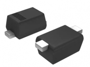

T3V3S5 / T5V0S5 / T6V0S5 / T12S5 UNIDIRECTIONAL SURFACE MOUNT TVS Please click here to visit our online spice models database. Features • • • • • • Ideally Suited for ESD Protection Ultra-Small Surface Mount Package Excellent Clamping Capability, Fast Response Time Low Capacitance Lead Free By Design/RoHS Compliant (Note 1) "Green" Device (Note 2) Mechanical Data • • • • • • • • • Case: SOD-523 Case Material: Molded Plastic, "Green" Molding Compound. UL Flammability Classification Rating 94V-0 Moisture Sensitivity: Level 1 per J-STD-020D Terminal Connections: Cathode Band Terminals: Solderable per MIL-STD-202, Method 208 Terminals: Finish - Matte Tin annealed over Alloy 42 leadframe. Solderable per MIL-STD-202, Method 208 Marking Information: See Page 2 Ordering Information: See Page 2 Weight: 0.001 grams (approximate) Top View Maximum Ratings Forward Voltage ESD Rating @TA = 25°C unless otherwise specified Symbol VF ESD Value 0.9 8 400 30 30 Unit V kV V kV kV Characteristic @ IF = 10mA Human Body Model Machine Model IEC61000-4-2 Air Discharge IEC61000-4-2 Contact Discharge Thermal Characteristics Characteristic Power Dissipation (Note 3) (See figure 2) Thermal Resistance, Junction to Ambient Air (Note 3) Operating and Storage Temperature Range Symbol PD RθJA TJ, TSTG Value 150 833 -65 to +150 Unit mW °C/W °C Electrical Characteristics Part Number Min. Reverse Breakdown Test Standoff Voltage Current Voltage VBR @ IT VRWM (V) Min (V) IT (mA) @TA = 25°C unless otherwise specified Max. Reverse Leakage @ VRWM (Note 4) IR (μA) Typ. Clamping Voltage @ IPP =5A (tp = 8 x 20 μs) (See figure 1) VC (V) Max. Clamping Voltage Vc @ IPP (tp = 8 x 20 μs) (See Figure 1) VC (V) IPP (A) Max. Clamping Voltage Vc @ IPP (tp = 8 x 20 μs) (See Figure 1) VC (V) IPP (A) Typical Total Peak Power Capacitance Marking Dissipation VR = 0V Code (See Figure 1) f = 1MHz PPK (W) T3V3S5 T5V0S5 T6V0S5 T12S5 Notes: 1. 2. 3. 4. 3.3 5.0 6.0 12 5.0 6.2 6.8 14.1 1.0 1.0 1.0 1.0 1 0.05 0.05 0.01 8.4 15 11.2 19.7 14.1 22 17 25 11.2 9.4 8.8 9.6 16 27 23 28 16 15 15 12 220 260 260 300 CT (pF) 85 60 90 60 ED EJ EL ES No purposefully added lead. Diodes Inc.'s "Green" policy can be found on our website at http://www.diodes.com/products/lead_free/index.php. Part mounted on FR-4 board with recommended pad layout, which can be found on our website at http://www.diodes.com/datasheets/ap02001.pdf. Short duration pulse test used to minimize self-heating effect. T3V3S5 / T5V0S5 / T6V0S5 / T12S5 Document number: DS31112 Rev. 8 - 2 1 of 3 www.diodes.com July 2009 © Diodes Incorporated T3V3S5 / T5V0S5 / T6V0S5 / T12S5 0.3 Note 3 IPP, PEAK PULSE CURRENT (%Ipp) PD, POWER DISSIPATION (W) 0.2 0.1 0 0 25 100 50 75 125 TA, AMBIENT TEMPERATURE (°C) Fig. 2 Power Derating Curve 150 Ordering Information (Note 5) Case SOD-523 Packaging 3000/Tape & Reel Part Number (Type Number)-7* (Note 6) * Notes: Add “-7” to the appropriate type number in Electrical Characteristics Table on page 1 example: 2.5V TVS = T2V5S5-7. 5. For packaging details, go to our website at http://www.diodes.com/datasheets/ap02007.pdf. 6. Dispensed in every other cavity of the tape. Marking Information xx xx = Product Type Marking Code (See Electrical Characteristics Table) Package Outline Dimensions L C H SOD-523 Dim Min Max A 0.25 0.35 B 0.70 0.90 C 1.50 1.70 H 1.10 1.30 K 0.55 0.65 L 0.10 0.30 M 0.10 0.12 All Dimensions in mm A B K M T3V3S5 / T5V0S5 / T6V0S5 / T12S5 Document number: DS31112 Rev. 8 - 2 2 of 3 www.diodes.com July 2009 © Diodes Incorporated T3V3S5 / T5V0S5 / T6V0S5 / T12S5 Suggested Pad Layout C X Y G Z Dimensions Value (in mm) Z 2.3 G 1.1 X 0.8 Y 0.6 C 1.7 IMPORTANT NOTICE DIODES INCORPORATED MAKES NO WARRANTY OF ANY KIND, EXPRESS OR IMPLIED, WITH REGARDS TO THIS DOCUMENT, INCLUDING, BUT NOT LIMITED TO, THE IMPLIED WARRANTIES OF MERCHANTABILITY AND FITNESS FOR A PARTICULAR PURPOSE (AND THEIR EQUIVALENTS UNDER THE LAWS OF ANY JURISDICTION). Diodes Incorporated and its subsidiaries reserve the right to make modifications, enhancements, improvements, corrections or other changes without further notice to this document and any product described herein. Diodes Incorporated does not assume any liability arising out of the application or use of this document or any product described herein; neither does Diodes Incorporated convey any license under its patent or trademark rights, nor the rights of others. Any Customer or user of this document or products described herein in such applications shall assume all risks of such use and will agree to hold Diodes Incorporated and all the companies whose products are represented on Diodes Incorporated website, harmless against all damages. Diodes Incorporated does not warrant or accept any liability whatsoever in respect of any products purchased through unauthorized sales channel. Should Customers purchase or use Diodes Incorporated products for any unintended or unauthorized application, Customers shall indemnify and hold Diodes Incorporated and its representatives harmless against all claims, damages, expenses, and attorney fees arising out of, directly or indirectly, any claim of personal injury or death associated with such unintended or unauthorized application. Products described herein may be covered by one or more United States, international or foreign patents pending. Product names and markings noted herein may also be covered by one or more United States, international or foreign trademarks. LIFE SUPPORT Diodes Incorporated products are specifically not authorized for use as critical components in life support devices or systems without the express written approval of the Chief Executive Officer of Diodes Incorporated. As used herein: A. Life support devices or systems are devices or systems which: 1. are intended to implant into the body, or 2. support or sustain life and whose failure to perform when properly used in accordance with instructions for use provided in the labeling can be reasonably expected to result in significant injury to the user. B. A critical component is any component in a life support device or system whose failure to perform can be reasonably expected to cause the failure of the life support device or to affect its safety or effectiveness. Customers represent that they have all necessary expertise in the safety and regulatory ramifications of their life support devices or systems, and acknowledge and agree that they are solely responsible for all legal, regulatory and safety-related requirements concerning their products and any use of Diodes Incorporated products in such safety-critical, life support devices or systems, notwithstanding any devices- or systems-related information or support that may be provided by Diodes Incorporated. Further, Customers must fully indemnify Diodes Incorporated and its representatives against any damages arising out of the use of Diodes Incorporated products in such safety-critical, life support devices or systems. Copyright © 2009, Diodes Incorporated www.diodes.com T3V3S5 / T5V0S5 / T6V0S5 / T12S5 Document number: DS31112 Rev. 8 - 2 3 of 3 www.diodes.com July 2009 © Diodes Incorporated
