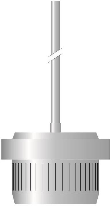

    DIODE STD D12.77X6.6W 600V 25A
KYW25A6 数据手册
KYW25A05 ... KYW25A6, KYW25K05 ... KYW25K6 KYW25A05 ... KYW25A6, KYW25K05 ... KYW25K6 Silicon-Press-Fit-Diodes – High Temperature Diodes Silizium-Einpress-Dioden – Hochtemperatur-Dioden Version 2006-04-20 Ø 16 ±0.5 Nominal Current Nennstrom 25 max. 25 A 50 ... 600 V Repetitive peak reverse voltage Periodische Spitzensperrspannung Metal press-fit case with glass seal Metall-Einpressgehäuse mit Glas-Durchführung Weight approx. Gewicht ca. Compound has classification UL94V-0 Vergussmasse nach UL94V-0 klassifiziert Standard packaging: bulk Standard Lieferform: lose im Karton 1.3 10 g 6.6 ±0.5 ±0.5 Dimensions - Maße [mm] Maximum ratings Type / Typ Wire to / Draht an Anode KYW25A05 KYW25A1 KYW25A2 KYW25A3 KYW25A4 KYW25A6 Cathode KYW25K05 KYW25K1 KYW25K2 KYW25K3 KYW25K4 KYW25K6 Repetive peak reverse voltage Periodische Spitzensperrspannung VRRM [V] 50 100 200 300 400 600 TC = 100°C f > 15 Hz TA = 25°C TA = 25°C IFAV IFRM IFSM i2t Tj TS 1.5 Ø 12.77±0.04 4 Grenzwerte Surge peak reverse voltage Stoßspitzensperrspannung VRSM [V] 60 120 240 360 480 700 25 A 90 A 1) 270/300 A 375 A2s -50...+175°C -50...+175°C Max. average forward rectified current, R-load Dauergrenzstrom in Einwegschaltung mit R-Last Repetitive peak forward current Periodischer Spitzenstrom Peak forward surge current, 50/60 Hz half sine-wave Stoßstrom für eine 50/60 Hz Sinus-Halbwelle Rating for fusing, t < 10 ms Grenzlastintegral, t < 10 ms Operating junction temperature – Sperrschichttemperatur Storage temperature – Lagerungstemperatur 1 Max. case temperature TC = 150°C – Max. Gehäusetemperatur TC = 150°C http://www.diotec.com/ © Diotec Semiconductor AG 1 KYW25A05 ... KYW25A6, KYW25K05 ... KYW25K6 Characteristics Forward Voltage Durchlass-Spannung Leakage Current Sperrstrom Thermal Resistance Junction – Case Wärmewiderstand Sperrschicht – Gehäuse Tj = 25°C IF = 25 A VF Kennwerte < 1.1 V Tj = 25°C VR = VRRM IR RthC < 100 µA < 1 K/W 120 [%] 100 103 [A] 102 Tj = 125°C 80 10 Tj = 25°C 60 40 1 20 IFAV 0 0 TC 50 100 150 [°C] Rated forward current versus case temperature Zul. Richtstrom in Abh. von der Gehäusetemp. IF 10-1 270a-(25a-1,1v) 0.4 VF 0.8 1.0 1.2 1.4 [V] 1.8 Forward characteristics (typical values) Durchlasskennlinien (typische Werte) 10 3 [A] 10 2 îF 10 1 10 10 [n] 10 Peak forward surge current versus number of cycles at 50 Hz Durchlass-Spitzenstrom in Abh. von der Zahl der Halbwellen bei 50 Hz 2 3 © Diotec Semiconductor AG http://www.diotec.com/ 2
