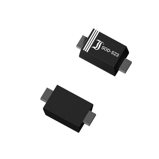

MM5Z2V4 ... MM5Z47
MM5Z2V4 ... MM5Z47
Ptot1 = 300 mW
VZ = 2.4V ... 47V
Tjmax = 150°C
SMD Planar Zener Diodes
SMD Planar Zener-Dioden
Version 2021-06-04

SOD-523
