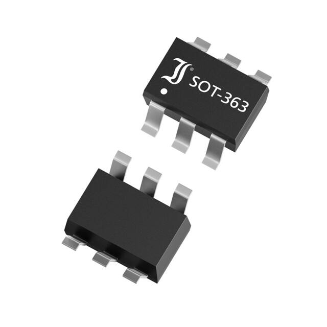

SOT-363
Mechanical Data 1)
Mechanische Daten 1)
Taped and reeled
3000 / 7“
Weight approx.
Marking Code
K72
