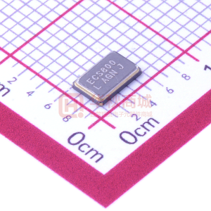

Low Voltage HCMOS 7 x 5 mm Footprint Low current consumption Pb Free/RoHS Compliant ECS-5718/5725 SMD CLOCK OSCILLATOR ECS-5718 (1.8V) and ECS-5725 (2.5V) miniature SMD oscillators. Ideal for today's high density applications. OPERATING CONDITIONS / ELECTRICAL CHARACTERISTICS ECS-5718 (+1.8V) ECS-5725 (+2.5V) PARAMETERS Frequency Range Operating Temperature Storage Temperature Supply Voltage Frequency Stability * CONDITIONS MIN 1.000 0 -40 -55 +1.62 TYP MAX 125.0 +70 +85 +125 +1.98 ± 100 ± 50 ± 25 10 12 15 25 40/60 45/55 5 10% VDD MIN 1.000 0 -40 -55 +2.25 TYP MAX 125.0 +70 +85 +125 +2.75 ± 100 ± 50 ± 25 12 15 20 30 40/60 45/55 6 10% VDD UNITS MHz °C °C °C VDC ppm ppm ppm mA mA mA mA % % ns VDC VDC pF ns ms ppm Standard Extended (N Option) VDD Option A Option B Option C 1.000 to 23.999 MHz 24.000 to 49.999 MHz 50.000 to 69.999 MHz 70.000 to 125.000 MHz @ 50% VDD level @ 50% VDD level (T Option) 10% VDD to 90% level VOL VOH HCMOS +1.8 +2.5 Input Current Output Symmetry Rise and Fall Times "0" level "1" level Output Load Disable delay time Startup/Enable time Aging 90% VDD 90% VDD 30 150 10 ±5 30 150 10 ±5 * Note: Inclusive of 25°C tolerance, operating temperature,input voltage change, load change, shock and vibration. DIMENSIONS (mm) Tri-State Control Voltage Pad 1 Open 1 Level 0 Level Pad 3 Oscillation Oscillation No Oscillation Pin Connections Pin #1 Pin #2 Pin #3 Pin #4 Tri-State Ground Output VDD Figure 1) Top, Side and Bottom views Figure 2) Suggested Land Pattern PART NUMBERING GUIDE: Example ECS-5725-200-BN ECS Series 5718 = +1.8V 5725 = +2.5V Frequency Abbreviation 200 = 20.000 MHz See Frequency Abbreviations. Stability Temperature Blank = 0 ~ +70°C M = -20 ~ +70°C N = -40 ~ +85°C Symmetry Blank = 40/60 (Std) T = 45/55 A = ± 100 ppm B = ± 50 ppm C = ± 25 ppm 1105 South Ridgeview Road Olathe, KS 66062 Phone: 913.782.7787 Fax: 913.782.6991 www.ecsxtal.com
