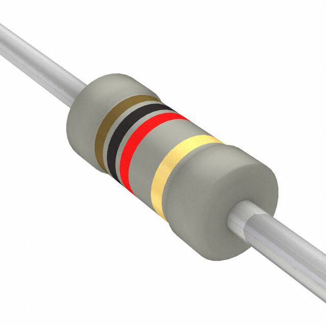

    固定电感器 Axial 1mH ±5% 130mA 14Ω 1.6MHz 50@252KHz
B78108S1105J000 数据手册
Inductors RF chokes, BC series Series/Type: Date: B78108S, B78148S March 2008 7f…fÁRspp… 7f…fÁRspp… © EPCOS AG 2008. Reproduction, publication and dissemination of this publication, enclosures hereto and the information contained therein without EPCOS’ prior express consent is prohibited. RF chokes BC series, 4 s 9.2 (mm) BC chokes (Bobbin Core) Rated inductance 1 NH to 4700 NH Rated current 55 mA to 1200 mA Construction ■ Ferrite drum core ■ Winding: enamel copper wire ■ Flame-retardant lacquer coating B78108S, B78148S B78108S Features ■ ■ ■ ■ ■ Wide inductance range Suitable for general-purpose application Special versions available Suitable for wave soldering RoHS-compatible B78148S Applications ■ RF blocking and filtering ■ Decoupling and interference suppression ■ For antenna systems, automotive electronics, energy-saving lamps, entertainment electronics Terminals ■ ■ ■ ■ Central axial leads (B78108S) Radially bent to 5 mm lead spacing (B78148S) Base material Cu Hot-dipped with pure tin Marking Inductance indicated by color bands to IEC 60062 Delivery mode and packing units ■ Taped, Ammo and reel packing ■ Packing units: Ammo (pcs./pack.) Axial Radial 2500 2500 Reel (pcs./reel) 5000 2000 Please read C autions and warnings and Important notes at the end of this document. 2 03/08 RF chokes BC series, 4 s 9.2 (mm) Dimensional drawings B78108S (axial leads, taped) 65±1 53±2 B78108S, B78148S Dimensions in mm ø0.8 max. ø4 max. 9.2 max. (IEC 60294) 6±0.5 3.5 min. 11.5 max. lacquered 5±0.25 5±0.25 IND0429-B-E Minimum lead spacing 12.5 mm B78148S (central radial leads, taped) ø4 max. 1.3 max. 2 max. 2 max. 0.8 max. 0.5 max. 9.2 max. (IEC 60294) 11.5 max. lacquered 1.3 max. insulated 30.5 max. _ 0.5 9 +0.75 16±0.5 Thickness of tape 0.7±0.2 IND0629-B _ 0.5 18 +1 6 min. ø4±0.2 3.8±0.7 12.7±0.3 _ 0.1 5 +0.6 IND0633-N-E Packing ø30.5±0.15 ø82+1 ø90 30 ø360 _ 1 30 H n w Label 30 IND0452-V-E L W IND0631-B-E n (mm): Axial 72 +1, radial 42 +1 w (mm): Axial 84 max., radial 54 max. Please read C autions and warnings and Important notes at the end of this document. L × W × H (max. mm): Axial: 265 × 75 × 125, radial: 340 × 50 × 210 3 03/08 RF chokes BC series, 4 s 9.2 (mm) Technical data and measuring conditions Rated inductance LR B78108S, B78148S Measured with LCR meter Agilent 4284A or impedance analyzer Agilent 4294A = 1 MHz Measuring frequency: LR ≤ 10 μ H 10 μH < LR ≤ 4700 μH = 100 kHz Measuring current: ≤ 1 mA Measuring temperature: 20 °C Measured with precision impedance analyzer Agilent 4294A, 20 °C 40 °C Maximum permissible DC current at rated temperature ≤ 10% (referred to initial value) at IR, 20 °C Measured at 20 °C Sn95.5Ag3.8Cu0.7: (245 ±5) °C, (3 ±0.3) s Wetting of soldering area ≥ 90% (to IEC 60068-2-20, test Ta) (260 ±5) °C, 10 s (to IEC 60068-2-20, test Tb) ≥ 20 N (to IEC 60068-2-21, test Ua) 55/125/56 (to IEC 60068-1) Mounted: –55 °C … +125 °C Packaged: –25 °C … +40 °C, ≤ 75% RH Approx. 0.38 g Q factor Qmin Rated temperature TR Rated current IR Inductance decrease ΔL/L0 DC resistance Rmax Solderability (lead-free) Resonance frequency fres,min Measured with Agilent 4294A or 8753ES, 20 °C Resistance to soldering heat Tensile strength of leads Climatic category Storage conditions Weight Mounting information When bending the leads, take care that the start-of-winding areas at the face ends (protected by glue and lacquer) are not subjected to any mechanical stress. Please read C autions and warnings and Important notes at the end of this document. 4 03/08 RF chokes BC series, 4 s 9.2 (mm) Characteristics and ordering codes LR μH 1.0 1.2 1.5 1.8 2.2 2.7 3.3 3.9 4.7 5.6 6.8 8.2 10 12 15 18 22 27 33 39 ±10% ^ B78108S, B78148S Tolerance1) K Qmin 55 55 55 55 55 60 60 60 60 60 65 65 70 70 60 60 55 55 55 50 fQ MHz 7.96 7.96 7.96 7.96 7.96 7.96 7.96 7.96 7.96 7.96 7.96 7.96 2.52 2.52 2.52 2.52 2.52 2.52 2.52 2.52 IR mA 1200 1150 1100 1030 1000 940 900 850 820 780 670 690 680 650 610 580 560 530 500 470 Rmax Ω 0.16 0.18 0.20 0.22 0.25 0.26 0.29 0.31 0.34 0.38 0.51 0.48 0.49 0.55 0.60 0.67 0.74 0.83 0.92 1.02 fres, min MHz 205 185 165 155 140 125 115 105 95 85 75 50 35 30 20 17 13 10 9.0 8.0 Ordering code 2) (reel packing) 3) B781*8S1102K000 B781*8S1122K000 B781*8S1152K000 B781*8S1182K000 B781*8S1222K000 B781*8S1272K000 B781*8S1332K000 B781*8S1392K000 B781*8S1472K000 B781*8S1562K000 B781*8S1682K000 B781*8S1822K000 B781*8S1103K000 B781*8S1123K000 B781*8S1153K000 B781*8S1183K000 B781*8S1223K000 B781*8S1273K000 B781*8S1333K000 B781*8S1393K000 BC chokes with temperature range up to 140 °C on request. BC chokes up to 33 μH with higher resonance frequency on request. 1) Closer tolerances on request. 2) Replace the * b y code number »0« for axial taping or by »4« for radial taping. 3) For Ammo pack the last digit has to be a »9«. Example: B78108S1102K009 Please read C autions and warnings and Important notes at the end of this document. 5 03/08 RF chokes BC series, 4 s 9.2 (mm) Characteristics and ordering codes LR μH 47 56 68 82 100 120 150 180 220 270 330 390 470 560 680 820 1000 1200 1500 1800 2200 2700 3300 3900 4700 ±5% ^ B78108S, B78148S Tolerance1) J Qmin 45 40 40 35 70 70 70 70 70 70 70 70 70 60 55 50 50 50 50 50 40 40 40 40 35 fQ MHz 2.52 2.52 2.52 2.52 0.796 0.796 0.796 0.796 0.796 0.796 0.796 0.796 0.796 0.796 0.796 0.796 0.252 0.252 0.252 0.252 0.252 0.252 0.252 0.252 0.252 IR mA 450 430 410 390 370 300 280 270 250 200 190 180 170 160 150 140 130 115 100 95 80 75 62 59 55 Rmax Ω 1.10 1.23 1.35 1.54 1.70 2.40 2.80 3.00 3.30 5.70 6.40 7.00 7.90 8.80 10.0 12.0 14.0 17.5 23.0 26.0 34.7 40.0 59.5 66.0 78.0 fres, min MHz 7.5 7.0 6.5 6.0 5.0 4.5 4.2 3.9 3.7 2.8 2.7 2.4 2.2 2.0 1.9 1.6 1.6 1.3 1.25 1.2 1.1 1.0 0.9 0.8 0.7 Ordering code 2) (reel packing) 3) B781*8S1473J000 B781*8S1563J000 B781*8S1683J000 B781*8S1823J000 B781*8S1104J000 B781*8S1124J000 B781*8S1154J000 B781*8S1184J000 B781*8S1224J000 B781*8S1274J000 B781*8S1334J000 B781*8S1394J000 B781*8S1474J000 B781*8S1564J000 B781*8S1684J000 B781*8S1824J000 B781*8S1105J000 B781*8S1125J000 B781*8S1155J000 B781*8S1185J000 B781*8S1225J000 B781*8S1275J000 B781*8S1335J000 B781*8S1395J000 B781*8S1475J000 BC chokes with temperature range up to 140 °C on request. 1) Closer tolerances on request. 2) Replace the * b y code number »0« for axial taping or by »4« for radial taping. 3) For Ammo pack the last digit has to be a »9«. Example: B78108S1473J009 Please read C autions and warnings and Important notes at the end of this document. 6 03/08 RF chokes BC series, 4 s 9.2 (mm) Impedance |Z| versus frequency f measured with impedance analyzer Agilent 4294A or S-parameter network analyzer Agilent 8753ES, typical values at 20 °C 10 6 Ω | Z| 10 5 IND0122-K B78108S, B78148S Inductance L versus DC load current IDC measured with LCR meter Agilent 4284A, typical values at 20 °C 10 4 µH L 10 3 1000 µH 4700 µH IND0123-X B781*8S B781*8S 10 4 10 2 10 3 100 µH 10 µH 10 1 10 2 1 µH 10 µH 100 µH 1000 µH 4700 µH 10 6 1 µH 10 0 10 1 10 0 5 10 10 7 10 8 Hz 10 f 9 10 _1 10 _2 10 _1 10 0 A 10 1 I DC Q factor versus frequency f measured with impedance analyzer Agilent 4294A, typical values at 20 °C 150 B781*8S Q IND0124-C Current derating Iop/IR versus ambient temperature TA (rated temperature TR = 40 °C) 1.2 IND0552-S-E Iop IR 1.0 100 1 µH 10 µH 100 µH 1000 µH 4700 µH 50 0.8 0.6 0.4 0.2 04 10 10 5 10 6 10 7 Hz 10 8 f 0 0 20 40 60 80 100 ˚C TA 140 7 03/08 Cautions and warnings ■ Please note the recommendations in our Inductors data book (latest edition) and in the data sheets. – Particular attention should be paid to the derating curves given there. – The soldering conditions should also be observed. Temperatures quoted in relation to wave soldering refer to the pin, not the housing. ■ If the components are to be washed varnished it is necessary to check whether the washing varnish agent that is used has a negative effect on the wire insulation, any plastics that are used, or on glued joints. In particular, it is possible for washing varnish agent residues to have a negative effect in the long-term on wire insulation. ■ The following points must be observed if the components are potted in customer applications: – Many potting materials shrink as they harden. They therefore exert a pressure on the plastic housing or core. This pressure can have a deleterious effect on electrical properties, and in extreme cases can damage the core or plastic housing mechanically. – It is necessary to check whether the potting material used attacks or destroys the wire insulation, plastics or glue. – The effect of the potting material can change the high-frequency behaviour of the components. ■ Ferrites are sensitive to direct impact. This can cause the core material to flake, or lead to breakage of the core. ■ Even for customer-specific products, conclusive validation of the component in the circuit can only be carried out by the customer. Please read C autions and warnings and Important notes at the end of this document. 8 03/08 Important notes The following applies to all products named in this publication: 1. Some parts of this publication contain statements about the suitability of our products for certain areas of application. These statements are based on our knowledge of typical requirements that are often placed on our products in the areas of application concerned. We nevertheless expressly point out that such statements cannot be regarded as binding statements about the suitability of our products for a particular customer application. As a rule, EPCOS is either unfamiliar with individual customer applications or less familiar with them than the customers themselves. For these reasons, it is always ultimately incumbent on the customer to check and decide whether an EPCOS product with the properties described in the product specification is suitable for use in a particular customer application. 2. We also point out that in individual cases, a malfunction of electronic components or failure before the end of their usual service life cannot be completely ruled out in the current state of the art, even if they are operated as specified. In customer applications requiring a very high level of operational safety and especially in customer applications in which the malfunction or failure of an electronic component could endanger human life or health (e.g. in accident prevention or life-saving systems), it must therefore be ensured by means of suitable design of the customer application or other action taken by the customer (e.g. installation of protective circuitry or redundancy) that no injury or damage is sustained by third parties in the event of malfunction or failure of an electronic component. 3. The warnings, cautions and product-specific notes must be observed. 4. In order to satisfy certain technical requirements, some of the products described in this publication may contain substances subject to restrictions in certain jurisdictions (e.g. because they are classed as hazardous). Useful information on this will be found in our Material Data Sheets on the Internet (www.epcos.com/material). Should you have any more detailed questions, please contact our sales offices. 5. We constantly strive to improve our products. Consequently, the products described in this publication may change from time to time. The same is true of the corresponding product specifications. Please check therefore to what extent product descriptions and specifications contained in this publication are still applicable before or when you place an order. We also reserve the right to discontinue production and delivery of products. Consequently, we cannot guarantee that all products named in this publication will always be available. The aforementioned does not apply in the case of individual agreements deviating from the foregoing for customer-specific products. 6. Unless otherwise agreed in individual contracts, all orders are subject to the current version of the “General Terms of Delivery for Products and Services in the Electrical Industry” published by the German Electrical and Electronics Industry Association (ZVEI). 7. The trade names EPCOS, BAOKE, Alu-X, CeraDiode, CSMP, CSSP, CTVS, DSSP, MiniBlue, MKK, MLSC, MotorCap, PCC, PhaseCap, PhaseCube, PhaseMod, SIFERRIT, SIFI, SIKOREL, SilverCap, SIMDAD, SIMID, SineFormer, SIOV, SIP5D, SIP5K, ThermoFuse, WindCap are trademarks registered or pending in Europe and in other countries. Further information will be found on the Internet at www.epcos.com/trademarks. 9 03/09
