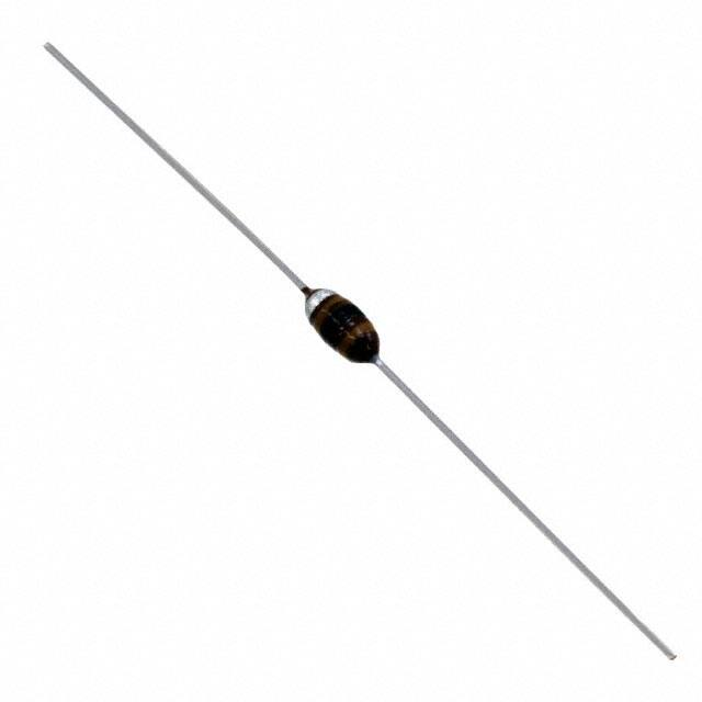

    固定电感器 Axial 100µH ±10% 85mA 12.5Ω 11MHz 60@2.52MHz
B78108T1104K000 数据手册
Inductors RF chokes, MCC series Series/Type: Date: B78108T, B78148T March 2008 Data Data Sheet  EPCOS AG 2008. Reproduction, publication and dissemination of this publication, enclosures hereto and the information contained therein without EPCOS’ prior express consent is prohibited. RF chokes MCC series, 3.3 × 7 (mm) MCC choke (Mini Cylinder Core) Rated inductance 0.1 µH to 100 µH Rated current 85 mA to 1120 mA Construction ■ Ceramic or ferrite cylinder core ■ Winding: enamel copper wire ■ Flame-retardant lacquer coating B78108T, B78148T B78108T Features ■ ■ ■ ■ ■ Low total height Low inductance High resonance frequency Suitable for wave soldering RoHS-compatible B78148T Applications ■ RF blocking ■ Decoupling and interference suppression ■ For antenna systems, automotive electronics, telecommunications, entertainment electronics Terminals ■ Central axial leads (B78108T) ■ Radially bent to 5 mm lead spacing (B78148T) ■ B781*T3: – Base material Staku 30/copper-clad steel 30 – Hot-dipped and electro-plated with pure tin ■ B781*T1: – Base material CuAg0.1 – Hot-dipped with pure tin Marking Inductance indicated by color bands to IEC 60062 Delivery mode and packing units ■ Taped, Ammo and reel packing ■ Packing units: Ammo (pcs./pack.) Axial Radial 5000 2500 Reel (pcs./reel) 5000 2000 Please read Cautions and warnings and Important notes at the end of this document. 2 03/08 RF chokes MCC series, 3.3 × 7 (mm) Dimensional drawings B78108T (axial leads, taped) 65±1 53±2 B78108T, B78148T Dimensions in mm ø0.6 max. ø3.3 max. 7 max. (IEC 60294) 6±0.5 3.5 min. 9.8 max. lacquered 5±0.25 5±0.25 IND0427-U-E Minimum lead spacing 10 mm B78148T (central radial leads, taped) (IEC 60294) 9.8 max. lacquered ø3.3 max. 2 max. 2 max. 0.6 max. 0.5 max. insulated 7 max. 1.3 max. 1.3 max. 29 max. _ 0.5 9 +0.75 16±0.5 Thickness of tape 0.7±0.2 IND0629-B _ 0.5 18 +1 6 min. 3.8±0.7 4±0.2 12.7±0.3 _ 0.1 5 +0.6 IND0630-V-E Packing ø30.5±0.15 ø82+1 ø90 30 ø360 _ 1 30 H n w Label 30 IND0452-V-E L W IND0631-B-E n (mm): Axial 72 +1, radial 42 +1 w (mm): Axial 84 max., radial 54 max. Please read Cautions and warnings and Important notes at the end of this document. L × W × H (max. mm): Axial: 310 × 75 × 120, radial: 340 × 50 × 210 3 03/08 RF chokes MCC series, 3.3 × 7 (mm) Technical data and measuring conditions Rated inductance LR B78108T, B78148T Measured with LCR meter Agilent 4284A or impedance analyzer Agilent 4294A = 1 MHz Measuring frequency: LR ≤ 10 µH 10 µH < LR ≤ 4700 µH = 100 kHz Measuring current: ≤ 1 mA Measuring temperature: 20 °C Measured with precision impedance analyzer Agilent 4294A, 20 °C 40 °C Maximum permissible DC current at rated temperature ≤ 10% (referred to initial value) at IR, 20 °C Measured at 20 °C Sn95.5Ag3.8Cu0.7: (245 ±5) °C, (3 ±0.3) s Wetting of soldering area ≥ 90% (to IEC 60068-2-20, test Ta) (260 ±5) °C, 10 s (to IEC 60068-2-20, test Tb) ≥ 20 N (to IEC 60068-2-21, test Ua) 55/125/56 (to IEC 60068-1) Mounted: –55 °C … +125 °C Packaged: –25 °C … +40 °C, ≤ 75% RH Approx. 0.25 g Q factor Qmin Rated temperature TR Rated current IR Inductance decrease ∆L/L0 DC resistance Rmax Solderability (lead-free) Resonance frequency fres,min Measured with Agilent 4294A or 8753ES, 20 °C Resistance to soldering heat Tensile strength of leads Climatic category Storage conditions Weight Mounting information When bending the leads, take care that the start-of-winding areas at the face ends (protected by glue and lacquer) are not subjected to any mechanical stress. Please read Cautions and warnings and Important notes at the end of this document. 4 03/08 RF chokes MCC series, 3.3 × 7 (mm) Characteristics and ordering codes LR µH Ceramic cylinder core 0.10 0.12 0.15 0.18 0.22 0.27 0.33 0.39 0.47 0.56 0.68 0.82 ±10% ^ B78108T, B78148T Tolerance1) Qmin fQ MHz IR mA 1120 1080 1020 1000 990 910 830 790 750 700 530 500 Rmax Ω 0.13 0.145 0.155 0.17 0.195 0.215 0.24 0.27 0.315 0.34 0.48 0.55 fres,min MHz 600 570 500 460 420 380 330 300 280 260 240 230 Ordering code 2) (reel packing)3) K 40 40 38 35 35 35 35 35 35 35 35 35 25.2 25.2 25.2 25.2 25.2 25.2 25.2 25.2 25.2 25.2 25.2 25.2 B781*8T3101K000 B781*8T3121K000 B781*8T3151K000 B781*8T3181K000 B781*8T3221K000 B781*8T3271K000 B781*8T3331K000 B781*8T3391K000 B781*8T3471K000 B781*8T3561K000 B781*8T3681K000 B781*8T3821K000 1) Closer tolerances on request. 2) Replace the * by code number »0« for axial taping or by »4« for radial taping. 3) For Ammo pack the last digit has to be a »9«. Example: B78108T3101K009 Please read Cautions and warnings and Important notes at the end of this document. 5 03/08 RF chokes MCC series, 3.3 × 7 (mm) Characteristics and ordering codes LR µH Ferrite cylinder core 1.0 1.2 1.5 1.8 2.2 2.7 3.3 3.9 4.7 5.6 6.8 8.2 10 12 15 18 22 27 33 39 47 56 68 82 100 ±10% ^ B78108T, B78148T Tolerance1) Qmin fQ MHz IR mA 630 610 570 540 520 480 420 400 380 260 250 240 230 190 185 175 170 160 150 140 100 100 95 90 85 Rmax Ω 0.25 0.25 0.30 0.30 0.35 0.40 0.50 0.55 0.65 1.30 1.45 1.60 1.70 2.40 2.70 2.90 3.20 3.60 4.10 4.50 8.50 8.80 10.0 11.5 12.5 fres,min MHz 180 170 150 130 120 110 110 100 90 75 70 65 60 50 45 40 30 27 24 22 20 18 15 14 11 Ordering code 2) (reel packing)3) B781*8T1102K000 B781*8T1122K000 B781*8T1152K000 B781*8T1182K000 B781*8T1222K000 B781*8T1272K000 B781*8T1332K000 B781*8T1392K000 B781*8T1472K000 B781*8T1562K000 B781*8T1682K000 B781*8T1822K000 B781*8T1103K000 B781*8T1123K000 B781*8T1153K000 B781*8T1183K000 B781*8T1223K000 B781*8T1273K000 B781*8T1333K000 B781*8T1393K000 B781*8T1473K000 B781*8T1563K000 B781*8T1683K000 B781*8T1823K000 B781*8T1104K000 K 35 40 40 40 40 40 40 40 40 45 45 50 50 55 55 55 60 60 60 60 60 60 60 60 60 25.2 7.96 7.96 7.96 7.96 7.96 7.96 7.96 7.96 7.96 7.96 7.96 7.96 2.52 2.52 2.52 2.52 2.52 2.52 2.52 2.52 2.52 2.52 2.52 2.52 1) Closer tolerances on request. 2) Replace the * by code number »0« for axial taping or by »4« for radial taping. 3) For Ammo pack the last digit has to be a »9«. Example: B78108T3101K009 Please read Cautions and warnings and Important notes at the end of this document. 6 03/08 RF chokes MCC series, 3.3 × 7 (mm) Impedance |Z| versus frequency f measured with impedance analyzer Agilent 4294A or S-parameter network analyzer Agilent 8753ES, typical values at 20 °C 10 6 Ω B781*8T |Z| 10 5 IND0112-N B78108T, B78148T Inductance L versus DC load current IDC measured with LCR meter Agilent 4284A, typical values at 20 °C 10 3 µH L 10 2 10 µH 10 1 IND0113-B B781*8T 100 µH 10 4 10 3 10 0 1 µH 10 2 0.1 µH 1 µH 10 µH 100 µH 10 7 10 1 10 _1 0.1 µH 10 0 6 10 10 8 Hz 10 f 9 10 _2 10 _2 10 _1 10 0 A 10 1 I DC Q factor versus frequency f measured with impedance analyzer Agilent 4294A, typical values at 20 °C 100 B781*8T Q IND0114-H Current derating Iop/IR versus ambient temperature TA (rated temperature TR = 40 °C) 1.2 IND0552-S-E Iop IR 1.0 0.8 0.1 µH 1 µH 10 µH 100 µH 50 0.6 0.4 0.2 04 10 10 5 10 6 10 7 Hz 10 8 f 0 0 20 40 60 80 100 ˚C TA 140 7 03/08 Cautions and warnings ■ Please note the recommendations in our Inductors data book (latest edition) and in the data sheets. – Particular attention should be paid to the derating curves given there. – The soldering conditions should also be observed. Temperatures quoted in relation to wave soldering refer to the pin, not the housing. ■ If the components are to be washed varnished it is necessary to check whether the washing varnish agent that is used has a negative effect on the wire insulation, any plastics that are used, or on glued joints. In particular, it is possible for washing varnish agent residues to have a negative effect in the long-term on wire insulation. ■ The following points must be observed if the components are potted in customer applications: – Many potting materials shrink as they harden. They therefore exert a pressure on the plastic housing or core. This pressure can have a deleterious effect on electrical properties, and in extreme cases can damage the core or plastic housing mechanically. – It is necessary to check whether the potting material used attacks or destroys the wire insulation, plastics or glue. – The effect of the potting material can change the high-frequency behaviour of the components. ■ Ferrites are sensitive to direct impact. This can cause the core material to flake, or lead to breakage of the core. ■ Even for customer-specific products, conclusive validation of the component in the circuit can only be carried out by the customer. Please read Cautions and warnings and Important notes at the end of this document. 8 03/08 Important notes The following applies to all products named in this publication: 1. Some parts of this publication contain statements about the suitability of our products for certain areas of application. These statements are based on our knowledge of typical requirements that are often placed on our products in the areas of application concerned. We nevertheless expressly point out that such statements cannot be regarded as binding statements about the suitability of our products for a particular customer application. As a rule, EPCOS is either unfamiliar with individual customer applications or less familiar with them than the customers themselves. For these reasons, it is always ultimately incumbent on the customer to check and decide whether an EPCOS product with the properties described in the product specification is suitable for use in a particular customer application. 2. We also point out that in individual cases, a malfunction of electronic components or failure before the end of their usual service life cannot be completely ruled out in the current state of the art, even if they are operated as specified. In customer applications requiring a very high level of operational safety and especially in customer applications in which the malfunction or failure of an electronic component could endanger human life or health (e.g. in accident prevention or life-saving systems), it must therefore be ensured by means of suitable design of the customer application or other action taken by the customer (e.g. installation of protective circuitry or redundancy) that no injury or damage is sustained by third parties in the event of malfunction or failure of an electronic component. 3. The warnings, cautions and product-specific notes must be observed. 4. In order to satisfy certain technical requirements, some of the products described in this publication may contain substances subject to restrictions in certain jurisdictions (e.g. because they are classed as hazardous). Useful information on this will be found in our Material Data Sheets on the Internet (www.epcos.com/material). Should you have any more detailed questions, please contact our sales offices. 5. We constantly strive to improve our products. Consequently, the products described in this publication may change from time to time. The same is true of the corresponding product specifications. Please check therefore to what extent product descriptions and specifications contained in this publication are still applicable before or when you place an order. We also reserve the right to discontinue production and delivery of products. Consequently, we cannot guarantee that all products named in this publication will always be available. The aforementioned does not apply in the case of individual agreements deviating from the foregoing for customer-specific products. 6. Unless otherwise agreed in individual contracts, all orders are subject to the current version of the “General Terms of Delivery for Products and Services in the Electrical Industry” published by the German Electrical and Electronics Industry Association (ZVEI). 7. The trade names EPCOS, BAOKE, Alu-X, CeraDiode, CSMP, CSSP, CTVS, DSSP, MiniBlue, MKK, MLSC, MotorCap, PCC, PhaseCap, PhaseCube, PhaseMod, SIFERRIT, SIFI, SIKOREL, SilverCap, SIMDAD, SIMID, SineFormer, SIOV, SIP5D, SIP5K, ThermoFuse, WindCap are trademarks registered or pending in Europe and in other countries. Further information will be found on the Internet at www.epcos.com/trademarks. 9 03/09
B78108T1104K000
1. 物料型号: - 系列/型号:B78108T, B78148T - MCC系列,尺寸为3.3 × 7毫米
2. 器件简介: - MCC电感(Mini Cylinder Core) - 额定电感:0.1微亨到100微亨 - 额定电流:85毫安到1120毫安
3. 引脚分配: - B78108T:中心轴向引脚(Axial) - B78148T:径向弯曲至5毫米引脚间距(Radial)
4. 参数特性: - 构造:陶瓷或铁氧体圆柱形磁芯,漆包铜线绕制,阻燃漆涂层 - 特性:低总高度、低电感、高谐振频率,适合波峰焊接,符合RoHS标准
5. 功能详解: - B78148T用于射频阻断、去耦和干扰抑制,适用于天线系统、汽车电子、电信、娱乐电子等领域。
6. 应用信息: - 终端:B78108T为轴向引脚,B78148T为径向引脚 - 标记:电感值通过颜色带表示,符合IEC 60062标准
7. 封装信息: - 包装方式:胶带包装、Ammo和卷轴包装 - 包装单位:轴向5000/卷,径向2500/卷
