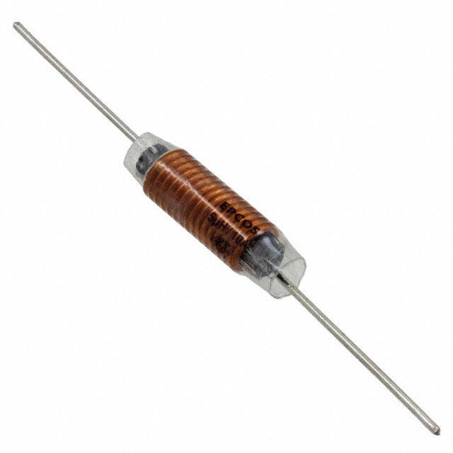

    固定电感器 Axial 5µH ±20% 10A 5mΩ 175MHz
B82111B0000C021 数据手册
Inductors VHF chokes Series/Type: Date: B82111B March 2008 Data Data Sheet  EPCOS AG 2008. Reproduction, publication and dissemination of this publication, enclosures hereto and the information contained therein without EPCOS’ prior express consent is prohibited. VHF chokes B82111B Rated voltage 500 V AC/DC Rated current 2 A to 10 A Rated inductance 3 µH to 25 µH Construction ■ Ferrite cylinder core ■ Winding: single-layer, enamel copper wire, winding ends brought out as leads ■ Polyester insulating sleeve Features ■ ■ ■ ■ ■ High resonant frequency High rated current Suitable for wave soldering RoHS-compatible ENEC10 approval Applications ■ RF blocking and filtering ■ Interference suppression in small appliances Terminals ■ Central axial leads ■ Base material Cu ■ Hot-dip tinned with pure tin Marking LR and IR in clear text and approval mark Delivery mode Bulk Dimensional drawing ød2 102 _ 5 ød1 l1 l2 IND0626-L Dimensions in mm Please read Cautions and warnings and Important notes at the end of this document. 2 03/08 VHF chokes B82111B Technical data and measuring conditions Test voltage Vtest Rated inductance LR 2500 V AC, 1 min Measured with LCR meter Agilent 4284A or impedance analyzer Agilent 4294A = 1 MHz Measuring frequency: LR ≤ 1 0 µ H 10 µH < LR ≤ 1000 µH = 100 kHz Measuring voltage: 1V Measuring temperature: 20 °C ±20% 60 °C Maximum permissible DC current at rated temperature Measured at 20 °C, tolerance ±20%, typical values Measured with Agilent 4294A or 8753ES, 20 °C tolerance ±30% Sn95.5Ag3.8Cu0.7: (245 ±5) °C, (3 ±0.3) s Wetting of soldering area ≥ 90% (to IEC 60068-2-20, test Ta) (260 ±5) °C, 10 s (to IEC 60068-2-20, test Tb) ≥ 30 N (to IEC 60068-2-21, test Ua) 55/125/56 (to IEC 60068-1) Mounted: –55 °C … +125 °C Packaged: –25 °C … +40 °C, ≤ 75% RH EN 60938 Inductance tolerance Rated temperature TR Rated current IR DC resistance Rtyp Resonance frequency fres Solderability (lead-free) Resistance to soldering heat (wave soldering) Tensile strength of leads Climatic category Storage conditions Approvals Mounting information When bending the leads, take care that the bending point is at least 3 mm apart from the face ends of the core and that the start-of-winding areas are not subjected to any mechanical stress. Please read Cautions and warnings and Important notes at the end of this document. 3 03/08 VHF chokes B82111B Characteristics and ordering codes IR LR µH 2 3 3 3 3 4 4 4 6 6 6 9 10 17 8 13 20 25 6 11 15 4 6 9 3 5 Rtyp Ω 0.063 0.025 0.024 0.054 0.046 0.017 0.020 0.024 0.014 0.010 0.012 0.006 0.005 fres Dimensions (mm) l2–3 24 24 29 29 34 24 29 34 24 29 34 29 34 d1 max. d2 7.0 7.0 6.5 6.0 8.5 7.5 6.5 8.5 7.5 7.0 9.0 7.5 9.5 0.45 0.63 0.67 0.5 0.63 0.75 0.71 0.75 0.8 0.95 0.95 1.2 1.3 Approx. weight g 3.0 3.0 3.5 3.5 6.0 3.0 6.0 7.0 4.0 5.0 8.0 5.0 10.0 Ordering code Approvals MHz l1–1.5 100 145 170 125 85 170 150 120 205 200 150 220 175 18.3 18.3 24.5 24.5 28.5 18.3 24.5 28.5 18.3 24.5 28.5 24.5 28.5 B82111B0000C014 × B82111B0000C013 B82111B0000C019 B82111B0000C020 B82111B0000C024 B82111B0000C012 B82111B0000C018 B82111B0000C023 B82111B0000C011 B82111B0000C017 B82111B0000C022 B82111B0000C016 B82111B0000C021 × × × × × × × × × × × × × = approval granted Impedance |Z| versus frequency f measured with impedance analyzer Agilent 4294A or S-parameter network analyzer Agilent 8753ES, typical values at 20 °C B82111B0000C011…C014 10 6 Ω |Z | 10 5 B82111B IND0154-3 B82111B0000C016…C020 10 6 Ω |Z| 10 5 B82111B IND0155-1 10 4 10 4 10 3 C014 C013 C012 C011 10 3 C020 C019 C018 C017 C016 10 8 Hz f 10 9 10 2 7 10 10 8 Hz f 10 9 10 2 7 10 Please read Cautions and warnings and Important notes at the end of this document. 4 03/08 VHF chokes B82111B Impedance |Z| versus frequency f measured with impedance analyzer Agilent 4294A or S-parameter network analyzer Agilent 8753ES, typical values at 20 °C B82111B0000C021…C024 10 6 Ω |Z| 10 5 B82111B IND0156-R Current derating Iop/IR versus ambient temperature TA (rated temperature TR = 60 °C) 1.2 I op IR IND0143-T-E 1.0 0.8 10 4 0.6 0.4 10 3 C024 C023 C022 C021 0.2 10 2 7 10 10 8 Hz f 10 9 0 0 20 40 60 80 100 ˚C TA 140 5 03/08 Cautions and warnings ■ Please note the recommendations in our Inductors data book (latest edition) and in the data sheets. – Particular attention should be paid to the derating curves given there. – The soldering conditions should also be observed. Temperatures quoted in relation to wave soldering refer to the pin, not the housing. ■ If the components are to be washed varnished it is necessary to check whether the washing varnish agent that is used has a negative effect on the wire insulation, any plastics that are used, or on glued joints. In particular, it is possible for washing varnish agent residues to have a negative effect in the long-term on wire insulation. ■ The following points must be observed if the components are potted in customer applications: – Many potting materials shrink as they harden. They therefore exert a pressure on the plastic housing or core. This pressure can have a deleterious effect on electrical properties, and in extreme cases can damage the core or plastic housing mechanically. – It is necessary to check whether the potting material used attacks or destroys the wire insulation, plastics or glue. – The effect of the potting material can change the high-frequency behaviour of the components. ■ Ferrites are sensitive to direct impact. This can cause the core material to flake, or lead to breakage of the core. ■ Even for customer-specific products, conclusive validation of the component in the circuit can only be carried out by the customer. Please read Cautions and warnings and Important notes at the end of this document. 6 03/08 Important notes The following applies to all products named in this publication: 1. Some parts of this publication contain statements about the suitability of our products for certain areas of application. These statements are based on our knowledge of typical requirements that are often placed on our products in the areas of application concerned. We nevertheless expressly point out that such statements cannot be regarded as binding statements about the suitability of our products for a particular customer application. As a rule, EPCOS is either unfamiliar with individual customer applications or less familiar with them than the customers themselves. For these reasons, it is always ultimately incumbent on the customer to check and decide whether an EPCOS product with the properties described in the product specification is suitable for use in a particular customer application. 2. We also point out that in individual cases, a malfunction of electronic components or failure before the end of their usual service life cannot be completely ruled out in the current state of the art, even if they are operated as specified. In customer applications requiring a very high level of operational safety and especially in customer applications in which the malfunction or failure of an electronic component could endanger human life or health (e.g. in accident prevention or life-saving systems), it must therefore be ensured by means of suitable design of the customer application or other action taken by the customer (e.g. installation of protective circuitry or redundancy) that no injury or damage is sustained by third parties in the event of malfunction or failure of an electronic component. 3. The warnings, cautions and product-specific notes must be observed. 4. In order to satisfy certain technical requirements, some of the products described in this publication may contain substances subject to restrictions in certain jurisdictions (e.g. because they are classed as hazardous). Useful information on this will be found in our Material Data Sheets on the Internet (www.epcos.com/material). Should you have any more detailed questions, please contact our sales offices. 5. We constantly strive to improve our products. Consequently, the products described in this publication may change from time to time. The same is true of the corresponding product specifications. Please check therefore to what extent product descriptions and specifications contained in this publication are still applicable before or when you place an order. We also reserve the right to discontinue production and delivery of products. Consequently, we cannot guarantee that all products named in this publication will always be available. The aforementioned does not apply in the case of individual agreements deviating from the foregoing for customer-specific products. 6. Unless otherwise agreed in individual contracts, all orders are subject to the current version of the “General Terms of Delivery for Products and Services in the Electrical Industry” published by the German Electrical and Electronics Industry Association (ZVEI). 7. The trade names EPCOS, BAOKE, Alu-X, CeraDiode, CSMP, CSSP, CTVS, DSSP, MiniBlue, MKK, MLSC, MotorCap, PCC, PhaseCap, PhaseCube, PhaseMod, SIFERRIT, SIFI, SIKOREL, SilverCap, SIMDAD, SIMID, SineFormer, SIOV, SIP5D, SIP5K, ThermoFuse, WindCap are trademarks registered or pending in Europe and in other countries. Further information will be found on the Internet at www.epcos.com/trademarks. 7 03/09
B82111B0000C021
1. 物料型号: - 系列/型号:B82111B
2. 器件简介: - B82111B是一种VHF扼流圈,具有高谐振频率和高额定电流的特点,适用于回流焊,符合RoHS标准,并获得了ENEC10认证。
3. 引脚分配: - 引脚为中央轴向引线,基本材料为铜,热浸镀纯锡。
4. 参数特性: - 额定电压:500V AC/DC - 额定电流:2A至10A - 额定电感:3µH至25µH - 构造:铁氧体圆柱磁芯,单层绕组,使用漆包铜线,绕组端引出作为引线,外覆聚酯绝缘套管。
5. 功能详解: - 应用包括射频阻断和滤波、小型家电中的干扰抑制。 - 电感公差为+20%,额定温度为60°C。 - 直流电阻Rtyp在20°C下测量,公差为+20%,提供典型值。 - 谐振频率fres在20°C下测量,公差为+30%。 - 焊接性(无铅)符合IEC 60068-2-20标准,焊接面积湿润度≥90%。 - 耐焊接热(波峰焊接)符合IEC 60068-2-20标准,260°C±5°C,10秒。 - 引线抗拉强度≥30N,符合IEC 60068-2-21标准。 - 气候类别为55/125/56,符合IEC 60068-1标准。 - 存储条件:安装时-55°C至+125°C,包装时-25°C至+40°C,75%RH。 - 获得EN60938认证。
6. 应用信息: - 主要用于射频阻断和滤波,以及小型家电中的干扰抑制。
7. 封装信息: - 提供了详细的尺寸图纸,尺寸以毫米为单位,具体尺寸请参考PDF文档中的图表。
