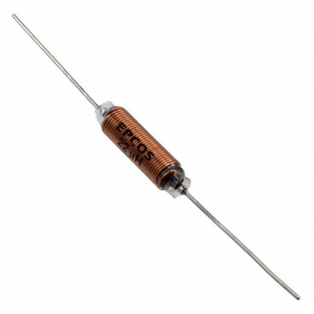

    固定电感器 Axial 22µH ±20% 3A 70MΩ 110MHz
B82111E0000C022 数据手册
Inductors VHF chokes Series/Type: Date: B82111E March 2008 7f…fÁRspp… 7f…fÁRspp… © EPCOS AG 2008. Reproduction, publication and dissemination of this publication, enclosures hereto and the information contained therein without EPCOS’ prior express consent is prohibited. VHF chokes B82111E Rated voltage 500 V AC/DC Rated current 0.1 A to 6 A Rated inductance 7 NH to 1200 NH Construction ■ Ferrite cylinder core ■ Winding: single-layer, enamel copper wire ■ Polyester insulating sleeve Features ■ ■ ■ ■ ■ High resonant frequency Wide inductance range Design complies with EN 60938 Suitable for wave soldering RoHS-compatible Applications ■ RF blocking and filtering ■ Interference suppression in small appliances ■ Decoupling in telecommunications and entertainment electronics Terminals ■ Central axial leads ■ Base material Cu ■ Hot-dip tinned with pure tin Marking LR and IR in clear text Delivery mode and packing unit ■ Taped and reeled ■ Packing unit: 1000 pcs./reel Please read C autions and warnings and Important notes at the end of this document. 2 03/08 VHF chokes B82111E Dimensional drawing 73 _ 1 9±0.5 ø0.8 26 max. d max. 10±0.5 10±0.5 30 min. IND0151-A 27.4 max. *) 1.2 max. *) *) Tolerance over 10 spacings ±2 mm Dimensions in mm IND0150-S-E Reel packing B82111E*C020, C029 325 97+1 109 max. IND0625-B B82111E*C021 … C028 ø30.5±0.15 ø126+1 ø133 ø360 _ 1 30 95+1 107 max. 30 Label IND0451-4-E Dimensions in mm Please read C autions and warnings and Important notes at the end of this document. 3 03/08 VHF chokes B82111E Technical data and measuring conditions Test voltage Vtest Rated inductance LR 2500 V AC, 1 min Measured with LCR meter Agilent 4284A or impedance analyzer Agilent 4294A = 1 MHz Measuring frequency: LR ≤ 10 μH 10 μH < LR ≤ 1000 μH = 100 kHz LR > 1000 μH = 10 kHz Measuring voltage: 1V Measuring temperature: 20 °C ±20% 60 °C Maximum permissible DC current at rated temperature Measured at 20 °C, tolerance ±20%, typical values Measured with Agilent 4294A or 8753ES, 20 °C, tolerance ±30% Sn95.5Ag3.8Cu0.7: (245 ±5) °C, (3 ±0.3) s Wetting of soldering area ≥ 90% (to IEC 60068-2-20, tst Ta) (260 ±5) °C, 10 s (to IEC 60068-2-20, test Tb) ≥ 30 N (to IEC 60068-2-21, test Ua) 55/125/56 (to IEC 60068-1) Mounted: –55 °C … +125 °C Packaged: –25 °C … +40 °C, ≤ 75% RH Inductance tolerance Rated temperature TR Rated current IR DC resistance Rtyp Resonance frequency fres Solderability (lead-free) Resistance to soldering heat (wave soldering) Tensile strength of leads Climatic category Storage conditions Mounting information When bending the leads, take care that the bending point is at least 3 mm apart from the face ends of the core and that the start-of-winding areas are not subjected to any mechanical stress. Please read C autions and warnings and Important notes at the end of this document. 4 03/08 VHF chokes B82111E Characteristics and ordering codes IR A 0.1 0.2 0.3 0.5 1 1.5 2 3 4 6 LR μH 1200 680 470 220 100 56 40 22 12 7 Rtyp Ω 34 14 6.5 2.6 0.65 0.30 0.18 0.07 0.04 0.02 fres MHz 16 19 25 32 55 70 90 110 140 180 Approx. weight g 2.2 2.2 2.3 2.3 2.5 2.7 3.0 3.3 3.5 3.6 Dimensions dmax mm 6.0 6.0 6.0 6.5 6.5 6.5 7.0 7.0 7.5 7.5 Ordering code B82111E0000C029 B82111E0000C028 B82111E0000C027 B82111E0000C026 B82111E0000C025 B82111E0000C024 B82111E0000C023 B82111E0000C022 B82111E0000C021 B82111E0000C020 Impedance |Z| versus frequency f measured with impedance analyzer Agilent 4294A or S-parameter network analyzer Agilent 8753ES, typical values at 20 °C 10 6 Ω |Z | 10 5 C029 C028 C027 C026 IND0152-S Current derating Iop/IR versus ambient temperature TA (rated temperature TR = 60 °C) 1.2 I op IR IND0143-T-E B82111E 1.0 0.8 10 4 0.6 10 3 C025 C024 C023 C022 C021 C020 10 7 10 8 Hz f 10 9 0.4 0.2 10 2 6 10 0 0 20 40 60 80 100 ˚C TA 140 Please read C autions and warnings and Important notes at the end of this document. 5 03/08 Cautions and warnings ■ Please note the recommendations in our Inductors data book (latest edition) and in the data sheets. – Particular attention should be paid to the derating curves given there. – The soldering conditions should also be observed. Temperatures quoted in relation to wave soldering refer to the pin, not the housing. ■ If the components are to be washed varnished it is necessary to check whether the washing varnish agent that is used has a negative effect on the wire insulation, any plastics that are used, or on glued joints. In particular, it is possible for washing varnish agent residues to have a negative effect in the long-term on wire insulation. ■ The following points must be observed if the components are potted in customer applications: – Many potting materials shrink as they harden. They therefore exert a pressure on the plastic housing or core. This pressure can have a deleterious effect on electrical properties, and in extreme cases can damage the core or plastic housing mechanically. – It is necessary to check whether the potting material used attacks or destroys the wire insulation, plastics or glue. – The effect of the potting material can change the high-frequency behaviour of the components. ■ Ferrites are sensitive to direct impact. This can cause the core material to flake, or lead to breakage of the core. ■ Even for customer-specific products, conclusive validation of the component in the circuit can only be carried out by the customer. Please read C autions and warnings and Important notes at the end of this document. 6 03/08 Important notes The following applies to all products named in this publication: 1. Some parts of this publication contain statements about the suitability of our products for certain areas of application. These statements are based on our knowledge of typical requirements that are often placed on our products in the areas of application concerned. We nevertheless expressly point out that such statements cannot be regarded as binding statements about the suitability of our products for a particular customer application. As a rule, EPCOS is either unfamiliar with individual customer applications or less familiar with them than the customers themselves. For these reasons, it is always ultimately incumbent on the customer to check and decide whether an EPCOS product with the properties described in the product specification is suitable for use in a particular customer application. 2. We also point out that in individual cases, a malfunction of electronic components or failure before the end of their usual service life cannot be completely ruled out in the current state of the art, even if they are operated as specified. In customer applications requiring a very high level of operational safety and especially in customer applications in which the malfunction or failure of an electronic component could endanger human life or health (e.g. in accident prevention or life-saving systems), it must therefore be ensured by means of suitable design of the customer application or other action taken by the customer (e.g. installation of protective circuitry or redundancy) that no injury or damage is sustained by third parties in the event of malfunction or failure of an electronic component. 3. The warnings, cautions and product-specific notes must be observed. 4. In order to satisfy certain technical requirements, some of the products described in this publication may contain substances subject to restrictions in certain jurisdictions (e.g. because they are classed as hazardous). Useful information on this will be found in our Material Data Sheets on the Internet (www.epcos.com/material). Should you have any more detailed questions, please contact our sales offices. 5. We constantly strive to improve our products. Consequently, the products described in this publication may change from time to time. The same is true of the corresponding product specifications. Please check therefore to what extent product descriptions and specifications contained in this publication are still applicable before or when you place an order. We also reserve the right to discontinue production and delivery of products. Consequently, we cannot guarantee that all products named in this publication will always be available. The aforementioned does not apply in the case of individual agreements deviating from the foregoing for customer-specific products. 6. Unless otherwise agreed in individual contracts, all orders are subject to the current version of the “General Terms of Delivery for Products and Services in the Electrical Industry” published by the German Electrical and Electronics Industry Association (ZVEI). 7. The trade names EPCOS, BAOKE, Alu-X, CeraDiode, CSMP, CSSP, CTVS, DSSP, MiniBlue, MKK, MLSC, MotorCap, PCC, PhaseCap, PhaseCube, PhaseMod, SIFERRIT, SIFI, SIKOREL, SilverCap, SIMDAD, SIMID, SineFormer, SIOV, SIP5D, SIP5K, ThermoFuse, WindCap are trademarks registered or pending in Europe and in other countries. Further information will be found on the Internet at www.epcos.com/trademarks. 7 03/09
