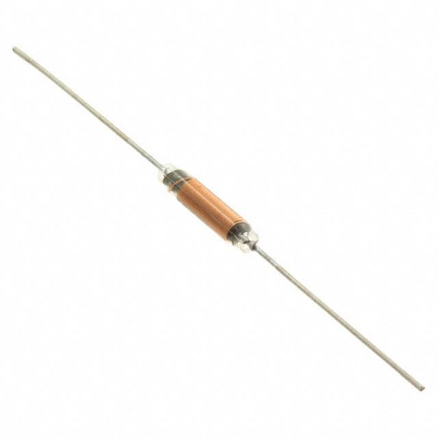

    固定电感器 Axial 23µH ±20% 700mA 730mΩ 55MHz
B82132A5701M000 数据手册
Inductors VHF chokes Series/Type: Date: B82131, B82132, B82133, B82134 March 2008 Data Data Sheet  EPCOS AG 2008. Reproduction, publication and dissemination of this publication, enclosures hereto and the information contained therein without EPCOS’ prior express consent is prohibited. VHF chokes B82131 … B82134 Rated voltage 500 V AC/DC Rated current 0.15 A to 6 A Rated inductance 1 µH to 420 µH Construction ■ Cylinder core of carbonyl iron ■ Winding: single-layer, enamel copper wire ■ Polyester insulating sleeve Features ■ ■ ■ ■ High resonant frequency Design complies with EN 60938 Suitable for wave soldering RoHS-compatible Applications ■ RF blocking and filtering ■ Interference suppression in small appliances ■ Decoupling in telecommunications and entertainment electronics Terminals ■ Central axial leads ■ Base material Cu ■ Hot-dip tinned with pure tin Marking LR and IR in clear text Delivery mode and packing units ■ Taped and reeled ■ Packing units: Series B82131, B82132 B82133, B82134 Pcs./reel 2000 1000 Please read Cautions and warnings and Important notes at the end of this document. 2 03/08 VHF chokes B82131 … B82134 Dimensional drawing 73 _ 1 ø0.8 9±0.5 d max. l max. 10±0.5 10±0.5 e min. IND0145-U *) Lead spacing e min (mm) 17.5 22.5 27.5 32.5 Type B82131 B82132 B82133 B82134 k max. *) Tolerance over 10 spacings ±2 mm IND0144-Z-E Dimensions in mm Reel packing ø30.5±0.15 ø126+1 ø133 ø360 _ 1 30 95+1 107 max. 30 Label IND0451-4-E Dimensions in mm Please read Cautions and warnings and Important notes at the end of this document. 3 1.2 max. *) 03/08 VHF chokes B82131 … B82134 Technical data and measuring conditions Test voltage Vtest Rated inductance LR 2500 V AC, 1 min Measured with LCR meter Agilent 4284A or impedance analyzer Agilent 4294A = 1 MHz Measuring frequency: LR ≤ 1 0 µ H 10 µH < LR ≤ 1000 µH = 100 kHz Measuring voltage: 1V Measuring temperature: 20 °C ±20% 60 °C Maximum permissible DC current at rated temperature Measured at 20 °C, tolerance ±20%, typical values Measured with Agilent 4294A or 8753ES, 20 °C, tolerance ±30% Sn95.5Ag3.8Cu0.7: (245 ±5) °C, (3 ±0.3) s Wetting of soldering area ≥ 90% (to IEC 60068-2-20, test Ta) (260 ±5) °C, 10 s (to IEC 60068-2-20, test Tb) ≥ 30 N (to IEC 60068-2-21, test Ua) 55/125/56 (to IEC 60068-1) Mounted: –55 °C … +125 °C Packaged: –25 °C … +40 °C, ≤ 75% RH Inductance tolerance Rated temperature TR Rated current IR DC resistance Rtyp Resonance frequency fres Solderability (lead-free) Resistance to soldering heat (wave soldering) Tensile strength of leads Climatic category Storage conditions Mounting information When bending the leads, take care that the bending point is at least 3 mm apart from the face ends of the core and that the start-of-winding areas are not subjected to any mechanical stress. Please read Cautions and warnings and Important notes at the end of this document. 4 03/08 VHF chokes B82131 … B82134 Characteristics and ordering codes IR A 0.15 LR µH 80 160 350 420 0.3 40 70 160 210 0.4 27 50 130 150 0.7 14 23 55 60 1.5 6 8 25 30 2 3 6 14 20 3 2 3 10 12 4 1 2 5 Rtyp Ω 11 17 21 19 4.1 5.7 6.5 6.4 2.0 3.0 4.8 3.5 0.76 0.73 1.20 0.77 0.19 0.16 0.32 0.30 0.09 0.11 0.13 0.15 0.038 0.035 0.077 0.090 0.014 0.020 0.034 fres MHz 22 20 11 12 31 29 16 18 40 37 18 18 53 55 26 34 84 90 40 44 113 108 57 59 147 151 69 75 199 186 87 Dimensions (mm) dmax 5 5.5 7.5 7.5 5 5.5 7.5 7.5 5 5.5 7.5 7.5 5 5.5 7.5 7.5 5 5.5 7.5 7.5 5 5.5 7.5 7.5 5 5.5 7.5 7.5 5 5.5 7.5 lmax 15 20 25 30 15 20 25 30 15 20 25 30 15 20 25 30 15 20 25 30 15 20 25 30 15 20 25 30 15 20 25 kmax 16.4 21.4 26.4 31.4 16.4 21.4 26.4 31.4 16.4 21.4 26.4 31.4 16.4 21.4 26.4 31.4 16.4 21.4 26.4 31.4 16.4 21.4 26.4 31.4 16.4 21.4 26.4 31.4 16.4 21.4 26.4 emin 17.5 22.5 27.5 32.5 17.5 22.5 27.5 32.5 17.5 22.5 27.5 32.5 17.5 22.5 27.5 32.5 17.5 22.5 27.5 32.5 17.5 22.5 27.5 32.5 17.5 22.5 27.5 32.5 17.5 22.5 27.5 Approx. Ordering code weight g 0.8 0.9 2.3 2.6 0.8 0.9 2.2 2.8 0.8 1.0 2.8 2.8 0.8 1.0 2.4 3.0 0.8 1.1 2.5 3.2 0.8 1.1 2.8 3.3 1.0 1.2 2.9 3.5 1.1 1.4 3.0 B82131A5151M000 B82132A5151M000 B82133A5151M000 B82134A5151M000 B82131A5301M000 B82132A5301M000 B82133A5301M000 B82134A5301M000 B82131A5401M000 B82132A5401M000 B82133A5401M000 B82134A5401M000 B82131A5701M000 B82132A5701M000 B82133A5701M000 B82134A5701M000 B82131A5152M000 B82132A5152M000 B82133A5152M000 B82134A5152M000 B82131A5202M000 B82132A5202M000 B82133A5202M000 B82134A5202M000 B82131A5302M000 B82132A5302M000 B82133A5302M000 B82134A5302M000 B82131A5402M000 B82132A5402M000 B82133A5402M000 Please read Cautions and warnings and Important notes at the end of this document. 5 03/08 VHF chokes B82131 … B82134 Impedance |Z| versus frequency f measured with impedance analyzer Agilent 4294A or S-parameter network analyzer Agilent 8753ES, typical values at 20 °C B82131A5***M000 10 6 Ω | Z| 10 5 A5151 A5301 A5401 B82131 IND0146-1 B82132A5***M000 10 6 Ω B82132 | Z| 10 5 A5151 A5301 A5401 IND0147-5 10 4 10 4 10 3 10 3 10 2 10 1 A5701 A5152 A5202 A5302 A5402 10 7 10 8 Hz 10 9 f 10 2 10 1 A5701 A5152 A5202 A5302 A5402 10 7 10 8 Hz 10 9 f 10 0 6 10 10 0 6 10 B82133A5***M000 10 6 Ω B82133 | Z| 10 5 IND0148-6 B82134A5***M000 10 6 Ω | Z| 10 5 B82134 IND0149-9 10 4 10 4 10 3 A5151 A5301 A5401 A5701 A5152 A5202 A5302 A5402 10 7 10 8 Hz 10 9 f 10 3 A5151 A5301 A5401 A5701 A5152 A5202 A5302 10 2 10 2 10 1 10 1 10 0 6 10 10 0 6 10 10 7 10 8 Hz 10 9 f 6 03/08 VHF chokes B82131 … B82134 Current derating Iop/IR versus ambient temperature TA (rated temperature TR = 60 °C) 1.2 I op IR IND0143-T-E 1.0 0.8 0.6 0.4 0.2 0 0 20 40 60 80 100 ˚C TA 140 7 03/08 Cautions and warnings ■ Please note the recommendations in our Inductors data book (latest edition) and in the data sheets. – Particular attention should be paid to the derating curves given there. – The soldering conditions should also be observed. Temperatures quoted in relation to wave soldering refer to the pin, not the housing. ■ If the components are to be washed varnished it is necessary to check whether the washing varnish agent that is used has a negative effect on the wire insulation, any plastics that are used, or on glued joints. In particular, it is possible for washing varnish agent residues to have a negative effect in the long-term on wire insulation. ■ The following points must be observed if the components are potted in customer applications: – Many potting materials shrink as they harden. They therefore exert a pressure on the plastic housing or core. This pressure can have a deleterious effect on electrical properties, and in extreme cases can damage the core or plastic housing mechanically. – It is necessary to check whether the potting material used attacks or destroys the wire insulation, plastics or glue. – The effect of the potting material can change the high-frequency behaviour of the components. ■ Ferrites are sensitive to direct impact. This can cause the core material to flake, or lead to breakage of the core. ■ Even for customer-specific products, conclusive validation of the component in the circuit can only be carried out by the customer. Please read Cautions and warnings and Important notes at the end of this document. 8 03/08 Important notes The following applies to all products named in this publication: 1. Some parts of this publication contain statements about the suitability of our products for certain areas of application. These statements are based on our knowledge of typical requirements that are often placed on our products in the areas of application concerned. We nevertheless expressly point out that such statements cannot be regarded as binding statements about the suitability of our products for a particular customer application. As a rule, EPCOS is either unfamiliar with individual customer applications or less familiar with them than the customers themselves. For these reasons, it is always ultimately incumbent on the customer to check and decide whether an EPCOS product with the properties described in the product specification is suitable for use in a particular customer application. 2. We also point out that in individual cases, a malfunction of electronic components or failure before the end of their usual service life cannot be completely ruled out in the current state of the art, even if they are operated as specified. In customer applications requiring a very high level of operational safety and especially in customer applications in which the malfunction or failure of an electronic component could endanger human life or health (e.g. in accident prevention or life-saving systems), it must therefore be ensured by means of suitable design of the customer application or other action taken by the customer (e.g. installation of protective circuitry or redundancy) that no injury or damage is sustained by third parties in the event of malfunction or failure of an electronic component. 3. The warnings, cautions and product-specific notes must be observed. 4. In order to satisfy certain technical requirements, some of the products described in this publication may contain substances subject to restrictions in certain jurisdictions (e.g. because they are classed as hazardous). Useful information on this will be found in our Material Data Sheets on the Internet (www.epcos.com/material). Should you have any more detailed questions, please contact our sales offices. 5. We constantly strive to improve our products. Consequently, the products described in this publication may change from time to time. The same is true of the corresponding product specifications. Please check therefore to what extent product descriptions and specifications contained in this publication are still applicable before or when you place an order. We also reserve the right to discontinue production and delivery of products. Consequently, we cannot guarantee that all products named in this publication will always be available. The aforementioned does not apply in the case of individual agreements deviating from the foregoing for customer-specific products. 6. Unless otherwise agreed in individual contracts, all orders are subject to the current version of the “General Terms of Delivery for Products and Services in the Electrical Industry” published by the German Electrical and Electronics Industry Association (ZVEI). 7. The trade names EPCOS, BAOKE, Alu-X, CeraDiode, CSMP, CSSP, CTVS, DSSP, MiniBlue, MKK, MLSC, MotorCap, PCC, PhaseCap, PhaseCube, PhaseMod, SIFERRIT, SIFI, SIKOREL, SilverCap, SIMDAD, SIMID, SineFormer, SIOV, SIP5D, SIP5K, ThermoFuse, WindCap are trademarks registered or pending in Europe and in other countries. Further information will be found on the Internet at www.epcos.com/trademarks. 9 03/09
