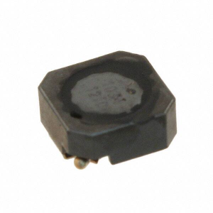

SMT–Power–Inductors DATA SHEET B82462–G4 Size 6x6 mm Rated inductance 0,82 µH .. 1000 µH Construction S Ferrite core S Magnetically shielded S Winding: enamel copper wire S Winding welded to terminals Features S Wide temperature range S High rated current S Low DC resistance S Suitable for reflow soldering Applications S Filtering of supply voltages S Coupling, decoupling S DC/DC converters S Automotive electronics Terminals S Leadfree tinned Marking Marking on component: Manufacturer L value (in µH) and tolerance (coded) Date code Minimum marking on reel: Manufacturer, part number, ordering code, L value and tolerance quantity, date of packing Delivery mode Blister tape 12mm, reel packing packaging quantity 2500 pcs per reel The information contained in this data sheet describes the type of component and shall not be considered as guaranteed characteristics. 1 B82462–G4–01–7659 14.04.2005 SMT–Power–Inductors DATA SHEET B82462–G4 General technical data Rated inductance LR Rated current IR Saturation current Climatic category Solderability Resistance to soldering heat Self–resonance frequency fres DC resistance Rmax Weight Measured with HP 4294A, measuring voltage 100 mV Maximum permissible DC with temperature increase of v 40 K at ambient temperature of 85 °C Maximum permissible DC with inductance decrease ∆L/L0 ≈ 10% In accordance with IEC 60068–1 55/125/56 (–55 °C/ +125 °C/ 56 days damp heat test) 5s, 235°C, wetting > 90% acc. to IEC 60068–2–58, leadfree reflow soldering profile Measured with network analyzer HP 8753 Measured at 20 °C ambient temperature Approx. 1,5g Dimensional drawing The information contained in this data sheet describes the type of component and shall not be considered as guaranteed characteristics. 2 B82462–G4–01–7659 14.04.2005 SMT–Power–Inductors DATA SHEET B82462–G4 Characteristics and ordering codes LR µH 0,82 1,0 1,2 1,5 2,2 3,3 4,7 6,8 10 15 22 33 47 68 100 150 220 330 470 680 1000 fL MHz 0,1 0,1 0,1 0,1 0,1 0,1 0,1 0,1 0,1 0,1 0,1 0,1 0,1 0,1 0,1 0,1 0,1 0,1 0,1 0,1 0,1 Tolerance Isat A 20 % 20 % 20 % 20 % 20 % 20 % 20 % 20 % 20 % 20 % 20 % 20 % 20 % 20 % 20% 20 % 20 % 20 % 20 % 20 % 20 % 4,45 4,40 3,90 3,60 2,60 2,10 1,80 1,50 1,30 1,05 0,85 0,72 0,60 0,50 0,42 0,33 0,28 0,22 0,18 0,15 0,13 IR A 3,45 3,40 3,25 3,10 2,55 2,30 2,00 1,65 1,50 1,25 1,05 0,85 0,75 0,65 0,53 0,38 0,35 0,27 0,24 0,20 0,16 Rmax Ω 0,015 0,016 0,017 0,020 0,025 0,031 0,040 0,050 0,062 0,097 0,15 0,23 0,31 0,41 0,58 1,05 1,35 2,30 2,70 4,05 6,00 fres,typ MHz 182 180 130 100 75 60 55 40 31 23 20 16 13 10 8,5 6,5 5,5 4,5 3,5 3,0 2,5 Ordering code B82462–G4821–M B82462–G4102–M B82462–G4122–M B82462–G4152–M B82462–G4222–M B82462–G4332–M B82462–G4472–M B82462–G4682–M B82462–G4103–M B82462–G4153–M B82462–G4223–M B82462–G4333–M B82462–G4473–M B82462–G4683–M B82462–G4104–M B82462–G4154–M B82462–G4224–M B82462–G4334–M B82462–G4474–M B82462–G4684–M B82462–G4105–M The information contained in this data sheet describes the type of component and shall not be considered as guaranteed characteristics. 3 B82462–G4–01–7659 14.04.2005 SMT–Power–Inductors DATA SHEET B82462–G4 Typical diagrams: 12 , I0 1 / I B82462–XXXX–X: current derating versus ambient temperature 08 , 06 , 04 , 02 , 0 0 1 2 3 4 5 6 7 8 9 10 1010 1010 10T/ 0 0 0 0 0 0 0 0 0 0 1 2 3 4 5 AC Impedance versus frequency Inductance derating versus load current 1 The information contained in this data sheet describes the type of component and shall not be considered as guaranteed characteristics. 4 B82462–G4–01–7659 14.04.2005
