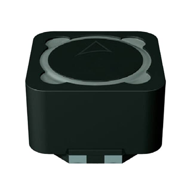

SMT power inductors Size 12.5 × 12.5 × 8.5 (mm) Series/Type: Date: B82477D4 October 2008 7f…fÁRspp… 7f…fÁRspp… © EPCOS AG 2008. Reproduction, publication and dissemination of this publication, enclosures hereto and the information contained therein without EPCOS’ prior express consent is prohibited. SMT power inductors Size 12.5 s 12.5 s 8.5 (mm) Rated inductance 10 NH to 100 NH Rated current 0.96 A to 2.7 A Construction ■ ■ ■ ■ ■ B82477D4 Ferrite core Magnetically shielded Winding: enamel copper wire Special winding technology for low stray inductance Winding soldered to terminals Features Temperature range up to 150 °C Very high rated current Low DC resistance Suitable for lead-free reflow soldering as referenced in JEDEC J-STD 020C ■ RoHS-compatible ■ ■ ■ ■ Applications ■ Common mode choke ■ DC/DC converters ■ 1:1 transformer Terminals ■ Base material CuSn6P ■ Layer composition Ni, Sn (lead-free) ■ Electro-plated Marking ■ Marking on component: Manufacturer, L value (μH, coded), manufacturing date (YWWD) ■ Minimum data on reel: Manufacturer, ordering code, L value, quantity, date of packing Delivery mode and packing unit ■ 24-mm blister tape, wound on 330-mm ∅ reel ■ Packing unit: 350 pcs./reel Please read C autions and warnings and Important notes at the end of this document. 2 10/08 SMT power inductors Size 12.5 s 12.5 s 8.5 (mm) Dimensional drawing and pin configuration 12.5 max. 7.2±0.2 6.8 B82477D4 Layout recommendation 12.5 max. 2 3 5±0.2 1.6±0.2 1.2 1 4 5.8 IND0916-R Marking 1 4 1 2 3 4 IND0515-V-E 8.5 max. 2 3 Dimensions in mm Taping and packing Blister tape 1.75±0.1 4±0.1 Component 1.5+0.1 2±0.1 Reel 21±0.5 2.5±0.5 13±0.2 11.5±0.1 12.85±0.1 24±0.3 330±1 1.5 min. 8.7 max. 20±0.1 Direction of unreeling IND0342-S-E 30.4 max. IND0348-6 Dimensions in mm Please read C autions and warnings and Important notes at the end of this document. 3 10/08 75±1 1.0 13 SMT power inductors Size 12.5 s 12.5 s 8.5 (mm) Technical data and measuring conditions Rated inductance LR Rated temperature TR Rated current IR B82477D4 Measured with LCR meter Agilent 4284A at frequency fL, 0.1 V, 20 °C 85 °C Max. permissible DC with temperature increase of ≤ 40 K at rated temperature or inductance decrease ΔL/L0 ≤ 10% (per winding) Measured with Agilent 4284A at 100 kHz, 0.1 V, 20 °C, typical values Measured at 20 °C Dip and look method Sn95.5Ag3.8Cu0.7: (245 ±5) °C, (5 ±0.3) s Wetting of soldering area ≥ 90% (based on IEC 60068-2-58) 260 °C, 40 s (as referenced in JEDEC J-STD 020C) 55/150/56 (to IEC 60068-1) Mounted: –55 °C … +150 °C Packaged: –25 °C … +40 °C, ≤ 75% RH Approx. 4 g Stray inductance Lstray,typ DC resistance Rmax Solderability (lead-free) Resistance to soldering heat Climatic category Storage conditions Weight Characteristics and ordering codes LR1, LR2 μH 10 15 22 33 100 ±20% ^ Tolerance Lstray,typ μH M 0.20 0.25 0.30 0.50 0.60 fL MHz 0.1 0.1 0.1 0.1 0.1 IR1, IR2 A 2.70 2.30 2.05 1.65 0.96 R1max, R2max Ω 0.043 0.060 0.080 0.130 0.280 Ordering code B82477D4103M000 B82477D4153M000 B82477D4223M000 B82477D4333M000 B82477D4104M000 Please read C autions and warnings and Important notes at the end of this document. 4 10/08 SMT power inductors Size 12.5 s 12.5 s 8.5 (mm) Current derating Iop/IR versus ambient temperature TA (rated temperature TR = 85 °C) 1.2 I op IR IND0602-K B82477D4 1.0 0.8 0.6 0.4 0.2 0 0 20 40 60 80 100 120 ˚C 150 TA 5 10/08 Cautions and warnings ■ Please note the recommendations in our Inductors data book (latest edition) and in the data sheets. – Particular attention should be paid to the derating curves given there. – The soldering conditions should also be observed. Temperatures quoted in relation to wave soldering refer to the pin, not the housing. ■ If the components are to be washed varnished it is necessary to check whether the washing varnish agent that is used has a negative effect on the wire insulation, any plastics that are used, or on glued joints. In particular, it is possible for washing varnish agent residues to have a negative effect in the long-term on wire insulation. ■ The following points must be observed if the components are potted in customer applications: – Many potting materials shrink as they harden. They therefore exert a pressure on the plastic housing or core. This pressure can have a deleterious effect on electrical properties, and in extreme cases can damage the core or plastic housing mechanically. – It is necessary to check whether the potting material used attacks or destroys the wire insulation, plastics or glue. – The effect of the potting material can change the high-frequency behaviour of the components. ■ Ferrites are sensitive to direct impact. This can cause the core material to flake, or lead to breakage of the core. ■ Even for customer-specific products, conclusive validation of the component in the circuit can only be carried out by the customer. Please read C autions and warnings and Important notes at the end of this document. 6 10/08 Important notes The following applies to all products named in this publication: 1. Some parts of this publication contain statements about the suitability of our products for certain areas of application. These statements are based on our knowledge of typical requirements that are often placed on our products in the areas of application concerned. We nevertheless expressly point out that such statements cannot be regarded as binding statements about the suitability of our products for a particular customer application. As a rule, EPCOS is either unfamiliar with individual customer applications or less familiar with them than the customers themselves. For these reasons, it is always ultimately incumbent on the customer to check and decide whether an EPCOS product with the properties described in the product specification is suitable for use in a particular customer application. 2. We also point out that in individual cases, a malfunction of electronic components or failure before the end of their usual service life cannot be completely ruled out in the current state of the art, even if they are operated as specified. In customer applications requiring a very high level of operational safety and especially in customer applications in which the malfunction or failure of an electronic component could endanger human life or health (e.g. in accident prevention or life-saving systems), it must therefore be ensured by means of suitable design of the customer application or other action taken by the customer (e.g. installation of protective circuitry or redundancy) that no injury or damage is sustained by third parties in the event of malfunction or failure of an electronic component. 3. The warnings, cautions and product-specific notes must be observed. 4. In order to satisfy certain technical requirements, some of the products described in this publication may contain substances subject to restrictions in certain jurisdictions (e.g. because they are classed as hazardous). Useful information on this will be found in our Material Data Sheets on the Internet (www.epcos.com/material). Should you have any more detailed questions, please contact our sales offices. 5. We constantly strive to improve our products. Consequently, the products described in this publication may change from time to time. The same is true of the corresponding product specifications. Please check therefore to what extent product descriptions and specifications contained in this publication are still applicable before or when you place an order. We also reserve the right to discontinue production and delivery of products. Consequently, we cannot guarantee that all products named in this publication will always be available. The aforementioned does not apply in the case of individual agreements deviating from the foregoing for customer-specific products. 6. Unless otherwise agreed in individual contracts, all orders are subject to the current version of the “General Terms of Delivery for Products and Services in the Electrical Industry” published by the German Electrical and Electronics Industry Association (ZVEI). 7. The trade names EPCOS, BAOKE, Alu-X, CeraDiode, CSMP, CSSP, CTVS, DSSP, MiniBlue, MKK, MLSC, MotorCap, PCC, PhaseCap, PhaseCube, PhaseMod, SIFERRIT, SIFI, SIKOREL, SilverCap, SIMDAD, SIMID, SineFormer, SIOV, SIP5D, SIP5K, ThermoFuse, WindCap are trademarks registered or pending in Europe and in other countries. Further information will be found on the Internet at www.epcos.com/trademarks. 7 03/09
