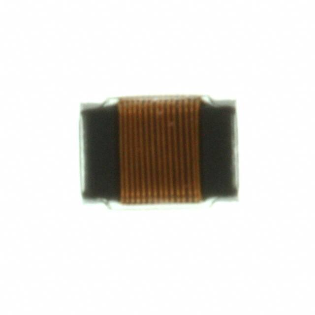

    固定电感器 Nonstandard 1µH ±5% 240mA 550mΩ 440MHz 20@7.96MHz
B82498F1102J000 数据手册
SMT inductors SIMID series, SIMID 0805-F Series/Type: Date: B82498F March 2008 Data Data Sheet  EPCOS AG 2008. Reproduction, publication and dissemination of this publication, enclosures hereto and the information contained therein without EPCOS’ prior express consent is prohibited. SMT inductors, SIMID series SIMID 0805-F Size 0805 (EIA) and/or 2012 (IEC) Rated inductance 2.7 nH to 6800 nH Rated current 80 mA to 1000 mA Construction ■ Cubic coil with ceramic or ferrite core ■ Epoxy-molded flat top for vacuum pickup ■ Winding ends welded to terminals B82498F Features ■ ■ ■ ■ High resonance frequency Close inductance tolerance Suitable for lead-free reflow soldering RoHS-compatible Applications Resonant circuits, impedance matching for ■ Antenna amplifiers ■ Multimedia ■ Wireless communication systems ■ Car access systems ■ TPMS (Tire Pressure Monitoring System) ■ GPS (Global Positioning System) Terminals ■ Standard version: – Base material Al2O3 ceramic and ferrite – Thick-film coating of Ag/Pd/Pt ■ Gold-plated terminals: – Base material Al2O3 ceramic – Layer composition W/Ni/Au – Electro-plated Marking ■ No marking on component ■ Minimum data on reel: Manufacturer, ordering code, L value, quantity, date of packing Delivery mode and packing unit ■ 8-mm blister tape, wound on 180-mm reel ■ Packing unit: 3000 pcs./reel Please read Cautions and warnings and Important notes at the end of this document. 2 03/08 SMT inductors, SIMID series SIMID 0805-F Dimensional drawing and layout recommendation 2.3 max. 2+0.2 1) B82498F 1.3±0.1 Metallization Welding 0.5±0.11) 1.7 max. area 2) Epoxy coating C B IND0041-C 0.5±0.11) 0.2 min.1) A 1.5 ±0.2 B 3.2 ±0.4 A C 1.0 ±0.1 1.4 max. 1) Soldering area 2) This area (30% of contact area) should not be used to assess solderability IND0542-S-E 0.8 max. Dimensions in mm Taping and packing Blister tape 1.75±0.1 4±0.1 Component _0 1.5 +0.1 Reel 14.4 max. 3.5±0.05 13±0.25 2±0.05 _ < 3.3 8±0.3 1.9 max. 4±0.1 Direction of unreeling IND0554-E-E _0 8.4 +1.5 178±2 ø60 min. IND0581-C Dimensions in mm Please read Cautions and warnings and Important notes at the end of this document. 3 03/08 SMT inductors, SIMID series SIMID 0805-F Technical data and measuring conditions Rated inductance LR B82498F Measured with impedance analyzer Agilent 4291A and test fixture Agilent 16197A at frequency fL, 0.1 V, 20 °C. Pad distance 0.9 ±0.1 (mm) Short inductance 200 pH unconsidered Measured with impedance analyzer Agilent 4291A and test fixture Agilent 16197A at frequency fQ, 20 °C. Pad distance 0.9 ±0.1 (mm) Short inductance 200 pH unconsidered 105 °C Maximum permissible DC with inductance decrease ∆L/L0 ≤ 10% and temperature increase of ≤ 20 K at rated temperature Measured with network analyzer Agilent 8720D, 20 °C Measured at 20 °C Sn95.5Ag3.8Cu0.7: (245 ±5) °C, (5 ±0.3) s Wetting of soldering area ≥ 90% (based on IEC 60068-2-58) Standard version: 260 °C, 20 s (as referenced in JEDEC J-STD 020C) Gold-plated terminals: 260 °C, 40 s (as referenced in JEDEC J-STD 020C) 55/125/56 (to IEC 60068-1) Mounted: −55 °C … +125 °C Packaged: −25 °C … +40 °C, ≤ 75% RH Approx. 10 mg Q factor Qmin Rated temperature TR Rated current IR Self-resonance frequency fres,min DC resistance Rmax Solderability (lead-free) Resistance to soldering heat Climatic category Storage conditions Weight Please read Cautions and warnings and Important notes at the end of this document. 4 03/08 SMT inductors, SIMID series SIMID 0805-F Characteristics and ordering codes LR nH Core material: ceramic 2.7 5.6 6.8 8.2 10 12 15 18 22 27 33 39 47 56 68 82 100 120 150 180 220 270 330 390 470 560 680 820 ±2% ±5% ^ ^ B82498F Tolerance fL MHz Qmin fQ MHz IR mA 1000 900 800 700 700 700 650 700 700 700 600 600 600 600 500 500 450 440 400 340 320 270 220 210 190 230 190 180 Rmax Ω 0.03 0.04 0.05 0.09 0.09 0.09 0.13 0.08 0.08 0.09 0.11 0.12 0.13 0.14 0.18 0.19 0.28 0.31 0.42 0.53 0.70 1.0 1.5 1.6 1.9 1.3 1.7 1.9 fres,min MHz 9000 7000 6000 5000 5000 4000 3300 3300 2500 2500 2200 2100 2000 1700 1600 1500 1350 1250 1150 1050 950 900 800 700 650 400 300 300 Ordering code 1)2) (standard version) ±10% ^ K 250 250 250 250 50 50 50 50 50 50 50 60 60 60 65 65 65 60 60 60 55 50 45 45 45 45 45 40 30 23 23 23 1500 1000 1000 1000 500 500 500 500 500 500 500 500 500 500 500 500 500 250 250 250 250 250 250 250 100 50 50 50 B82498F3279K000 B82498F3569K000 B82498F3689K000 B82498F3829K000 B82498F3100+000 B82498F3120+000 B82498F3150+000 B82498F3180+000 B82498F3220+000 B82498F3270+000 B82498F3330+000 B82498F3390+000 B82498F3470+000 B82498F3560+000 B82498F3680+000 B82498F3820+000 B82498F3101+000 B82498F3121+000 B82498F3151+000 B82498F3181+000 B82498F3221+000 B82498F3271+000 B82498F3331+000 B82498F3391+000 B82498F3471+000 B82498F3561+000 B82498F3681+000 B82498F3821+000 G J 250 250 250 250 250 250 250 250 200 200 200 150 150 150 100 100 100 100 100 100 50 25 25 25 Higher currents possible at temperatures
