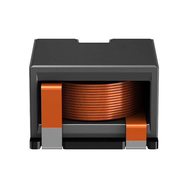

    固定电感器 Nonstandard, 3 Lead 1.5µH ±10% 30A 1.4mΩ
B82559B3152A016 数据手册
ERU chokes ERU 16, SMT flat wire high current inductors Series/Type: B82559B*A016 Date: August 2020 Data Sheet ¤TDK Electronics AG 2020. Reproduction, publication and dissemination of this publication, enclosures hereto and the information contained therein without TDK Electronics’ prior express consent is prohibited. ERU chokes B82559B*A016 ERU 16 Helically wound Rated inductance 1.0 .... 30 μH Saturation current 10.3 ... 40.4 A Construction ■ ■ ■ ■ ■ ■ High temperature ferrite core Magnetically shielded Helical winding Self-leaded construction Under body termination 3 pins for improved reliability Features ■ ■ ■ ■ ■ ■ ■ High rated current Extremely low DC resistance Very low profile and extremely small footprint Suitable for pick-and-place processes RoHS-compatible Easily customized AEC-Q200 qualified Applications Energy storage chokes for ■ DC-DC converters ■ VRM modules ■ POL converters ■ Solar converters Terminals Lead-free tinned Marking Manufacturer, ordering code, date of manufacture and production place (YYWWD/X), Delivery mode and packing units ■ Blister tape Please read Cautions and warnings and Important notes at the end of this document. 2 08/20 ERU chokes B82559B*A016 ERU 16 Helically wound Dimensional drawing and layout recommendation Dimensions in mm Circuit diagram Please read Cautions and warnings and Important notes at the end of this document. 3 08/20 ERU chokes B82559B*A016 ERU 16 Helically wound Taping and packing Tape: Dimensions in mm Reel: Dimensions in mm Height (mm) component h cavity H (blister tape) nom. max. Packing unit pcs. per reel 7.2 8.6 300 8.1 9.5 280 9.1 10.5 250 10.0 11.4 210 10.75 12.7 170 Please read Cautions and warnings and Important notes at the end of this document. 4 08/20 ERU chokes B82559B*A016 ERU 16 Helically wound Technical data and measuring conditions Rated inductance LR Measured at 100 kHz, 0.1 V, +25 °C Inductance tolerance r10% Saturation current ISat Current that will result in an approximately 20% drop in the inductance values at the specified temperature Rated current IR Current that will cause a '40 K self-heating at room temperature DC resistance RDC Measured at +25 °C, tolerance r10%, typical values Self-resonant frequency ! 2 MHz High voltage: N1 - core 200 V DC, 1 s Solderability (test of wettability of the pins) (245 r5) °C, (3 r0.3) s, wetting of soldering area t95% (based on IEC 60068-2-58, solder bath method) Resistance to soldering heat To JEDEC J-STD 020D (Tc: +245 °C on pin) Operating temperature 40 °C … +150 °C (component) Storage conditions (packaged) –25 °C … +40 °C, d75% RH Characteristics and ordering codes LR Isat, 25°C Isat, 100°C IR RDC (typ) Height h Approx. Ordering code (nom.) weight PH A A A m: mm 1.0 40.4 34.4 36.0 1.0 7.20 6.8 B82559B2102A016 1.5 40.5 35.3 30.0 1.4 8.10 7.6 B82559B3152A016 2.2 37.3 31.8 26.8 1.8 9.10 8.5 B82559B4222A016 3.3 30.9 26.5 25.0 2.2 10.00 9.1 B82559B5332A016 4.7 21.3 18.9 25.0 2.2 10.00 9.2 B82559B5472A016 6.8 18.7 16.0 14.4 6.2 8.10 7.4 B82559B6682A016 10.0 14.6 12.8 13.0 7.2 8.10 7.6 B82559B7103A016 15.0 14.0 12.1 11.7 10.2 9.10 8.7 B82559B0153A016 20.0 12.4 10.8 10.0 12.1 10.00 9.3 B82559B0203A016 30.0 10.3 9.1 8.5 15.4 10.75 10.5 B82559B0303A016 Please read Cautions and warnings and Important notes at the end of this document. 5 08/20 g ERU chokes B82559B*A016 ERU 16 Helically wound Inductance L versus DC load current IDC The temperature rise 'T is measured at an ambient temperature of +25 °C. A current is applied for 30 minutes and the temperature is measured on top of the inductor which is monted on a printed circuit board. No forced air cooling is applied. B82559B2102A016 The inductance vs current curves are generated by measuring the inductors at +25 °C and +100 °C. B82559B3152A016 Please read Cautions and warnings and Important notes at the end of this document. B82559B4222A016 6 08/20 ERU chokes B82559B*A016 ERU 16 Helically wound B82559B5332A016 B82559B5472A016 B82559B6682A016 B82559B7103A016 Please read Cautions and warnings and Important notes at the end of this document. 7 08/20 ERU chokes B82559B*A016 ERU 16 Helically wound B82559B9153A016 B82559B0203A016 B82559B0303A019 Please read Cautions and warnings and Important notes at the end of this document. 8 08/20 Cautions and warnings ■ Please note the recommendations in our Inductors data book (latest edition) and in the data sheets. – Particular attention should be paid to the derating curves given there. – The soldering conditions should also be observed. Temperatures quoted in relation to wave soldering refer to the pin, not the housing. ■ If the components are to be washed varnished it is necessary to check whether the washing varnish agent that is used has a negative effect on the wire insulation, any plastics that are used, or on glued joints. In particular, it is possible for washing varnish agent residues to have a negative effect in the long-term on wire insulation. Washing processes may damage the product due to the possible static or cyclic mechanical loads (e.g. ultrasonic cleaning). They may cause cracks to develop on the product and its parts, which might lead to reduced reliability or lifetime. ■ The following points must be observed if the components are potted in customer applications: – Many potting materials shrink as they harden. They therefore exert a pressure on the plastic housing or core. This pressure can have a deleterious effect on electrical properties, and in extreme cases can damage the core or plastic housing mechanically. – It is necessary to check whether the potting material used attacks or destroys the wire insulation, plastics or glue. – The effect of the potting material can change the high-frequency behaviour of the components. ■ Ferrites are sensitive to direct impact. This can cause the core material to flake, or lead to breakage of the core. ■ Even for customer-specific products, conclusive validation of the component in the circuit can only be carried out by the customer. Display of ordering codes for TDK Electronics products The ordering code for one and the same product can be represented differently in data sheets, data books, other publications, on the company website or in order-related documents such as shipping notes, order confirmations and product labels. The varying representations of the ordering codes are due to different processes employed and do not affect the specifications of the respective products. Detailed information can be found on the Internet under www.tdk-electronics.tdk.com/orderingcodes. Please read Cautions and warnings and Important notes at the end of this document. 9 08/20 Important notes The following applies to all products named in this publication: 1. Some parts of this publication contain statements about the suitability of our products for certain areas of application. These statements are based on our knowledge of typical requirements that are often placed on our products in the areas of application concerned. We nevertheless expressly point out that such statements cannot be regarded as binding statements about the suitability of our products for a particular customer application. As a rule, we are either unfamiliar with individual customer applications or less familiar with them than the customers themselves. For these reasons, it is always ultimately incumbent on the customer to check and decide whether a product with the properties described in the product specification is suitable for use in a particular customer application. 2. We also point out that in individual cases, a malfunction of electronic components or failure before the end of their usual service life cannot be completely ruled out in the current state of the art, even if they are operated as specified. In customer applications requiring a very high level of operational safety and especially in customer applications in which the malfunction or failure of an electronic component could endanger human life or health (e.g. in accident prevention or life-saving systems), it must therefore be ensured by means of suitable design of the customer application or other action taken by the customer (e.g. installation of protective circuitry or redundancy) that no injury or damage is sustained by third parties in the event of malfunction or failure of an electronic component. 3. The warnings, cautions and product-specific notes must be observed. 4. In order to satisfy certain technical requirements, some of the products described in this publication may contain substances subject to restrictions in certain jurisdictions (e.g. because they are classed as hazardous). Useful information on this will be found in our Material Data Sheets on the Internet (www.tdk-electronics.tdk.com/material). Should you have any more detailed questions, please contact our sales offices. 5. We constantly strive to improve our products. Consequently, the products described in this publication may change from time to time. The same is true of the corresponding product specifications. Please check therefore to what extent product descriptions and specifications contained in this publication are still applicable before or when you place an order. We also reserve the right to discontinue production and delivery of products. Consequently, we cannot guarantee that all products named in this publication will always be available. The aforementioned does not apply in the case of individual agreements deviating from the foregoing for customer-specific products. 6. Unless otherwise agreed in individual contracts, all orders are subject to our General Terms and Conditions of Supply. 10 08/20 7. Our manufacturing sites serving the automotive business apply the IATF 16949 standard. The IATF certifications confirm our compliance with requirements regarding the quality management system in the automotive industry. Referring to customer requirements and customer specific requirements (“CSR”) TDK always has and will continue to have the policy of respecting individual agreements. Even if IATF 16949 may appear to support the acceptance of unilateral requirements, we hereby like to emphasize that only requirements mutually agreed upon can and will be implemented in our Quality Management System. For clarification purposes we like to point out that obligations from IATF 16949 shall only become legally binding if individually agreed upon. 8. The trade names EPCOS, CarXield, CeraCharge, CeraDiode, CeraLink, CeraPad, CeraPlas, CSMP, CTVS, DeltaCap, DigiSiMic, ExoCore, FilterCap, FormFit, LeaXield, MiniBlue, MiniCell, MKD, MKK, ModCap, MotorCap, PCC, PhaseCap, PhaseCube, PhaseMod, PhiCap, PowerHap, PQSine, PQvar, SIFERRIT, SIFI, SIKOREL, SilverCap, SIMDAD, SiMic, SIMID, SineFormer, SIOV, ThermoFuse, WindCap, XieldCap are trademarks registered or pending in Europe and in other countries. Further information will be found on the Internet at www.tdk-electronics.tdk.com/trademarks. Release 2020-06 Please read Cautions and warnings and Important notes at the end of this document. 11 08/20
