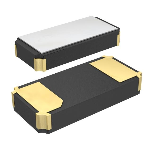

    无源晶振 32.768kHz ±20ppm 70kΩ -40℃~+85℃
FC-135 32.7680KA-R 数据手册
Crystal unit Product Number FC-135R : X1A000141xxxx00 FC-135 : Q13FC1350xxxx00 FC-135 TYPE : Q14FC1350xxxx00 kHz RANGE CRYSTAL UNIT FC-135R FC-135 / FC-135 TYPE •Frequency range : : •External dimensions : •Overtone order : •Applications : FC-135R / FC-135···32.768 kHz FC-135 TYPE···32 kHz to 77.5 kHz 3.2 × 1.5 × 0.80 mm Fundamental Small communications devices Specifications (characteristics) Item Symbol Nominal frequency range Specifications FC-135 FC-135R f_nom 32.768 kHz FC-135 TYPE 32 kHz to 77.5 kHz 32.768 kHz Storage temperature range T_stg -55 C to +125 C Operating temperature range T_use -40 C to +85 C (+105 C) DL 0.5 W (1.0 W Max.) f_tol 20  10-6 Level of drive Frequency tolerance (standard) Turnover temperature Ti +25 C 5 C Parabolic coefficient B -0.04  10-6 / C2 Max. Load capacitance CL 7 pF, 9 pF, 12.5 pF Motional resistance (ESR) R1 50 k Max. 70 k Max. Motional capacitance C1 3.4 fF Typ. 3.4 fF Typ. Shunt capacitance C0 1.0 pF Typ. 1.0 pF Typ. Frequency aging Product name (Standard form) 3  10-6 / year Max. f_age FC-135R 32.768000kHz 12.5 +20.0-20.0 ① ② ③ ④ ①Model ②Frequency ③Load capacitance (pF) External dimensions (Unit:mm) Please specify 70 k to 45 k 3.7 fF to 1.6 fF 1.3 pF to 0.5 pF +25 C, First year ④Frequency tolerance (× 10-6, +25 C) Footprint (Recommended) (Unit:mm) 2.5 0.9 Max. A501J 0.1 #2 1.3 0.65 1.8 1.5±0.1 3.2±0.1 #1 Please contact us about +85 C < T_use Please contact us if you require 1.0W Max. +25 C, DL=0.1 W Please ask for tighter tolerance FC-135R / FC-135 FC-135R / FC-135 1.7 Conditions / Remarks Please contact us about available frequencies. Storage as single product. 0.35 1.0 Internal Connection #1 #2 Do not design any circuit patterns in the shaded area. PROMOTION OF ENVIRONMENTAL MANAGEMENT SYSTEM CONFORMING TO INTERNATIONAL STANDARDS At Seiko Epson, all environmental initiatives operate under the Plan-Do-Check-Action (PDCA) cycle designed to achieve continuous improvements. The environmental management system (EMS) operates under the ISO 14001 environmental management standard. All of our major manufacturing and non-manufacturing sites, in Japan and overseas, completed the acquisition of ISO 14001 certification. ISO 14000 is an international standard for environmental management that was established by the International Standards Organization in 1996 against the background of growing concern regarding global warming, destruction of the ozone layer, and global deforestation. WORKING FOR HIGH QUALITY In order provide high quality and reliable products and services than meet customer needs, Seiko Epson made early efforts towards obtaining ISO9000 series certification and has acquired ISO9001 for all business establishments in Japan and abroad. We have also acquired IATF 16949 certification that is requested strongly by major automotive manufacturers as standard. ►Explanation of the mark that are using it for the catalog IATF 16949 is the international standard that added the sector-specific supplemental requirements for automotive industry based on ISO9001. ►Pb free. ►Complies with EU RoHS directive. *About the products without the Pb-free mark. Contains Pb in products exempted by EU RoHS directive. (Contains Pb in sealing glass, high melting temperature type solder or other.) ►Designed for automotive applications such as Car Multimedia, Body Electronics, Remote Keyless Entry etc. ►Designed for automotive applications related to driving safety (Engine Control Unit, Air Bag, ESC etc ). NOTICE:PLEASE READ CAREFULLY BELOW BEFORE THE USE OF THIS DOCUMENT ©Seiko Epson Corporation 2020 ―――――――――――――――――――――――――――――――――――――――――――――――――――― 1. The content of this document is subject to change without notice. Before purchasing or using Epson products, please contact with sales representative of Seiko Epson Corporation (“Epson”) for the latest information and be always sure to check the latest information published on Epson’s official web sites and resources. 2. This document may not be copied, reproduced, or used for any other purposes, in whole or in part, without Epson’s prior consent. 3. Information provided in this document including, but not limited to application circuits, programs and usage, is for reference purpose only. Epson makes no guarantees against any infringements or damages to any third parties’ intellectual property rights or any other rights resulting from the information. This document does not grant you any licenses, any intellectual property rights or any other rights with respect to Epson products owned by Epson or any third parties. 4. Using Epson products, you shall be responsible for safe design in your products; that is, your hardware, software, and/or systems shall be designed enough to prevent any critical harm or damages to life, health or property, even if any malfunction or failure might be caused by Epson products. In designing your products with Epson products, please be sure to check and comply with the latest information regarding Epson products (including, but not limited to this document, specifications, data sheets, manuals, and Epson’s web site). Using technical contents such as product data, graphic and chart, and technical information, including programs, algorithms and application circuit examples under this document, you shall evaluate your products thoroughly both in stand-alone basis and within your overall systems. You shall be solely responsible for deciding whether to adopt/use Epson products with your products. 5. Epson has prepared this document carefully to be accurate and dependable, but Epson does not guarantee that the information is always accurate and complete. Epson assumes no responsibility for any damages you incurred due to any misinformation in this document. 6. No dismantling, analysis, reverse engineering, modification, alteration, adaptation, reproduction, etc., of Epson products is allowed. 7. Epson products have been designed, developed and manufactured to be used in general electronic applications and specifically designated applications (“Anticipated Purpose”). Epson products are NOT intended for any use beyond the Anticipated Purpose that requires particular quality or extremely high reliability in order to refrain from causing any malfunction or failure leading to critical harm to life and health, serious property damage, or severe impact on society, including, but not limited to listed below (“Specific Purpose”). Therefore, you are strongly advised to use Epson products only for the Anticipated Purpose. Should you desire to purchase and use Epson products for Specific Purpose, Epson makes no warranty and disclaims with respect to Epson products, whether express or implied, including without limitation any implied warranty of merchantability or fitness for any Specific Purpose. Please be sure to contact our sales representative in advance, if you desire Epson products for Specific Purpose: Space equipment (artificial satellites, rockets, etc.)/ Transportation vehicles and their control equipment (automobiles, aircraft, trains, ships, etc.) / Medical equipment/ Relay equipment to be placed on sea floor/ Power station control equipment / Disaster or crime prevention equipment/Traffic control equipment/ Financial equipment Other applications requiring similar levels of reliability as the above 8. Epson products listed in this document and our associated technologies shall not be used in any equipment or systems that laws and regulations in Japan or any other countries prohibit to manufacture, use or sell. Furthermore, Epson products and our associated technologies shall not be used for the purposes of military weapons development (e.g. mass destruction weapons), military use, or any other military applications. If exporting Epson products or our associated technologies, please be sure to comply with the Foreign Exchange and Foreign Trade Control Act in Japan, Export Administration Regulations in the U.S.A (EAR) and other export-related laws and regulations in Japan and any other countries and to follow their required procedures. 9. Epson assumes no responsibility for any damages (whether direct or indirect) caused by or in relation with your non-compliance with the terms and conditions in this document or for any damages (whether direct or indirect) incurred by any third party that you give, transfer or assign Epson products. 10. For more details or other concerns about this document, please contact our sales representative. 11. Company names and product names listed in this document are trademarks or registered trademarks of their respective companies. ©Seiko Epson Corporation 2020 Seiko Epson Corporation
FC-135 32.7680KA-R
物料型号:FC-135R、FC-135 TYPE、FC-135
器件简介:这是由精工爱普生公司生产的kHz范围的晶体单元,符合RoHS标准。
引脚分配:文档中没有提供具体的引脚分配图,但通常这类晶体单元会有2个引脚,分别用于连接电路的输入和输出。
参数特性: - 标称频率范围:FC-135R为32.768kHz,FC-135为32kHz至77.5kHz - 工作温度范围:-40°C至+85°C(0.5W,最大1.0W) - 驱动频率容差:标准情况下为+25°C,5°C - 负载电容:7pF、9pF、12.5pF - 动态电阻(ESR):最大50kΩ至70kΩ - 动态电容:典型值3.4fF至3.7fF至1.6fF - 并联电容:典型值1.0pF至1.3pF至0.5pF - 频率老化:最大±3x10^-6/年
功能详解:文档中没有提供详细的功能解释,但晶体单元通常用于为电子设备提供稳定的时钟信号。
应用信息:适用于小型通信设备。
封装信息:外部尺寸为3.2×1.5×0.80mm。
