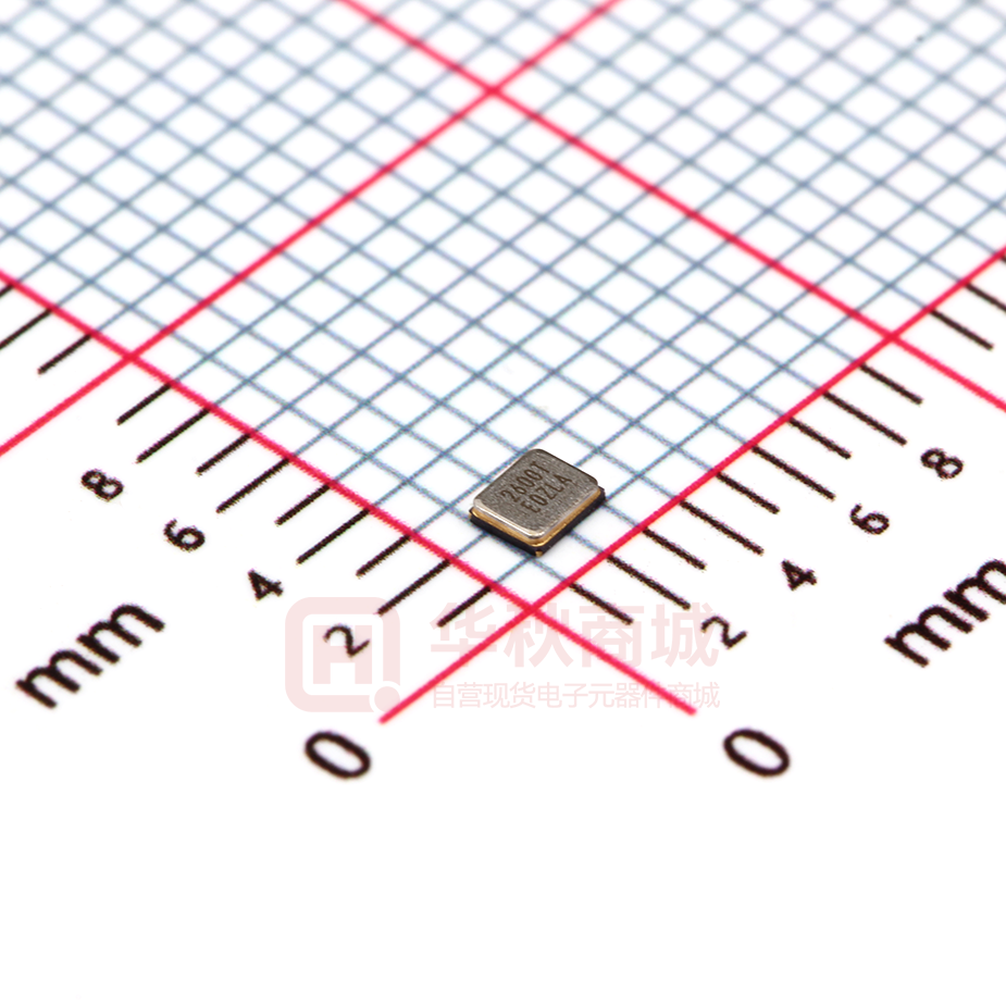

    EPSONTOYOCOM(爱普生)
    SMD2016_4P
    无源晶振 10pF 26MHz ±10ppm 60Ω -40℃~+85℃ SMD2016_4P
Q22FA1280023000 数据手册
MHz Range Crystal unit FA-128 FA-128 26.000000 MHz 10.0 +10.0-10.0 Product name Product Number / Ordering code Q22FA12800230xx Please refer to the 5.Packing information about xx (last 2 digits) Pb free / Complies with EU RoHS directive Reference weight Typ. 7 mg 1.Absolute maximum ratings Parameter Symbol Storage temperature Operating temperature T_stg T_use 2.Specifications(characteristics) Parameter Symbol Nominal frequency Frequency tolerance Frequency Stability over temperature Operating temperature Level of drive Load capacitance Motional resistance (ESR) Motional capacitance Motional inductance Shunt capacitance Frequency aging Min. Typ. Max. Unit -40 -40 - +125 +105 ºC ºC Conditions / Remarks Storage as single product Min. Typ. Max. Unit Conditions / Remarks f_nom f_tol - -10 26.000000 - - +10 MHz x 10-6 Fundamental @+25ºC f_tem -20 - +20 x 10-6 -40ºC to +85ºC T_use DL CL R1 C1 L1 C0 f_age -40 10 - -1 10 2.28 16.48 0.72 - +85 100 - 60 +1 ºC µW pF Ω fF mH pF 3.External dimensions (Unit: mm) x10-6 /yea @+25ºC, First year 4.Footprint(Recommended) (Unit: mm) 2.0±0.1 #3 1.6±0.1 #4 2600M 1.45 E66RA #1 0.5 Max. #2 1.15 0.85 0.65 0.6 Internal connection (TOP VIEW) 0.45 0.5 #2 #1 C 0.2 Min. #3 #4 #4 #1 0.95 #3 #2 #2 and #4 are connected to the cover. (Please connect to ground) 5.Packing information [ 1 ]Product number last 2 digits code (xx) description Q22FA12800230xx Code 01 11 12 14 Condition Any Q'ty vinyl bag(Tape cut) Any Q'ty / Reel 250pcs / Reel 1000pcs / Reel The recommended code is "18" Condition Code 00 18 3000pcs / Reel 5000pcs / Reel 1 Page [ 2 ] Taping specification Subject to EIA-481 & IEC-60286 (1) Tape dimensions TE0804L    Material of the Carrier Tape : PS    Material of the Top Tape : PET+PE Unit: mm 4.0±0.1 MRAKING MRAKING 4.0±0.1 φ0.5±0.05 0.7±0.1 0.25±0.05 2.2±0.1 2.0±0.1 8.0±0.2 +0.1 φ1.5 -0 3.5±0.05 1.75±0.1 10P:40±0.15 1.8±0.1 Direction of unreeling (2) Reel dimensions Center material : PS Material of the Reel : PS φ 180.00 Unit: mm +0 -3 ±1 11.40 2.00 +0.3 -0 φ 60.00 φ 76 φ 160 ± 0.3 9.00 Hφ 3 G φ 21 ± 0.8 2 Page φ 13± 0.2 6.Reflow profile Reflow condition (Follow of JEDEC STD-020D.01) Temperature[C] 300 TP  ;+260C +255C 250 ;+217C Tsmax;+200C TL 200 150 Tsmin;+150C Avg. Ramp-up 3C/sMax. tp;20sto40s tL 60sto150s (+217Cover) Ramp-down 6C/sMax. ts 60sto180s (+150Cto+200C) 100 50 Time +25CtoPeak 0 60 120 180 240 300 360 420 480 540 600 660 720 780 Time[s] 7.Notice · This material is subject to change without notice. · Any part of this material may not be reproduced or duplicated in any form or any means without the written permission of Seiko Epson. · The information about applied data,circuitry, software, usage, etc. written in this material is intended for reference only. Seiko Epson does not assume any liability for the occurrence of customer damage or infringing on any patent or copyright of a third party. This material does not authorize the licensing for any patent or intellectual copyrights. · When exporting the products or technology described in this material, you should comply with the applicable export control laws and regulations and follow the procedures required by such laws and regulations. · You are requested not to use the products (and any technical information furnished, if any) for the development and/or manufacture of weapon of mass destruction or for other military purposes. You are also requested that you would not make the products available to any third party who may use the products for such prohibited purposes. · These products are intended for general use in electronic equipment. When using them in specific applications that require extremely high reliability, such as the applications stated below, you must obtain permission from Seiko Epson in advance. / Space equipment (artificial satellites, rockets, etc.) / Transportation vehicles and related (automobiles, aircraft, trains, vessels, etc.) / Medical instruments to sustain life / Submarine transmitters / Power stations and related / Fire work equipment and security equipment / Traffic control equipment / And others requiring equivalent reliability. · All brands or product names mentioned herein are trademarks and/or registered trademarks of their respective. Contact us http://www5.epsondevice.com/en/contact/ 3 Page
