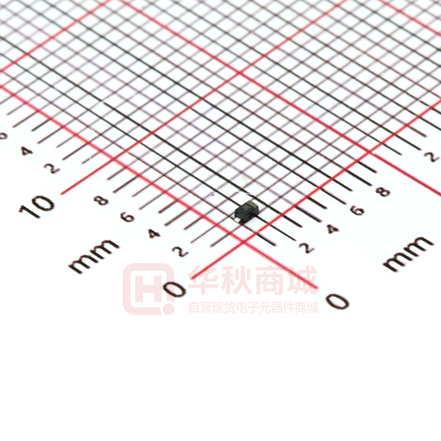

BAS3005B.... Medium Power AF Schottky Diode • Forward current: 0.5 A • Reverse voltage: 30 V • Low capacitance, low reverse current • For high efficiency DC/DC conversion, fast switching, protecting and clamping applications • Pb-free (RoHS compliant) package • Qualified according AEC Q101 BAS3005B-02LRH* BAS3005B-02V  Type Package Configuration Marking BAS3005B-02LRH* BAS3005B-02V TSLP-2-17 SC79 single, leadless single 5B 3 *Preliminary Maximum Ratings at TA = 25 °C, unless otherwise specified Parameter Symbol Diode reverse voltage1) VR RMS reverse voltage VR(RMS) Forward current1) IF Value 30 Unit V 500 Average rectified forward current (50/60Hz, sinus) IFAV 500 Repetitive peak forward current IFRM 3.5 IFSM 5 mA A (tp ≤ 1 ms, D ≤ 0.25) Non-repetitive peak surge forward current (t ≤ 10ms) 150 Junction temperature Tj Operating temperature range Top -55 ...125 Storage temperature Tstg -65 ...150 1 °C 2012-07-02 BAS3005B.... 1For TA > 25°C the derating of VR and IF has to be considered. Please refer to the attached curves. Thermal Resistance Parameter Symbol Value Unit Junction - soldering point1) RthJS ≤ 80 K/W 1For calculation of RthJA please refer to Application Note Thermal Resistance Electrical Characteristics at TA = 25°C, unless otherwise specified Parameter Symbol Values min. typ. max. DC Characteristics Reverse current1) µA IR VR = 5 V - 1 5 VR = 10 V - 2 10 VR = 30 V - 5 25 Forward voltage1) mV VF IF = 1 mA - 200 250 IF = 10 mA - 260 310 IF = 100 mA - 360 410 IF = 200 mA - 410 470 IF = 500 mA - 550 620 - 6 10 AC Characteristics Diode capacitance CT Unit pF VR = 5 V, f = 1 MHz 1Pulsed test: tp = 300 µs; D = 0.01 2 2012-07-02 BAS3005B.... Diode capacitance CT = ƒ (VR) Reverse current IR = ƒ (TA) f = 1MHz VR = Parameter 10 -2 25 A 10 -3 IR CT pF 15 10 -4 10 10 -5 5 10 -6 0 0 5 10 15 20 V 10 -7 0 30 30 V 20 V 10 V 5V 25 50 75 °C 100 VR Forward Voltage VF = ƒ (TA) IF = Parameter 10 -2 0.6 A V 10 -3 0.5 125 °C 500 mA 0.45 VF IR Reverse current IR = ƒ(VR ) TA = Parameter 10 -4 150 TA 85 °C 0.4 0.35 200 mA 0.3 10 -5 0.25 100 mA 0.2 25 °C 0.15 10 -6 10 mA 0.1 0.05 10 -7 0 5 10 15 20 V 0 -50 30 VR 1 mA -25 0 25 50 75 100 °C 150 TA 3 2012-07-02 BAS3005B.... Forward current IF = ƒ (VF) Permissible Reverse voltage VR = ƒ (TA) TA = Parameter tp = Parameter, Duty cycle < 0.01 Device mounted on PCB with Rth = 160 k/W 0 10 35 A 300µs V 100ms IF VRmax 10 -1 25 20 10 -2 15 -40 °C 25 °C 85 °C 125°C 10 -3 DC 10 5 10 -4 0 0.1 0.2 0.3 0.4 V 0 0 0.6 VF 25 50 75 100 °C 150 TA Forward current IF = ƒ (TS ) 600 mA 500 450 IF 400 350 300 250 200 150 100 50 0 0 20 40 60 80 100 120 °C 150 TS 4 2012-07-02 Package SC79 5 BAS3005B.... 2012-07-02 BAS3005B.... Date Code marking for discrete packages with one digit (SCD80, SC79, SC75 1) ) CES-Code Month 2 0 03 2 0 04 2005 2006 2 0 07 2008 2009 2010 2011 2012 2 0 13 2014 01 a p A P a p A P a p A P 02 b q B Q b q B Q b q B Q 03 c r C R c r C R c r C R 04 d s D S d s D S d s D S 05 e t E T e t E T e t E T 06 f u F U f u F U f u F U 07 g v G V g v G V g v G V 08 h x H X h x H X h x H X 09 j y J Y j y J Y j y J Y 10 k z K Z k z K Z k z K Z 11 l 2 L 4 l 2 L 4 l 2 L 4 12 n 3 N 5 n 3 N 5 n 3 N 5 1) New Marking Layout for SC75, implemented at October 2005. . 6 2012-07-02 Package TSLP-2-17 BAS3005B.... Package Outline Top view Bottom view 0.39 +0.01 -0.03 0.6 ±0.05 0.05 MAX. 1 1 0.25 ±0.035 1) 2 1±0.05 0.65 ±0.05 2 0.5 ±0.035 1) Cathode marking 1) Dimension applies to plated terminal Foot Print 0.45 Copper Solder mask 0.375 0.35 0.275 1 0.925 0.3 0.35 0.6 0.275 For board assembly information please refer to Infineon website "Packages" Stencil apertures Marking Layout (Example) BAR90-02LRH Type code Cathode marking Laser marking Standard Packing Reel ø180 mm = 15.000 Pieces/Reel Reel ø330 mm = 50.000 Pieces/Reel (optional) 0.5 Cathode marking 8 1.16 4 0.76 7 2012-07-02 BAS3005B.... Edition 2009-11-16 Published by Infineon Technologies AG 81726 Munich, Germany  2009 Infineon Technologies AG All Rights Reserved. Legal Disclaimer The information given in this document shall in no event be regarded as a guarantee of conditions or characteristics. With respect to any examples or hints given herein, any typical values stated herein and/or any information regarding the application of the device, Infineon Technologies hereby disclaims any and all warranties and liabilities of any kind, including without limitation, warranties of non-infringement of intellectual property rights of any third party. Information For further information on technology, delivery terms and conditions and prices, please contact the nearest Infineon Technologies Office (). Warnings Due to technical requirements, components may contain dangerous substances. For information on the types in question, please contact the nearest Infineon Technologies Office. Infineon Technologies components may be used in life-support devices or systems only with the express written approval of Infineon Technologies, if a failure of such components can reasonably be expected to cause the failure of that life-support device or system or to affect the safety or effectiveness of that device or system. Life support devices or systems are intended to be implanted in the human body or to support and/or maintain and sustain and/or protect human life. If they fail, it is reasonable to assume that the health of the user or other persons may be endangered. 8 2012-07-02

物料型号为BAS3005B,这是一款来自英飞凌的中功率AF肖特基二极管。
以下是其主要信息:
1. 器件简介:该二极管具有以下特性: - 正向电流:0.5 A - 反向电压:30 V - 低电容,低反向电流 - 适用于高效直流/直流转换、快速开关、保护和钳位应用 - Pb(铅)自由(符合RoHS标准)封装 - 通过AEC Q101认证
2. 引脚分配:有两种封装类型: - BAS3005B-02LRH:TSLP-2-17封装,单引脚无引线封装,标记为5B - BAS3005B-02V:SC79封装,单引脚封装,标记为3
3. 参数特性: - 最大反向电压:30 V - 正向电流:500 mA(平均整流正向电流,50/60Hz正弦波) - 重复峰值正向电流(t ≤1ms, D≤0.25):3.5 A - 非重复峰值浪涌正向电流(ts 10ms):5 A - 结温:150 °C - 工作温度范围:-55°C 至 125°C - 存储温度:-65°C 至 150°C
4. 功能详解:二极管的电气特性,包括反向电流和正向电压在不同条件下的值。
5. 应用信息:适用于高效率直流/直流转换器、快速开关、保护和钳位应用。
6. 封装信息:提供了SC79和TSLP-2-17两种封装的详细信息,包括尺寸、标记布局和标准包装。
请注意,文档中还包含了热阻、电气特性等详细技术数据,以及产品标记和日期代码的说明。
