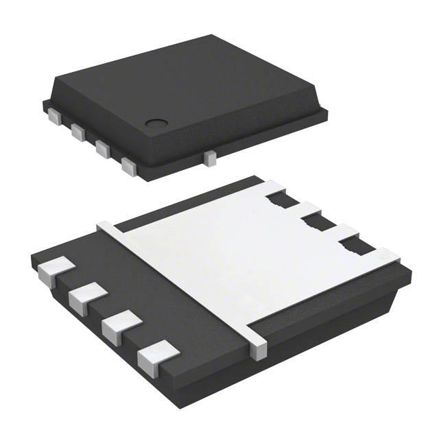

Type BSZ22DN20NS3 G OptiMOSTM3 Power-Transistor Product Summary Features • Optimized for dc-dc conversion • N-channel, normal level VDS 200 V RDS(on),max 225 mW ID 7 A • Excellent gate charge x R DS(on) product (FOM) • Low on-resistance R DS(on) PG-TSDSON-8 • 150 °C operating temperature • Pb-free lead plating; RoHS compliant • Qualified according to JEDEC1) for target application • Halogen-free according to IEC61249-2-21 Type Package Marking BSZ22DN20NS3 G PG-TSDSON-8 22DN20N Maximum ratings, at T j=25 °C, unless otherwise specified Parameter Symbol Conditions Continuous drain current ID Value T C=25 °C 7.0 T C=100 °C 4.9 Unit A Pulsed drain current2) I D,pulse T C=25 °C 28 Avalanche energy, single pulse E AS I D=3.5 A, R GS=25 W 30 mJ Reverse diode dv /dt dv /dt 10 kV/µs Gate source voltage V GS ±20 V Power dissipation P tot 34 W Operating and storage temperature T j, T stg -55 ... 150 °C T C=25 °C IEC climatic category; DIN IEC 68-1 1) 2) 55/150/56 J-STD20 and JESD22 see figure 3 Rev. 2.2 page 1 2011-07-14 BSZ22DN20NS3 G Parameter Values Symbol Conditions Unit min. typ. max. - - 3.7 - - 60 200 - - Thermal characteristics Thermal resistance, junction - case R thJC Thermal resistance, junction - ambient R thJA 6 cm2 cooling area3) K/W Electrical characteristics, at T j=25 °C, unless otherwise specified Static characteristics Drain-source breakdown voltage V (BR)DSS V GS=0 V, I D=1 mA Gate threshold voltage V GS(th) V DS=V GS, I D=13 µA 2 3 4 Zero gate voltage drain current I DSS V DS=160 V, V GS=0 V, T j=25 °C - 0.1 1 V DS=160 V, V GS=0 V, T j=125 °C - 10 100 V µA Gate-source leakage current I GSS V GS=20 V, V DS=0 V - 1 100 nA Drain-source on-state resistance R DS(on) V GS=10 V, I D=3.5 A - 194 225 mW Gate resistance RG - 1.6 - W Transconductance g fs 3.5 7 - S |V DS|>2|I D|R DS(on)max, I D=3.5 A 3) Device on 40 mm x 40 mm x 1.5 mm epoxy PCB FR4 with 6 cm 2 (one layer, 70 µm thick) copper area for drain connection. PCB is vertical in still air. Rev. 2.2 page 2 2011-07-14 BSZ22DN20NS3 G Parameter Values Symbol Conditions Unit min. typ. max. - 320 430 - 24 32 Dynamic characteristics Input capacitance C iss Output capacitance C oss Reverse transfer capacitance C rss - 5.1 - Turn-on delay time t d(on) - 4 - Rise time tr - 4 - Turn-off delay time t d(off) - 6 - Fall time tf - 3 - Gate to source charge Q gs - 1.4 - Gate to drain charge Q gd - 0.8 - Switching charge Q sw - 1.3 - Gate charge total Qg - 4.2 5.6 Gate plateau voltage V plateau - 4.5 - Output charge Q oss - 8 11 nC - - 7 A - - 28 - 1 1.2 V - 70 - ns - 156 V GS=0 V, V DS=100 V, f =1 MHz V DD=100 V, V GS=10 V, I D=3.5 A, R G=1.6 W pF ns Gate Charge Characteristics4) V DD=100 V, I D=3.5 A, V GS=0 to 10 V V DD=100 V, V GS=0 V nC V Reverse Diode Diode continous forward current IS Diode pulse current I S,pulse Diode forward voltage V SD Reverse recovery time t rr Reverse recovery charge Q rr 4) T C=25 °C V GS=0 V, I F=7 A, T j=25 °C V R=100 V, I F=I S, di F/dt =100 A/µs nC See figure 16 for gate charge parameter definition Rev. 2.2 page 3 2011-07-14 BSZ22DN20NS3 G 1 Power dissipation 2 Drain current P tot=f(T C) I D=f(T C); V GS≥10 V 8 40 7 6 30 ID [A] Ptot [W] 5 20 4 3 2 10 1 0 0 0 40 80 120 0 160 40 80 TC [°C] 120 160 TC [°C] 3 Safe operating area 4 Max. transient thermal impedance I D=f(V DS); T C=25 °C; D =0 Z thJC=f(t p) parameter: t p parameter: D =t p/T 102 101 1 µs ID [A] 0.5 ZthJC [K/W] 10 µs 101 100 µs 1 ms 0.2 100 0.1 100 0.05 0.02 10 ms 0.01 single pulse DC 10-1 10-1 10-1 100 101 102 103 VDS [V] Rev. 2.2 10-5 10-4 10-3 10-2 10-1 100 tp [s] page 4 2011-07-14 BSZ22DN20NS3 G 5 Typ. output characteristics 6 Typ. drain-source on resistance I D=f(V DS); T j=25 °C R DS(on)=f(I D); T j=25 °C parameter: V GS parameter: V GS 20 320 280 10 V 5V 15 5.5 V 240 6V 6V 7V RDS(on) [mW] 200 ID [A] 5.5 V 10 8V 10 V 160 120 5V 5 80 4.5 V 40 0 0 0 1 2 3 4 5 0 2 4 VDS [V] 6 8 ID [A] 7 Typ. transfer characteristics 8 Typ. forward transconductance I D=f(V GS); |V DS|>2|I D|R DS(on)max g fs=f(I D); T j=25 °C 16 16 14 14 12 12 10 10 gfs [S] ID [A] parameter: T j 8 8 6 6 4 4 2 150 °C 2 25 °C 0 0 0 2 4 6 8 Rev. 2.2 0 5 10 15 ID [A] VGS [V] page 5 2011-07-14 BSZ22DN20NS3 G 9 Drain-source on-state resistance 10 Typ. gate threshold voltage R DS(on)=f(T j); I D=3.5 A; V GS=10 V V GS(th)=f(T j); V GS=V DS parameter: I D 600 4 3.5 500 130 µA 3 13 µA 2.5 VGS(th) [V] RDS(on) [mW] 400 300 98 % 1.5 typ 200 2 1 100 0.5 0 0 -60 -20 20 60 100 140 180 -60 -20 20 60 100 140 180 Tj [°C] Tj [°C] 11 Typ. capacitances 12 Forward characteristics of reverse diode C =f(V DS); V GS=0 V; f =1 MHz I F=f(V SD) parameter: T j 103 100 Ciss Coss 102 10 IF [A] C [pF] 25 °C 101 150 °C, 98% 1 150 °C 25 °C, 98% Crss 100 0.1 0 40 80 120 160 Rev. 2.2 0 0.5 1 1.5 2 VSD [V] VDS [V] page 6 2011-07-14 BSZ22DN20NS3 G 13 Avalanche characteristics 14 Typ. gate charge I AS=f(t AV); R GS=25 W V GS=f(Q gate); I D=3.5 A pulsed parameter: T j(start) parameter: V DD 10 10 160 V 8 100 V 25 °C 100 °C 1 40 V VGS [V] IAS [A] 6 125 °C 4 2 0.1 0 1 10 100 1000 0 1 2 3 4 5 Qgate [nC] tAV [µs] 15 Drain-source breakdown voltage 16 Gate charge waveforms V BR(DSS)=f(T j); I D=1 mA 230 V GS Qg VBR(DSS) [V] 220 210 V gs(th) 200 190 Q g(th) Q sw Q gs 180 -60 -20 20 60 100 140 Q gate Q gd 180 Tj [°C] Rev. 2.2 page 7 2011-07-14 BSZ22DN20NS3 G Package Outline:PG-TSDSON-8 Rev. 2.2 page 8 2011-07-14 BSZ22DN20NS3 G Published by Infineon Technologies AG 81726 Munich, Germany © 2010 Infineon Technologies AG All Rights Reserved. Legal Disclaimer The information given in this document shall in no event be regarded as a guarantee of conditions or characteristics. With respect to any examples or hints given herein, any typical values stated herein and/or any information regarding the application of the device, Infineon Technologies hereby disclaims any and all warranties and liabilities of any kind, including without limitation, warranties of non-infringement of intellectual property rights of any third party. Information For further information on technology, delivery terms and conditions and prices, please contact the nearest Infineon Technologies Office (www.infineon.com). Warnings Due to technical requirements, components may contain dangerous substances. For information on the types in question, please contact the nearest Infineon Technologies Office. Infineon Technologies components may be used in life-support devices or systems only with the express written approval of Infineon Technologies, if a failure of such components can reasonably be expected to cause the failure of that life-support device or system or to affect the safety or effectiveness of that device or system. Life support devices or systems are intended to be implanted in the human body or to support and/or maintain and sustain Rev. 2.2 page 9 2011-07-14
