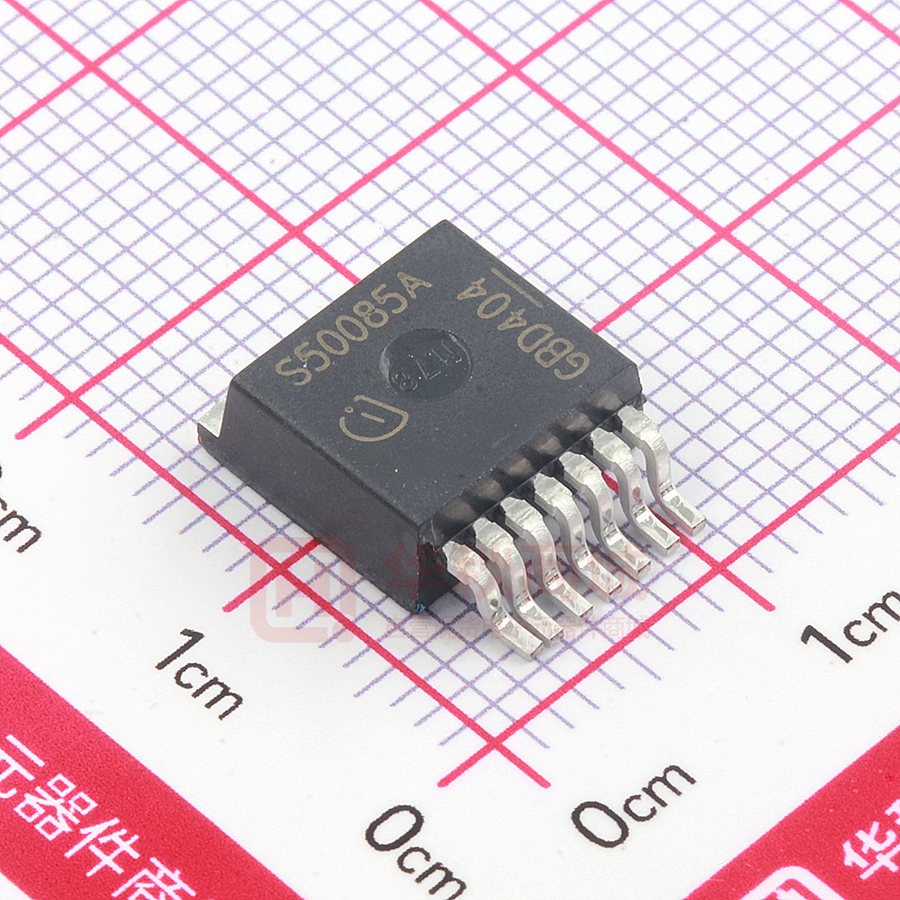

    BTS50085-1TMA是一款高端电源开关,集成了垂直功率场效应管,提供嵌入式保护和诊断功能 TO220-7 5~58V
BTS50085-1TMA 数据手册
PROFET® Data Sheet BTS50085-1TMA Smart Highside High Current Power Switch Product Summary Overvoltage protection Output clamp Operating voltage On-state resistance Load current (ISO) Short circuit current limitation Current sense ratio Reversave • Reverse battery protection by self turn on of power MOSFET Features • Overload protection • Current limitation • Short circuit protection • Over temperature protection • Over voltage protection (including load dump) • Clamp of negative voltage at output • Fast deenergizing of inductive loads 1) • Low ohmic inverse current operation • Diagnostic feedback with load current sense • Open load detection via current sense • Loss of Vbb protection2) • Electrostatic discharge (ESD) protection • Green product (RoHS compliant) • AEC qualified Vbb(AZ) 70 VON(CL) 62 Vbb(on) 5.0 ... 58 RON IL(ISO) IL(SC) IL : IIS V V V 9 mΩ 44 A 90 A 13 000 PG-TO220-7-4 7 Application 1 SMD • Power switch with current sense diagnostic feedback for up to 48 V DC grounded loads • Most suitable for loads with high inrush current like lamps and motors; all types of resistive and inductive loads • Replaces electromechanical relays, fuses and discrete circuits General Description N channel vertical power FET with charge pump, current controlled input and diagnostic feedback with load current sense, integrated in Smart SIPMOS chip on chip technology. Providing embedded protection functions. 4 & Tab R Voltage source Voltage sensor Overvoltage Current Gate protection limit protection Charge pump Level shifter Rectifier 3 IN Logic ESD I IN Limit for unclamped ind. loads Output Voltage detection + V bb bb OUT 1,2,6,7 IL Current Sense Load Temperature sensor IS  PROFET I IS Load GND 5 VIN V IS R IS Logic GND 1 ) 2) With additional external diode. Additional external diode required for energized inductive loads (see page 9). Infineon Technologies AG Page 1 2008-Jan-24 Data Sheet BTS50085-1TMA Pin Symbol Function 1 OUT O Output to the load. The pins 1,2,6 and 7 must be shorted with each other 3 especially in high current applications! ) 2 OUT O Output to the load. The pins 1,2,6 and 7 must be shorted with each other especially in high current applications! 3) 3 IN I Input, activates the power switch in case of short to ground 4 Vbb + Positive power supply voltage, the tab is electrically connected to this pin. In high current applications the tab should be used for the Vbb connection 4 instead of this pin ). 5 IS S Diagnostic feedback providing a sense current proportional to the load current; zero current on failure (see Truth Table on page 7) 6 OUT O Output to the load. The pins 1,2,6 and 7 must be shorted with each other especially in high current applications! 3) 7 OUT O Output to the load. The pins 1,2,6 and 7 must be shorted with each other especially in high current applications! 3) Maximum Ratings at Tj = 25 °C unless otherwise specified Parameter Supply voltage (over voltage protection see page 4) Supply voltage for full short circuit protection, (EAS limitation see diagram on page 10) Tj,start =-40 ...+150°C: Load current (short circuit current, see page 5) Load dump protection VLoadDump = UA + Vs, UA = 13.5 V RI5) = 2 Ω, RL = 0.23 Ω, td = 200 ms, IN, IS = open or grounded Operating temperature range Storage temperature range Power dissipation (DC), TC ≤ 25 °C Inductive load switch-off energy dissipation, single pulse Vbb = 12V, Tj,start = 150°C, TC = 150°C const., IL = 20 A, ZL = 6 mH, 0 Ω, see diagrams on page 10 Electrostatic discharge capability (ESD) Symbol Vbb Vbb Values 62 58 Unit V V self-limited A 80 V Tj Tstg Ptot -40 ...+150 -55 ...+150 170 °C EAS 1.2 J VESD 4.0 kV +15 , -250 +15 , -250 mA IL VLoad dump6) W Human Body Model acc. MIL-STD883D, method 3015.7 and ESD assn. std. S5.1-1993, C = 100 pF, R = 1.5 kΩ Current through input pin (DC) Current through current sense status pin (DC) IIN IIS see internal circuit diagrams on page 7 and 8 3) 4) 5) 6) Not shorting all outputs will considerably increase the on-state resistance, reduce the peak current capability and decrease the current sense accuracy Otherwise add up to 0.7 mΩ (depending on used length of the pin) to the RON if the pin is used instead of the tab. RI = internal resistance of the load dump test pulse generator. VLoad dump is setup without the DUT connected to the generator per ISO 7637-1 and DIN 40839. Infineon Technologies AG Page 2 2008-Jan-24 Data Sheet BTS50085-1TMA Thermal Characteristics Parameter and Conditions Symbol 7 chip - case: RthJC ) junction - ambient (free air): RthJA SMD version, device on PCB 8): Thermal resistance min ---- Values typ max -- 0.75 60 -33 -- Unit K/W Electrical Characteristics Parameter and Conditions Symbol at Tj = -40 ... +150 °C, Vbb = 24 V unless otherwise specified Load Switching Capabilities and Characteristics On-state resistance (Tab to pins 1,2,6,7, see measurement circuit page 7) IL = 20 A, Tj = 25 °C: RON VIN = 0, IL = 20 A, Tj = 150 °C: IL = 80 A, Tj = 150 °C: Vbb =6V, IL =20A, Tj =150°C: RON(Static) 9) Nominal load current (Tab to pins 1,2,6,7) IL(ISO) 10) ISO 10483-1/6.7: VON = 0.5 V, Tc = 85 °C Nominal load current 9), device on PCB 8) TA = 85 °C, Tj ≤ 150 °C VON ≤ 0.5 V, IL(NOM) Maximum load current in resistive range (Tab to pins 1,2,6,7) VON = 1.8 V, Tc = 25 °C: IL(Max) see diagram on page 13 VON = 1.8 V, Tc = 150 °C: 11) Turn-on time IIN to 90% VOUT: ton Turn-off time IIN to 10% VOUT: toff RL = 1 Ω , Tj =-40...+150°C Slew rate on 11) (10 to 30% VOUT ) dV/dton RL = 1 Ω Slew rate off 11) (70 to 40% VOUT ) -dV/dtoff RL = 1 Ω Values min typ max -- Unit 9 17 17 22 -- mΩ 38 7.2 14.6 -17 44 9.9 11.1 -- A 185 105 50 30 --- --- A --- 400 110 µs 1.0 1.5 2.2 V/µs 1.1 1.9 2.6 V/µs A 7) Thermal resistance RthCH case to heatsink (about 0.5 ... 0.9 K/W with silicone paste) not included! Device on 50mm*50mm*1.5mm epoxy PCB FR4 with 6cm2 (one layer, 70µm thick) copper area for Vbb connection. PCB is vertical without blown air. 9) not subject to production test, specified by design 10) TJ is about 105°C under these conditions. 11) See timing diagram on page 14. ) 8 Infineon Technologies AG Page 3 2008-Jan-24 Data Sheet BTS50085-1TMA Parameter and Conditions Symbol at Tj = -40 ... +150 °C, Vbb = 24 V unless otherwise specified Inverse Load Current Operation On-state resistance (Pins 1,2,6,7 to pin 4) VbIN = 12 V, IL = - 20 A Tj = 25 °C: RON(inv) see diagram on page 10 Tj = 150 °C: Nominal inverse load current (Pins 1,2,6,7 to Tab) IL(inv) VON = -0.5 V, Tc = 85 °C Drain-source diode voltage (Vout > Vbb) -VON IL = - 20 A, IIN = 0, Tj = +150°C Values min typ max -- Unit 9 17 -- mΩ 50 7.2 14.6 60 -- 0.6 0.7 mV Vbb(on) VbIN(u) 5.0 1.5 -3.0 58 4.5 V V VbIN(ucp) VbIN(Z) 3.0 68 70 --- 4.5 -72 15 25 6.0 --25 50 V V A Operating Parameters Operating voltage (VIN = 0) 12) Under voltage shutdown 13)14) Under voltage start of charge pump see diagram page 15 Over voltage protection 15) Tj =-40°C: Ibb = 15 mA Tj = 25...+150°C: Standby current Tj =-40...+25°C: IIN = 0, Vbb=35V Tj = 150°C: Ibb(off) µA ) If the device is turned on before a V -decrease, the operating voltage range is extended down to VbIN(u). bb For the voltage range 0..58 V the device provides embedded protection functions against overtemperature and short circuit. 13) not subject to production test, specified by design 14) VbIN = Vbb - VIN see diagram on page 15. When VbIN increases from less than VbIN(u) up to VbIN(ucp) = 5 V (typ.) the charge pump is not active and VOUT ≈Vbb - 3 V. 15) See also VON(CL) in circuit diagram on page 9. 12 Infineon Technologies AG Page 4 2008-Jan-24 Data Sheet BTS50085-1TMA Parameter and Conditions Symbol at Tj = -40 ... +150 °C, Vbb = 24 V unless otherwise specified Protection Functions16) Short circuit current limit (Tab to pins 1,2,6,7) VON = 24 V, time until shutdown max. 300 µs Tc =-40°C: see page 8 and 13 Tc =25°C: Tc =+150°C: Short circuit shutdown delay after input current positive slope, VON > VON(SC) 17) (pin 4 to pins 1,2,6,7) Thermal overload trip temperature Thermal hysteresis --50 90 90 80 180 --- A td(SC) 80 -- 350 µs VON(CL) 62 65 72 V VON(SC) Tjt ∆Tjt -150 -- 6 -10 ---- V °C K -- -- 42 V -- 8.8 -- 10.5 20 mΩ 90 120 135 Ω 105 125 150 Reverse Battery Reverse battery voltage 18) -Vbb On-state resistance (Pins 1,2,6,7 to pin 4) Tj = 25 °C: RON(rev) Vbb = -12V, VIN = 0, IL = - 20 A, RIS = 1 kΩ Tj = 150 °C: Integrated resistor in Vbb line Tj = 25 C: Tj =150°C: Unit IL(SC) IL(SC) IL(SC) min. value valid only if input "off-signal" time exceeds 30 µs Output clamp (inductive load switch off) at VOUT = Vbb - VON(CL) (e.g. over voltage) IL= 40 mA Short circuit shutdown detection voltage 17) Values min typ max Rbb 16 ) Integrated protection functions are designed to prevent IC destruction under fault conditions described in the data sheet. Fault conditions are considered as “outside” normal operating range. Protection functions are not designed for continuous repetitive operation. 17) not subject to production test, specified by design. 18) The reverse load current through the intrinsic drain-source diode has to be limited by the connected load (as it is done with all polarity symmetric loads). Note that under off-conditions (IIN = IIS = 0) the power transistor is not activated. This results in raised power dissipation due to the higher voltage drop across the intrinsic drain-source diode. The temperature protection is not active during reverse current operation! To reduce the power dissipation at the integrated Rbb resistor an input resistor is recommended as described on page 9. Infineon Technologies AG Page 5 2008-Jan-24 Data Sheet BTS50085-1TMA Parameter and Conditions Symbol at Tj = -40 ... +150 °C, Vbb = 24 V unless otherwise specified Diagnostic Characteristics Current sense ratio, static on-condition, kILIS = IL : IIS,19 VON < 1.5 V ), VIS 4.0 V see diagram on page 12 IL = 80 A,Tj =-40°C: kILIS Tj =25°C: Tj =150°C: IL = 20 A,Tj =-40°C: Tj =25°C: Tj =150°C: IL = 10 A,Tj =-40°C: Tj =25°C: Tj =150°C: IL = 4 A,Tj =-40°C: Tj =25°C: Tj =150°C: IIN = 0, IIS=0 (e.g. during deenergizing of inductive loads): Values min typ max Unit 11 400 11 400 11 000 11 000 11 000 11 000 10 500 10 500 11 000 9 000 10 000 10 800 -- 13 000 13 000 13 000 13 000 13 000 13 000 13 000 13 000 13 000 13 000 13 000 13 000 -- 15 400 14 600 14 200 16 000 15 000 14 500 17 000 15 500 15 000 22 000 18 500 16 000 -- IIS,lim 6.5 -- -- mA IIN = 0 IIS(LL) -- -- 0.5 µA VIN = 0, IL < 0: IIS(LH) Current sense over voltage protection Tj =-40°C: VbIS(Z) Ibb = 15 mA Tj = 25...+150°C: 20) Current sense settling time ts(IS) -68 70 -- 2 -72 -- 65 --500 µs Input Input and operating current (see diagram page 13) IIN(on) -- 0.8 1.5 mA -- -- 80 µA Sense current saturation Current sense leakage current V IN grounded (VIN = 0) Input current for turn-off 21) IIN(off) 19) If VON is higher, the sense current is no longer proportional to the load current due to sense current saturation, see IIS,lim . 20) not subject to production test, specified by design 21) We recommend the resistance between IN and GND to be less than 0.5 kΩ for turn-on and more than 500kΩ for turn-off. Consider that when the device is switched off (IIN = 0) the voltage between IN and GND reaches almost Vbb. Infineon Technologies AG Page 6 2008-Jan-24 Data Sheet BTS50085-1TMA Truth Table Input current Output Current Sense level level L H L H IIS 0 nominal H H IIS, lim H H 0 L H L H L H L H L L L L L H H 23 Z ) H L 0 0 0 0 0 22 VON(Fold back) if VON>VON(SC), shutdown will occure L = "Low" Level H = "High" Level Over temperature reset by cooling: Tj < Tjt (see diagram on page 15) Short circuit to GND: Shutdown remains latched until next reset via input (see diagram on page 14) Terms RON measurement layout I bb 4 VbIN l ≤ 5.5mm VON Vbb IL V 3 bb IN RIN V OUT PROFET IS 5 IN I IN 1,2,6,7 VbIS V IS I IS Vbb force Out Force Sense contacts contacts (both out pins parallel) VOUT DS R IS Typical RON for SMD version is about 0.2 mΩ less than straight leads due to l ≈ 2 mm Two or more devices can easily be connected in parallel to increase load current capability. ) Low ohmic short to Vbb may reduce the output current IL and can thus be detected via the sense current IIS. ) Power Transistor "OFF", potential defined by external impedance. 22 23 Infineon Technologies AG Page 7 2008-Jan-24 Data Sheet BTS50085-1TMA Input circuit (ESD protection) Current sense status output V bb ZD V Vbb R bb R bb V Z,IS ZD Z,IN V bIN IS IN IIS I R IN V IN When the device is switched off (IIN = 0) the voltage between IN and GND reaches almost Vbb. Use a bipolar or MOS transistor with appropriate breakdown voltage as driver. VZ,IN = 74 V (typ). Short circuit detection Fault Condition: VON > VON(SC) (6 V typ.) and t> td(SC) (80 ...300 µs). VIS IS VZ,IS = 74 V (typ.), RIS = 1 kΩ nominal (or 1 kΩ /n, if n devices are connected in parallel). IS = IL/kilis can be driven only by the internal circuit as long as Vout - VIS > 5 V. If you want measure load currents up to IL(M), RIS Vbb - 5 V . should be less than IL(M) / Kilis Note: For large values of RIS the voltage VIS can reach almost Vbb. See also over voltage protection. If you don't use the current sense output in your application, you can leave it open. Inductive and over voltage output clamp + Vbb VZ1 + Vbb V VON ON OUT OUT Logic unit PROFET Short circuit detection IS V OUT VON is clamped to VON(Cl) = 62 V typ Infineon Technologies AG Page 8 2008-Jan-24 Data Sheet BTS50085-1TMA Over voltage protection of logic part + Vbb V R IN IN Provide a current path with load current capability by using a diode, a Z-diode, or a varistor. (VZL < 70 V or VZb < 42 V if RIN=0). For higher clamp voltages currents at IN and IS have to be limited to 250 mA. R bb Z,IN V Z,IS Vbb disconnect with energized inductive load Logic V OUT Version a: PROFET IS R IS V bb V V Z,VIS RV IN bb PROFET OUT Signal GND Rbb = 120 Ω typ., VZ,IN = VZ,IS = 74 V typ., RIS = 1 kΩ nominal. Note that when over voltage exceeds 79 V typ. a voltage above 5V can occur between IS and GND, if RV, VZ,VIS are not used. Reverse battery protection - Vbb IS V ZL Version b: R bb V IN OUT R IN Vbb bb IN PROFET OUT Power Transistor Logic IS IS DS D RIS RL V Zb RV Signal GND Power GND Note that there is no reverse battery protection when using a diode without additional Z-diode VZL, VZb. RV ≥ 1 kΩ, RIS = 1 kΩ nominal. Add RIN for reverse battery protection in applications with Vbb above 16V18); Version c: Sometimes a necessary voltage clamp is given by non inductive loads RL connected to the same 1 1 0.1A 1 switch and eliminates the need of clamping circuit: + + = if DS recommended value: RIN RIS RV |Vbb| - 12V 1 0.1A is not used (or = if DS is used). RIN |Vbb| - 12V V Vbb To minimize power dissipation at reverse battery bb RL operation, the overall current into the IN and IS pin OUT IN should be about 120mA. The current can be provided PROFET by using a small signal diode D in parallel to the input switch, by using a MOSFET input switch or by proper IS adjusting the current through RIS and RV. Infineon Technologies AG Page 9 2008-Jan-24 Data Sheet BTS50085-1TMA Inverse load current operation Maximum allowable load inductance for a single switch off L = f (IL ); Tj,start = 150°C, Vbb = 40 V, RL = 0 Ω Vbb V bb - IL IN + PROFET OUT 10000 V OUT + IS - IIS V IN V IS - R IS 1000 The device is specified for inverse load current operation (VOUT > Vbb > 0V). The current sense feature is not available during this kind of operation (IIS = 0). With IIN = 0 (e.g. input open) only the intrinsic drain source diode is conducting resulting in considerably increased power dissipation. If the device is switched on (VIN = 0), this power dissipation is decreased to the much lower value RON(INV) * I2 (specifications see page 4). Note: Temperature protection during inverse load current operation is not possible! Inductive load switch-off energy dissipation 100 10 1 10 100 1000 L [µH] I [A] E bb E AS V Externally adjustable current limit ELoad bb i L(t) V bb IN PROFET OUT IS I IN ZL RIS L { RL EL ER If the device is conducting, the sense current can be used to reduce the short circuit current and allow higher lead inductance (see diagram above). The device will be turned off, if the threshold voltage of T2 is reached by IS*RIS . After a delay time defined by RV*CV T1 will be reset. The device is turned on again, the short circuit current is defined by IL(SC) and the device is shut down after td(SC) with latch function. Vbb Energy stored in load inductance: V bb 2 EL = 1/2·L·I L IN While demagnetizing load inductance, the energy dissipated in PROFET is Rload with an approximate solution for RL > 0 Ω: Infineon Technologies AG ln (1+ |V OUT IS RV EAS= Ebb + EL - ER= ∫ VON(CL)·iL(t) dt, IL· L EAS= (V + |VOUT(CL)|) 2·RL bb PROFET IN Signal IL·RL OUT(CL)| ) Page 10 T1 Signal GND CV T2 R IS Power GND 2008-Jan-24 Data Sheet BTS50085-1TMA Options Overview Type BTS50085-1TMA Over temperature protection with hysteresis Tj >150 °C, latch function24) Tj >150 °C, with auto-restart on cooling Short circuit to GND protection X switches off when VON>6 V typ. (when first turned on after approx. 180 µs) X Over voltage shutdown - X Output negative voltage transient limit to Vbb - VON(CL) to VOUT = -15 V typ X 25 X ) ) Latch except when V -V bb OUT < VON(SC) after shutdown. In most cases VOUT = 0 V after shutdown (VOUT ≠ 0 V only if forced externally). So the device remains latched unless Vbb < VON(SC) (see page 5). No latch between turn on and td(SC). 25) Can be "switched off" by using a diode DS (see page 8) or leaving open the current sense output. 24 Infineon Technologies AG Page 11 2008-Jan-24 Data Sheet BTS50085-1TMA Characteristics Current sense ratio: KILIS = f(IL), Tj= 25°C Current sense versus load current: IIS = f(IL), TJ= -40 ... +150 °C IIS [mA] 20000 7 6 18000 5 16000 max 4 max 14000 typ 3 min 12000 2 min 10000 1 0 8000 0 20 40 60 80 0 20 40 60 80 IL [A] kilis IL [A] Current sense ratio: KILIS = f(IL), Tj= -40°C kilis Current sense ratio: KILIS = f(IL), Tj= 150°C kilis 24000 20000 22000 20000 18000 18000 16000 max 16000 max 14000 typ 14000 typ 12000 min 10000 12000 min 8000 0 20 40 60 80 10000 0 20 40 60 80 IL [A] IL [A] Infineon Technologies AG Page 12 2008-Jan-24 Data Sheet BTS50085-1TMA Typ. current limitation characteristic IL = f (VON, Tj ) Typ. input current IIN = f (VbIN), VbIN = Vbb - VIN IIN [mA] IL [A] 400 1.6 350 1.4 300 1.2 VON>V ON(SC) only for t < t d(SC) (otherwise immediate shutdown) 250 1.0 200 0.8 150 0.6 0.4 100 T j = -40°C 150°C 25°C 0.2 50 0 0 0 VON(FB)5(Fold Back) 10 15 20 VON [V] 0 20 40 60 80 VbIN [V] In case of VON > VON(SC) (typ. 6 V) the device will be switched off by internal short circuit detection. Typ. on-state resistance RON = f (Vbb, Tj ); IL = 20 A; VIN = 0 RON [mOhm] 18 static dynamic 16 14 Tj = 150°C 12 85°C 10 25°C -40°C 8 6 4 0 5 10 15 40 Vbb [V] Infineon Technologies AG Page 13 2008-Jan-24 Data Sheet BTS50085-1TMA Timing diagrams Figure 2c: Switching an inductive load: Figure 1a: Switching a resistive load, change of load current in on-condition: IIN IIN VOUT 90% dV/dtoff t on dV/dton t off 10% IL tslc(IS) Load 1 IIS VOUT IL t slc(IS) Load 2 IIS t tson(IS) t t soff(IS) The sense signal is not valid during a settling time after turn-on/off and after change of load current. Figure 3d: Short circuit: shut down by short circuit detection, reset by IIN = 0. Figure 2b: Switching motors and lamps: IIN IIN IL IL(SCp) VOUT td(SC) IIL IIS VOUT>>0 VOUT=0 t IIS t Shut down remains latched until next reset via input. Sense current saturation can occur at very high inrush currents (see IIS,lim on page 6). Infineon Technologies AG Page 14 2008-Jan-24 Data Sheet BTS50085-1TMA Figure 4e: Overtemperature Reset if Tj
