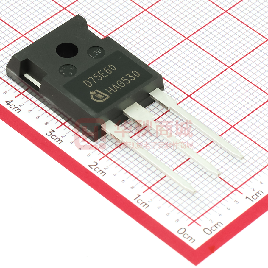

IDW75E60 Fast Switching Emitter Controlled Diode Features:  600V EmCon technology  Fast recovery  Soft switching  Low reverse recovery charge  Low forward voltage  175°C junction operating temperature  Easy paralleling  Pb-free lead plating; RoHS compliant  Complete product spectrum and PSpice Models: http://www.infineon.com/emcon/ Datasheet IDW75E60 Applications:  Welding  Motor drives PG-TO247-3 Type VRRM IF VF,Tj=25°C Tj,max Marking Package IDW75E60 600V 75A 1.65V 175C D75E60 PG-TO247-3 Maximum Ratings Parameter Symbol Repetitive peak reverse voltage VRRM Value 600 Unit V Continuous forward current TC = 25C IF TC = 90C 120 82 A 75 TC = 100C Surge non repetitive forward current TC = 25C, tp = 10 ms, sine halfwave Maximum repetitive forward current TC = 25C, tp limited by tj,max, D = 0.5 IFSM 220 A IFRM 225 A Power dissipation TC = 25C Ptot TC = 90C 300 170 150 TC = 100C Operating junction temperature Tj -40…+175 Storage temperature Tstg -55...+150 Soldering temperature 1.6mm (0.063 in.) from case for 10 s TS IFAG IPC TD VLS W 1 °C 260 Rev. 2.2 20.09.2013 IDW75E60 Thermal Resistance Parameter Symbol Conditions Max. Value Unit RthJC 0.5 K/W RthJA 40 Characteristic Thermal resistance, junction – case Thermal resistance, junction – ambient Electrical Characteristic, at Tj = 25 C, unless otherwise specified Parameter Symbol Conditions Value min. typ. max. 600 - - T j =2 5 C - 1.65 2.0 T j =1 7 5 C - 1.65 - T j =2 5 C - - 40 T j =1 7 5 C - - 2500 Unit Static Characteristic Collector-emitter breakdown voltage VRRM IR=0.25mA Diode forward voltage VF I F = 75 A Reverse leakage current IR V A V R = 6 00 V Dynamic Electrical Characteristics Diode reverse recovery time trr T j =2 5 C - 121 - ns Diode reverse recovery charge Qrr V R = 4 00 V , I F = 7 5 A, - 2.4 - µC Diode peak reverse recovery current Irr dI F / dt = 1 46 0 A/ µs - 38.5 - A Diode peak rate of fall of reverse recovery current during t b dI r r / d t - 921 - A/µs Diode reverse recovery time trr T j =1 2 5 C - 155 - ns Diode reverse recovery charge Qrrm V R = 4 00 V , I F = 7 5 A, - 4.4 - µC Diode peak reverse recovery current Irr dI F / dt = 1 46 0 A/ µs - 46.6 - A Diode peak rate of fall of reverse recovery current during t b dI r r / d t - 960 - A/µs Diode reverse recovery time trr T j =1 7 5 C - 182 - ns Diode reverse recovery charge Qrrm V R = 4 00 V , I F = 7 5 A, - 5.8 - µC Diode peak reverse recovery current Irr dI F / dt = 1 46 0 A/ µs - 56.2 - A Diode peak rate of fall of reverse recovery current during t b dI r r / d t - 1013 - A/µs IFAG IPC TD VLS 2 Rev. 2.2 20.09.2013 IDW75E60 300W 120A IF, FORWARD CURRENT Ptot, POWER DISSIPATION 250W 200W 150W 100W 90A 60A 30A 50W 0W 25°C 50°C 75°C 100°C 125°C 0A 25°C 150°C TC, CASE TEMPERATURE Figure 1. Power dissipation as a function of case temperature (Tj  175C) 200A 125°C TC, CASE TEMPERATURE Figure 2. Diode forward current as a function of case temperature (Tj  175C) TJ=25°C IF=150A 2.0V VF, FORWARD VOLTAGE 175°C IF, FORWARD CURRENT 75°C 150A 100A 50A 75A 1.5V 37.5A 1.0V 0.5V 0.0V 0°C 0A 0V 1V 2V VF, FORWARD VOLTAGE Figure 3. Typical diode forward current as a function of forward voltage IFAG IPC TD VLS 50°C 100°C 150°C TJ, JUNCTION TEMPERATURE Figure 4. Typical diode forward voltage as a function of junction temperature 3 Rev. 2.2 20.09.2013 IDW75E60 trr, REVERSE RECOVERY TIME TJ=175°C 150ns 100ns TJ=25°C 50ns 0ns 1000A/µs Qrr, REVERSE RECOVERY CHARGE 5µC 200ns 4µC 3µC 2µC T J=25°C 1µC 0µC 1000A/µs 1500A/µs diF/dt, DIODE CURRENT SLOPE Figure 5. Typical reverse recovery time as a function of diode current slope (VR=400V, IF=75A, Dynamic test circuit in Figure E) T J =175°C T J=175°C 1500A/µs diF/dt, DIODE CURRENT SLOPE Figure 6. Typical reverse recovery charge as a function of diode current slope (VR = 400V, IF = 75A, Dynamic test circuit in Figure E) -1200A/µs T J=175°C dirr/dt, DIODE PEAK RATE OF FALL OF REVERSE RECOVERY CURRENT Irr, REVERSE RECOVERY CURRENT 60A -1000A/µs 50A 40A T J =25°C 30A 20A 10A 1000A/µs 1500A/µs diF/dt, DIODE CURRENT SLOPE Figure 7. Typical reverse recovery current as a function of diode current slope (VR = 400V, IF = 75A, Dynamic test circuit in Figure E) IFAG IPC TD VLS -800A/µs -600A/µs -400A/µs -200A/µs 0A/µs 1000A/µs 0A T J=25°C 1500A/µs diF/dt, DIODE CURRENT SLOPE Figure 8. Typical diode peak rate of fall of reverse recovery current as a function of diode current slope (VR=400V, IF=75A, Dynamic test circuit in Figure E) 4 Rev. 2.2 20.09.2013 ZthJC, TRANSIENT THERMAL IMPEDANCE IDW75E60 D=0.5 -1 10 K/W 0.2 0.1 0.05 0.02 0.01 -2 R,(K/W) 0.0556 0.1757 0.12374 0.12192 0.02305 R1 , (s) 0.1495 0.02797 3.623 E-3 3.276 E-4 2.635 E-5 R2 10 K/W C 1 =  1 /R 1 C 2 =  2 /R 2 single pulse 1µs 10µs 100µs 1ms 10ms 100ms tP, PULSE WIDTH Figure 9. Diode transient thermal impedance as a function of pulse width (D=tP/T) IFAG IPC TD VLS 5 Rev. 2.2 20.09.2013 IDW75E60 IFAG IPC TD VLS 6 Rev. 2.2 20.09.2013 IDW75E60 Published by Infineon Technologies AG 81726 Munich, Germany © 2013 Infineon Technologies AG All Rights Reserved. Legal Disclaimer The information given in this document shall in no event be regarded as a guarantee of conditions or characteristics. With respect to any examples or hints given herein, any typical values stated herein and/or any information regarding the application of the device, Infineon Technologies hereby disclaims any and all warranties and liabilities of any kind, including without limitation, warranties of non-infringement of intellectual property rights of any third party. Information For further information on technology, delivery terms and conditions and prices, please contact the nearest Infineon Technologies Office (www.infineon.com). Warnings Due to technical requirements, components may contain dangerous substances. For information on the types in question, please contact the nearest Infineon Technologies Office. The Infineon Technologies component described in this Data Sheet may be used in life-support devices or systems and/or automotive, aviation and aerospace applications or systems only with the express written approval of Infineon Technologies, if a failure of such components can reasonably be expected to cause the failure of that life-support, automotive, aviation and aerospace device or system or to affect the safety or effectiveness of that device or system. Life support devices or systems are intended to be implanted in the human body or to support and/or maintain and sustain and/or protect human life. If they fail, it is reasonable to assume that the health of the user or other persons may be endangered. IFAG IPC TD VLS 7 Rev. 2.2 20.09.2013
