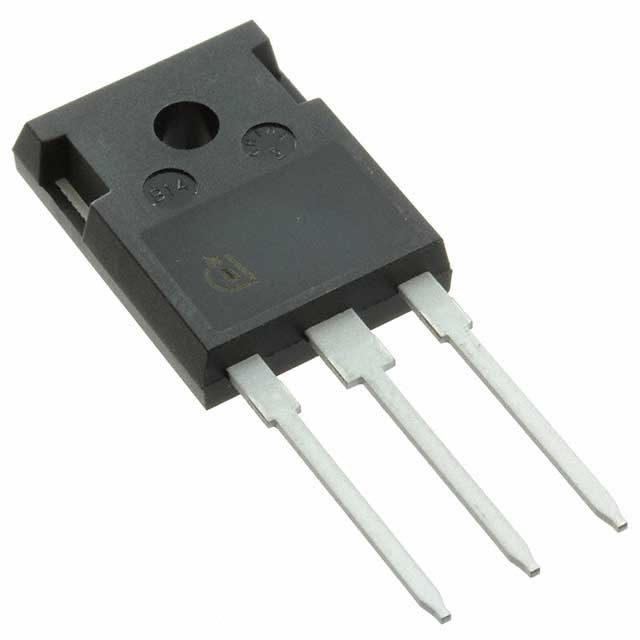

IKW50N65SS5 HybridCoolSiCTMIGBT TRENCHSTOPTM5S5IGBTco-packedwithfull-rated6thgeneration CoolSiCTMSchottkybarrierdiode  FeaturesandBenefits: C •Ultra-lowswitchinglossesduetothecombinationof TRENCHSTOPTM5andCoolSiCTMtechnology •Verylowon-statelosses •Benchmarkefficiencyinhardswitchingtopologies •Plug-and-playreplacementofpuresilicondevices •Maximumjunctiontemperature175°C •QualifiedaccordingtoJEDECfortargetapplications •Pb-freeleadplating;RoHScompliant •CompleteproductspectrumandPSpicemodels: http://www.infineon.com/igbt/ G E PotentialApplications: •IndustrialPowerSupplies -IndustrialSMPS -IndustrialUPS •EnergyGeneration -SolarStringInverter •EnergyDistribution -EnergyStorage •Infrastructure–Charge -Charger 1 2 3 ProductValidation: Qualifiedforapplicationslistedabovebasedonthetest conditionsintherelevanttestsofJEDEC20/22 Packagepindefinition: •Pin1-gate •Pin2&backside-collector •Pin3-emitter KeyPerformanceandPackageParameters Type IKW50N65SS5 Datasheet www.infineon.com VCE IC VCEsat,Tvj=25°C Tvjmax Marking Package 650V 50A 1.35V 175°C K50ESS5 PG-TO247-3 PleasereadtheImportantNoticeandWarningsattheendofthisdocument V2.1 2020-07-27 IKW50N65SS5 HybridCoolSiCTMIGBT TableofContents Description . . . . . . . . . . . . . . . . . . . . . . . . . . . . . . . . . . . . . . . . . . . . . . . . . . . . . . . . . . . . . . . . . . . . . . . . 1 Table of Contents . . . . . . . . . . . . . . . . . . . . . . . . . . . . . . . . . . . . . . . . . . . . . . . . . . . . . . . . . . . . . . . . . . . 2 Maximum Ratings . . . . . . . . . . . . . . . . . . . . . . . . . . . . . . . . . . . . . . . . . . . . . . . . . . . . . . . . . . . . . . . . . . . 3 Thermal Resistance . . . . . . . . . . . . . . . . . . . . . . . . . . . . . . . . . . . . . . . . . . . . . . . . . . . . . . . . . . . . . . . . . 3 Electrical Characteristics . . . . . . . . . . . . . . . . . . . . . . . . . . . . . . . . . . . . . . . . . . . . . . . . . . . . . . . . . . . . . . 4 Electrical Characteristics Diagrams . . . . . . . . . . . . . . . . . . . . . . . . . . . . . . . . . . . . . . . . . . . . . . . . . . . . . 6 Package Drawing . . . . . . . . . . . . . . . . . . . . . . . . . . . . . . . . . . . . . . . . . . . . . . . . . . . . . . . . . . . . . . . . . . .12 Testing Conditions . . . . . . . . . . . . . . . . . . . . . . . . . . . . . . . . . . . . . . . . . . . . . . . . . . . . . . . . . . . . . . . . . .13 Revision History . . . . . . . . . . . . . . . . . . . . . . . . . . . . . . . . . . . . . . . . . . . . . . . . . . . . . . . . . . . . . . . . . . . .14 Disclaimer . . . . . . . . . . . . . . . . . . . . . . . . . . . . . . . . . . . . . . . . . . . . . . . . . . . . . . . . . . . . . . . . . . . . . . . . .15 Datasheet 2 V2.1 2020-07-27 IKW50N65SS5 HybridCoolSiCTMIGBT MaximumRatings Foroptimumlifetimeandreliability,Infineonrecommendsoperatingconditionsthatdonotexceed80%ofthemaximumratingsstatedinthisdatasheet. Parameter Symbol Value Unit Collector-emittervoltage,Tvj≥25°C VCE 650 V DCcollectorcurrent,limitedbyTvjmax Tc=25°Cvaluelimitedbybondwire Tc=100°C IC 80.0 60.5 A Pulsedcollectorcurrent,tplimitedbyTvjmax ICpuls 200.0 A Turn off safe operating area VCE≤650V,Tvj≤175°C,tp=1µs - 200.0 A Diodeforwardcurrent,limitedbyTvjmax Tc=25°C Tc=100°C IF 57.5 38.5 A Diodepulsedcurrent,tplimitedbyTvjmax1) IFpuls 150.0 A Gate-emitter voltage TransientGate-emittervoltage(tp≤10µs,D

物料型号:IKW50N65SS5
器件简介:这是一种采用TRENCHSTOP技术的CoolSiC IGBT,具有超低开关损耗和非常低的导通损耗,适用于硬开关拓扑结构,可与纯硅器件即插即用替换。
引脚分配:1号引脚为门极(gate),2号引脚和背面为集电极(collector),3号引脚为发射极(emitter)。
参数特性: - 集电极-发射极电压(VCE):650V - 集电极电流(Ic):50A - 饱和压降(VCEsat,Tv=25°C):1.35V - 最大结温(Tvjmax):175°C
功能详解:该模块适用于多种应用,包括工业电源、太阳能串逆变器、储能系统和基础设施充电器。它通过了JEDEC标准下的相关测试条件的认证。
应用信息:适用于工业电源供应、工业SMPS、工业UPS、能源产生、太阳能串逆变器、能源分配和储能、基础设施以及充电器。
封装信息:PG-TO247-3,提供了详细的封装尺寸和引脚定义。
