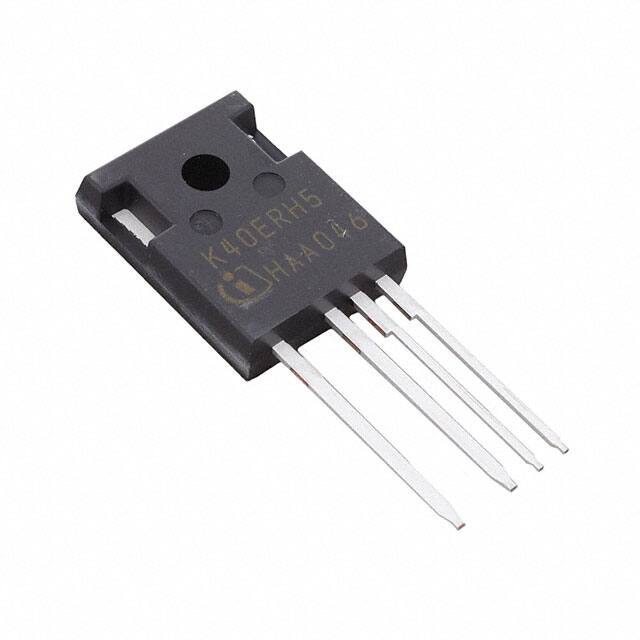

IKZA40N65RH5 HybridCoolSiCTMIGBT TRENCHSTOPTM5H5IGBTco-packedwithhalf-rated6thgeneration CoolSiCTMSchottkybarrierdiode  FeaturesandBenefits: •Ultra-lowswitchinglossesduetothecombinationof TRENCHSTOPTM5andCoolSiCTMtechnologyaswellasthe Kelvinemitterpin •Benchmarkefficiencyinhardswitchingtopologies •Plug-and-playreplacementofpuresilicondevices •SimplifiedPCBdesignduetotheoptimizedpin-outofthe four-pinpackage •Improvedwavesolderingqualityduetotheincreasedclearance oftheKelvinemitterandgatepins •Maximumjunctiontemperature175°C •QualifiedaccordingtoJEDECfortargetapplications •Pb-freeleadplating;RoHScompliant •CompleteproductspectrumandPSpicemodels: http://www.infineon.com/igbt/ PotentialApplications: •IndustrialPowerSupplies -IndustrialSMPS -IndustrialUPS •EnergyGeneration -SolarStringInverter •EnergyDistribution -EnergyStorage •Infrastructure–Charge -Charger ProductValidation: Qualifiedforapplicationslistedabovebasedonthetest conditionsintherelevanttestsofJEDEC20/22 Packagepindefinition: •PinC&backside-collector •PinE-emitter •PinK-Kelvinemitter •PinG-gate KeyPerformanceandPackageParameters Type IKZA40N65RH5 Datasheet www.infineon.com VCE IC VCEsat,Tvj=25°C Tvjmax Marking Package 650V 40A 1.65V 175°C K40ERH5 PG-TO247-4-3 PleasereadtheImportantNoticeandWarningsattheendofthisdocument V2.1 2020-07-27 IKZA40N65RH5 HybridCoolSiCTMIGBT TableofContents Description . . . . . . . . . . . . . . . . . . . . . . . . . . . . . . . . . . . . . . . . . . . . . . . . . . . . . . . . . . . . . . . . . . . . . . . . 1 Table of Contents . . . . . . . . . . . . . . . . . . . . . . . . . . . . . . . . . . . . . . . . . . . . . . . . . . . . . . . . . . . . . . . . . . . 2 Maximum Ratings . . . . . . . . . . . . . . . . . . . . . . . . . . . . . . . . . . . . . . . . . . . . . . . . . . . . . . . . . . . . . . . . . . . 3 Thermal Resistance . . . . . . . . . . . . . . . . . . . . . . . . . . . . . . . . . . . . . . . . . . . . . . . . . . . . . . . . . . . . . . . . . 3 Electrical Characteristics . . . . . . . . . . . . . . . . . . . . . . . . . . . . . . . . . . . . . . . . . . . . . . . . . . . . . . . . . . . . . . 4 Electrical Characteristics Diagrams . . . . . . . . . . . . . . . . . . . . . . . . . . . . . . . . . . . . . . . . . . . . . . . . . . . . . 6 Package Drawing . . . . . . . . . . . . . . . . . . . . . . . . . . . . . . . . . . . . . . . . . . . . . . . . . . . . . . . . . . . . . . . . . . .12 Testing Conditions . . . . . . . . . . . . . . . . . . . . . . . . . . . . . . . . . . . . . . . . . . . . . . . . . . . . . . . . . . . . . . . . . .13 Revision History . . . . . . . . . . . . . . . . . . . . . . . . . . . . . . . . . . . . . . . . . . . . . . . . . . . . . . . . . . . . . . . . . . . .14 Disclaimer . . . . . . . . . . . . . . . . . . . . . . . . . . . . . . . . . . . . . . . . . . . . . . . . . . . . . . . . . . . . . . . . . . . . . . . . .15 Datasheet 2 V2.1 2020-07-27 IKZA40N65RH5 HybridCoolSiCTMIGBT MaximumRatings Foroptimumlifetimeandreliability,Infineonrecommendsoperatingconditionsthatdonotexceed80%ofthemaximumratingsstatedinthisdatasheet. Parameter Symbol Value Unit Collector-emittervoltage,Tvj≥25°C VCE 650 V DCcollectorcurrent,limitedbyTvjmax Tc=25°C Tc=100°C IC 74.0 46.0 A Pulsedcollectorcurrent,tplimitedbyTvjmax ICpuls 160.0 A Turn off safe operating area VCE≤650V,Tvj≤175°C,tp=1µs - 160.0 A Diodeforwardcurrent,limitedbyTvjmax Tc=25°C Tc=100°C IF 27.5 18.5 A Diodepulsedcurrent,tplimitedbyTvjmax1) IFpuls 60.0 A Gate-emitter voltage TransientGate-emittervoltage(tp≤10µs,D
