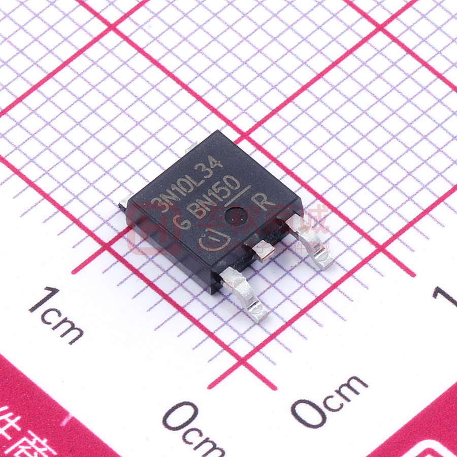

IPD30N10S3L-34 数据手册
IPD30N10S3L-34 OptiMOS®-T Power-Transistor Product Summary V DS 100 V R DS(on),max 31 mW ID 30 A Features • N-channel - Enhancement mode PG-TO252-3-11 • Automotive AEC Q101 qualified • MSL1 up to 260°C peak reflow • 175°C operating temperature • Green product (RoHS compliant) • 100% Avalanche tested Type Package Marking IPD30N10S3L-34 PG-TO252-3-11 3N10L34 Maximum ratings, at T j=25 °C, unless otherwise specified Parameter Symbol Continuous drain current ID Conditions Value T C=25°C, V GS=10V 30 T C=100°C, V GS=10V1) 20 Unit A Pulsed drain current1) I D,pulse T C=25°C 120 Avalanche energy, single pulse1) E AS I D=15A 138 mJ Avalanche current, single pulse I AS 30 A Gate source voltage2) V GS ±20 V Power dissipation P tot 57 W Operating and storage temperature T j, T stg -55 ... +175 °C T C=25°C IEC climatic category; DIN IEC 68-1 Rev. 1.1 55/175/56 page 1 2011-10-06 IPD30N10S3L-34 Parameter Symbol Values Conditions Unit min. typ. max. - - 2.6 minimal footprint - - 62 6 cm2 cooling area3) - - 40 Thermal characteristics1) Thermal resistance, junction - case R thJC SMD version, device on PCB R thJA K/W Electrical characteristics, at T j=25 °C, unless otherwise specified Static characteristics Drain-source breakdown voltage V (BR)DSS V GS=0V, I D= 1mA 100 - - Gate threshold voltage V GS(th) V DS=V GS, I D=29µA 1.2 1.7 2.4 Zero gate voltage drain current I DSS V DS=80V, V GS=0V, T j=25°C - 0.01 0.1 T j=125°C1) - 1 10 V DS=80V, V GS=0V, V µA Gate-source leakage current I GSS V GS=16V, V DS=0V - - 100 nA Drain-source on-state resistance R DS(on) V GS=4.5V, I D=30A - 32.2 41.8 mW V GS=10 V, I D=30 A - 25.8 31.0 Rev. 1.1 page 2 2011-10-06 IPD30N10S3L-34 Parameter Symbol Values Conditions Unit min. typ. max. - 1520 1976 - 380 494 Dynamic characteristics1) Input capacitance C iss Output capacitance C oss Reverse transfer capacitance Crss - 45 68 Turn-on delay time t d(on) - 6 - Rise time tr - 4 - Turn-off delay time t d(off) - 18 - Fall time tf - 3 - Gate to source charge Q gs - 5 7 Gate to drain charge Q gd - 4 6 Gate charge total Qg - 24 31 Gate plateau voltage V plateau - 3.7 - V - - 30 A - - 120 0.6 1 1.2 V - 72 - ns - 150 - nC V GS=0V, V DS=25V, f =1MHz V DD=20V, V GS=10V, I D=30A, R G=3.5W pF ns Gate Charge Characteristics1) V DD=80V, I D=30A, V GS=0 to 10V nC Reverse Diode Diode continous forward current1) IS Diode pulse current1) I S,pulse Diode forward voltage V SD V GS=0V, I F=30A, T j=25°C Reverse recovery time1) t rr V R=50V, I F=I S, di F/dt =100A/µs Reverse recovery charge1) Q rr 1) Defined by design. Not subject to production test. 2) Qualified with VGS = +20/-5V. T C=25°C 3) Device on 40 mm x 40 mm x 1.5 mm epoxy PCB FR4 with 6 cm2 (one layer, 70 µm thick) copper area for drain connection. PCB is vertical in still air. Rev. 1.1 page 3 2011-10-06 IPD30N10S3L-34 1 Power dissipation 2 Drain current P tot = f(T C); V GS ≥ 6 V I D = f(T C); V GS ≥ 6 V 60 30 50 40 I D [A] P tot [W] 20 30 20 10 10 0 0 0 50 100 150 200 0 50 100 T C [°C] 150 200 T C [°C] 3 Safe operating area 4 Max. transient thermal impedance I D = f(V DS); T C = 25 °C; D = 0 Z thJC = f(t p) parameter: t p parameter: D =t p/T 101 1000 0.5 0 10 1 µs 100 Z thJC [K/W] 0.1 I D [A] 10 µs 100 µs 10 0.05 10-1 0.01 1 ms 10-2 10-3 1 0.1 1 10 100 10-6 10-5 10-4 10-3 10-2 10-1 100 t p [s] V DS [V] Rev. 1.1 single pulse page 4 2011-10-06 IPD30N10S3L-34 5 Typ. output characteristics 6 Typ. drain-source on-state resistance I D = f(V DS); T j = 25 °C R DS(on) = f(I D); T j = 25 °C parameter: V GS parameter: V GS 120 80 10 V 5V 3V 4V 3.5 V 70 80 60 I D [A] R DS(on) [mW] 4.5 V 50 4V 40 40 4.5 V 3.5 V 5V 30 10 V 3V 0 20 0 1 2 3 4 5 6 0 20 V DS [V] 40 60 I D [A] 7 Typ. transfer characteristics 8 Typ. drain-source on-state resistance I D = f(V GS); V DS = 6V R DS(on) = f(T j); I D = 30 A; V GS = 10 V parameter: T j 60 60 25 °C 175 °C -55 °C 50 I D [A] R DS(on) [mW] 40 40 30 20 20 0 1 2 3 4 5 V GS [V] Rev. 1.1 10 -60 -20 20 60 100 140 180 T j [°C] page 5 2011-10-06 IPD30N10S3L-34 9 Typ. gate threshold voltage 10 Typ. capacitances V GS(th) = f(T j); V GS = V DS C = f(V DS); V GS = 0 V; f = 1 MHz parameter: I D 104 2.5 2 Ciss C [pF] 150 µA V GS(th) [V] 30 µA 1.5 103 Coss 1 102 0.5 Crss 101 0 -60 -20 20 60 100 140 0 180 5 10 15 20 25 30 V DS [V] T j [°C] 11 Typical forward diode characteristicis 12 Typ. avalanche characteristics IF = f(VSD) I A S= f(t AV) parameter: T j parameter: Tj(start) 103 100 25 °C 102 100 °C 10 I F [A] I AV [A] 150 °C 101 1 175 °C 25 °C 0.6 0.8 100 0.1 0 0.2 0.4 1 1.2 1.4 V SD [V] Rev. 1.1 0.1 1 10 100 1000 t AV [µs] page 6 2011-10-06 IPD30N10S3L-34 13 Typical avalanche energy 14 Typ. drain-source breakdown voltage E AS = f(T j) V BR(DSS) = f(T j); I D = 1 mA parameter: I D 115 300 7.5 A 250 110 150 V BR(DSS) [V] E AS [mJ] 200 15 A 105 100 100 30 A 95 50 90 0 25 75 125 -55 175 -15 T j [°C] 25 65 105 145 T j [°C] 15 Typ. gate charge 16 Gate charge waveforms V GS = f(Q gate); I D = 30 A pulsed parameter: V DD 10 V GS 9 Qg 8 20 V 80 V 7 V GS [V] 6 5 V g s(th) 4 3 2 Q g (th) Q sw 1 Q gs 0 0 5 10 15 20 Q gate Q gd 25 Q gate [nC] Rev. 1.1 page 7 2011-10-06 IPD30N10S3L-34 Published by Infineon Technologies AG 81726 Munich, Germany © Infineon Technologies AG 2008 All Rights Reserved. Legal Disclaimer The information given in this document shall in no event be regarded as a guarantee of conditions or characteristics. With respect to any examples or hints given herein, any typical values stated herein and/or any information regarding the application of the device, Infineon Technologies hereby disclaims any and all warranties and liabilities of any kind, including without limitation warranties of non‑infringement of intellectual property rights of any third party. Information For further information on technology, delivery terms and conditions and prices please contact your nearest Infineon Technologies Office (www.infineon.com). Warnings Due to technical requirements components may contain dangerous substances. For information on the types in question please contact your nearest Infineon Technologies Office. Infineon Technologies Components may only be used in life-support devices or systems with the express written approval of Infineon Technologies, if a failure of such components can reasonably be expected to cause the failure of that life-support device or system, or to affect the safety or effectiveness of that device or system. Life support devices or systems are intended to be implanted in the human body, or to support and/or maintain and sustain and/or protect human life. If they fail, it is reasonable to assume that the health of the user or other persons may be endangered. Rev. 1.1 page 8 2011-10-06 IPD30N10S3L-34 Revision History Version Rev. 1.1 Date Changes 1.1 Page 1: VGS changed from ±16V to 08.04.2008 ±20V 1.1 08.04.2008 Page 3: Footnote 2) added page 9 2011-10-06
