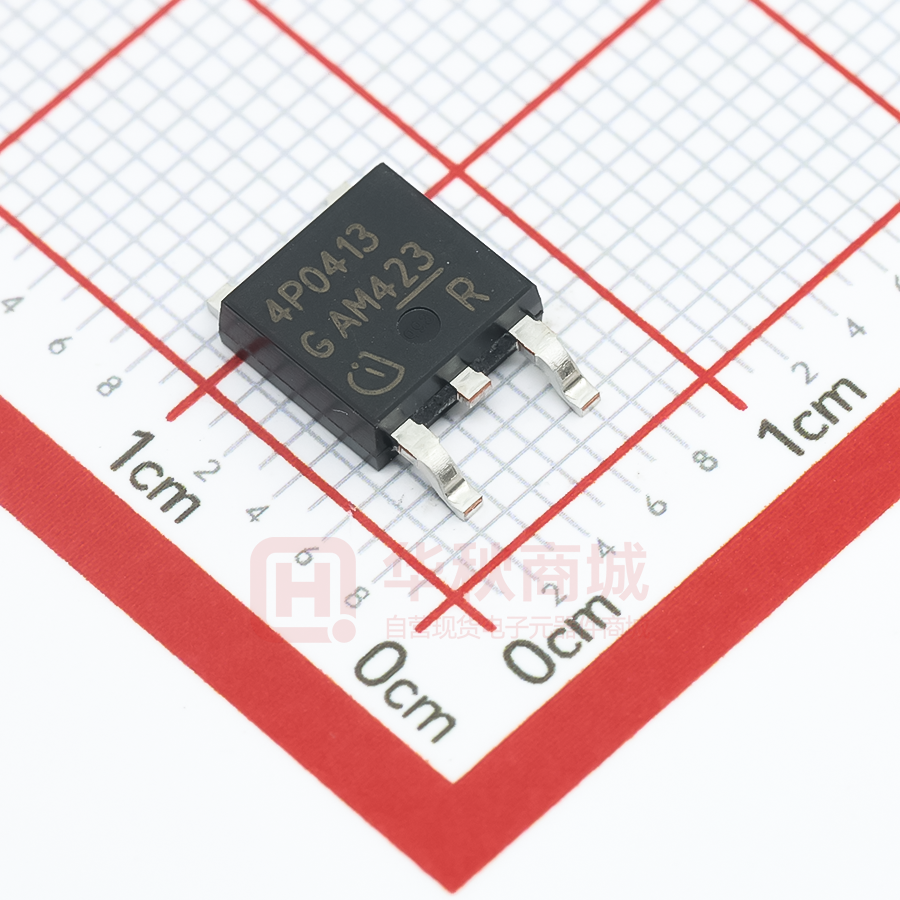

IPD50P04P4-13 Type OptiMOS®-P2 Power-Transistor Product Summary VDS -40 V RDS(on) 12.6 mW ID -50 A Features • P-channel - Normal Level - Enhancement mode • AEC qualified PG-TO252-3-313 • MSL1 up to 260°C peak reflow Tab • 175°C operating temperature • Green package (RoHS compliant) 1 3 • 100% Avalanche tested Source pin 3 Gate pin 1 Type Package Marking IPD50P04P4-13 PG-TO252-3-313 4P0413 Drain pin 2/Tab Maximum ratings, at T j=25 °C, unless otherwise specified Parameter Symbol Continuous drain current1) ID Conditions T C=25°C, V GS=-10V T C=100°C, Value -50 V GS=-10V2) -45 Unit A Pulsed drain current2) I D,pulse T C=25°C -200 Avalanche energy, single pulse2) E AS I D=-25A 18 mJ Avalanche current, single pulse I AS - -50 A Gate source voltage V GS - ±20 V Power dissipation P tot T C=25 °C 58 W Operating and storage temperature T j, T stg - -55 ... +175 °C IEC climatic category; DIN IEC 68-1 - - 55/175/56 Rev. 1.3 page 1 2019-07-16 IPD50P04P4-13 Parameter Symbol Values Conditions Unit min. typ. max. Thermal characteristics2) Thermal resistance, junction - case R thJC - - - 2.6 SMD version, device on PCB R thJA minimal footprint - - 62 6 cm2 cooling area3) - - 40 K/W Electrical characteristics, at T j=25 °C, unless otherwise specified Static characteristics Drain-source breakdown voltage V (BR)DSS V GS=0V, I D= -1mA -40 - - Gate threshold voltage V GS(th) V DS=V GS, I D=-85µA -2.0 -3.0 -4.0 Zero gate voltage drain current I DSS V DS=-32V, V GS=0V, T j=25°C - -0.05 -1 T j=125°C2) - -20 -200 V DS=-32V, V GS=0V, V µA Gate-source leakage current I GSS V GS=-20V, V DS=0V - - -100 nA Drain-source on-state resistance R DS(on) V GS=-10V, I D=-50A - 9.2 12.6 mW Rev. 1.3 page 2 2019-07-16 IPD50P04P4-13 Parameter Symbol Values Conditions Unit min. typ. max. - 2820 3670 - 1000 1500 Dynamic characteristics2) Input capacitance C iss Output capacitance C oss Reverse transfer capacitance Crss - 30 60 Turn-on delay time t d(on) - 17 - Rise time tr - 10 - Turn-off delay time t d(off) - 22 - Fall time tf - 28 - Gate to source charge Q gs - 14 19 Gate to drain charge Q gd - 7 14 Gate charge total Qg - 39 51 Gate plateau voltage V plateau - 5.4 - V - - -50 A - - -200 - -1 -1.3 V - 39 - ns - 32 - nC V GS=0V, V DS=-25V, f =1MHz V DD=-20V, V GS=-10V, I D=-50A, R G=3.5W pF ns Gate Charge Characteristics2) V DD=-32V, I D=-50A, V GS=0 to -10V nC Reverse Diode Diode continous forward current2) IS Diode pulse current2) I S,pulse Diode forward voltage V SD Reverse recovery time2) t rr Reverse recovery charge2) Q rr T C=25°C V GS=0V, I F=-50A, T j=25°C V R=-20V, I F=-50A, di F/dt =-100A/µs 1) Current is limited by bondwire; with an R thJC = 2.6K/W the chip is able to carry -55A at 25°C. 2) Defined by design. Not subject to production test. 3) Device on 40 mm x 40 mm x 1.5 mm epoxy PCB FR4 with 6 cm 2 (one layer, 70 µm thick) copper area for drain connection. PCB is vertical in still air. Rev. 1.3 page 3 2019-07-16 IPD50P04P4-13 1 Power dissipation 2 Drain current P tot = f(T C); V GS = -10V I D = f(T C); V GS = -10V 80 60 60 -ID [A] Ptot [W] 40 40 20 20 0 0 0 50 100 150 200 0 50 100 TC [°C] 150 200 TC [°C] 3 Safe operating area 4 Max. transient thermal impedance I D = f(V DS); T C = 25 °C; D = 0 Z thJC = f(t p) parameter: t p parameter: D =t p/T 1000 101 1 µs 0.5 0 10 10 µs 100 ZthJC [K/W] 100 µs -ID [A] 1 ms 0.1 0.05 10-1 0.01 10 single pulse 10-2 1 10-3 0.1 1 10 100 -VDS [V] Rev. 1.3 10-6 10-5 10-4 10-3 10-2 10-1 100 tp [s] page 4 2019-07-16 IPD50P04P4-13 5 Typ. output characteristics 6 Typ. drain-source on-state resistance I D = f(V DS); T j = 25 °C R DS(on) = (I D); T j = 25 °C parameter: -V GS parameter: -V GS 40 200 5V 35 8V 10V 7V 30 RDS(on) [mW] -ID [A] 150 100 25 6V 20 6V 15 50 7V 8V 10 10V 5V 5 0 0 2 4 0 6 25 50 -ID [A] -VDS [V] 7 Typ. transfer characteristics 8 Typ. drain-source on-state resistance I D = f(V GS); V DS = -6V R DS(on) = f(T j); I D = -50 A; V GS = -10 V parameter: T j 200 16 14 RDS(on) [mW] -ID [A] 150 100 50 12 10 175 °C 8 25 °C -55 °C 5 6 6 0 2 3 4 7 8 -20 20 60 100 140 180 Tj [°C] -VGS [V] Rev. 1.3 -60 page 5 2019-07-16 IPD50P04P4-13 9 Typ. gate threshold voltage 10 Typ. capacitances V GS(th) = f(T j); V GS = V DS C = f(V DS); V GS = 0 V; f = 1 MHz parameter: -I D 104 4 3.5 Ciss 850µA 103 85µA Coss C [pF] -VGS(th) [V] 3 2.5 102 2 Crss 1.5 101 1 -60 -20 20 60 100 140 0 180 5 10 15 20 25 30 140 180 -VDS [V] Tj [°C] 11 Typical forward diode characteristicis 12 Drain-source breakdown voltage IF = f(VSD) V BR(DSS) = f(T j); I D = -1 mA parameter: T j 44 103 43 42 -IF [A] -VBR(DSS) [V] 102 41 40 175 °C 25 °C 101 39 38 37 100 0 0.4 0.8 1.2 1.6 -VSD [V] Rev. 1.3 -60 -20 20 60 100 Tj [°C] page 6 2019-07-16 IPD50P04P4-13 13 Typ. gate charge 14 Gate charge waveforms V GS = f(Q gate); I D = -50 A pulsed parameter: V DD 10 9 V GS -8V Qg 8 -32V 7 -VGS [V] 6 5 4 3 2 Q gate 1 Q gs Q gd 0 0 10 20 30 40 Qgate [nC] Rev. 1.3 page 7 2019-07-16 IPD50P04P4-13 Published by Infineon Technologies AG 81726 Munich, Germany © Infineon Technologies AG 2019 All Rights Reserved. Legal Disclaimer The information given in this document shall in no event be regarded as a guarantee of conditions or characteristics. With respect to any examples or hints given herein, any typical values stated herein and/or any information regarding the application of the device, Infineon Technologies hereby disclaims any and all warranties and liabilities of any kind, including without limitation, warranties of non-infringement of intellectual property rights of any third party. Information For further information on technology, delivery terms and conditions and prices, please contact the nearest Infineon Technologies Office (www.infineon.com). Warnings Due to technical requirements, components may contain dangerous substances. For information on the types in question, please contact the nearest Infineon Technologies Office. Infineon Technologies components may be used in life-support devices or systems only with the express written approval of Infineon Technologies, if a failure of such components can reasonably be expected to cause the failure of that life-support device or system or to affect the safety or effectiveness of that device or system. Life support devices or systems are intended to be implanted in the human body or to support and/or maintain and sustain and/or protect human life. If they fail, it is reasonable to assume that the health of the user or other persons may be endangered. Rev. 1.3 page 8 2019-07-16 IPD50P04P4-13 Revision History Version Rev. 1.3 Date Changes 1.0 14.03.2011 Final Data Sheet 1.1 21.12.2012 Update of diagram 8 1.2 09.12.2013 Update of Idpuls and SOA 1.3 16.07.2019 graphs corrected page 9 2019-07-16
