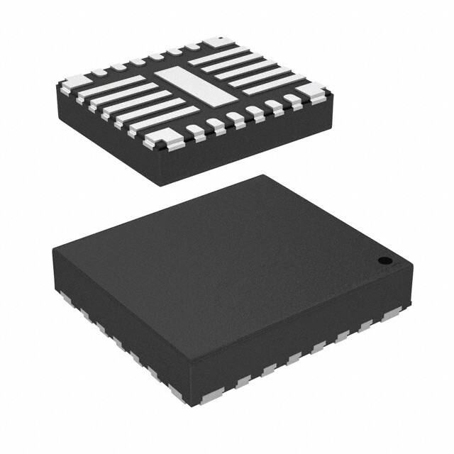

DCDC Converter Single-input Voltage, 15 A & 30 A Buck Regulators with SVID OptiMOS™ IPOL IR38163/363/165/365 FEATURES     Internal LDO allows single 16 V operation Output Voltage Range: 0.5 V to 0.875*PVin 0.5% accurate Reference Voltage Intel VR12.5 (Rev 1.5); VR13 (Rev 1.0) and SVID (Rev 1.7) compliant Enhanced line/load regulation with Feedforward Frequency programmable by PMBus™ up to 1.5 MHz Enable input with Voltage Monitoring Capability Remote Sense Amplifier with True Differential Voltage Sensing Fast mode I2C and 400 kHz PMBus™ interface for programming, sequencing and margining output voltage, and for monitoring input voltage, output voltage, output current and temperature. PMBus™ configurable fault thresholds for input UVLO, output OVP, OCP and thermal shutdown. Thermally compensated pulse-by-pulse current limit and Hiccup Mode Over Current Protection Dedicated output voltage sensing for power good indication and overvoltage protection which remains active even when Enable is low. Enhanced Pre-Bias Start up Integrated MOSFET drivers and Bootstrap diode Operating junction temp: -40oC

1. 物料型号:文档中提到的物料型号为IR38163/363/165/365,这些是Infineon公司的DCDC转换器,具体型号包括IR38163MTRPbF、IR38363MTRPbF、IR38165MTRPbF和IR38365MTRPbF。
2. 器件简介:这些器件是高效率的DC/DC调节器,具有Intel SVID接口和I2C/PMBus™接口,适用于多种应用,包括Intel® VR13和VR12.5系统、服务器和高端桌面CPU VRs。
3. 引脚分配:文档提供了详细的引脚分配图,包括电源地(PGND)、信号地(LGND)、开关节点(SW)、启用输入(ENABLE)、输出电压(VOUT)等。
4. 参数特性:文档列出了详细的电气规格,包括输入电压范围、输出电压范围、开关频率、工作温度范围等。
5. 功能详解:文档描述了器件的多种功能,如内部LDO允许单16V操作、输出电压范围可调节、增强的线/负载调节、频率可编程、远程感应放大器等。
6. 应用信息:这些器件适用于需要高效率和高电流输出的应用,如服务器和高端桌面CPU的电压调节。
7. 封装信息:文档提供了5mm x 7mm PQFN封装的详细信息,包括焊盘尺寸和间距。
