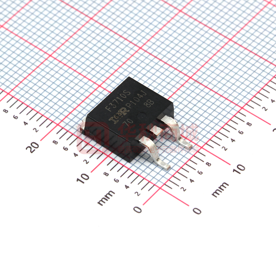

IRF3710SPbF IRF3710LPbF l l l l l l l Advanced Process Technology Ultra Low On-Resistance Dynamic dv/dt Rating 175°C Operating Temperature Fast Switching Fully Avalanche Rated Lead-Free HEXFET® Power MOSFET D VDSS = 100V RDS(on) = 23mΩ G ID = 57A S Description Advanced HEXFET® Power MOSFETs from International Rectifier utilize advanced processing techniques to achieve extremely low on-resistance per silicon area. This benefit, combined with the fast switching speed and ruggedized device design that HEXFET power MOSFETs are well known for, provides the designer with an extremely efficient and reliable device for use in a wide variety of applications. The D2Pak is a surface mount power package capable of accommodating die sizes up to HEX-4. It provides the highest power capability and the lowest possible on-resistance in any existing surface mount package. The D 2Pak is suitable for high current applications because of its low internal connection resistance and can dissipate up to 2.0W in a typical surface mount application. The through-hole version (IRF3710L) is available for low-profile applications. D2Pak IRF3710SPbF TO-262 IRF3710LPbF Absolute Maximum Ratings ID @ TC = 25°C ID @ TC = 100°C IDM PD @TC = 25°C VGS IAR EAR dv/dt TJ TSTG Parameter Max. Continuous Drain Current, VGS @ 10V‡ Continuous Drain Current, VGS @ 10V‡ Pulsed Drain Current ‡ Power Dissipation Linear Derating Factor Gate-to-Source Voltage Avalanche Current Repetitive Avalanche Energy Peak Diode Recovery dv/dt ƒ‡ Operating Junction and Storage Temperature Range Soldering Temperature, for 10 seconds 57 40 180 200 1.3 ± 20 28 20 5.8 -55 to + 175 Units A W W/°C V A mJ V/ns °C 300 (1.6mm from case ) Thermal Resistance Parameter RθJC RθJA Junction-to-Case Junction-to-Ambient (PCB Mounted,steady-state)** Typ. Max. Units ––– ––– 0.75 40 °C/W 1 www.irf.com © 2013 International Rectifier Submit Datasheet Feedback November 12, 2013 IRF3710S/LPbF Electrical Characteristics @ TJ = 25°C (unless otherwise specified) RDS(on) VGS(th) gfs Parameter Drain-to-Source Breakdown Voltage Breakdown Voltage Temp. Coefficient Static Drain-to-Source On-Resistance Gate Threshold Voltage Forward Transconductance Qg Qgs Qgd td(on) tr td(off) tf Gate-to-Source Forward Leakage Gate-to-Source Reverse Leakage Total Gate Charge Gate-to-Source Charge Gate-to-Drain ("Miller") Charge Turn-On Delay Time Rise Time Turn-Off Delay Time Fall Time Min. 100 ––– ––– 2.0 32 ––– ––– ––– ––– ––– ––– ––– ––– ––– ––– ––– IDSS Drain-to-Source Leakage Current LD Internal Drain Inductance ––– LS Internal Source Inductance ––– Ciss Coss Crss EAS Input Capacitance Output Capacitance Reverse Transfer Capacitance Single Pulse Avalanche Energy‚‡ ––– ––– ––– ––– V(BR)DSS ∆V(BR)DSS/∆TJ IGSS Typ. ––– 0.13 ––– ––– ––– ––– ––– ––– ––– ––– ––– ––– 12 58 45 47 Max. Units Conditions ––– V VGS = 0V, ID = 250µA ––– V/°C Reference to 25°C, ID = 1mA‡ 23 mΩ VGS = 10V, ID =28A „ 4.0 V VDS = VGS, ID = 250µA ––– S VDS = 25V, ID = 28A„‡ 25 VDS = 100V, VGS = 0V µA 250 VDS = 80V, VGS = 0V, TJ = 150°C 100 VGS = 20V nA -100 VGS = -20V 130 ID = 28A 26 nC VDS = 80V 43 VGS = 10V, See Fig. 6 and 13‡ ––– VDD = 50V ––– ID = 28A ns ––– RG = 2.5Ω ––– VGS = 10V, See Fig. 10 „‡ Between lead, 4.5 ––– 6mm (0.25in.) nH G from package 7.5 ––– and center of die contact 3130 ––– VGS = 0V 410 ––– VDS = 25V 72 ––– pF ƒ = 1.0MHz, See Fig. 5‡ 1060…280† mJ IAS = 28A, L = 0.70mH D S Source-Drain Ratings and Characteristics IS ISM VSD trr Qrr ton Parameter Continuous Source Current (Body Diode) Pulsed Source Current (Body Diode) Diode Forward Voltage Reverse Recovery Time Reverse Recovery Charge Forward Turn-On Time Min. Typ. Max. Units Conditions D MOSFET symbol 57 ––– ––– showing the A G integral reverse ––– ––– 230 S p-n junction diode. ––– ––– 1.2 V TJ = 25°C, IS = 28A, VGS = 0V „ ––– 140 220 ns TJ = 25°C, IF = 28A ––– 670 1010 nC di/dt = 100A/µs „ Intrinsic turn-on time is negligible (turn-on is dominated by LS+LD) Notes:  Repetitive rating; pulse width limited by max. junction temperature. (See fig. 11). ‚ Starting TJ = 25°C, L = 0.70mH, RG = 25Ω, IAS = 28A, VGS=10V. (See Figure 12). ƒ ≤ 28A, di/dt ≤ 380A/µs, VDD ≤ V(BR)DSS, TJ ≤ 175°C. „ Pulse width ≤ 400µs; duty cycle ≤ 2%. 2 … This is a typical value at device destruction and represents operation outside rated limits. † This is a calculated value limited to TJ = 175°C . ‡ Uses IRF3710 data and test conditions. **When mounted on 1" square PCB (FR-4 or G-10 Material). For recommended footprint and soldering techniques refer to application note #AN-994. www.irf.com © 2013 International Rectifier Submit Datasheet Feedback November 12, 2013 IRF3710S/LPbF 1000 1000 VGS 16V 10V 7.0V 6.0V 5.0V 4.5V 4.0V BOTTOM 3.5V 100 VGS 16V 10V 7.0V 6.0V 5.0V 4.5V 4.0V BOTTOM 3.5V TOP 10 3.5V 1 20µs PULSE WIDTH Tj = 25°C ID, Drain-to-Source Current (A) ID, Drain-to-Source Current (A) TOP 100 0.1 10 3.5V 1 20µs PULSE WIDTH Tj = 175°C 0.1 0.1 1 10 100 0.1 1 VDS, Drain-to-Source Voltage (V) Fig 1. Typical Output Characteristics 100 Fig 2. Typical Output Characteristics 1000.00 3.0 I D = 57A 2.5 R DS(on) , Drain-to-Source On Resistance 100.00 T J = 175°C 10.00 T J = 25°C 1.00 VDS = 50V 15V 20µs PULSE WIDTH 0.10 3.0 4.0 5.0 6.0 7.0 8.0 VGS, Gate-to-Source Voltage (V) Fig 3. Typical Transfer Characteristics 9.0 2.0 (Normalized) ID, Drain-to-Source Current (Α ) 10 VDS, Drain-to-Source Voltage (V) 1.5 1.0 0.5 V GS = 10V 0.0 -60 -40 -20 0 20 40 60 80 TJ , Junction Temperature 100 120 140 160 180 ( °C) Fig 4. Normalized On-Resistance Vs. Temperature 3 www.irf.com © 2013 International Rectifier Submit Datasheet Feedback November 12, 2013 IRF3710S/LPbF 100000 Ciss 1000 Coss Crss 100 ID = 28A 10 7 5 2 0 1 10 0 100 20 1000.00 1000 ID, Drain-to-Source Current (A) ISD, Reverse Drain Current (A) 60 80 100 Fig 6. Typical Gate Charge Vs. Gate-to-Source Voltage Fig 5. Typical Capacitance Vs. Drain-to-Source Voltage 100.00 TJ = 175°C 10.00 T J = 25°C 1.00 40 QG, Total Gate Charge (nC) VDS, Drain-to-Source Voltage (V) OPERATION IN THIS AREA LIMITED BY RDS(on) 100 100µsec 10 1msec 1 0.1 VGS = 0V 10msec Tc = 25°C Tj = 175°C Single Pulse DC 0.01 0.10 0.0 0.5 1.0 1.5 VSD, Source-toDrain Voltage (V) Fig 7. Typical Source-Drain Diode Forward Voltage 4 VDS = 80V VDS = 50V VDS = 20V 10 VGS , Gate-to-Source Voltage (V) Coss = Cds + Cgd 10000 C, Capacitance(pF) 12 VGS = 0V, f = 1 MHZ Ciss = Cgs + Cgd, Cds SHORTED Crss = Cgd 2.0 0.01 0.1 1 10 100 1000 VDS, Drain-to-Source Voltage (V) Fig 8. Maximum Safe Operating Area www.irf.com © 2013 International Rectifier Submit Datasheet Feedback November 12, 2013 IRF3710S/LPbF 60 RD VDS VGS 50 D.U.T. RG + -VDD I D , Drain Current (A) 40 V GS 30 Pulse Width ≤ 1 µs Duty Factor ≤ 0.1 % 20 Fig 10a. Switching Time Test Circuit VDS 10 90% 0 25 50 75 100 TC , Case Temperature 125 150 175 ( °C) 10% VGS Fig 9. Maximum Drain Current Vs. Case Temperature td(on) tr t d(off) tf Fig 10b. Switching Time Waveforms 1 (Z thJC) D = 0.50 Thermal Response 0.20 0.1 0.10 P DM 0.05 0.02 SINGLE PULSE (THERMAL RESPONSE) t1 t2 0.01 Notes: 1. Duty factor D = 2. Peak T 0.01 0.00001 0.0001 0.001 0.01 t1/ t 2 J = P DM x Z thJC +TC 0.1 1 t 1, Rectangular Pulse Duration (sec) Fig 11. Maximum Effective Transient Thermal Impedance, Junction-to-Case 5 www.irf.com © 2013 International Rectifier Submit Datasheet Feedback November 12, 2013 IRF3710S/LPbF 550 ID 15V TOP D.U.T RG 20V VGS IAS 440 DRIVER + V - DD A 0.01Ω tp Fig 12a. Unclamped Inductive Test Circuit V(BR)DSS tp EAS , Single Pulse Avalanche Energy (mJ) L VDS 11A 20A 28A BOTTOM 330 220 110 0 25 50 75 100 125 Starting T , Junction Temperature J 150 175 ( °C) Fig 12c. Maximum Avalanche Energy Vs. Drain Current I AS Fig 12b. Unclamped Inductive Waveforms Current Regulator Same Type as D.U.T. 50KΩ QG 12V .2µF .3µF VGS QGS D.U.T. QGD + V - DS VGS VG 3mA Charge Fig 13a. Basic Gate Charge Waveform 6 IG ID Current Sampling Resistors Fig 13b. Gate Charge Test Circuit www.irf.com © 2013 International Rectifier Submit Datasheet Feedback November 12, 2013 IRF3710S/LPbF Peak Diode Recovery dv/dt Test Circuit + D.U.T* ƒ Circuit Layout Considerations • Low Stray Inductance • Ground Plane • Low Leakage Inductance Current Transformer + ‚ - - „ +  RG • dv/dt controlled by RG • ISD controlled by Duty Factor "D" • D.U.T. - Device Under Test + - VDD VGS * Reverse Polarity of D.U.T for P-Channel Driver Gate Drive P.W. Period D= P.W. Period [VGS=10V ] *** D.U.T. ISD Waveform Reverse Recovery Current Body Diode Forward Current di/dt D.U.T. VDS Waveform Diode Recovery dv/dt Re-Applied Voltage Body Diode [VDD] Forward Drop Inductor Curent Ripple ≤ 5% [ISD ] *** VGS = 5.0V for Logic Level and 3V Drive Devices Fig 14. For N-channel HEXFET® power MOSFETs 7 www.irf.com © 2013 International Rectifier Submit Datasheet Feedback November 12, 2013 IRF3710S/LPbF D2Pak (TO-263AB) Package Outline Dimensions are shown in millimeters (inches) D2Pak (TO-263AB) Part Marking Information 7+,6,6$1,5)6:,7+ /27&2'( $66(0%/('21:: ,17+($66(0%/

物料型号: - IRF3710SPbF:D2Pak封装 - IRF3710LPbF:TO-262封装 - 另外还提到了IRF3710L,为通孔版本,适用于低高度应用。
器件简介: - 这些是采用先进工艺技术的HEXFET® Power MOSFETs,具有超低的导通电阻。 - D2Pak封装能够承受高达2.0W的功率消耗,适合高电流应用。
引脚分配: - 文档中没有明确指出引脚分配,但通常MOSFET会有源极(S)、漏极(D)和栅极(G)。
参数特性: - 绝对最大额定值包括:连续漏极电流57A、脉冲漏极电流180A、功耗200W等。 - 热阻包括:结到外壳热阻0.75°C/W、结到环境热阻40°C/W。 - 电气特性在25°C时包括:漏极到源极击穿电压100V、栅极阈值电压2.0到4.0V、导通电阻23mΩ等。
功能详解: - 这些MOSFETs以其快速开关速度和坚固的器件设计而闻名,适用于多种应用。 - D2Pak封装提供最高的功率能力和最低的导通电阻。
应用信息: - 适用于需要高效率和可靠性的广泛应用。
封装信息: - D2Pak和TO-262封装的尺寸信息和标记信息在文档中有详细说明。
