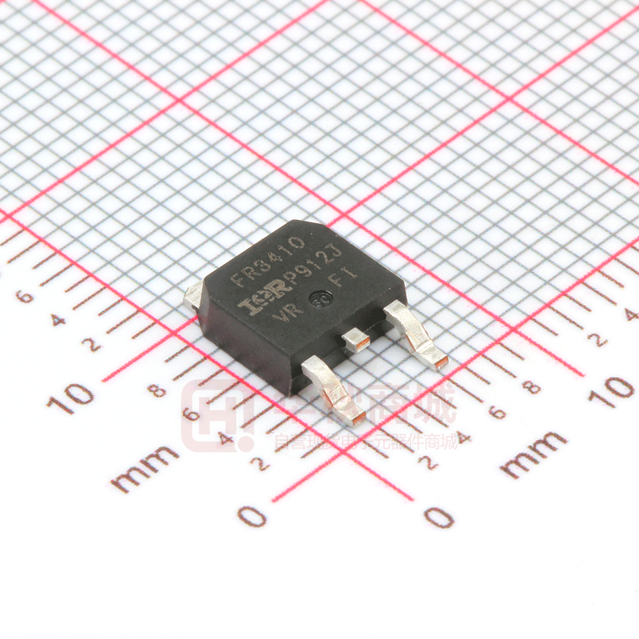

    TO-252AA
    表面贴装型 N 通道 100 V 31A(Tc) 3W(Ta),110W(Tc) D-Pak
IRFR3410TRPBF 数据手册
PD - 95514A IRFR3410PbF IRFU3410PbF HEXFET® Power MOSFET Applications High frequency DC-DC converters l Lead-Free l Benefits Low Gate-to-Drain Charge to Reduce Switching Losses l Fully Characterized Capacitance Including Effective COSS to Simplify Design, (See App. Note AN1001) l Fully Characterized Avalanche Voltage and Current VDSS RDS(on) max ID 39mΩ 31A† 100V l D-Pak IRFR3410 I-Pak IRFU3410 Absolute Maximum Ratings Symbol VDS VGS ID @ TC = 25°C ID @ TC = 100°C IDM PD @TC = 25°C PD @TA = 25°C dv/dt TJ TSTG Parameter Drain-Source Voltage Gate-to-Source Voltage Continuous Drain Current, VGS @ 10V Continuous Drain Current, VGS @ 10V Pulsed Drain Current Maximum Power Dissipation Maximum Power Dissipation Linear Derating Factor Peak Diode Recovery dv/dt ƒ Operating Junction and Storage Temperature Range Soldering Temperature, for 10 seconds Max. Units 100 ± 20 31† 22 125 110 3.0 0.71 15 -55 to + 175 V A W mW°C V/ns °C 300 (1.6mm from case ) Thermal Resistance Parameter RθJC RθJA RθJA Junction-to-Case Junction-to-Ambient (PCB mount)* Junction-to-Ambient Typ. Max. Units ––– ––– ––– 1.4 40 110 °C/W Notes  through † are on page 10 www.irf.com 1 12/03/04 IRFR/U3410PbF Static @ TJ = 25°C (unless otherwise specified) Parameter Drain-to-Source Breakdown Voltage ∆V(BR)DSS/∆TJ Breakdown Voltage Temp. Coefficient RDS(on) Static Drain-to-Source On-Resistance VGS(th) Gate Threshold Voltage V(BR)DSS IDSS Drain-to-Source Leakage Current IGSS Gate-to-Source Forward Leakage Gate-to-Source Reverse Leakage Min. 100 ––– ––– 2.0 ––– ––– ––– ––– Typ. ––– 0.11 34 ––– ––– ––– ––– ––– Max. Units Conditions ––– V VGS = 0V, ID = 250µA ––– V/°C Reference to 25°C, ID = 1mA „ 39 mΩ VGS = 10V, ID = 18A „ 4.0 V VDS = VGS, ID = 250µA 20 VDS = 100V, VGS = 0V µA 250 VDS = 80V, VGS = 0V, TJ = 150°C 200 VGS = 20V nA -200 VGS = -20V Dynamic @ TJ = 25°C (unless otherwise specified) gfs Qg Qgs Qgd td(on) tr td(off) tf Ciss Coss Crss Coss Coss Coss eff. Parameter Forward Transconductance Total Gate Charge Gate-to-Source Charge Gate-to-Drain ("Miller") Charge Turn-On Delay Time Rise Time Turn-Off Delay Time Fall Time Input Capacitance Output Capacitance Reverse Transfer Capacitance Output Capacitance Output Capacitance Effective Output Capacitance Min. 33 ––– ––– ––– ––– ––– ––– ––– ––– ––– ––– ––– ––– ––– Typ. ––– 37 10 11 12 27 40 13 1690 220 26 1640 130 250 Max. Units Conditions ––– S VDS = 25V, ID = 18A 56 I D = 18A ––– nC VDS = 50V ––– VGS = 10V, „ ––– VDD = 50V ––– ID = 18A ns ––– RG = 9.1Ω ––– VGS = 10V „ ––– VGS = 0V ––– VDS = 25V ––– pF ƒ = 1.0MHz ––– VGS = 0V, VDS = 1.0V, ƒ = 1.0MHz ––– VGS = 0V, VDS = 80V, ƒ = 1.0MHz ––– VGS = 0V, VDS = 0V to 80V … Avalanche Characteristics Parameter EAS IAR Single Pulse Avalanche Energy‚ Avalanche Current Typ. Max. Units ––– ––– 140 18 mJ A Diode Characteristics IS ISM VSD trr Qrr ton 2 Parameter Continuous Source Current (Body Diode) Pulsed Source Current (Body Diode)  Diode Forward Voltage Reverse Recovery Time Reverse RecoveryCharge Forward Turn-On Time Min. Typ. Max. Units Conditions D MOSFET symbol ––– ––– 31† showing the A G integral reverse ––– ––– 125 S p-n junction diode. ––– ––– 1.3 V TJ = 25°C, IS = 18A, VGS = 0V „ ––– 84 ––– ns TJ = 25°C, IF = 18A ––– 260 ––– nC di/dt = 100A/µs „ Intrinsic turn-on time is negligible (turn-on is dominated by LS+LD) www.irf.com IRFR/U3410PbF 1000 100 VGS 15V 10V 8.0V 7.0V 6.0V 5.5V 5.0V BOTTOM 4.5V ID, Drain-to-Source Current (A) ID, Drain-to-Source Current (A) 100 10 4.5V 20µs PULSE WIDTH Tj = 25°C 1 10 10 20µs PULSE WIDTH Tj = 175°C 0.1 100 1 10 100 VDS, Drain-to-Source Voltage (V) VDS, Drain-to-Source Voltage (V) Fig 2. Typical Output Characteristics Fig 1. Typical Output Characteristics 1000 3.0 100 T J = 175°C T J = 25°C 10 VDS = 50V 20µs PULSE WIDTH 1 ID = 30A VGS = 10V 2.0 (Normalized) RDS(on) , Drain-to-Source On Resistance ID, Drain-to-Source Current (Α) 4.5V 1 1 0.1 VGS 15V 10V 8.0V 7.0V 6.0V 5.5V 5.0V BOTTOM 4.5V TOP TOP 1.0 0.0 4.0 5.0 6.0 7.0 8.0 VGS , Gate-to-Source Voltage (V) Fig 3. Typical Transfer Characteristics www.irf.com 9.0 -60 -40 -20 0 20 40 60 80 100 120 140 160 180 T J , Junction Temperature (°C) Fig 4. Normalized On-Resistance Vs. Temperature 3 IRFR/U3410PbF 100000 ID= 18A VGS , Gate-to-Source Voltage (V) Coss 10000 C, Capacitance (pF) 20 VGS = 0V, f = 1 MHZ Ciss = Cgs + Cgd, Cds SHORTED Crss = Cgd = Cds + Cgd Ciss 1000 Coss 100 Crss 16 12 8 4 0 10 1 10 0 100 10 30 40 50 60 Fig 6. Typical Gate Charge Vs. Gate-to-Source Voltage Fig 5. Typical Capacitance Vs. Drain-to-Source Voltage 1000.0 1000 ID, Drain-to-Source Current (A) ISD, Reverse Drain Current (A) 20 Q G Total Gate Charge (nC) VDS, Drain-to-Source Voltage (V) 100.0 OPERATION IN THIS AREA LIMITED BY RDS (on) 100 TJ = 175°C 10.0 1.0 TJ = 25°C 100µsec 10 1msec 1 Tc = 25°C Tj = 175°C Single Pulse VGS = 0V 10msec 0.1 0.1 0.0 0.5 1.0 1.5 VSD, Source-toDrain Voltage (V) Fig 7. Typical Source-Drain Diode Forward Voltage 4 VDS = 80V VDS= 50V VDS= 20V 2.0 1 10 100 1000 VDS , Drain-toSource Voltage (V) Fig 8. Maximum Safe Operating Area www.irf.com IRFR/U3410PbF 32 28 ID , Drain Current (A) RD V DS LIMITED BY PACKAGE VGS RG 24 D.U.T. + -VDD 20 VGS 16 Pulse Width ≤ 1 µs Duty Factor ≤ 0.1 % 12 Fig 10a. Switching Time Test Circuit 8 VDS 4 90% 0 25 50 75 100 125 150 175 T C , Case Temperature (°C) 10% VGS Fig 9. Maximum Drain Current Vs. Case Temperature td(on) tr t d(off) tf Fig 10b. Switching Time Waveforms Thermal Response ( Z thJC ) 10 1 D = 0.50 0.20 0.10 0.05 0.1 0.02 0.01 0.01 SINGLE PULSE ( THERMAL RESPONSE ) 0.001 1E-006 1E-005 0.0001 0.001 0.01 0.1 t1 , Rectangular Pulse Duration (sec) Fig 11. Maximum Effective Transient Thermal Impedance, Junction-to-Case www.irf.com 5 IRFR/U3410PbF L VDS D.U.T RG IAS VGS 20V tp DRIVER + V - DD A 0.01Ω Fig 12a. Unclamped Inductive Test Circuit V(BR)DSS tp EAS, Single Pulse Avalanche Energy (mJ) 250 15V TOP BOTTOM 200 ID 7.3A 13A 18A 150 100 50 0 25 50 75 100 125 150 175 Starting TJ , Junction Temperature (°C) Fig 12c. Maximum Avalanche Energy Vs. Drain Current I AS Fig 12b. Unclamped Inductive Waveforms Current Regulator Same Type as D.U.T. 50KΩ QG 12V .2µF .3µF VGS QGS D.U.T. QGD + V - DS VGS VG 3mA IG Charge Fig 13a. Basic Gate Charge Waveform 6 ID Current Sampling Resistors Fig 13b. Gate Charge Test Circuit www.irf.com IRFR/U3410PbF Peak Diode Recovery dv/dt Test Circuit Circuit Layout Considerations • Low Stray Inductance • Ground Plane • Low Leakage Inductance Current Transformer + D.U.T ƒ + ‚ - - „ +  RG • • • • dv/dt controlled by RG Driver same type as D.U.T. ISD controlled by Duty Factor "D" D.U.T. - Device Under Test Driver Gate Drive P.W. Period D= + - VDD P.W. Period VGS=10V * D.U.T. ISD Waveform Reverse Recovery Current Body Diode Forward Current di/dt D.U.T. VDS Waveform Diode Recovery dv/dt Re-Applied Voltage Body Diode VDD Forward Drop Inductor Curent Ripple ≤ 5% ISD * VGS = 5V for Logic Level Devices Fig 14. For N-Channel HEXFET® Power MOSFETs www.irf.com 7 IRFR/U3410PbF D-Pak (TO-252AA) Package Outline D-Pak (TO-252AA) Part Marking Information EXAMPLE: THIS IS AN IRFR120 WITH ASSEMBLY LOT CODE 1234 AS SEMBLED ON WW 16, 1999 IN T HE ASSEMBLY LINE "A" PART NUMBER INTERNATIONAL RECT IFIER LOGO Note: "P" in as sembly line position indicates "Lead-Free" IRFU120 12 916A 34 ASSEMBLY LOT CODE DATE CODE YEAR 9 = 1999 WEEK 16 LINE A OR PART NUMBER INTE RNATIONAL RECTIFIER LOGO IRFU120 12 AS S E MBLY LOT CODE 8 34 DATE CODE P = DESIGNAT ES LEAD-FRE E PRODUCT (OPT IONAL) YEAR 9 = 1999 WE EK 16 A = ASS EMBLY SITE CODE www.irf.com IRFR/U3410PbF I-Pak (TO-251AA) Package Outline Dimensions are shown in millimeters (inches) I-Pak (TO-251AA) Part Marking Information E XAMPLE: T HIS IS AN IRFU120 WIT H ASSE MBLY LOT CODE 5678 AS SEMBLED ON WW 19, 1999 IN T HE ASSE MBLY LINE "A" PART NUMBE R INT E RNAT IONAL RECT IF IE R LOGO IRF U120 919A 56 78 ASS EMBLY LOT CODE Note: "P" in as s embly line pos ition indicates "Lead-Free" DAT E CODE YEAR 9 = 1999 WEE K 19 LINE A OR INT ERNAT IONAL RECT IFIER LOGO PART NUMBER IRFU120 56 AS SEMBLY LOT CODE www.irf.com 78 DAT E CODE P = DESIGNAT ES LEAD-FREE PRODUCT (OPT IONAL) YEAR 9 = 1999 WEEK 19 A = AS SEMBLY SIT E CODE 9 IRFR/U3410PbF D-Pak (TO-252AA) Tape & Reel Information Dimensions are shown in millimeters (inches) TR TRR 16.3 ( .641 ) 15.7 ( .619 ) 12.1 ( .476 ) 11.9 ( .469 ) FEED DIRECTION TRL 16.3 ( .641 ) 15.7 ( .619 ) 8.1 ( .318 ) 7.9 ( .312 ) FEED DIRECTION NOTES : 1. CONTROLLING DIMENSION : MILLIMETER. 2. ALL DIMENSIONS ARE SHOWN IN MILLIMETERS ( INCHES ). 3. OUTLINE CONFORMS TO EIA-481 & EIA-541. 13 INCH 16 mm NOTES : 1. OUTLINE CONFORMS TO EIA-481. Notes:  Repetitive rating; pulse width limited by max. junction temperature. … Coss eff. is a fixed capacitance that gives the same charging time ‚ Starting TJ = 25°C, L = 0.85mH as Coss while VDS is rising from 0 to 80% VDSS R G = 25Ω, IAS = 18A. ƒ ISD ≤ 18A, di/dt ≤ 360A/µs, VDD ≤ V(BR)DSS, TJ ≤ 175°C „ Pulse width ≤ 300µs; duty cycle ≤ 2%. † Calculated continuous current based on maximum allowable junction temperature. Package limitation current is 30A. * When mounted on 1" square PCB (FR-4 or G-10 Material). For recommended footprint and soldering techniques refer to application note #AN-994. Data and specifications subject to change without notice. This product has been designed and qualified for the Industrial market. Qualification Standards can be found on IR’s Web site. IR WORLD HEADQUARTERS: 233 Kansas St., El Segundo, California 90245, USA Tel: (310) 252-7105 TAC Fax: (310) 252-7903 Visit us at www.irf.com for sales contact information.12/04 10 www.irf.com Note: For the most current drawings please refer to the IR website at: http://www.irf.com/package/
