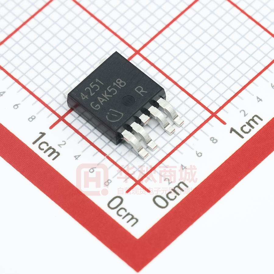

The TLE 4251 is a monolithic integrated low drop voltage
tracker in the very small SMD package PG-TO252-5-1. It
P-TO263-5-1
is designed to supply e.g. sensors under the severe
conditions of automotive applications. Therefore the
device is equipped with additional protection functions against overload, short circuit and
reverse polarity.
