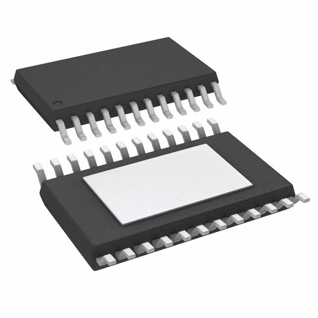

TLE94110EL Features • Ten half bridge power outputs • Very low power consumption in sleep mode • 3.3V / 5V compatible inputs with hysteresis • All outputs with overload and short circuit protection • Independently diagnosable outputs (overcurrent, open load) • Open load diagnostics in ON-state for all high-side and low-side • Outputs with selectable open load thresholds (HS1, HS2) • 16-bit Standard SPI interface with daisy chain and in-frame response capability for control and diagnosis • Fast diagnosis with the global error flag • PWM capable outputs for frequencies 80Hz, 100Hz and 200Hz with 8-bit duty cycle resolution • Overtemperature pre-warning and protection • Over- and Undervoltage lockout • Cross-current protection Applications • HVAC Flap DC motors • Monostable and bistable Relays • Side mirror x-y adjustment and mirror fold • LEDs Description The TLE94110EL is a protected ten-fold half-bridge driver designed especially for automotive motion control applications such as Heating, Ventilation and Air Conditioning (HVAC) flap DC motor control. It is part of a larger family offering half-bridge drivers from three outputs to twelve outputs with direct interface or SPI interface. The half bridge drivers are designed to drive DC motor loads in sequential or parallel operation. Operation modes forward (cw), reverse (ccw), brake and high impedance are controlled from a 16-bit SPI interface. It offers diagnosis features such as short circuit, open load, power supply failure and overtemperature detection. In combination with its low quiescent current, this device is attractive among others for automotive applications. The small fine pitch exposed pad package, PG-SSOP-24, provides good thermal performance and reduces PCB-board space and costs. Data Sheet www.infineon.com 1 1.0 2016-08-27 TLE94110EL Type Package Marking TLE94110EL PG-SSOP-24 TLE94110EL Table 1 Product Summary Normal Operating Voltage VS 5.5 ... 18 V Extended Operating Voltage VS 18 ... 20 V Logic Supply Voltage VDD 3.0 ... 5.5 V Maximum Supply Voltage for Load Dump Protection VS(LD) 40 V Minimum Overcurrent Threshold ISD 0.9 A Maximum On-State Path Resistance at Tj = 150°C RDSON(total)_HSx+LSy 1.8 + 1.8 Ω Typical Quiescent Current at Tj = 85°C ISQ 0.1 µA Maximum SPI Access Frequency fSCLK 5 MHz Data Sheet 2 1.0 2016-08-27 TLE94110EL Table of Contents 1 1.1 1.2 Pin Configuration . . . . . . . . . . . . . . . . . . . . . . . . . . . . . . . . . . . . . . . . . . . . . . . . . . . . . . . . . . . . . . . 5 Pin Assignment . . . . . . . . . . . . . . . . . . . . . . . . . . . . . . . . . . . . . . . . . . . . . . . . . . . . . . . . . . . . . . . . . . . . . . . . . . . 5 Pin Definitions and Functions . . . . . . . . . . . . . . . . . . . . . . . . . . . . . . . . . . . . . . . . . . . . . . . . . . . . . . . . . . . . . . 5 2 2.1 Block Diagram . . . . . . . . . . . . . . . . . . . . . . . . . . . . . . . . . . . . . . . . . . . . . . . . . . . . . . . . . . . . . . . . . . 7 Voltage and current definition . . . . . . . . . . . . . . . . . . . . . . . . . . . . . . . . . . . . . . . . . . . . . . . . . . . . . . . . . . . . . 8 3 3.1 3.2 3.3 3.4 General Product Characteristics . . . . . . . . . . . . . . . . . . . . . . . . . . . . . . . . . . . . . . . . . . . . . . . . . . . 9 Absolute Maximum Ratings . . . . . . . . . . . . . . . . . . . . . . . . . . . . . . . . . . . . . . . . . . . . . . . . . . . . . . . . . . . . . . . . 9 Functional Range . . . . . . . . . . . . . . . . . . . . . . . . . . . . . . . . . . . . . . . . . . . . . . . . . . . . . . . . . . . . . . . . . . . . . . . . 11 Thermal Resistance . . . . . . . . . . . . . . . . . . . . . . . . . . . . . . . . . . . . . . . . . . . . . . . . . . . . . . . . . . . . . . . . . . . . . . 12 Electrical Characteristics . . . . . . . . . . . . . . . . . . . . . . . . . . . . . . . . . . . . . . . . . . . . . . . . . . . . . . . . . . . . . . . . . 13 4 Characterization results . . . . . . . . . . . . . . . . . . . . . . . . . . . . . . . . . . . . . . . . . . . . . . . . . . . . . . . . 18 5 5.1 5.2 5.2.1 5.2.2 5.3 5.4 General Description . . . . . . . . . . . . . . . . . . . . . . . . . . . . . . . . . . . . . . . . . . . . . . . . . . . . . . . . . . . . Power Supply . . . . . . . . . . . . . . . . . . . . . . . . . . . . . . . . . . . . . . . . . . . . . . . . . . . . . . . . . . . . . . . . . . . . . . . . . . . Operation modes . . . . . . . . . . . . . . . . . . . . . . . . . . . . . . . . . . . . . . . . . . . . . . . . . . . . . . . . . . . . . . . . . . . . . . . Normal mode . . . . . . . . . . . . . . . . . . . . . . . . . . . . . . . . . . . . . . . . . . . . . . . . . . . . . . . . . . . . . . . . . . . . . . . . . . Sleep mode . . . . . . . . . . . . . . . . . . . . . . . . . . . . . . . . . . . . . . . . . . . . . . . . . . . . . . . . . . . . . . . . . . . . . . . . . . . Reset Behaviour . . . . . . . . . . . . . . . . . . . . . . . . . . . . . . . . . . . . . . . . . . . . . . . . . . . . . . . . . . . . . . . . . . . . . . . . . Reverse Polarity Protection . . . . . . . . . . . . . . . . . . . . . . . . . . . . . . . . . . . . . . . . . . . . . . . . . . . . . . . . . . . . . . . 23 23 23 23 23 23 24 6 6.1 6.1.1 6.1.1.1 6.1.1.2 6.2 6.2.1 6.2.2 6.2.3 6.2.4 6.2.4.1 6.2.4.2 6.2.4.3 6.2.5 Half-Bridge Outputs . . . . . . . . . . . . . . . . . . . . . . . . . . . . . . . . . . . . . . . . . . . . . . . . . . . . . . . . . . . . Functional Description . . . . . . . . . . . . . . . . . . . . . . . . . . . . . . . . . . . . . . . . . . . . . . . . . . . . . . . . . . . . . . . . . . . Half-bridge operation with PWM enabled . . . . . . . . . . . . . . . . . . . . . . . . . . . . . . . . . . . . . . . . . . . . . . . . . Inductive Load . . . . . . . . . . . . . . . . . . . . . . . . . . . . . . . . . . . . . . . . . . . . . . . . . . . . . . . . . . . . . . . . . . . . . . LED mode (optional) . . . . . . . . . . . . . . . . . . . . . . . . . . . . . . . . . . . . . . . . . . . . . . . . . . . . . . . . . . . . . . . . . Protection & Diagnosis . . . . . . . . . . . . . . . . . . . . . . . . . . . . . . . . . . . . . . . . . . . . . . . . . . . . . . . . . . . . . . . . . . . Short Circuit of Output to Supply or Ground . . . . . . . . . . . . . . . . . . . . . . . . . . . . . . . . . . . . . . . . . . . . . . Cross-Current . . . . . . . . . . . . . . . . . . . . . . . . . . . . . . . . . . . . . . . . . . . . . . . . . . . . . . . . . . . . . . . . . . . . . . . . . Temperature Monitoring . . . . . . . . . . . . . . . . . . . . . . . . . . . . . . . . . . . . . . . . . . . . . . . . . . . . . . . . . . . . . . . Overvoltage and undervoltage shutdown . . . . . . . . . . . . . . . . . . . . . . . . . . . . . . . . . . . . . . . . . . . . . . . . VS Undervoltage . . . . . . . . . . . . . . . . . . . . . . . . . . . . . . . . . . . . . . . . . . . . . . . . . . . . . . . . . . . . . . . . . . . . . VS Overvoltage . . . . . . . . . . . . . . . . . . . . . . . . . . . . . . . . . . . . . . . . . . . . . . . . . . . . . . . . . . . . . . . . . . . . . . VDD Undervoltage . . . . . . . . . . . . . . . . . . . . . . . . . . . . . . . . . . . . . . . . . . . . . . . . . . . . . . . . . . . . . . . . . . . . Open Load . . . . . . . . . . . . . . . . . . . . . . . . . . . . . . . . . . . . . . . . . . . . . . . . . . . . . . . . . . . . . . . . . . . . . . . . . . . . 25 25 25 26 28 29 31 33 35 36 36 36 36 37 7 7.1 7.1.1 7.1.2 7.1.3 7.2 7.3 7.4 7.5 7.6 7.6.1 7.7 Serial Peripheral Interface (SPI) . . . . . . . . . . . . . . . . . . . . . . . . . . . . . . . . . . . . . . . . . . . . . . . . . . SPI Description . . . . . . . . . . . . . . . . . . . . . . . . . . . . . . . . . . . . . . . . . . . . . . . . . . . . . . . . . . . . . . . . . . . . . . . . . . Global Error Flag . . . . . . . . . . . . . . . . . . . . . . . . . . . . . . . . . . . . . . . . . . . . . . . . . . . . . . . . . . . . . . . . . . . . . . . Global Status Register . . . . . . . . . . . . . . . . . . . . . . . . . . . . . . . . . . . . . . . . . . . . . . . . . . . . . . . . . . . . . . . . . . SPI protocol error detection . . . . . . . . . . . . . . . . . . . . . . . . . . . . . . . . . . . . . . . . . . . . . . . . . . . . . . . . . . . . SPI with independent slave configuration . . . . . . . . . . . . . . . . . . . . . . . . . . . . . . . . . . . . . . . . . . . . . . . . . . Daisy chain operation . . . . . . . . . . . . . . . . . . . . . . . . . . . . . . . . . . . . . . . . . . . . . . . . . . . . . . . . . . . . . . . . . . . . Status register change during SPI communication . . . . . . . . . . . . . . . . . . . . . . . . . . . . . . . . . . . . . . . . . . SPI Bit Mapping . . . . . . . . . . . . . . . . . . . . . . . . . . . . . . . . . . . . . . . . . . . . . . . . . . . . . . . . . . . . . . . . . . . . . . . . . SPI Control Registers . . . . . . . . . . . . . . . . . . . . . . . . . . . . . . . . . . . . . . . . . . . . . . . . . . . . . . . . . . . . . . . . . . . . . Control register definition . . . . . . . . . . . . . . . . . . . . . . . . . . . . . . . . . . . . . . . . . . . . . . . . . . . . . . . . . . . . . . SPI Status Registers . . . . . . . . . . . . . . . . . . . . . . . . . . . . . . . . . . . . . . . . . . . . . . . . . . . . . . . . . . . . . . . . . . . . . . 38 38 39 40 41 43 45 47 50 52 53 65 Data Sheet 3 1.0 2016-08-27 TLE94110EL 7.7.1 Status register definition . . . . . . . . . . . . . . . . . . . . . . . . . . . . . . . . . . . . . . . . . . . . . . . . . . . . . . . . . . . . . . . 66 8 8.1 8.2 8.3 Application Information . . . . . . . . . . . . . . . . . . . . . . . . . . . . . . . . . . . . . . . . . . . . . . . . . . . . . . . . Application Diagram . . . . . . . . . . . . . . . . . . . . . . . . . . . . . . . . . . . . . . . . . . . . . . . . . . . . . . . . . . . . . . . . . . . . . Thermal application information . . . . . . . . . . . . . . . . . . . . . . . . . . . . . . . . . . . . . . . . . . . . . . . . . . . . . . . . . . EMC Enhancement . . . . . . . . . . . . . . . . . . . . . . . . . . . . . . . . . . . . . . . . . . . . . . . . . . . . . . . . . . . . . . . . . . . . . . . 9 Package Outlines . . . . . . . . . . . . . . . . . . . . . . . . . . . . . . . . . . . . . . . . . . . . . . . . . . . . . . . . . . . . . . 78 10 Revision History . . . . . . . . . . . . . . . . . . . . . . . . . . . . . . . . . . . . . . . . . . . . . . . . . . . . . . . . . . . . . . . 79 Data Sheet 4 73 73 76 77 1.0 2016-08-27 TLE94110EL Pin Configuration 1 Pin Configuration 1.1 Pin Assignment GND OUT 1 OUT 5 OUT 7 SDI VDD SDO EN OUT 9 OUT 6 OUT 4 GND 24 23 22 21 20 19 18 17 16 15 14 13 1 2 3 4 5 6 7 8 9 10 11 12 Figure 1 Pin Configuration TLE94110EL 1.2 Pin Definitions and Functions GND OUT 2 OUT 8 VS2 SCLK CSN N.U. N.U. VS1 OUT 10 OUT 3 GND Pin Symbol Function 1 GND Ground. All ground pins should be externally connected together. 2 OUT 1 Power half-bridge 1 3 OUT 5 Power half-bridge 5 4 OUT 7 Power half-bridge 7 5 SDI Serial data input with internal pull down 6 VDD Logic supply voltage 7 SDO Serial data output 8 EN Enable with internal pull-down; Places device in standby mode by pulling the EN line Low 9 OUT 9 Power half-bridge 9 10 OUT 6 Power half-bridge 6 11 OUT 4 Power half-bridge 4 12 GND Ground. All ground pins should be externally connected together. Data Sheet 5 1.0 2016-08-27 TLE94110EL Pin Configuration Pin Symbol Function 13 GND Ground. All ground pins should be externally connected together. 14 OUT 3 Power half-bridge 3 15 OUT 10 Power half-bridge 10 16 VS1 Main supply voltage for power half bridges. VS1 should be externally connected to VS2. 17 N.U. Not used. This pin should be left open. 18 N.U. Not used. This pin should be left open. 19 CSN Chip select Not input with internal pull up 20 SCLK Serial clock input with internal pull down 21 VS2 Main supply voltage for power half bridges. VS1 should be externally connected to VS2. 22 OUT 8 Power half-bridge 8 23 OUT 2 Power half-bridge 2 24 GND Ground. All ground pins should be externally connected together. EDP - Exposed Die Pad; For cooling and EMC purposes only - not usable as electrical ground. Electrical ground must be provided by pins 1,12,13,24.1) 1) The exposed die pad at the bottom of the package allows better heat dissipation from the device via the PCB. The exposed pad (EP) must be either left open or connected to GND. It is recommended to connect EP to GND for best EMC and thermal performance. Note: Data Sheet Not used (N.U.) pins and unused outputs are recommended to be left unconnected (open) on the application board. If N.U. pins or unused output pins are routed to an external connector which leaves the PCB, then these outputs should have provision for a zero ohm jumper (depopulated if unused) or ESD protection. In other words, they should be treated like used pins. 6 1.0 2016-08-27 TLE94110EL Block Diagram 2 Block Diagram VDD VS1 10-Fold Half Bridge Driver SPI Interface EN BIAS & MONITOR UNDERVOLTAGE & OVERVOLTAGE MONITOR SDI short short shortto toto short short open toto battery short short totoload battery battery detection short to battery battery detection battery battery detection detection battery detection detection detection detection detection short to ground detection overtemperature detection LOGIC CONTROL & LATCH SPI INTERFACE open load open openload load detection open load detection detection open load detection detection current current current open load current current control detection current current control control current current control control current control control control control short toto control short shortto to battery short short to battery short short toto detection battery short short toto battery battery short to detection battery battery detection battery battery detection detection battery detection detection overtemperature detection detection detection detection SDO ERROR DETECTION GND Figure 2 Data Sheet CHARGE PUMP P ower stage PWM GENERATOR CSN SCLK VS2 Power driver highhigh -side side high-side high -side high high -side -side driver driver high -side driver driver driver driver driver high -side driver temp temp temp temp temp sensor sensor sensor temp temp sensor sensor temp temp sensor sensor sensor sensor low-side low-side low-side low-side low-side low-side lowside driver driver driver low-side driver driver driver driver driver low-side driver OUT 1 OUT 2 OUT 3 temp sensor OUT 4 OUT 5 OUT 6 OUT 7 OUT 8 OUT 9 OUT 10 GND GND GND Block Diagram TLE94110EL (SPI Interface) 7 1.0 2016-08-27 TLE94110EL Block Diagram 2.1 Voltage and current definition Figure 3 shows terms used in this datasheet, with associated convention for positive values. VS IS1 VS1 IDD ISDO VDD I S2 VS2 VDD SDO VSDO ISDI V SDI I CSN VCSN ISCLK V SCLK SDI SPI INTERFACE DRIVER CSN SCLK I OUTx VDS HSx OUT x VDSLSx IEN EN V EN GND GND GND GND IGND I GND IGND Figure 3 Data Sheet IGND Voltage and Current Definition 8 1.0 2016-08-27 TLE94110EL General Product Characteristics 3 General Product Characteristics 3.1 Absolute Maximum Ratings Table 2 Absolute Maximum Ratings1)Tj = -40°C to +150°C Parameter Symbol Values Min. Typ. Max. Unit Note or Test Condition Number Voltages Supply voltage VS -0.3 – 40 V VS = VS1 = VS2 P_4.1.1 Supply Voltage Slew Rate | dVS/dt | – – 10 V/µs VS increasing and decreasing 1) P_4.2.2 Power half-bridge output voltage VOUT -0.3 – 40 V 0 V < VOUT < VS 2) P_4.1.2 Logic supply voltage VDD -0.3 – 5.5 V 0 V < VS < 40 V P_4.1.3 Logic input voltages (SDI, SCLK, CSN, EN) VSDI, VSCLK, VCSN, VEN -0.3 – VDD V 0 V < VS < 40 V 0 V < VDD < 5.5V P_4.1.4 Logic output voltage (SDO) VSDO -0.3 – VDD V 0 V < VS < 40 V 0 V < VDD < 5.5V P_4.1.5 Continuous Supply Current for VS1 IS1 0 – 2.5 A – P_4.1.6 Continuous Supply Current for VS2 IS2 0 – 2.5 A – P_4.1.7 Current per GND pin IGND 0 – 2.0 A – P_4.1.14 Output Currents IOUT -2.0 – 2.0 A – P_4.1.15 Junction temperature Tj -40 – 150 °C – P_4.1.8 Storage temperature Tstg -50 – 150 °C – P_4.1.9 ESD susceptibility OUTn and VSx pins versus GND. All other pins grounded. VESD -8 – 8 kV JEDEC HBM1)3) P_4.1.10 ESD susceptibility all pins VESD -2 – 2 kV JEDEC HBM1)3) P_4.1.11 ESD susceptibility all pins VESD -500 – 500 V CDM1)4) P_4.1.12 V 1)4) P_4.1.13 Currents Temperatures ESD Susceptibility ESD susceptibility corner pins 1) 2) 3) 4) VESD -750 – 750 CDM Not subject to production test, specified by design Also applicable to not used (N.U.) pins ESD susceptibility, “JEDEC HBM” according to ANSI/ ESDA/ JEDEC JS001 (1.5 kΩ, 100pF) ESD susceptibility, Charged Device Model “CDM” according JEDEC JESD22-C101 Data Sheet 9 1.0 2016-08-27 TLE94110EL General Product Characteristics Notes 1. Stresses above the ones listed here may cause permanent damage to the device. Exposure to absolute maximum rating conditions for extended periods may affect device reliability. 2. Integrated protection functions are designed to prevent IC destruction under fault conditions described in the data sheet. Fault conditions are considered as “outside” normal operating range. Protection functions are not designed for continuous repetitive operation. Data Sheet 10 1.0 2016-08-27 TLE94110EL General Product Characteristics 3.2 Functional Range Table 3 Functional Range Parameter Symbol Values Min. Typ. Max. Unit Note or Test Condition Number Supply voltage range for normal operation VS(nor) 5.5 – 18 V – P_4.2.1 Extended supply voltage range VS(ext) 18 – 20 V 1)2) P_4.2.7 Logic supply voltage range for normal operation VDD 3.0 – 5.5 V – P_4.2.3 Logic input voltages (SDI, SCLK, CSN, EN) VSDI, VSCLK, VCSN, VEN -0.3 – 5.5 V – P_4.2.4 Junction temperature Tj -40 – 150 °C P_4.2.5 1) Not subject to production test, specified by design. 2) In the extended supply range, the device is still functional. However, deviations of the specified electrical characteristics are possible. Note: Data Sheet Within the normal functional range the IC operates as described in the circuit description. The electrical characteristics are specified within the conditions given in the related electrical characteristics table. 11 1.0 2016-08-27 TLE94110EL General Product Characteristics 3.3 Thermal Resistance Table 4 Thermal Resistance TLE94110EL Parameter Symbol Values Min. Typ. Max. Unit Note or Test Condition Junction to Case, TA = -40°C RthjC_cold – 5 – K/W 1) Junction to Case, TA = 85°C RthjC_hot – 6 – K/W 1) Junction to ambient, TA = -40°C (1s0p, minimal footprint) RthjA_cold_ – 71 – K/W 1) 2) RthjA_hot_m – 73 – K/W 1) 2) 43 – K/W 1) 3) 47 – K/W 1) 3) 42 – K/W 1) 4) 46 – K/W 1) 4) 26 – K/W 1) 5) 32 – K/W 1) 5) Junction to ambient, TA = 85°C (1s0p, minimal footprint) Junction to ambient, TA = -40°C (1s0p, 300mm2 Cu) Junction to ambient, TA = 85°C (1s0p, 300mm2 Cu) Junction to ambient, TA = -40°C (1s0p, 600mm2 Cu) Junction to ambient, TA = 85°C (1s0p, 600mm2 Cu) Junction to ambient, TA = -40°C (2s2p) Junction to ambient, TA = 85°C (2s2p) Number min in RthjA_cold_3 – 00 RthjA_hot_30 – 0 RthjA_cold_6 – 00 RthjA_hot_60 – 0 RthjA_cold_2 – s2p RthjA_hot_2s – 2p 1) Not subject to production test, specified by design. 2) Specified RthJA value is according to JEDEC JESD51-2, -3 at natural convection on FR4 1s0p board; The product (chip + package) was simulated on a 76.2 x 114.3 x 1.5mm board with minimal footprint copper area and 35µm thickness. Ta = -40°C, each channel dissipates 0.2W. Ta = 85°C, each channel dissipates 0.135W. 3) Specified RthJA value is according to JEDEC JESD51-2, -3 at natural convection on FR4 1s0p board; The product (chip + package) was simulated on a 76.2 x 114.3 x 1.5mm board with additional cooling of 300mm2 copper area and 35µm thickness. Ta = -40°C, each channel dissipates 0.2W. Ta = 85°C, each channel dissipates 0.135W. 4) Specified RthJA value is according to JEDEC JESD51-2, -3 at natural convection on FR4 1s0p board; The product (chip + package) was simulated on a 76.2 x 114.3 x 1.5mm board with additional cooling of 600mm2 copper area and 35µm thickness. Ta = -40°C, each channel dissipates 0.2W. Ta = 85°C, each channel dissipates 0.135W. 5) Specified RthJA value is according to JEDEC JESD51-2, -3 at natural convection on FR4 2s2p board; The product (chip + package) was simulated on a 76.2 x 114.3 x 1.5mm board with two inner copper layers ( 4 x 35µm Cu). Ta = -40°C, each channel dissipates 0.2W. Ta = 85°C, each channel dissipates 0.135W. Data Sheet 12 1.0 2016-08-27 TLE94110EL General Product Characteristics 3.4 Electrical Characteristics Table 5 Electrical Characteristics, VS =5.5 V to 18 V, VDD = 3.0V to 5.5V, Tj = -40°C to +150°C, EN= HIGH, IOUTn= 0 A; Typical values refer to VDD = 5.0 V, VS = 13.5 V and TJ = 25 °C unless otherwise specified; all voltages with respect to ground, positive current flowing into pin (unless otherwise specified) Parameter Symbol Values Unit Note or Test Condition Number Min. Typ. Max. – 0.5 2 µA -40°C ≤ Tj ≤ 85°C P_4.4.1 Logic supply quiescent current IDD_Q – 0.1 1 µA -40°C ≤ Tj ≤ 85°C P_4.4.2 Total quiescent current – 0.6 3 µA -40°C ≤ Tj ≤ 85°C P_4.4.3 Current Consumption, EN = GND Supply Quiescent current ISQ ISQ + IDD_Q Current Consumption, EN=HIGH Supply current IS – 0.5 1 mA Power drivers and power stages are off P_4.4.4 Supply current IS_HSON – 4.5 9 mA All high-sides ON1) P_4.4.101 Logic supply current IDD – 1.5 3 mA SPI not active P_4.4.5 Logic supply current IDD_RUN – 5 – mA SPI 5MHz 3) P_4.4.6 3) P_4.4.7 Total supply current IS + IDD_RUN – 5.5 – mA SPI 5MHz Over- and Undervoltage Lockout Undervoltage Switch ON voltage threshold VUV ON 4.25 – 5.25 V VS increasing P_4.4.8 Undervoltage Switch OFF voltage threshold VUV OFF 4 – 5.0 V VS decreasing P_4.4.9 Undervoltage Switch ON/OFF hysteresis VUV HY – 0.25 – V VUV ON - VUV OFF 3) P_4.4.10 Overvoltage Switch OFF voltage VOV OFF threshold 21 – 25 V VS increasing P_4.4.11 Overvoltage Switch ON voltage VOV ON threshold 20 – 24 V VS decreasing P_4.4.12 Overvoltage Switch ON/OFF hysteresis VOV HY – 1 – V VOV OFF - VOV ON 3) P_4.4.13 VDD Power-On-Reset VDD POR 2.40 2.70 2.90 V VDD increasing P_4.4.14 VDD Power-Off-Reset VDD POffR 2.35 2.65 2.85 V VDD decreasing P_4.4.15 VDD Power ON/OFF hysteresis VDD POR HY – 0.05 – V VDD POR - VDD POffR 3) P_4.4.98 Static Drain-source ON-Resistance (High-Side or Low-Side) High-Side or Low-Side RDSON (all outputs) RDSON_HB_25C – 850 1200 mΩ IOUT = ±0.5 A; Tj = 25 °C P_4.4.16 High-Side or Low-Side RDSON (all outputs) RDSON_HB_150 – 1400 1800 mΩ IOUT = ±0.5 A; Tj = 150 °C P_4.4.17 Data Sheet C 13 1.0 2016-08-27 TLE94110EL General Product Characteristics Table 5 Electrical Characteristics, VS =5.5 V to 18 V, VDD = 3.0V to 5.5V, Tj = -40°C to +150°C, EN= HIGH, IOUTn= 0 A; Typical values refer to VDD = 5.0 V, VS = 13.5 V and TJ = 25 °C unless otherwise specified; all voltages with respect to ground, positive current flowing into pin (unless otherwise specified) (cont’d) Parameter Symbol Values Min. High-Side RDSON (HS1 and HS2 in LED mode) High-Side RDSON (HS1 and HS2 in LED mode) RDSON_HI_HB_ – Unit Note or Test Condition Number 1300 mΩ 2) IOUT = ±0.1 A; Tj = 25 °C P_4.4.18 1500 2000 mΩ 2) P_4.4.19 Typ. Max. 950 25C RDSON_HI_HB_ – 150C IOUT = ±0.1 A; Tj = 150 °C Output Protection and Diagnosis of high-side (HS) channels of half-bridge output HS Overcurrent Shutdown Threshold ISD_HS -1.4 -1.1 -0.9 A See Figure 7 P_4.4.89 Difference between shutdown and limit current ILIM_HS ISD_HS -1.2 -0.6 0 A 3) |ILIM_HS| ≥ |ISD_HS| See Figure 7 P_4.4.21 Overcurrent Shutdown filter time tdSD_HS 15 19 23 µs 3) P_4.4.22 Open Load Detection Current IOLD1_HS -15 -8 -3 mA - P_4.4.23 P_4.4.24 P_4.4.25 Open Load Detection filter time tOLD1_HS 2000 3000 4000 µs 3) Open Load Detection Current for LED mode (HS1 & HS2) IOLD2_HS1,2 -3.2 -2 -0.5 mA Bit OL_SEL_HS1 = 1, OL_SEL_HS2 = 1 Open Load Detection filter time tOLD2_HS1,2 for LED mode (HS1 & HS2) 100 200 300 µs Bit OL_SEL_HS1 = P_4.4.26 1, OL_SEL_HS2 = 1; 3) Output Protection and Diagnosis of low-side (LS) channels of half-bridge output LS Overcurrent Shutdown Threshold ISD_LS 0.9 1.1 1.4 A Figure 8 P_4.4.104 Difference between shutdown and limit current ILIM_LS ISD_LS 0 0.6 1.2 A 3) ILIM_LS ≥ ISD_LS Figure 8 P_4.4.28 Overcurrent Shutdown filter time tdSD_LS 15 19 23 µs 3) P_4.4.29 Open Load Detection Current IOLD_LS 3 8 15 mA - P_4.4.30 P_4.4.31 Open Load Detection filter time tOLD_LS 2000 3000 4000 µs 3) Outputs OUT(1...n) leakage current HS leakage current in off state IQLHn_NOR -2 -0.5 – µA VOUTn = 0V ; EN=High P_4.4.32 HS leakage current in off state IQLHn_SLE -2 -0.5 – µA VOUTn = 0V; EN=GND P_4.4.33 LS Leakage current in off state IQLLn_NOR – 0.5 2 µA VOUTn = VS ; EN=High P_4.4.34 LS Leakage current in off state IQLLn_SLE – 0.5 2 µA VOUTn = VS ; EN=GND P_4.4.35 0.75 V/µs Resistive load = 100Ω; VS=13.5V 4) Output Switching Times. See Figure 9 and Figure 10. Slew rate of high-side and low- dVOUT/ dt side outputs Data Sheet 0.1 0.45 14 P_4.4.36 1.0 2016-08-27 TLE94110EL General Product Characteristics Table 5 Electrical Characteristics, VS =5.5 V to 18 V, VDD = 3.0V to 5.5V, Tj = -40°C to +150°C, EN= HIGH, IOUTn= 0 A; Typical values refer to VDD = 5.0 V, VS = 13.5 V and TJ = 25 °C unless otherwise specified; all voltages with respect to ground, positive current flowing into pin (unless otherwise specified) (cont’d) Parameter Symbol Values Min. Typ. Max. Unit Note or Test Condition Number Output delay time high side driver on tdONH 5 20 35 µs Resistive load = 100Ω to GND P_4.4.37 Output delay time high side driver off tdOFFH 15 45 75 µs Resistive load = 100Ω to GND P_4.4.38 Output delay time low side driver on tdONL 5 20 35 µs Resistive load = 100Ω to VS P_4.4.39 Output delay time low side driver off tdOFFL 15 45 75 µs Resistive load = 100Ω to VS P_4.4.40 Cross current protection time, high to low tDHL 100 130 160 µs Resistive load = 100Ω3) P_4.4.41 Cross current protection time, low to high tDLH 100 130 160 µs Resistive load = 100Ω3) P_4.4.42 High-input voltage VENH 0.7 * VDD – – V – P_4.4.43 Low-input voltage VENL – – 0.3 * VDD V – P_4.4.44 Hysteresis of input voltage VENHY – 500 – mV 3) P_4.4.45 Pull down resistor RPD_EN 20 40 70 kΩ VEN = 0.2 x VDD P_4.4.46 fSPI,max – – 5.0 MHz 3) 5) P_4.4.47 µs 3) P_4.4.48 Input Interface: Logic Input EN SPI frequency Maximum SPI frequency SPI INTERFACE: Delay Time from EN rising edge to first Data in Setup time tset – – 150 See Figure 14 SPI INTERFACE: Input Interface, Logic Inputs SDI, SCLK, CSN H-input voltage threshold VIH 0.7 * VDD – – V – P_4.4.50 L-input voltage threshold VIL – – 0.3 * VDD V – P_4.4.51 Hysteresis of input voltage VIHY – 500 – mV 3) P_4.4.52 Pull up resistor at pin CSN RPU_CSN 30 50 80 kΩ VCSN = 0.7 x VDD P_4.4.53 Pull down resistor at pin SDI, SCLK RPD_SDI, RPD_SCLK 20 40 70 kΩ VSDI, VSCLK = 0.2 x VDD P_4.4.54 Input capacitance at pin CSN, SDI or SCLK CI – 10 15 pF 0V < VDD < 5.25V 3) P_4.4.55 VDD 0.4 VDD - – 0.2 V ISDOH = -1.6 mA P_4.4.56 Input Interface, Logic Output SDO H-output voltage level Data Sheet VSDOH 15 1.0 2016-08-27 TLE94110EL General Product Characteristics Table 5 Electrical Characteristics, VS =5.5 V to 18 V, VDD = 3.0V to 5.5V, Tj = -40°C to +150°C, EN= HIGH, IOUTn= 0 A; Typical values refer to VDD = 5.0 V, VS = 13.5 V and TJ = 25 °C unless otherwise specified; all voltages with respect to ground, positive current flowing into pin (unless otherwise specified) (cont’d) Parameter Symbol Values Min. Typ. Max. Unit Note or Test Condition Number L-output voltage level VSDOL – 0.2 0.4 V ISDOL = 1.6 mA P_4.4.57 Tri-state Leakage Current ISDOLK -1 – 1 µA VCSN = VDD; 0V < VSDO < VDD P_4.4.58 Tri-state input capacitance CSDO – 10 15 pF 3) P_4.4.59 – – ns 3) P_4.4.60 P_4.4.61 Data Input Timing. See Figure 15 and Figure 17. SCLK Period tpCLK 200 SCLK High Time tSCLKH 0.45 * – tpCLK 0.55 * ns tpCLK 3) SCLK Low Time tSCLKL 0.45 * – tpCLK 0.55 * ns tpCLK 3) P_4.4.62 SCLK Low before CSN Low tBEF 125 – ns 3) P_4.4.63 P_4.4.64 – CSN Setup Time tlead 250 – – ns 3) SCLK Setup Time tlag 250 – – ns 3) P_4.4.65 ns 3) P_4.4.66 ns 3) P_4.4.67 ns 3) P_4.4.68 P_4.4.69 SCLK Low after CSN High SDI Setup Time SDI Hold Time tBEH tSDI_setup tSDI_hold 125 30 30 – – – – – – trIN – – 50 ns 3) Input Signal Fall Time at pin SDI, tfIN SCLK, CSN – – 50 ns 3) P_4.4.70 Delay time from EN falling edge tDMODE to standby mode – – 8 µs 3) P_4.4.71 Minimum CSN High Time 5 – – µs 3) P_4.4.72 – 30 80 ns Cload = 40pF 3) ns 3) Input Signal Rise Time at pin SDI, SCLK, CSN tCSNH Data Output Timing. See Figure 15. SDO Rise Time SDO Fall Time trSDO tfSDO – 30 80 Cload = 40pF P_4.4.73 P_4.4.74 3) P_4.4.75 SDO Enable Time after CSN falling edge tENSDO – – 75 ns Low Impedance SDO Disable Time after CSN rising edge tDISSDO – – 75 ns High Impedance 3) P_4.4.76 Duty cycle of incoming clock at dutySCLK SCLK 45 – 55 % 3) P_4.4.77 SDO Valid Time for VDD = 3.3V – 70 95 ns VSDO < 0.2 x VDD VSDO > 0.8 x VDD Cload = 40pF 3) P_4.4.78 Data Sheet tVASDO3 16 1.0 2016-08-27 TLE94110EL General Product Characteristics Table 5 Electrical Characteristics, VS =5.5 V to 18 V, VDD = 3.0V to 5.5V, Tj = -40°C to +150°C, EN= HIGH, IOUTn= 0 A; Typical values refer to VDD = 5.0 V, VS = 13.5 V and TJ = 25 °C unless otherwise specified; all voltages with respect to ground, positive current flowing into pin (unless otherwise specified) (cont’d) Parameter Symbol Values Unit Note or Test Condition Number Min. Typ. Max. tVASDO5 – 50 65 ns VSDO < 0.2 x VDD VSDO > 0.8 VDD Cload = 40pF 3) P_4.4.79 Thermal warning junction temperature TjW 120 140 170 °C See Figure 113) P_4.4.80 Thermal shutdown junction temperature TjSD 150 175 200 °C See Figure 113) P_4.4.81 Thermal comparator hysteresis TjHYS – 5 – °C 3) P_4.4.82 Ratio of SD to W temperature 1.05 1.20 – – 3) P_4.4.83 SDO Valid Time for VDD = 5V Thermal warning & Shutdown 1) 2) 3) 4) 5) TjSD / TjW IS_HSON does not include the load current HS1, respectively HS2, is set to LED mode by setting OL_SEL_HS1 bit to 1, respectively OL_SEL_HS2 bit to 1 Not subject to production test, specified by design Measured for 20% - 80% of VS. Not applicable in daisy chain configuration Data Sheet 17 1.0 2016-08-27 TLE94110EL Characterization results 4 Characterization results Performed on 7 devices from 2 lots, over operating temperature and nominal/extended supply range. Typical performance characteristics Supply quiescent current Supply current P_4.4.4 300 4.9 250 3.9 200 IS[uA] ISQ [uA] P_4.4.1 5.9 2.9 150 1.9 100 0.9 50 ‐0.1 0 -50 -30 -10 VS=5.5V 10 30 50 70 90 110 130 150 Junction Temperature [°C] VS=13.5V VS=18V VS=19V -50 -30 -10 VS=21 Logic supply quiescent current VS=5.5V 10 30 50 70 90 110 130 150 Junction Temperature [°C] VS=13.5V VS=18V VS=19V VS=21V Logic supply current P_4.4.2 P_4.4.5 0.4 0.89 0.35 0.3 0.88 0.2 IDD[mA] IDD_Q[uA] 0.25 0.15 0.1 0.87 0.86 0.05 0 0.85 -0.05 -0.1 0.84 -50 -30 -10 VS=5.5V Data Sheet 10 30 50 70 90 110 130 150 Junction Temperature [°C] VS=13.5V VS=18V VS=19V -50 -30 -10 VS=21V VS=5.5V 18 10 30 50 70 90 110 130 150 Junction Temperature [°C] VS=13.5V VS=18V VS=19V VS=21V 1.0 2016-08-27 TLE94110EL Characterization results HS static Drain-source ON-resistance LS static Drain-source ON-resistance P_4.4.16 and P_4.4.17 P_4.4.16 and P_4.4.17 1500 1600 1400 1500 1400 1300 1200 RDSON_LS [mΩ] RDSON_HS [mΩ] 1300 1100 1000 900 1200 1100 1000 900 800 800 700 700 600 600 -50 -30 -10 10 30 50 70 90 110 130 150 Junction Temperature [°C] -50 -30 -10 10 30 50 70 90 110 130 150 Junction Temperature [°C] VS=5.5V VS=13.5V VS=18V VS=19V VS=5.5V VS=21V HS static drain-source ON-resistance VS = 13.5V and VDD = 5V VS=18V VS=19V VS=21V LS static drain-source ON-resistance VS = 13.5V and VDD = 5V P_4.4.16 and P_4.4.17 P_4.4.16 and P_4.4.17 1600 1600 1500 1500 1400 1400 1300 1300 RDSON_LS [mΩ] RDSON_HS [mΩ] VS=13.5V 1200 1100 1000 1200 1100 1000 900 900 800 800 700 700 600 600 -50 -30 -10 Data Sheet -50 -30 -10 10 30 50 70 90 110 130 150 Junction Temperature [°C] 10 30 50 70 90 110 130 150 Junction Temperature [°C] OUT1 OUT2 OUT3 OUT4 OUT5 OUT1 OUT2 OUT3 OUT4 OUT5 OUT6 OUT7 OUT8 OUT9 OUT10 OUT6 OUT7 OUT8 OUT9 OUT10 19 1.0 2016-08-27 TLE94110EL Characterization results Slew rate ON of high-side outputs Slew rate ON of low-side outputs P_4.4.36 P_4.4.36 0.6 0.65 0.55 0.6 0.55 dVOUT/ dt [V/us] dVOUT/ dt [V/us] 0.5 0.45 0.4 0.35 0.3 0.5 0.45 0.4 0.35 0.3 0.25 0.25 0.2 0.2 -50 -30 -10 VS=5.5V 10 30 50 70 90 110 130 150 Junction Temperature [°C] VS=13.5V VS=18V VS=19V -50 -30 -10 VS=21V Slew rate OFF of high-side outputs VS=5.5V 10 30 50 70 90 110 130 150 Junction Temperature [°C] VS=13.5V VS=19V VS=21V Slew rate OFF of low-side outputs P_4.4.36 P_4.4.36 0.65 0.65 0.6 0.6 0.55 0.55 0.5 0.5 dVOUT/ dt [V/us] dVOUT/ dt [V/us] VS=18V 0.45 0.4 0.35 0.45 0.4 0.35 0.3 0.3 0.25 0.25 0.2 0.2 -50 -30 -10 VS=5.5V Data Sheet 10 30 50 70 90 110 130 150 Junction Temperature [°C] VS=13.5V VS=18V VS=19V -50 -30 -10 VS=21V VS=5.5V 20 10 30 50 70 90 110 130 150 Junction Temperature [°C] VS=13.5V VS=18V VS=19V VS=21V 1.0 2016-08-27 TLE94110EL Characterization results HS overcurrent shutdown threshold LS overcurrent shutdown threshold P_4.4.89 P_4.4.104 -1000 1160 -1020 1140 -1040 1120 -1080 ISD_LS [mA] ISD_HS [mA] -1060 -1100 -1120 1100 1080 1060 -1140 1040 -1160 1020 -1180 -1200 1000 -50 -30 -10 VS=5.5V -50 -30 -10 10 30 50 70 90 110 130 150 Junction Temperature [°C] VS=13.5V VS=18V VS=19V VS=21V Undervoltage switch ON voltage threshold VS=5.5V 10 30 50 70 90 110 130 150 Junction Temperature [°C] VS=13.5V VS=18V VS=19V VS=21V Undervoltage switch OFF voltage threshold P_4.4.8 P_4.4.9 4.95 4.79 4.9 4.74 VUV_OFF [V] VUV_ON [V] 4.85 4.8 4.69 4.64 4.75 4.59 4.7 4.65 4.54 -50 -30 -10 10 30 50 70 90 110 130 150 Junction Temperature [°C] VDD=3V Data Sheet VDD=5V -50 -30 -10 10 30 50 70 90 110 130 150 Junction Temperature [°C] VDD=5.5V VDD=3V 21 VDD=5V VDD=5.5V 1.0 2016-08-27 TLE94110EL Characterization results Overvoltage switch ON voltage threshold Overvoltage switch OFF voltage threshold P_4.4.12 P_4.4.11 22.8 23.6 22.7 23.5 22.6 23.4 VOV_OFF [V] VOV_ON [V] 22.5 22.4 22.3 22.2 23.3 23.2 23.1 23 22.1 22.9 22 21.9 22.8 -50 -30 -10 10 30 50 70 90 110 130 150 Junction Temperature [°C] -50 -30 -10 10 30 50 70 90 110 130 150 Junction Temperature [°C] VDD=3V VDD=5V VDD=5.5V VDD=3V VDD=5V VDD=5.5V VDD Power-on-reset and VDD Power-off-reset P_4.4.14 and P_4.4.15 2.68 VDD threshold [V] 2.66 2.64 2.62 2.60 2.58 2.56 -50 -30 -10 10 30 50 70 90 110 130 150 Junction Temperature [°C] VDD POR Data Sheet VDD POffR 22 1.0 2016-08-27 TLE94110EL General Description 5 General Description 5.1 Power Supply The TLE94110EL has two power supply inputs, VS and VDD. The half bridge outputs are supplied by VS, which is connected to the 12V automotive supply rail. VDD is used to supply the I/O buffers and internal voltage regulator of the device. VS and VDD supplies are separated so that information stored in the logic block remains intact in the event of voltage drop outs or disturbances on VS. The system can therefore continue to operate once VS has recovered, without having to resend commands to the device. A rising edge on VDD crossing VDD POR triggers an internal Power-On Reset (POR) to initialize the IC at power-on. All data stored internally is deleted, and the outputs are switched off (high impedance). An electrolytic and 100nF ceramic capacitors are recommended to be placed as close as possible to the VS supply pin of the device for improved EMC performance in the high and low frequency band. The electrolytic capacitor must be dimensioned to prevent the VS voltage from exceeding the absolute maximum rating. In addition, decoupling capacitors are recommended on the VDD supply pin. 5.2 Operation modes 5.2.1 Normal mode The TLE94110EL enters normal mode by setting the EN input High. In normal mode, the charge pump is active and all output transistors can be configured via SPI. 5.2.2 Sleep mode The TLE94110EL enters sleep mode by setting the EN input Low. The EN input has an internal pull-down resistor. In sleep mode, all output transistors are turned off and the SPI register banks are reset. The current consumption is reduced to ISQ + IDD_Q. 5.3 Reset Behaviour The following reset triggers have been implemented in the TLE94110EL: VDD Undervoltage Reset: The SPI Interface shall not function if VDD is below the undervoltage threshold, VDD POffR. The digital block will be deactivated, the logic contents cleared and the output stages are switched off . The digital block is initialized once VDD voltage levels is above the undervoltage threshold, VDD POR. Then the NPOR bit is reset (NPOR = 0 in SYS_DIAG1 and Global Status Register). Reset on EN pin: If the EN pin is pulled Low, the logic content is reset and the device enters sleep mode. The reset event is reported by the NPOR bit (NPOR = 0) once the TLE94110EL is in normal mode (EN = High; VDD > VDD POR). Data Sheet 23 1.0 2016-08-27 TLE94110EL General Description 5.4 Reverse Polarity Protection The TLE94110EL requires an external reverse polarity protection. During reverse polarity, the free-wheeling diodes across the half bridge output will begin to conduct, causing an undesired current flow (IRB) from ground potential to battery and excessive power dissipation across the diodes. As such, a reverse polarity protection diode is recommended (see Figure 4). a) GND b) VBAT D RP CS2 CS HSx HSx OUTx OUTx LSx LSx I RB GND VBAT Figure 4 Data Sheet Reverse Polarity Protection 24 1.0 2016-08-27 TLE94110EL Half-Bridge Outputs 6 Half-Bridge Outputs 6.1 Functional Description The half-bridge outputs of the TLE94110EL are intended to drive motor loads. These outputs can either be driven continuously or PWM enabled via SPI. If the outputs are driven continuously via SPI, for example HS1 and LS2 used to drive a motor, then the following suggested SPI commands shall be sent: • Activate HS1: Bit HB1_HS_EN in HB_ACT_1_CTRL register • Activate LS2: Bit HB2_LS_EN in HB_ACT_1_CTRL register 6.1.1 Half-bridge operation with PWM enabled All half-bridge outputs of the TLE94110EL are capable of PWM operation. They can either be used to drive an inductive load (e.g. DC brush motor) or optionally a resistive load (e.g. LED). Each half-bridge output has been allocated a maximum of three PWM channels with individual duty cycle settings with 8-bit resolution. Each channel is further mapped to a maximum of three PWM frequency options, i.e. 80Hz,100Hz and 200Hz. This feature enables a highly flexible PWM operation while driving loads with varying control profiles. PWM frequency and duty cycle can be changed on demand during PWM operation of the desired half-bridge output. Glitches on the PWM output waveform, which may arise as a result of on-demand changes in PWM operation, will be prevented by the internal logic circuitry. When operating with motor loads, active or passive free-wheeling configuration is available via SPI to select the speed at which the inductive current can decay over the full-bridge circuit. The default setting is passive free-wheeling. Note: Table 6 Active free-wheeling is effectively applied if the selected duty cycle corresponds to turn-on times of the HS and the LS, which are longer than the sum of the cross conduction times tDHL + tDLH. PWM capability and frequency selection per half-bridge output Control Register: PWM Frequency 80Hz HBx_MODEn (n=0,1) (Control Register: PWM_CH_FREQ_CTRL) PWM Frequency 100Hz (Control Register: PWM_CH_FREQ_CTRL) PWM Frequency 200Hz (Control Register: PWM_CH_FREQ_CTRL) PWM Channel 1 PWM_CH1_FREQ_n (n=0,1) PWM_CH1_FREQ_n (n=0,1) PWM_CH1_FREQ_n (n=0,1) Bit ‘01B’ Bit ‘10B’ Bit ‘11B’ PWM Channel 2 PWM_CH2_FREQ_n (n=0,1) PWM_CH2_FREQ_n (n=0,1) PWM_CH2_FREQ_n (n=0,1) Bit ‘01B’ Bit ‘10B’ Bit ‘11B’ PWM Channel 3 PWM_CH3_FREQ_n (n=0,1) PWM_CH3_FREQ_n (n=0,1) PWM_CH3_FREQ_n (n=0,1) Bit ‘01B’ Bit ‘10B’ Bit ‘11B’ Data Sheet 25 1.0 2016-08-27 TLE94110EL Half-Bridge Outputs 6.1.1.1 Inductive Load An illustration is shown in Figure 5 with OUT1 and OUT2 driving a DC brush motor. With this configuration, HS1 is permanently driven while LS2 is driven in PWM operation. HS2 serves to actively free-wheel (FW) the motor current load, reducing the power dissipation of the device. VS HBn HS2 active FW HS1 ON OUT 1 t FW OUT 1 M1 OUT 2 LS1 FW FW FW OUT 2 CW CW CW CW t LS2 PWM CW = motor clockwise FW = Free-wheeling Figure 5 PWM operation on OUT 2 Assuming HBx Mode = 00 and both HSx and LSx are considered off (tri-state). The suggested SPI control commands for proper PWM operation are: Option 1: The considered output is not put in parallel with another one • Configure the frequency to 00 (PWM is stopped and off) for selected PWM channel • Configure active or passive free-wheeling of the inductive decay current in FW_CTRL register • Assign an appropriate PWM channel for selected half-bridge output in HB_MODE_CTRL register • Configure the duty cycle of the selected half-bridge output in PWM_DC_CTRL register • Select the PWM frequency in PWM_CH_FREQ_CTRL register to begin the PWM period • Activate the channel to be driven in PWM operation: HSn or LSn in the HB_ACT_CTRL register Option 2: Outputs controlled by different control registers are put paralleled. This sequence ensures that corresponding HS or LS are activated simultaneously • Configure the frequency 00 (PWM is stopped and off) for selected PWM channel • Configure active or passive free-wheeling of the inductive decay current in FW_CTRL register • Assign an appropriate PWM channel for selected half-bridge output in HB_MODE_CTRL register • Configure the duty cycle of the selected half-bridge output in PWM_DC_CTRL register • Activate the channel to be driven in PWM operation: HSn or LSn in the HB_ACT_CTRL register • Select the PWM frequency in PWM_CH_FREQ_CTRL register to begin the PWM period Careful attention should be paid to the free-wheeling configuration of the half-bridge required to be driven in PWM operation. For example, in the event a high-side channel is activated and assigned a PWM channel, and active free-wheeling is selected, but a frequency mode of ‘00’ (PWM is stopped and off) is configured in the Data Sheet 26 1.0 2016-08-27 TLE94110EL Half-Bridge Outputs PWM_CH_FREQ_CTRL register, then the respective high-side channel will be configured low and the adjacent low-side channel within the half-bridge will be enabled. This is a result of enabling active free-wheeling. Data Sheet 27 1.0 2016-08-27 TLE94110EL Half-Bridge Outputs 6.1.1.2 LED mode (optional) Outputs, OUT1 and OUT2, are designed to optionally drive low current loads such as LEDs. The high-side channels, HS1 and HS2 are equipped with a lower open load threshold detection current and shorter filter time, specifically for low current loads such as LEDs. See OL_SEL_HS1 and OL_SEL_HS2 bits in FW_OL_CTRL register. Setting HS1 or HS2 in LED mode increases the RDSON and decreases the open load detection threshold. An illustration is shown in Figure 6 with OUT1 driving an LED. With this configuration, HS1 is driven in PWM operation while LS1 is deactivated. VS HS1 PWM OUT 1 Figure 6 PWM operation on OUT 1 Assuming HBx Mode = 00 and both HSx and LSx are considered off (tri-state). The suggested SPI control commands are: • Configure frequency 00 (PWM is stopped and off) for selected channel to ensure PWM is off. • Assign an appropriate PWM channel for selected HS1 or HS2 output in HB_MODE_CTRL register • Configure duty cycle of selected HS1 or HS2 output in PWM_DC_CTRL register • Activate channel to be driven in PWM operation: HS1 or HS2 in the HB_ACT_CTRL register • Select low current open load detection threshold for HS1 or HS2 in FW_OL_CTRL register • Select PWM frequency in PWM_CH_FREQ_CTRL register to begin the PWM period. Data Sheet 28 1.0 2016-08-27 TLE94110EL Half-Bridge Outputs 6.2 Protection & Diagnosis The TLE94110EL is equipped with an SPI interface to control and diagnose the state of the half-bridge drivers. This device has embedded protective functions which are designed to prevent IC destruction under fault conditions described in the following sections. Fault conditions are treated as “outside” normal operating range. Protection functions are not designed for continuous repetitive operation. The following table provides a summary of fault conditions, protection mechanisms and recovery states embedded in the TLE94110EL device. Table 7 Summary of diagnosis and monitoring of outputs Fault condition Error Flag Error bit: Status Register (EF) behaviour Output Protection mechanism Output Output and error error flag (EF) recovery state Overcurrent Latch 1. Load Error bit, LE (bit 6) in SYS_DIAG 1: Global Status 1 Register 2. Localized error for each HS and LS channel of half-bridge, HBn_HS_OC and HBn_LS_OC bits in SYS_DIAG_2, SYS_DIAG_3, SYS_DIAG_4 status registers. Error output shutdown and latched High-Z Open load Latch None 1. Load Error bit, LE (bit 6) in SYS_DIAG 1: Global Status 1 Register 2. Localized error for each HS and LS channel of half-bridge, HBn_HS_OL and HBn_LS_OL bits in SYS_DIAG_5, SYS_DIAG_6, SYS_DIAG_7 status registers. No An open load state detection does not change change the state of the output. EF to be cleared. Temperature Latch pre-warning Global error bit 1, TPW in SYS_DIAG_1: Global Status 1 register None No Not applicable state change Temperature Latch shutdown Global error bit 2, TSD in SYS_DIAG_1: Global Status 1 register All outputs shutdown and latched. High-Z Data Sheet 29 Half-bridge control bits remain set despite error, however the output stage is shutdown. Clear EF to reactivate output stage. Half-bridge control bits remain set despite error, however the output stage is shutdown. Clear EF to reactivate output stage. 1.0 2016-08-27 TLE94110EL Half-Bridge Outputs Table 7 Fault condition Summary of diagnosis and monitoring of outputs (cont’d) Error Flag Error bit: Status Register (EF) behaviour Output Protection mechanism Output Output and error flag (EF) recovery error state Power supply Latch failure due to undervoltage Global error bit 5, VS_UV in SYS_DIAG_1: Global Status 1 register High-Z All outputs shutdown and automatically recovers. Half-bridge control bits remain set despite error, however the output stage is shutdown. They will automatically be reactivated once the power supply recovers. EF to be cleared. Power supply Latch failure due to overvoltage Global error bit 4, VS_OV in SYS_DIAG_1: Global Status 1 register High-Z All outputs shutdown and automatically recover. Half-bridge control bits remain set despite error, however the output stage is shutdown. They will automatically be reactivated once the power supply recovers. EF to be cleared. Data Sheet 30 1.0 2016-08-27 TLE94110EL Half-Bridge Outputs 6.2.1 Short Circuit of Output to Supply or Ground The high-side switches are protected against short to ground whereas the low-side switches are protected against short to supply. The high-side and low-side power switches will enter into an over-current condition if the current within the switch exceeds the overcurrent shutdown detection threshold, ISD. Upon detection of the ISD threshold, an overcurrent shutdown filter, tdSD is begun. As the current rises beyond the threshold ISD, it will be limited by the current limit threshold, ILIM. Upon expiry of the overcurrent shutdown filter time, the affected power switch is latched off and the corresponding error bit, HBn_HS_OC or HBn_LS_OC is set and latched. See Figure 7 and Figure 8 for more detail. A global load error bit, LE, contained in the global status register, SYS_DIAG_1, is also set for ease of error scanning by the application software. The power switch remains deactivated as long as the error bit is set. To resume normal functionality of the power switch (in the event the overcurrent condition disappears or to verify if the failure still exists) the microcontroller shall clear the error bit in the respective status register to reactivate the desired power switch. VS | IHS | I ILIM_HS I ON I ILIM_HS - ISD_HS I I ISD_HS I OUTn Short to GND tdSD_ HS t Short condition on High-Side Switch Figure 7 High-Side Switch - Short Circuit and Overcurrent Protection VS ILS VS ILIM_ LS Short to Supply OUTn ILIM_ LS - ISD_LS ISD_LS ON tdSD_LS t Short condition on Low-Side Switch Figure 8 Data Sheet Low-Side Switch - Short Circuit and Overcurrent Protection 31 1.0 2016-08-27 TLE94110EL Half-Bridge Outputs Table 8 Control and Status register bit state in the event of an overcurrent condition for an activated power switch BEFORE OVERCURRENT DURING OVERCURRENT AFTER OVERCURRENT Bit State Bit State Bit State REGISTER TYPE REGISTER NAME Bit Control HB_ACT_CTRL_n HBn_HS_EN HBn_LS_EN 1 1 1 (corresponding half-bridge deactivated) Status SYS_DIAG_1: Global Status 1 LE 0 0 1 Status SYS_DIAG_x where x=2,3,4 HBn_HS_OC HBn_LS_OC 0 0 1 Data Sheet 32 1.0 2016-08-27 TLE94110EL Half-Bridge Outputs 6.2.2 Cross-Current In bridge configurations the high-side and low-side power transistors are ensured never to be simultaneously “ON” to avoid cross currents. This is achieved by integrating delays in the driver stage of the power outputs to create a dead-time between switching off of one power transistor and switching on of the adjacent power transistor within the half-bridge. The dead times, tDHL and tDLH, as shown in Figure 9 case 3 and Figure 10 case 3, have been specified to ensure that the switching slopes do not overlap with each other. This prevents a cross conduction event. CSN t Case 1: Delay Time High Side Driver OFF Previous State Æ New State HS ON LS OFF Æ HS OFF VOUT_HSx [V] VS 80% tdOFFH 1) Æ LS OFF GND 1) Case 2: Delay Time Low Side Driver ON 20% t Delay time HS OFF VOUT_LSx [V] Previous State Æ New State HS OFF Æ HS OFF VS 80% tdONL2) LS OFF Æ LS ON 20% GND 2) t Delay time LS ON without dead time ; HS previously OFF Case 3: Delay Time Low Side Driver ON with tDHL dead time Previous State Æ New State HS ON Æ HS OFF LS OFF VOUT_LSx [V] VS 80% Low-Side ON delay time Æ LS ON 20% GND 3) Figure 9 Data Sheet tdONL + tDHL 3) t Delay time LS ON with dead time ; HS previously ON Half bridge outputs switching times - high-side to low-side transition 33 1.0 2016-08-27 TLE94110EL Half-Bridge Outputs CSN t Case 1: Delay Time High Side Driver OFF Previous State Æ New State HS OFF Æ HS OFF VOUT_LSx [V] VS 80% tdOFFL1) Æ LS OFF LS ON GND 20% 1) t Delay time LS OFF Case 2: Delay Time High Side Driver ON VOUT_HSx [V] Previous State Æ New State HS OFF Æ HS ON LS OFF VS 80% tdONH2) Æ LS OFF 20% GND 2) t Delay time HS ON without dead time ; LS previously OFF Case 3: Delay Time High Side Driver ON with tDLH dead time Previous State Æ New State HS OFF Æ HS ON LS ON VOUT _HSx [V] VS 80% High-Side ON delay time Æ LS OFF tdONH + tDLH3) 20% GND 3) Figure 10 Data Sheet t HS ON delay time with dead time ; LS previously ON Half bridge outputs switching times- low-side to high-side transition 34 1.0 2016-08-27 TLE94110EL Half-Bridge Outputs 6.2.3 Temperature Monitoring Temperature sensors are integrated in the power stages. The temperature monitoring circuit compares the measured temperature to the warning and shutdown thresholds. If one or more temperature sensors reach the warning temperature, the temperature pre-warning bit, TPW is set. This bit is latched and can only be cleared via SPI. The outputs stages however remain activated. If one or more temperature sensors reach the shut-down temperature threshold, all outputs are latched off. The TSD bit in SYS_DIAG_1: Global Status 1 is set. All outputs remain deactivated until the TSD bit is cleared. See Figure 11. To resume normal functionality of the power switch (in the event the overtemperature condition disappears, or to verify if the failure still exists) the microcontroller shall clear the TSD error bit in the status register to reactivate the respective power switch. Tj TjSD TjW t VOUTx Output is switched off if TjSD is reached, can be reactivated if TSD bit is cleared ON High Z no error t TPW error bit High TPW is latched, can be cleared via SPI Low t no error TSD error bit High TSD is latched, can be cleared via SPI Low t no error Figure 11 Data Sheet Overtemperature Behavior 35 1.0 2016-08-27 TLE94110EL Half-Bridge Outputs Table 9 Control and Status register bit state in the event of an overtemperature condition for an activated power switch Tj < TjW Tj > TjW Tj > TjSD Tj < TjSD - TjHYS REGISTER TYPE REGISTER NAME Bit Bit State Bit State Bit State Bit State Control HB_ACT_CTRL_n HBn_HS_EN HBn_LS_EN 1 1 1 (all outputs are latched off) ‘1’ (outputs are latched off unless error is cleared) Status SYS_DIAG_1: Global TPW status 1 0 1 (latched) 1 (latched) ‘0’ if error is cleared and Tj < TjW , else ‘1’ Status SYS_DIAG_1: Global TSD status 1 0 0 1 (latched) ‘0’ if error is cleared, else ‘1’ 6.2.4 Overvoltage and undervoltage shutdown The power supply rails VS and VDD are monitored for supply fluctuations. The VS supply is monitored for underand over-voltage conditions where as the VDD supply is monitored for under-voltage conditions. 6.2.4.1 VS Undervoltage In the event the supply voltage VS drops below the switch off voltage VUV OFF, all output stages are switched off, however, the logic information remains intact and uncorrupted. The VS under-voltage error bit, VS_UV, located in SYS_DIAG_1: Global Status 1 status register, will be set and latched. If VS rises again and reaches the switch on voltage VUV ON threshold, the power stages will automatically be activated. The VS_UV error bit should be cleared to verify if the supply disruption is still present. See Figure 12. 6.2.4.2 VS Overvoltage In the event the supply voltage VS rises above the switch off voltage VOV OFF, all output stages are switched off. The VS over-voltage error bit, VS_OV, located in SYS_DIAG_1: Global Status 1 status register, will be set and latched. If VS falls again and reaches the switch on voltage VOV ON threshold, the power stages will automatically be activated. The VS_OV error bit should be cleared to verify if the overvoltage condition is still present. See Figure 12. 6.2.4.3 VDD Undervoltage In the event the VDD logic supply decreases below the undervoltage threshold, VDD POffR, the SPI interface shall no longer be functional and the TLE94110EL will enter reset. The digital block will be initialized and the output stages are switched off to High impedance. The undervoltage reset is released once VDD voltage levels are above the undervoltage threshold, VDD POR. The reset event is reported in SYS_DIAG1 by the NPOR bit (NPOR = 0) once the TLE94110EL is in normal mode (EN = High ; VDD > VDD POR). Data Sheet 36 1.0 2016-08-27 TLE94110EL Half-Bridge Outputs VS VOV HY VOV OFF VOV ON VUV HY VUV ON VUV OFF t VOUTx VOUTx Output reactivated ON ON t High Z VS_UV error bit SPI command : Clear SYS _DIAG1 VS_OV error bit SPI command Clear SYS_DIAG1 High Low 6.2.5 t High Z High Figure 12 Output reactivated Low t t Output behavior during under- and overvoltage VS condition Open Load Both high-side and low-side switches of the half-bridge power outputs are capable of detecting an open load in their activated state. If a load current lower than the open load detection threshold, IOLD for at least tdOLD is detected at the activated switch, the corresponding error bit, HBn_HS_OL or HBn_LS_OL is set and latched. A global load error bit, LE, in the global status register, SYS_DIAG_1: Global Status 1, is also set for ease of error scanning by the application software. The half-bridge output however, remains activated. The microcontroller must clear the error bit in the respective status register to determine if the open load is still present or disappeared. High-side outputs, HS1 and HS2, are specifically designed to detect open load thresholds for LED loads. Both HS1 and HS2 have a unique and lower open load current threshold and filter time which are configurable via SPI in control register, FW_OL_CTRL. During PWM operation, the open load detection is blanked and will not be visible in the status register for power stages used in active free-wheeling Data Sheet 37 1.0 2016-08-27 TLE94110EL Serial Peripheral Interface (SPI) 7 Serial Peripheral Interface (SPI) The TLE94110EL has a 16-bit SPI interface for output control and diagnostics. This section describes the SPI protocol, the control and status registers. 7.1 SPI Description The 16-bit wide Control Input Word is read via the data input SDI, which is synchronized with the clock input SCLK provided by the microcontroller. SCLK must be Low during CSN falling edge (Clock Polarity = 0). The SPI incorporates an in-frame response: the content of the addressed register is shifted out at SDO within the same SPI frame (see Figure 19 and Figure 21).The transmission cycle begins when the chip is selected by the input CSN (Chip Select Not), Low active. After the CSN input returns from Low to High, the word that has been read is interpreted according to the content. The SDO output switches to tri-state status (High impedance) at this point, thereby releasing the SDO bus for other use.The state of SDI is shifted into the input register with every falling edge on SCLK. The state of SDO is shifted out of the output register at every rising edge on SCLK (Clock Phase = 1). The SPI protocol of the TLE94110EL is compatible with independent slave configuration and with daisy chain. Daisy chaining is applicable to SPI devices with the same protocol. Writing, clearing and reading is done byte wise. The SPI configuration and status bits are not cleared automatically by the device and therefore must be cleared by the microcontroller, e.g. if the TSD bit was set due to over temperature (refer to the respective register description for detailed information). CSN high to low: SDO is enabled. Status information transferred to output shift register CSN time CSN low to high: data from shift register is transferred to output functions SCLK time Actual data LSB SDI 0 1 2 3 4 5 6 7 8 9 10 11 12 13 14 MSB 15 New data 0 + 1 + time SDI: will accept data on the falling edge of SCLK signal New status Actual status SDO GEF 0 1 2 3 4 5 6 7 8 9 10 11 12 13 14 15 GEF 0 + + 1 + time SDO will change state on the rising edge of SCLK signal Figure 13 SPI Data Transfer Timing (note the reversed order of LSB and MSB as shown in this figure compared to the register description) SPI messages are only recognized if a minimum set time, tSET, is observed upon rising edge of the EN pin (Figure 14). Data Sheet 38 1.0 2016-08-27 TLE94110EL Serial Peripheral Interface (SPI) EN EN tSET SPI SPI A) SPI message ignored Figure 14 B) SPI message accepted Setup time from EN rising edge to first SPI communication t lead tlag tCSNH tpCLK 0.8V DD CSN 0.2V DD tSCLKH t SCLKL 0.8V DD SCLK 0.2V DD tSDI_setup tSDI_hold 0.8V DD SDI 0.2V DD tENSDO tVASDO t DISSDO 0.8V DD SDO 0.2V DD Figure 15 SPI Data Timing 7.1.1 Global Error Flag A logic OR combination between Global Error Flag (GEF) and the signal present on SDI is reported on SDO between a CSN falling edge and the first SCLK rising edge (Figure 13). GEF is set if a fault condition is detected or if the device comes from a Power On Reset (POR). Note: The SDI pin of all devices in daisy chain or non daisy chain mode must be Low at the beginning of the SPI frame (between the CSN falling edge and the first SCLK rising edge). It is possible to check if the TLE94110EL has detected a fault by reading the GEF without SPI clock pulse (Figure 16). Data Sheet 39 1.0 2016-08-27 TLE94110EL Serial Peripheral Interface (SPI) CSN time SCLK 0 time SDI 0 time SDO High Impedance Global Error Flag High Impedance time Figure 16 SDO behaviour with 0-clock cycle 7.1.2 Global Status Register The SDO shifts out during the first eight SCLK cycles the Global Status Register. This register provides an overview of the device status. All failures conditions are reported in this byte: • SPI protocol error (SPI_ERR) • Load Error (LE bit): logical OR between Open Load (OL) and Overcurrent (OC) failures • VS Undervoltage (VS_UV bit) • VS Overvoltage (VS_OV bit) • Negated Power ON Reset (NPOR bit) • Temperature Shutdown (TSD bit) • Temperature Pre-Warning (TPW bit) See Chapter 7.7.1 for details. Note: The Global Error Flag is a logic OR combination of every bit of the Global Status Register with the exception of NPOR: GEF = (SPI_ERR) OR (LE) OR (VS_UV) OR (VS_OV) OR (NOT(NPOR)) OR (TSD) OR (TPW). The following table shows how failures are reported in the Global Status Register and by the Global Error Flag. Table 10 Failure reported in the Global Status Register and Global Error Flag Type of Error Failure reported in the Global Status Register Global Error Flag SPI protocol error SPI_ERR = 1 1 Open load or Overcurrent LE = 1 1 VS Undervoltage VS_UV = 1 1 VS Overvoltage VS_OV = 1 1 Power ON Reset NPOR = 0 1 Thermal Shutdown TSD = 1 1 Data Sheet 40 1.0 2016-08-27 TLE94110EL Serial Peripheral Interface (SPI) Table 10 Failure reported in the Global Status Register and Global Error Flag Type of Error Failure reported in the Global Status Register Global Error Flag Thermal Warning TPW = 1 1 No Error and no Power ON Reset SPI_ERR = 0 LE = 0 VS_UV = 0 VS_OV = 0 NPOR = 1 TSD = 0 TPW = 0 0 Note: The default value (after Power ON Reset) of NPOR is 0, therefore the default value of GEF is 1. 7.1.3 SPI protocol error detection The SPI incorporates an error flag in the Global Status Register (SPI_ERR, Bit7) to supervise and preserve the data integrity. If an SPI protocol error is detected during a given frame, the SPI_ERR bit is set in the next SPI communication. The SPI_ERR bit is set in the following error conditions: • the number of SCLK clock pulses received when CSN is Low is not 0, or is not a multiple of 8 and at least 16 • the microcontroller sends an SPI command to an unused address. In particular, SDI stuck to High is reported in the SPI_ERR bit • the LSB of an address byte is not set to 1. In particular, SDI stuck to Low is reported in the SPI_ERR bit • the Last Address Bit Token (LABT, bit 1 of the address byte, see Chapter 7.2) in independent slave configuration is not set to 1 • the LABT bit of the last address byte in daisy chain configuration is not set to 1 (see Chapter 7.3) • a clock polarity error is detected (see Figure 17 Case 2 and Case 3): the incoming clock signal was High during CSN rising or falling edges. For a correct SPI communication: • SCLK must be Low for a minimum tBEF before CSN falling edge and tlead after CSN falling edge • SCLK must be Low for a minimum tlag before CSN rising edge and tBEH after CSN rising edge Data Sheet 41 1.0 2016-08-27 TLE94110EL Serial Peripheral Interface (SPI) Case 1: Correct SCLK signal Correct incoming clock signal Correct clock during CSN rising edge CSN t BEF tlead tlag t BEH time SCLK time Case 2: Erroneous incoming clock signal CSN time SCLK is High with CSN falling edge SCLK time Case 3: Erroneous clock signal during CSN rising edge CSN Clock is High with CSN rising edge time SCLK time Figure 17 Data Sheet Clock Polarity Error 42 1.0 2016-08-27 TLE94110EL Serial Peripheral Interface (SPI) 7.2 SPI with independent slave configuration In an independent slave configuration, the microcontroller controls the CSN of each slave individually (Figure 18). SCLK CSN SDI2 TLE941xy_3 SDO2 SDI3 SPI SPI SDO3 SCLK SDO1 SPI CSN SDI1 TLE941xy_2 CSN TLE941xy_1 SCLK Microcontroller MCSN1 MCSN2 MCSN3 MCLK MO MI Figure 18 SPI with independent slave configuration Each SPI communication starts with one address byte followed by one data byte (Figure 19).The LSB of the data byte must be set to ‘1’.The address bytes specifies: • the type of operation: READ ONLY (OP bit =0) or READ/ WRITE (OP bit = 1) of the configuration bits, and READ ONLY (OP bit =0)or READ & CLEAR (OP bit = 1) of the status bits. • The target register address (A[6:2]) The Last Address Byte Token bit (LABT, Bit1 of the address byte) must be set to 1, as no daisy chain configuration is used. While the microcontroller sends the address byte on SDI, SDO shifts out GEF and the Global Status Register. A further data byte (Bit15...8) is allocated to either configure the half-bridges or retrieve status information of the TLE94110EL. Data Sheet 43 1.0 2016-08-27 TLE94110EL Serial Peripheral Interface (SPI) Address Byte LSB SDI Data Byte MSB 0 1 2 3 4 5 6 7 8 9 10 11 12 13 14 15 1 LABT =1 A2 A3 A4 A5 A6 OP D0 D1 D2 D3 D4 D5 D6 D7 Register content of the selected address Global Status Register LSB 0 SD0 0 1 TPW 2 TSD 3 4 5 NPOR VS_OV VS_UV Data Byte (Response ) MSB 6 7 8 9 10 11 12 13 14 15 LE SPI_ ERR D0 D1 D2 D3 D4 D5 D6 D7 Time LSB is sent first in SPI message Figure 19 SPI Operation Mode with independent slave configuration The in-frame response characteristic enables the microcontroller to read the contents of the addressed register within the SPI command. See Figure 19. Data Sheet 44 1.0 2016-08-27 TLE94110EL Serial Peripheral Interface (SPI) 7.3 Daisy chain operation The TLE94110EL supports daisy chain operation with devices with the same SPI protocol.This section describes the daisy chain hardware configuration with three devices from the TLE941xy family (See Figure 20). The master output (noted MO) is connected to a slave SDI and the first slave SDO is connected to the next slave SDI to form a chain. The SDO of the final slave in the chain will be connected to the master input (MI) to close the loop of the SPI communication frame. In daisy chain configuration, a single chip select, CSN, and clock signal, SCLK, connected in parallel to each slave device, are used by the microcontroller to control or access the SPI devices. In this configuration, the Master Output must send the address bytes and data bytes in the following order: • All address bytes must be sent first: – Address Byte 1 (for TLE941xy_1) is sent first, followed by Address Byte 2 (for TLE941xy_2) etc,... – The LABT bit of the last address byte must be 1, while the LABT bit of all the other address bytes must be 0 • The data bytes are sent all together once all address bytes have been transmitted: Data Byte 1 (for TLE941xy_1) is sent first, followed by Data Byte 2 (for TLE941xy_2) etc,... Note: The signal on the SDI pin of the first IC in daisy chain (and in non-daisy chain mode), must be Low at the beginning of the SPI frame (between CSN falling edge and the first SCLK rising edge). This is because each Global Error Flag in daisy chain operation is implemented in OR logic. The Master Input (MI), which is connected to the SDO of the last device in the daisy chain receives: • A logic OR combination of all Global Error Flags (GEF), at the beginning of the SPI frame, between CSN falling edge and the first SCLK rising edge • The logic OR combination of the GEFs is followed by the Global Status Registers in reverse order. In other words MI receives first the Global Status Register of the last device of the daisy chain • Once all Global Status Registers are received, MI receives the response bytes corresponding to the respective address and data bytes in reverse order. For example, if the daisy chain consists of three devices with SDO or TLE941xy_3 connected to MI, the master receives first the Response Byte 3 of TLE941xy_3 (corresponding to Address Byte 3 and Data Byte 3) followed by the Response Byte 2 of TLE941xy_2 and finally the Response Byte 1 of TLE941xy_1. An example of an SPI frame with three devices from the TLE941xy family is shown in Figure 21. Data Sheet 45 1.0 2016-08-27 TLE94110EL Serial Peripheral Interface (SPI) SCLK SDO2 SDI3 SPI SPI CSN SDO1 SDI2 SPI TLE941xy_3 SDO3 SCLK TLE941xy_2 CSN SDI1 CSN MO TLE941xy_1 SCLK Microcontroller MCSN MCLK MI Figure 20 SCLK Example of daisy chain hardware configuration with devices from the TLE941xy family 0 8 CLOCK CYCLES 8 CLOCK CYLES 8 CLOCK CYCLES 8 CLOCK CYLES 8 CLOCK CYCLES 8 CLOCK CYLES CSN LABT=0 MO = SDI1 SDI2 = SDO1 SDI3 = SDO2 MI =SDO3 0 GEF1 OR GEF1/2 LABT=0 LABT=1 ADDRESS BYTE 1 ADDRESS BYTE 2 ADDRESS BYTE 3 DATA BYTE 1 DATA BYTE 2 DATA BYTE 3 GLOBAL STATUS 1 ADDRESS BYTE 2 ADDRESS BYTE 3 RESPONSE 1 DATA BYTE 2 DATA BYTE 3 GLOBAL STATUS 2 GLOBAL STATUS 1 ADDRESS BYTE 3 RESPONSE 2 RESPONSE 1 DATA BYTE 3 GLOBAL STATUS 2 GLOBAL STATUS 1 RESPONSE 3 RESPONSE 2 RESPONSE 1 OR GLOBAL STATUS 3 GEF1/2/3 Time Figure 21 SPI frame with three devices of the TLE941xy family Like in the individual slave configuration, it is possible to check if one or several TLE941xy have detected a fault condition by reading the logic OR combination of all the Global Error Flags when CSN goes Low without any clock cycle (Figure 22). Data Sheet 46 1.0 2016-08-27 TLE94110EL Serial Peripheral Interface (SPI) SCLK 0 CSN MO = SDI1 SDI2 = SDO1 0 HiZ GEF1 GEF1 HiZ SDI3 = SDO2 OR GEF1/2 HiZ OR GEF1/2 HiZ MI = SDO3 OR GEF1/2/3 HiZ OR GEF1/2/3 HiZ Time Figure 22 Global Error Flag with zero SCLK clock cycle in daisy chain consisting only of TLE941xy devices Note: Some SPI protocol errors such as the LSB of an address byte is wrongly equal to 0, may be reported in the SPI_ERR bit of another device in the daisy chain (refer to Chapter 7.1.3 and Chapter 7.7 for more details on SPI_ERR). In this case some devices might accept wrong data during the corrupted SPI frame. Therefore if one of the devices in the daisy chain reports an SPI error, it is recommended to verify the content of the registers of all devices. 7.4 Status register change during SPI communication If a new failure occurs after the transfer of the data byte(s), i.e. between the end of the last address byte and the CSN rising edge, this failure will be reported in the next SPI frame (see example in Figure 23). SCLK 0 8 CLOCK CYCLES 8 CLOCK CYLES 8 CLOCK CYCLES 8 CLOCK CYLES CSN End of the address byte SDI 0 SDO ADDRESS BYTE New failure detection Read status byte corresponding to the failure DATA BYTE ADDRESS BYTE Failure is NOT notified in this SPI frame GEF GLOBAL STATUS DATA BYTE DATA BYTE Failure notified in the new SPI frame HiZ GEF GLOBAL STATUS DATA BYTE HiZ Time Figure 23 Data Sheet Status register change during transfer of data byte - Example in independent slave configuration 47 1.0 2016-08-27 TLE94110EL Serial Peripheral Interface (SPI) No information is lost, even if a status register is changed during a SPI frame, in particular during a Read and Clear command. For example: • the microcontroller sends a Read and Clear command to a status register • the TLE94110EL detects during the transfer the data byte(s) a new fault condition, which is normally reported in the target status register The incoming Clear command will be ignored, so that the microcontroller can read the new failure in the subsequent SPI frames. Data inconsistency between the Global Status Register (see Chapter 7.7) and the data byte (status register) within the same SPI frame is possible if: • an open load or overcurrent error is detected during the transfer of the data byte • the target status register corresponds to the new detected failure In this case the new failure: • is not reported in the Global Status Register of the current SPI frame but in the next one • is reported in the data byte of the current SPI frame Refer to Figure 23. Data Sheet 48 1.0 2016-08-27 TLE94110EL Serial Peripheral Interface (SPI) SPI Frame 1 Overcurrent failure detected on HS of HB 1 SPI frame: Read SYS _DIAG2 (OC error of HB 1-4) Address Byte LSB SDI Data Byte 0 1 2 3 4 5 6 7 8 9 10 11 12 13 14 15 1 LABT =1 A2 =0 A3 =0 A4 =1 A5 =1 A6 =0 OP =0 X X X X X X X X Overcurrent failure detected on HS of HB 1 during the transfer of the address byte 0 0 Target status register : OC error of HB 1-4 Global Status Register LSB SDO MSB 1 2 TPW TSD 3 4 5 NPOR VS_OV VS_UV Response Data Byte : SYS_DIAG2 MSB 6 7 8 9 10 11 12 13 14 15 LE =0 SPI_ ERR D0 =0 D1 =1 D2 =0 D3 =0 D4 =0 D5 =0 D6 =0 D7 =0 HB1_HS_OC reports the new Overcurrent failure on the HS of HB 1 Load Error bit (Overcurrent or Open Load ) does not report the new Overcurrent failure Inconsistency between Global Status Register and target Status Register Time SPI frame 2 (new) New SPI frame : e.g. Read SYS _DIAG2 (OC error of HB 1-4) Address Byte LSB Data Byte MSB 0 1 2 3 4 5 6 7 8 9 10 11 12 13 14 15 1 LABT =1 A2 =0 A3 =0 A4 =1 A5 =1 A6 =0 OP =0 X X X X X X X X Target status register : OC error of HB 1-4 Global Status Register LSB 0 0 1 TPW 2 3 4 5 TSD NPOR VS_OV VS_UV Response Data Byte : SYS_DIAG2 MSB 6 7 8 9 10 11 12 13 14 15 LE =1 SPI_ ERR D0 =0 D1 =1 D2 =0 D3 =0 D4 =0 D5 =0 D6 =0 D7 =0 Consistent information : Both Load Error bit and HB 1_HS_OC report the Overcurrent failure detected during the previous SPI frame Figure 24 Data Sheet Example of inconsistency between Global Error Flag and Status Register when a status bit is changed during the transfer of an address byte 49 1.0 2016-08-27 TLE94110EL Serial Peripheral Interface (SPI) 7.5 SPI Bit Mapping The SPI Registers have been mapped as shown in Figure 25 and Figure 26 respectively. The control registers are READ/ WRITE registers. To set the control register to READ, bit 7 of the address byte (OP bit) must be programmed to ‘0’, otherwise ‘1’ for WRITE. The status registers are READ/CLEAR registers. To CLEAR any Status Register, bit 7 of the address byte must be set to ‘1’, otherwise ‘0’ for READ. 15 14 13 12 11 10 9 8 STATUS REGISTERS CONTROL REGISTERS 8 Data Bits [D7…D0] for Configuration & Status Information HB_ACT_1_CTRL HB_ACT_2_CTRL HB_ACT_3_CTRL HB_MODE_1_CTRL HB_MODE_2_CTRL HB_MODE_3_CTRL PWM_CH_FREQ_CTRL PWM1_DC_CTRL PWM2_DC_CTRL PWM3_DC_CTRL FW_OL_CTRL FW_CTRL CONFIG_CTRL SYS_DIAG_1 : Global status 1 SYS_DIAG_2 : OP ERROR_1_STAT SYS_DIAG_3 : OP ERROR_2_STAT SYS_DIAG_4 : OP ERROR_3_STAT SYS_DIAG_5 : OP ERROR_4_STAT SYS_DIAG_6 : OP ERROR_5_STAT SYS_DIAG_7 : OP ERROR_6_STAT Figure 25 TLE94110EL SPI Register mapping Note: LABT: Last Address Bit Token, refer to Chapter 7.2 and Chapter 7.3. Data Sheet 50 7 6 5 4 3 2 1 8 Address Bits [A7…A0] Access type read/write 0 0 0 0 0 LABT read/write 1 0 0 0 0 LABT read/write 0 1 0 0 0 LABT read/write 1 1 0 0 0 LABT read/write 0 0 1 0 0 LABT read/write 1 0 1 0 0 LABT read/write 0 1 1 0 0 LABT read/write 1 1 1 0 0 LABT read/write 0 0 0 1 0 LABT read/write 1 0 0 1 0 LABT read/write 0 1 0 1 0 LABT read/write 1 1 0 1 0 LABT read 1 1 0 0 1 LABT read/clear 0 0 1 1 0 LABT read/clear 1 0 1 1 0 LABT read/clear 0 1 1 1 0 LABT read/clear 1 1 1 1 0 LABT read/clear 0 0 0 0 1 LABT read/clear 1 0 0 0 1 LABT read/clear 0 1 0 0 1 LABT 0 1 1 1 1 1 1 1 1 1 1 1 1 1 1 1 1 1 1 1 1 1.0 2016-08-27 Data Sheet 51 CONTROL REGISTERS STATUS REGISTERS 13 FM_CLK_MOD0 PWM1_DC_CTRL_6 PWM2_DC_CTRL_6 PWM3_DC_CTRL_6 FW_HB5 FM_CLK_MOD1 PWM2_DC_CTRL_7 PWM3_DC_CTRL_7 reserved PWM2_DC_CTRL PWM3_DC_CTRL reserved HB4_LS_OL HB8_LS_OL reserved reserved HB8_HS_OL reserved SYS_DIAG_6 : OP ERROR_5_STAT SYS_DIAG_7 : OP ERROR_6_STAT HB8_LS_OC HB8_HS_OC SYS_DIAG_3 : OP ERROR_2_STAT HB4_HS_OL HB4_LS_OC HB4_HS_OC SYS_DIAG_2 : OP ERROR_1_STAT SYS_DIAG_4 : OP ERROR_3_STAT LE SPI_ERR SYS_DIAG_1 : Global status 1 SYS_DIAG_5 : OP ERROR_4_STAT reserved reserved reserved reserved FW_CTRL CONFIG_CTRL FW_OL_CTRL PWM_CH_FREQ_CTRL PWM1_DC_CTRL_7 reserved reserved HB_MODE_3_CTRL PWM1_DC_CTRL HB8_MODE0 HB8_MODE1 HB_MODE_2_CTRL reserved reserved HB4_MODE0 reserved HB4_MODE1 HB_ACT_3_CTRL HB_MODE_1_CTRL HB7_HS_EN HB8_LS_EN HB8_HS_EN HB_ACT_2_CTRL reserved HB7_HS_OL HB3_HS_OL reserved HB7_HS_OC HB3_HS_OC VS_UV reserved reserved FW_HB4 PWM3_DC_CTRL_5 PWM2_DC_CTRL_5 PWM1_DC_CTRL_5 PWM_CH3_FREQ_1 reserved HB7_MODE1 HB3_MODE1 HB3_HS_EN HB4_LS_EN HB4_HS_EN D5 HB_ACT_1_CTRL 14 D6 15 D7 Register Name 12 Data Bits D7…D0 11 D3 HB2_HS_EN reserved FW_HB10 FW_HB2 PWM3_DC_CTRL_3 PWM2_DC_CTRL_3 PWM1_DC_CTRL_3 PWM_CH2_FREQ_1 HB10_MODE1 HB6_MODE1 HB2_MODE1 HB10_HS_EN HB6_HS_EN reserved HB7_LS_OL HB3_LS_OL reserved HB7_LS_OC HB3_LS_OC VS_OV HB10_HS_OL HB6_HS_OL HB2_HS_OL HB10_HS_OC HB6_HS_OC HB2_HS_OC NPOR STATUS REGISTERS reserved reserved FW_HB3 PWM3_DC_CTRL_4 PWM2_DC_CTRL_4 PWM1_DC_CTRL_4 PWM_CH3_FREQ_0 reserved HB7_MODE0 HB3_MODE0 reserved HB7_LS_EN HB3_LS_EN 10 HB10_MODE0 HB6_MODE0 HB2_MODE0 HB10_LS_EN HB6_LS_EN HB2_LS_EN D2 HB10_LS_OL HB6_LS_OL HB2_LS_OL HB10_LS_OC HB6_LS_OC HB2_LS_OC TSD DEV_ID2 FW_HB9 FW_HB1 PWM3_DC_CTRL_2 PWM2_DC_CTRL_2 PWM1_DC_CTRL_2 PWM_CH2_FREQ_0 CONTROL REGISTERS D4 9 HB9_HS_OL HB5_HS_OL HB1_HS_OL HB9_HS_OC HB5_HS_OC HB1_HS_OC TPW DEV_ID1 FW_HB8 OL_SEL_HS2 PWM3_DC_CTRL_1 PWM2_DC_CTRL_1 PWM1_DC_CTRL_1 PWM_CH1_FREQ_1 HB9_MODE1 HB5_MODE1 HB1_MODE1 HB9_HS_EN HB5_HS_EN HB1_HS_EN D1 8 HB9_LS_OL HB5_LS_OL HB1_LS_OL HB9_LS_OC HB5_LS_OC HB1_LS_OC 0 DEV_ID0 FW_HB7 OL_SEL_HS1 PWM3_DC_CTRL_0 PWM2_DC_CTRL_0 PWM1_DC_CTRL_0 PWM_CH1_FREQ_0 HB9_MODE0 HB5_MODE0 HB1_MODE0 HB9_LS_EN HB5_LS_EN HB1_LS_EN D0 read/clear read/clear read/clear read/clear read/clear read/clear read/clear read read/write read/write read/write read/write read/write read/write read/write read/write read/write read/write read/write read/write 0 1 0 1 0 1 0 1 1 0 1 0 1 0 1 0 1 0 1 0 1 0 0 1 1 0 0 1 1 1 0 0 1 1 0 0 1 1 0 0 0 0 0 1 1 1 1 0 0 0 0 0 1 1 1 1 0 0 0 0 0 0 0 1 1 1 1 0 1 1 1 1 0 0 0 0 0 0 0 0 1 1 1 0 0 0 0 1 0 0 0 0 0 0 0 0 0 0 0 0 7 6 5 4 3 2 Address Bits A7…A0 Access type LABT LABT LABT LABT LABT LABT LABT LABT LABT LABT LABT LABT LABT LABT LABT LABT LABT LABT LABT LABT 1 1 1 1 1 1 1 1 1 1 1 1 1 1 1 1 1 1 1 1 1 0 TLE94110EL Serial Peripheral Interface (SPI) Figure 26 TLE94110EL Bit Mapping Note: LABT: Last Address Bit Token, refer to Chapter 7.2 and Chapter 7.3. 1.0 2016-08-27 TLE94110EL Serial Peripheral Interface (SPI) 7.6 SPI Control Registers The Control Registers have a READ/WRITE access (see Chapter 7.5): • The ‘POR’ value is defined by the register content after a POR or device Reset – The default value of all control registers is 0000 0000B with the exception of CONFIG_CTRL – The default value of the CONFIG_CTRL register is 0000 0001B • One 16-bit SPI command consists of two bytes (see Figure 25 and Figure 26), i.e. – an address byte – followed by a data byte • The control bits are not cleared or changed automatically by the device. This must be done by the microcontroller via SPI programming. • Reading a register is done byte wise by setting the SPI bit 7 to “0” (= READ ONLY). • Writing to a register is done byte wise by setting the SPI bit 7 to “1”. Data Sheet 52 1.0 2016-08-27 TLE94110EL Serial Peripheral Interface (SPI) 7.6.1 Control register definition HB_ACT_1_CTRL Half-bridge output control 1 (Address Byte [OP] 000 00[LABT]1B) D7 D6 D5 D4 D3 D2 D1 D0 HB4_HS_EN HB4_LS_EN HB3_HS_EN HB3_LS_EN HB2_HS_EN HB2_LS_EN HB1_HS_EN HB1_LS_EN rw rw rw rw rw rw rw rw Field Type Description HB4_HS_EN D7 rw Half-bridge output 4 high side switch enable 0B HS4 OFF/ High-Z (default value) 1B HS4 ON HB4_LS_EN D6 rw Half-bridge output 4 low side switch enable 0B LS4 OFF/ High-Z (default value) 1B LS4 ON HB3_HS_EN D5 rw Half-bridge output 3 high side switch enable 0B HS3 OFF/ High-Z (default value) 1B HS3 ON HB3_LS_EN D4 rw Half-bridge output 3 low side switch enable 0B LS3 OFF/ High-Z (default value) 1B LS3 ON HB2_HS_EN D3 rw Half-bridge output 2 high side switch enable 0B HS2 OFF/ High-Z (default value) 1B HS2 ON HB2_LS_EN D2 rw Half-bridge output 2 low side switch enable 0B LS2 OFF/ High-Z (default value) 1B LS2 ON HB1_HS_EN D1 rw Half-bridge output 1 high side switch enable 0B HS1 OFF/ High-Z (default value) 1B HS1 ON HB1_LS_EN D0 rw Half-bridge output 1 low side switch enable 0B LS1 OFF/ High-Z (default value) 1B LS1 ON Note: Data Sheet Bits r The simultaneous activation of both HS and LS switch within a half-bridge is prevented by the digital block to avoid cross current. If both LS_EN and HS_EN bits of a given half-bridge are set, the logic turns off this half-bridge. 53 1.0 2016-08-27 TLE94110EL Serial Peripheral Interface (SPI) HB_ACT_2_CTRL Half-bridge output control 2 (Address Byte [OP]100 00[LABT]1B) D7 D6 D5 D4 D3 D2 D1 D0 HB8_HS_EN HB8_LS_EN HB7_HS_EN HB7_LS_EN HB6_HS_EN HB6_LS_EN HB5_HS_EN HB5_LS_EN rw rw rw rw rw rw rw rw Field Type Description HB8_HS_EN D7 rw Half-bridge output 8 high side switch enable 0B HS8 OFF/ High-Z (default value) 1B HS8 ON HB8_LS_EN D6 rw Half-bridge output 8 low side switch enable 0B LS8 OFF/ High-Z (default value) 1B LS8 ON HB7_HS_EN D5 rw Half-bridge output 7 high side switch enable 0B HS7 OFF/ High-Z (default value) 1B HS7 ON HB7_LS_EN D4 rw Half-bridge output 7 low side switch enable 0B LS7 OFF/ High-Z (default value) 1B LS7 ON HB6_HS_EN D3 rw Half-bridge output 6 high side switch enable 0B HS6 OFF/ High-Z (default value) 1B HS6 ON HB6_LS_EN D2 rw Half-bridge output 6 low side switch enable 0B LS6 OFF/ High-Z (default value) 1B LS6 ON HB5_HS_EN D1 rw Half-bridge output 5 high side switch enable 0B HS5 OFF/ High-Z (default value) 1B HS5 ON HB5_LS_EN D0 rw Half-bridge output 5 low side switch enable 0B LS5 OFF/ High-Z (default value) 1B LS5 ON Note: Data Sheet Bits r The simultaneous activation of both HS and LS switch within a half-bridge is prevented by the digital block to avoid cross current. If both LS_EN and HS_EN bits of a given half-bridge are set, the logic turns off this half-bridge. 54 1.0 2016-08-27 TLE94110EL Serial Peripheral Interface (SPI) HB_ACT_3_CTRL Half-bridge output control 3 (Address Byte [OP]010 00[LABT]1B) D7 D6 D5 D4 reserved reserved reserved reserved rw rw rw rw D3 D2 D1 HB10_HS_EN HB10_LS_EN HB9_HS_EN rw rw r rw Field Bits Type Description reserved D7 rw Reserved. Always reads as ‘0’. reserved D6 rw Reserved. Always reads as ‘0’. reserved D5 rw Reserved. Always reads as ‘0’. reserved D4 rw Reserved. Always reads as ‘0’. HB10_HS_EN D3 rw Half-bridge output 10 high side switch enable 0B HS10 OFF/ High-Z (default value) 1B HS10 ON HB10_LS_EN D2 rw Half-bridge output 10 low side switch enable 0B LS10 OFF/ High-Z (default value) 1B LS10 ON HB9_HS_EN D1 rw Half-bridge output 9 high side switch enable 0B HS9 OFF/ High-Z (default value) 1B HS9 ON HB9_LS_EN D0 rw Half-bridge output 9 low side switch enable 0B LS9 OFF/ High-Z (default value) 1B LS9 ON Note: Data Sheet D0 HB9_LS_EN rw The simultaneous activation of both HS and LS switch within a half-bridge is prevented by the digital block to avoid cross current. If both LS_EN and HS_EN bits of a given half-bridge are set, the logic turns off this half-bridge. 55 1.0 2016-08-27 TLE94110EL Serial Peripheral Interface (SPI) HB_MODE_1_CTRL Half-bridge output mode control 1 (Address Byte [OP]110 00[LABT]1B) D7 D6 D5 D4 D3 D2 D1 D0 HB4_MODE1 HB4_MODE0 HB3_MODE1 HB3_MODE0 HB2_MODE1 HB2_MODE0 HB1_MODE1 HB1_MODE0 rw rw rw rw rw rw r Field Bits Type Description HB4_MODEn (n = 0,1) D7:D6 rw Half-bridge output 4 mode select 00B No PWM (default value) 01B PWM control with PWM Channel 1 10B PWM control with PWM Channel 2 11B PWM control with PWM Channel 3 HB3_MODEn (n = 0,1) D5:D4 rw Half-bridge output 3 mode select 00B No PWM (default value) 01B PWM control with PWM Channel 1 10B PWM control with PWM Channel 2 11B PWM control with PWM Channel 3 HB2_MODEn (n = 0,1) D3:D2 rw Half-bridge output 2 mode select 00B No PWM (default value) 01B PWM control with PWM Channel 1 10B PWM control with PWM Channel 2 11B PWM control with PWM Channel 3 HB1_MODEn (n = 0,1) D1:D0 rw Half-bridge output 1 mode select 00B No PWM (default value) 01B PWM control with PWM Channel 1 10B PWM control with PWM Channel 2 11B PWM control with PWM Channel 3 Note: Data Sheet rw rw Refer to Chapter 6.1.1 for more information on PWM operation 56 1.0 2016-08-27 TLE94110EL Serial Peripheral Interface (SPI) HB_MODE_2_CTRL Half-bridge output mode control 2 (Address Byte [OP]001 00[LABT]1B) D7 D6 D5 D4 D3 D2 D1 D0 HB8_MODE1 HB8_MODE0 HB7_MODE1 HB7_MODE0 HB6_MODE1 HB6_MODE0 HB5_MODE1 HB5_MODE0 rw rw rw rw rw rw r Field Bits Type Description HB8_MODEn (n = 0,1) D7:D6 rw Half-bridge output 8 mode select 00B No PWM (default value) 01B PWM control with PWM Channel 1 10B PWM control with PWM Channel 2 11B PWM control with PWM Channel 3 HB7_MODEn (n = 0,1) D5:D4 rw Half-bridge output 7 mode select 00B No PWM (default value) 01B PWM control with PWM Channel 1 10B PWM control with PWM Channel 2 11B PWM control with PWM Channel 3 HB6_MODEn (n = 0,1) D3:D2 rw Half-bridge output 6 mode select 00B No PWM (default value) 01B PWM control with PWM Channel 1 10B PWM control with PWM Channel 2 11B PWM control with PWM Channel 3 HB5_MODEn (n = 0,1) D1:D0 rw Half-bridge output 5 mode select 00B No PWM (default value) 01B PWM control with PWM Channel 1 10B PWM control with PWM Channel 2 11B PWM control with PWM Channel 3 Note: Data Sheet rw rw Refer to Chapter 6.1.1 for more information on PWM operation 57 1.0 2016-08-27 TLE94110EL Serial Peripheral Interface (SPI) HB_MODE_3_CTRL Half-bridge output mode control 3 (Address Byte [OP]101 00[LABT]1B) D7 D6 D5 D4 reserved reserved reserved reserved rw rw rw rw D3 D2 D1 HB10_MODE1 HB10_MODE0 HB9_MODE1 HB9_MODE0 rw rw r Field Bits Type Description reserved D7:D4 rw Reserved. Always reads as ‘0’. HB10_MODEn D3:D2 (n = 0,1) rw Half-bridge output 10 mode select 00B No PWM (default value) 01B PWM control with PWM Channel 1 10B PWM control with PWM Channel 2 11B PWM control with PWM Channel 3 HB9_MODEn (n = 0,1) rw Half-bridge output 9 mode select 00B No PWM (default value) 01B PWM control with PWM Channel 1 10B PWM control with PWM Channel 2 11B PWM control with PWM Channel 3 Note: Data Sheet D1:D0 D0 rw rw Refer to Chapter 6.1.1 for more information on PWM operation 58 1.0 2016-08-27 TLE94110EL Serial Peripheral Interface (SPI) PWM_CH_FREQ_CTRL PWM channel frequency select (Address Byte [OP]011 00[LABT]1B) D7 D6 FM_CLK_ MOD1 FM_CLK_ MOD0 rw rw D5 D4 D3 D2 D1 D0 PWM_CH3_F PWM_CH3_F PWM_CH2_F PWM_CH2_F PWM_CH1_F PWM_CH1_F REQ_1 REQ_0 REQ_1 REQ_0 REQ_1 REQ_0 rw rw rw rw r rw Field Bits Type Description FM_MOD_EN D7:D6 rw FM Modulation Enable1) 00B No modulation (default) 01B Modulation frequency 15.625kHz 10B Modulation frequency 31.25kHz 11B Modulation frequency 62.5kHz PWM_CH3_FREQ_ D5:D4 n (n=0,1) rw PWM Channel 3 frequency select 00B PWM is stopped and off (default value) 01B PWM frequency 1 : 80Hz 10B PWM frequency 2 : 100Hz 11B PWM frequency 3 : 200Hz PWM_CH2_FREQ_ D3:D2 n (n=0,1) rw PWM Channel 2 frequency select 00B PWM is stopped and off (default value) 01B PWM frequency 1 : 80Hz 10B PWM frequency 2 : 100Hz 11B PWM frequency 3 : 200Hz PWM_CH1_FREQ_ D1:D0 n (n=0,1) rw PWM Channel 1 frequency select 00B PWM is stopped and off (default value) 01B PWM frequency 1 : 80Hz 10B PWM frequency 2 : 100Hz 11B PWM frequency 3 : 200Hz rw 1) Not subject to production test, guaranteed by design. Frequency may deviate by ±10% Note: Data Sheet Refer to Chapter 6.1.1 for more information on PWM operation 59 1.0 2016-08-27 TLE94110EL Serial Peripheral Interface (SPI) PWM1_DC_CTRL PWM channel 1 duty cycle configuration (Address Byte [OP]111 00[LABT]1B) D7 D6 D5 D4 D3 D2 D1 D0 PWM1_DC_ CTRL_7 PWM1_DC_ CTRL_6 PWM1_DC_ CTRL_5 PWM1_DC_ CTRL_4 PWM1_DC_ CTRL_3 PWM1_DC_ CTRL_2 PWM1_DC_ CTRL_1 PWM1_DC_ CTRL_0 rw rw rw rw rw rw rw rw Field Bits PWM1_DC_CTRLn D7:D0 Note: r Type Description rw PWM Channel 1 Duty Cycle configuration (bit7=MSB; bit0) 0000 0000B 100% OFF (default value) xxxx xxxx B parts of 255 ON 1111 1111B 100% ON Refer to Chapter 6.1.1 for more information on PWM operation PWM2_DC_CTRL PWM channel 2 duty cycle configuration (Address [OP]000 10[LABT]1B) D7 D6 D5 D4 D3 D2 D1 D0 PWM2_DC_ CTRL_7 PWM2_DC_ CTRL_6 PWM2_DC_ CTRL_5 PWM2_DC_ CTRL_4 PWM2_DC_ CTRL_3 PWM2_DC_ CTRL_2 PWM2_DC_ CTRL_1 PWM2_DC_ CTRL_0 rw rw rw rw rw rw rw rw Field Bits PWM2_DC_CTRLn D7:D0 Note: Data Sheet r Type Description rw PWM Channel 2 Duty Cycle configuration (bit7=MSB; bit0) 0000 0000B 100% OFF (default value) xxxx xxxx B parts of 255 ON 1111 1111B 100% ON Refer to Chapter 6.1.1 for more information on PWM operation 60 1.0 2016-08-27 TLE94110EL Serial Peripheral Interface (SPI) PWM3_DC_CTRL PWM channel 3 duty cycle configuration (Address Byte [OP]100 10[LABT]1B) D7 D6 D5 D4 D3 D2 D1 D0 PWM3_DC_ CTRL_7 PWM3_DC_ CTRL_6 PWM3_DC_ CTRL_5 PWM3_DC_ CTRL_4 PWM3_DC_ CTRL_3 PWM3_DC_ CTRL_2 PWM3_DC_ CTRL_1 PWM3_DC_ CTRL_0 rw rw rw rw rw rw rw rw Field Bits PWM3_DC_CTRLn D7:D0 Note: Data Sheet r Type Description rw PWM Channel 3 Duty Cycle configuration (bit7=MSB; bit0) 0000 0000B 100% OFF (default value) xxxx xxxx B parts of 255 ON 1111 1111B 100% ON Refer to Chapter 6.1.1 for more information on PWM operation 61 1.0 2016-08-27 TLE94110EL Serial Peripheral Interface (SPI) FW_OL_CTRL Free-wheeling configuration and Open load detection setting of HS1 and HS2 (Address Byte [OP]010 10[LABT]1B) D7 D6 D5 D4 D3 D2 FW_HB6 FW_HB5 FW_HB4 FW_HB3 FW_HB2 FW_HB1 rw rw rw rw rw rw D1 D0 OL_SEL_HS2 OL_SEL_HS1 r rw rw Field Bits Type Description FW_HB6 D7 rw HB6 free-wheeling configuration 0B Passive free-wheeling (default value) 1B Active free-wheeling FW_HB5 D6 rw HB5 free-wheeling configuration 0B Passive free-wheeling (default value) 1B Active free-wheeling FW_HB4 D5 rw HB4 free-wheeling configuration 0B Passive free-wheeling (default value) 1B Active free-wheeling FW_HB3 D4 rw HB3 free-wheeling configuration 0B Passive free-wheeling (default value) 1B Active free-wheeling FW_HB2 D3 rw HB2 free-wheeling configuration 0B Passive free-wheeling (default value) 1B Active free-wheeling FW_HB1 D2 rw HB1 free-wheeling configuration 0B Passive free-wheeling (default value) 1B Active free-wheeling OL_SEL_HS2 D1 rw HS2 open load detection current and filter time select 0B High-current mode (default value) 1B LED Mode (Low current mode) OL_SEL_HS1 D0 rw HS1 open load detection current and filter time select 0B High current mode (default value) 1B LED Mode (Low current mode) Note: Data Sheet Refer to Chapter 6.1.1 for more information on PWM operation 62 1.0 2016-08-27 TLE94110EL Serial Peripheral Interface (SPI) FW_CTRL Free-wheeling configuration (Address Byte [OP]110 10[LABT]1)B D7 D6 D5 D4 D3 D2 D1 D0 reserved reserved reserved reserved FW_HB10 FW_HB9 FW_HB8 FW_HB7 rw rw rw rw rw rw rw rw r Field Bits Type Description reserved D7:D6 rw To be programmed as ‘0’. reserved D5 rw Reserved. Always reads as ‘0’. reserved D4 rw Reserved. Always reads as ‘0’. FW_HB10 D3 rw HB10 free-wheeling configuration 0B Passive free-wheeling (default value) 1B Active free-wheeling FW_HB9 D2 rw HB9 free-wheeling configuration 0B Passive free-wheeling (default value) 1B Active free-wheeling FW_HB8 D1 rw HB8 free-wheeling configuration 0B Passive free-wheeling (default value) 1B Active free-wheeling FW_HB7 D0 rw HB7 free-wheeling configuration 0B Passive free-wheeling (default value) 1B Active free-wheeling Note: Data Sheet Refer to Chapter 6.1.1 for more information on PWM operation 63 1.0 2016-08-27 TLE94110EL Serial Peripheral Interface (SPI) CONFIG_CTRL Device Configuration control (Address Byte [OP]110 01[LABT]1B) D7 D6 D5 D4 D3 D2 D1 D0 reserved reserved reserved reserved reserved DEV_ID2 DEV_ID1 DEV_ID0 r r r r r r r r Field Bits Type Description reserved D7:D3 r Always reads as ‘0’ DEV_IDn D2:D0 r Device/ derivative identifier Note: 000B 001B 010B 011B 100B 101B 110B 111B Data Sheet r These bits can be used to verify the silicon content of the device TLE94112EL chip TLE94110EL chip TLE94108EL chip TLE94106EL chip TLE94104EP chip TLE94103EP chip reserved reserved 64 1.0 2016-08-27 TLE94110EL Serial Peripheral Interface (SPI) 7.7 SPI Status Registers The Control Registers have a READ/CLEAR access (see also Chapter 7.5): • The ‘POR Value’ of the Status registers (content after a POR or device Reset) and is 0000 0000B. • One 16-bit SPI command consists of two bytes (see Figure 25 and Figure 26), i.e. – an address byte – followed by a data byte • Reading a register is done byte wise by setting the SPI bit 7 of the address byte to “0” (= Read Only). • Clearing a register is done byte wise by setting the SPI bit 7 of the address byte to “1”. • SPI status registers are not cleared automatically by the device. This must be done by the microcontroller via SPI command. Data Sheet 65 1.0 2016-08-27 TLE94110EL Serial Peripheral Interface (SPI) 7.7.1 Status register definition SYS_DIAG1 Global status 1 (Address Byte [OP]001 10[LABT]1B) D7 D6 D5 D4 D3 D2 D1 D0 SPI_ERR LE VS_UV VS_OV NPOR TSD TPW reserved rc r rc rc rc rc rc r r Field Bits Type Description SPI_ERR D7 rc SPI error detection 0B No SPI protocol error is detected (default value). 1B An SPI protocol error is detected. LE D6 r Load error detection (logic OR combination of Open Load and Overcurrent) 0B No Open Load and no Overcurrent detected (default value) 1B Open Load or Overcurrent detected in at least one of the power outputs. Error latched. Faulty output is latched off in case of Overcurrent VS_UV D5 rc VS Undervoltage error detection 0B No undervoltage on VS detected (default value) 1B Undervoltage on VS detected. Error latched and all outputs disabled. VS_OV D4 rc VS Overvoltage error detection 0B No overvoltage on VS detected (default value) 1B Overvoltage on VS detected. Error latched and all outputs disabled. NPOR D3 rc Not Power On Reset (NPOR) detection 0B POR on EN or VDD supply rail (default value) 1B No POR TSD D2 rc Temperature shutdown error detection 0B Junction temperature below temperature shutdown threshold (default value) 1B Junction temperature has reached temperature shutdown threshold. Error latched and all outputs disabled. TPW D1 rc Temperature pre-warning error detection 0B Junction temperature below temperature pre-warning threshold (default value) 1B Junction temperature has reached temperature pre-warning threshold. reserved D0 r Bit reserved. Always reads ‘0’. Note: Data Sheet The LE bit in the Global Status register is read only. It reflects an OR combination of the respective open load and overcurrent errors of the half-bridge channels. If all OC/ OL bits of the respective highside and low-side channels are cleared to ‘0’, the LE bit will be automatically updated to ‘0’. 66 1.0 2016-08-27 TLE94110EL Serial Peripheral Interface (SPI) SYS_DIAG_2 : OP_ERROR_1_STAT Overcurrent error status of half-bridge outputs 1 - 4 (Address Byte [OP]101 10[LABT]1B) D7 D6 D5 D4 D3 D2 D1 D0 HB4_HS_OC HB4_LS_OC HB3_HS_OC HB3_LS_OC HB2_HS_OC HB2_LS_OC HB1_HS_OC HB1_LS_OC rc Field rc rc rc rc r rc rc Type Description HB4_HS_OC D7 rc High-side (HS) switch of half-bridge 4 overcurrent detection 0B No error on HS4 switch (default value) 1B Overcurrent detected on HS4 switch. Error latched and HS4 disabled. HB4_LS_OC D6 rc Low-side (LS) switch of half-bridge 4 overcurrent detection 0B No error on LS4 switch (default value) 1B Overcurrent detected on LS4 switch. Error latched and LS4 disabled. HB3_HS_OC D5 rc High-side (HS) switch of half-bridge 3 overcurrent detection 0B No error on HS3 switch (default value) 1B Overcurrent detected on HS3 switch. Error latched and HS3 disabled. HB3_LS_OC D4 rc Low-side (LS) switch of half-bridge 3 overcurrent detection 0B No error on LS3 switch (default value) 1B Overcurrent detected on LS3 switch. Error latched and LS3 disabled. HB2_HS_OC D3 rc High-side (HS) switch of half-bridge 2 overcurrent detection 0B No error on HS2 switch (default value) 1B Overcurrent detected on HS2 switch. Error latched and HS2 disabled. HB2_LS_OC D2 rc Low-side (LS) switch of half-bridge 2 overcurrent detection 0B No error on LS2 switch (default value) 1B Overcurrent detected on LS2 switch. Error latched and LS2 disabled. HB1_HS_OC D1 rc High-side (HS) switch of half-bridge 1 overcurrent detection 0B No error on HS1 switch (default value) 1B Overcurrent detected on HS1 switch. Error latched and HS1 disabled. HB1_LS_OC rc Low-side (LS) switch of half-bridge 1 overcurrent detection 0B No error on LS1 switch (default value) 1B Overcurrent detected on LS1 switch. Error latched and LS1 disabled. Data Sheet Bits rc D0 67 1.0 2016-08-27 TLE94110EL Serial Peripheral Interface (SPI) SYS_DIAG_3 : OP_ERROR_2_STAT Overcurrent error status of half-bridge outputs 5 - 8 (Address Byte [OP]011 10[LABT]1B) D7 D6 D5 D4 D3 D2 D1 D0 HB8_HS_OC HB8_LS_OC HB7_HS_OC HB7_LS_OC HB6_HS_OC HB6_LS_OC HB5_HS_OC HB5_LS_OC rc Field rc rc rc rc r rc rc Type Description HB8_HS_OC D7 rc High-side (HS) switch of half-bridge 8 overcurrent detection 0B No error on HS8 switch (default value) 1B Overcurrent detected on HS8 switch. Error latched and HS8 disabled. HB8_LS_OC D6 rc Low-side (LS) switch of half-bridge 8 overcurrent detection 0B No error on LS8 switch (default value) 1B Overcurrent detected on LS8 switch. Error latched and LS8 disabled. HB7_HS_OC D5 rc High-side (HS) switch of half-bridge 7 overcurrent detection 0B No error on HS7 switch (default value) 1B Overcurrent detected on HS7 switch. Error latched and HS7 disabled. HB7_LS_OC D4 rc Low-side (LS) switch of half-bridge 7 overcurrent detection 0B No error on LS7 switch (default value) 1B Overcurrent detected on LS7 switch. Error latched and LS7 disabled. HB6_HS_OC D3 rc High-side (HS) switch of half-bridge 6 overcurrent detection 0B No error on HS6 switch (default value) 1B Overcurrent detected on HS6 switch. Error latched and HS6 disabled. HB6_LS_OC D2 rc Low-side (LS) switch of half-bridge 6 overcurrent detection 0B No error on LS6 switch (default value) 1B Overcurrent detected on LS6 switch. Error latched and LS6 disabled. HB5_HS_OC D1 rc High-side (HS) switch of half-bridge 5 overcurrent detection 0B No error on HS5 switch (default value) 1B Overcurrent detected on HS5 switch. Error latched and HS5 disabled. HB5_LS_OC rc Low-side (LS) switch of half-bridge 5 overcurrent detection 0B No error on LS5 switch (default value) 1B Overcurrent detected on LS5 switch. Error latched and LS5 disabled. Data Sheet Bits rc D0 68 1.0 2016-08-27 TLE94110EL Serial Peripheral Interface (SPI) SYS_DIAG_4 : OP_ERROR_3_STAT Overcurrent error status of half-bridge outputs 9 - 12(Address Byte [OP]111 10[LABT]1B) D7 D6 D5 D4 reserved reserved reserved reserved rc rc rc rc D3 D2 D1 D0 HB10_HS_OC HB10_LS_OC HB9_HS_OC HB9_LS_OC rc rc r rc rc Field Bits Type Description reserved D7 rc Reserved. Always reads as ‘0’. reserved D6 rc Reserved. Always reads as ‘0’. reserved D5 rc Reserved. Always reads as ‘0’. reserved D4 rc Reserved. Always reads as ‘0’. HB10_HS_OC D3 rc High-side (HS) switch of half-bridge 10 overcurrent detection 0B No error on HS10 switch (default value) 1B Overcurrent detected on HS10 switch. Error latched and HS10 disabled. HB10_LS_OC D2 rc Low-side (LS) switch of half-bridge 10 overcurrent detection 0B No error on LS10 switch (default value) 1B Overcurrent detected on LS10 switch. Error latched and LS10 disabled. HB9_HS_OC D1 rc High-side (HS) switch of half-bridge 9 overcurrent detection 0B No error on HS9 switch (default value) 1B Overcurrent detected on HS9 switch. Error latched and HS9 disabled. HB9_LS_OC D0 rc Low-side (LS) switch of half-bridge 9 overcurrent detection 0B No error on LS9 switch (default value) 1B Overcurrent detected on LS9 switch. Error latched and LS9 disabled. Note: Data Sheet Unused or not connected outputs for lower derivatives, i.e. TLE94110EL, TLE94108EL and TLE94106EL will be defined as ‘reserved’, always reads as ‘0’ 69 1.0 2016-08-27 TLE94110EL Serial Peripheral Interface (SPI) SYS_DIAG_5 : OP_ERROR_4_STAT Open load error status of half-bridge outputs 1 - 4 (Address Byte [OP]000 01[LABT]1B) D7 D6 D5 D4 D3 D2 D1 D0 HB4_HS_OL HB4_LS_OL HB3_HS_OL HB3_LS_OL HB2_HS_OL HB2_LS_OL HB1_HS_OL HB1_LS_OL rc rc rc rc rc rc rc rc Field Type Description HB4_HS_OL D7 rc High-side (HS) switch of half-bridge 4 open load detection 0B No error on HS4 switch (default value) 1B Open load detected on HS4 switch. Error latched. HB4_LS_OL D6 rc Low-side (LS) switch of half-bridge 4 open load detection 0B No error on LS4 switch (default value) 1B Open load detected on LS4 switch. Error latched. HB3_HS_OL D5 rc High-side (HS) switch of half-bridge 3 open load detection 0B No error on HS3 switch (default value) 1B Open load detected on HS3 switch. Error latched. HB3_LS_OL D4 rc Low-side (LS) switch of half-bridge 3 open load detection 0B No error on LS3 switch (default value) 1B Open load detected on LS3 switch. Error latched. HB2_HS_OL D3 rc High-side (HS) switch of half-bridge 2 open load detection 0B No error on HS2 switch (default value) 1B Open load detected on HS2 switch. Error latched. HB2_LS_OL D2 rc Low-side (LS) switch of half-bridge 2 open load detection 0B No error on LS2 switch (default value) 1B Open load detected on LS2 switch. Error latched. HB1_HS_OL D1 rc High-side (HS) switch of half-bridge 1 open load detection 0B No error on HS1 switch (default value) 1B Open load detected on HS1 switch. Error latched. HB1_LS_OL D0 rc Low-side (LS) switch of half-bridge 1 open load detection 0B No error on LS1 switch (default value) 1B Open load detected on LS1 switch. Error latched. Data Sheet Bits r 70 1.0 2016-08-27 TLE94110EL Serial Peripheral Interface (SPI) SYS_DIAG_6 : OP_ERROR_5_STAT Open load error status of half-bridge outputs 5 - 8 (Address Byte [OP]100 01[LABT]1B) D7 D6 D5 D4 D3 D2 D1 D0 HB8_HS_OL HB8_LS_OL HB7_HS_OL HB7_LS_OL HB6_HS_OL HB6_LS_OL HB5_HS_OL HB5_LS_OL rc rc rc rc rc rc rc rc Field Type Description HB8_HS_OL D7 rc High-side (HS) switch of half-bridge 8 open load detection 0B No error on HS8 switch (default value) 1B Open load detected on HS8 switch. Error latched. HB8_LS_OL D6 rc Low-side (LS) switch of half-bridge 8 open load detection 0B No error on LS8 switch (default value) 1B Open load detected on LS8 switch. Error latched. HB7_HS_OL D5 rc High-side (HS) switch of half-bridge 7 open load detection 0B No error on HS7 switch (default value) 1B Open load detected on HS7 switch. Error latched. HB7_LS_OL D4 rc Low-side (LS) switch of half-bridge 7 open load detection 0B No error on LS7 switch (default value) 1B Open load detected on LS7 switch. Error latched. HB6_HS_OL D3 rc High-side (HS) switch of half-bridge 6 open load detection 0B No error on HS6 switch (default value) 1B Open load detected on HS6 switch. Error latched. HB6_LS_OL D2 rc Low-side (LS) switch of half-bridge 6 open load detection 0B No error on LS6 switch (default value) 1B Open load detected on LS6 switch. Error latched. HB5_HS_OL D1 rc High-side (HS) switch of half-bridge 5 open load detection 0B No error on HS5 switch (default value) 1B Open load detected on HS5 switch. Error latched. HB5_LS_OL D0 rc Low-side (LS) switch of half-bridge 5 open load detection 0B No error on LS5 switch (default value) 1B Open load detected on LS5 switch. Error latched. Data Sheet Bits r 71 1.0 2016-08-27 TLE94110EL Serial Peripheral Interface (SPI) SYS_DIAG_7 : OP_ERROR_6_STAT Open load error status of half-bridge outputs 9 - 12 (Address Byte [OP]010 01[LABT]1B) D7 D6 D5 D4 reserved reserved reserved reserved rc rc rc rc D3 D2 D1 HB10_HS_OL HB10_LS_OL HB9_HS_OL rc rc r rc D0 HB9_LS_OL rc Field Bits Type Description reserved D7:D4 rc Reserved. Always reads as ‘0. HB10_HS_OL D3 rc High-side (HS) switch of half-bridge 10 open load detection 0B No error on HS10 switch (default value) 1B Open load detected on HS10 switch. Error latched. HB10_LS_OL D2 rc Low-side (LS) switch of half-bridge 10 open load detection 0B No error on LS10 switch (default value) 1B Open load detected on LS10 switch. Error latched. HB9_HS_OL D1 rc High-side (HS) switch of half-bridge 9 open load detection 0B No error on HS9 switch (default value) 1B Open load detected on HS9 switch. Error latched. HB9_LS_OL D0 rc Low-side (LS) switch of half-bridge 9 open load detection 0B No error on LS9 switch (default value) 1B Open load detected on LS9 switch. Error latched. Data Sheet 72 1.0 2016-08-27 TLE94110EL Application Information 8 Application Information Note: The following simplified application examples are given as a hint for the implementation of the device only and shall not be regarded as a description or warranty of a certain functionality, condition or quality of the device. The function of the described circuits must be verified in the real application. 8.1 Application Diagram VS VBAT VBAT 100nF VBAT 10µF S1 100nF VS VCC1 WK 6 motors in non-cascaded configuration 100nF VDD VDD VS1 VS2 + 4 motors in cascaded configuration OUT 1 WK 10kΩ 1kΩ µC TLE9263 TLE94110EL 22nF, 50V EN M1 OUT 2 M6 SDO OUT 3 SDI 10µF VCCHSCAN SDI SCLK CANH CAN-H CSN INT 60Ω 47nF VDD 10kΩ M7 OUT 5 M3 OUT 6 60Ω CANL OUT 4 SCLK SPLIT CAN-L M2 SDO /CS VCC2 M8 RO OUT 7 M4 Series resistors are recommended if VS1/2 of the TLE94110EL are protected by an active reverse polarity protection OUT 8 M9 OUT 9 M5 Landing pads for ceramic capacitors at OUTx Figure 27 Data Sheet GND GND GND GND GND GND OUT 10 Application example for DC-motor loads 73 1.0 2016-08-27 TLE94110EL Application Information VBAT VS Reverse battery protection VBAT 100nF 100nF VDDP VS VDD Embedded Power IC LIN TLE984x VS1 VS2 TLE94110EL EN OUT 9 SDO VBAT M x-adjustment M y-adjustment SDI CSN SCLK OUT 10 OUT 1 OUT 2 M OUT 3 OUT 4 M GND Mirror fold Current < 3.6A OUT 5 OUT 6 VBAT OUT 7 OUT 8 PROFETTM GND GND GND GND Series resistors are recommended if the VS1/2 of the TLE94110EL are protected by an active reverse polarity protection Landing pads for ceramic capacitors at OUTx Figure 28 Application example for side-mirror control Notes on the application example 1. Series resistors between the microcontroller and the signal pins of the TLE94110EL are recommended if an active reverse polarity protection (MOSFET) is used to protect VS1 and VS2 pins. These resistors limit the current between the microcontroller and the device during negative transients on VBAT (e.g. ISO/TR 7637 pulse 1) 2. Landing pads for ceramic capacitors at the outputs of the TLE94110EL as close as possible to the connectors are recommended (the ceramic capacitors are not populated if unused). These ceramic capacitors can be mounted if a higher performance in term of ESD capability is required. 3. The electrolytic capacitor at the VSx pins should be dimensioned in order to prevent the VS voltage from exceeding the absolute maximum rating. PWM operation with a too low capacitance can lead to a VS voltage overshoot, which results in a VS overvoltage detection. Data Sheet 74 1.0 2016-08-27 TLE94110EL Application Information 4. Not used (NU) pins and unused outputs are recommended to be left unconnected (open) in the application. If NU pins or unused output pins are routed to an external connector which leaves the PCB, then these outputs should have provision for a zero ohm jumper (depopulated if unused) or ESD protection. In other words, NU and unused pins should be treated like used pins. 5. Place bypass ceramic capacitors as close as possible to the VSx pins, with shortest connections the GND pins and GND layer, for best EMC performance Data Sheet 75 1.0 2016-08-27 TLE94110EL Application Information 8.2 Thermal application information Ta = -40°C, Ch1 to Ch10 are dissipating a total of 2W (0.2W each). Ta = 85°C, Ch1 to Ch10 are dissipating a total of 1.35W (0.135W each). Zth-ja for TLE94110EL 80 1s0p / 600mm² / -40°C 70 Zth-ja [K/W] 60 50 1s0p / 600mm² / +85C 1s0p / 300mm² / -40°C 1s0p / 300mm² / +85C 1s0p / footprint / -40°C 1s0p / footprint / +85°C 40 2s2p / -40°C 2s2p / +85°C 30 20 10 0 0.000001 0.00001 0.0001 0.001 0.01 0.1 1 10 100 1000 10000 time [sec] Figure 29 ZthJA Curve for different PCB setups Zth-jc for TLE94110EL 8 Zth-jc [K/W] 6 4 Tamb = -40°C 2 0 0.000001 Tamb = +85C 0.00001 0.0001 0.001 0.01 0.1 1 10 100 1000 time [sec] Figure 30 Data Sheet ZthJC Curve 76 1.0 2016-08-27 TLE94110EL Application Information 8.3 EMC Enhancement In the event the emissions of the device exceed the allowable limits, a modulation of the oscillator frequency is incorporated to reduce eventual harmonics of the 8MHz base clock. The frequencies can be selected based on the resolution bandwidth of the peak detector during EMC testing. The selection is achieved by setting the FM_CLK_MODn bits in the PWM_CH_FREQ_CTRL register as follows: 00B: OFF 01B: FM CLK=15.625 kHZ 10B: FM CLK=31.25 kHz 11B: FM CLK=62.5 kHz Data Sheet 77 1.0 2016-08-27 TLE94110EL Package Outlines 2) 0.2 M 3.9 ±0.11) 0.1 C D 0.08 C Seating Plane C A-B D 24x 0.64 ±0.25 M D 12 B 8.65 ±0.1 Index Marking 1 12 24 13 2.65 ±0.25 13 1 0.2 Bottom View A 24 6 ±0.2 D 8° MAX. 2x 0.19 +0.06 0.35 x 45° 1.7 MAX. C 0.65 0.25 ±0.05 STAND OFF (1.47) Package Outlines 0.1+0 -0.1 9 6.4 ±0.25 0.1 C A-B 2x 1) Does not include plastic or metal protrusion of 0.15 max. per side 2) Does not include dambar protrusion of 0.13 max. PG-SSOP-24-4, -9-PO V01 Figure 31 PG-SSOP-24 (Plastic/Plastic Green - Dual Small Outline Package) Green Product (RoHS compliant) To meet the world-wide customer requirements for environmentally friendly products and to be compliant with government regulations the device is available as a green product. Green products are RoHS-Compliant (i.e lead-free finish on leads and suitable for Pb-free soldering according to IPC/JEDEC J-STD-020). For further information on alternative packages, please visit our website: http://www.infineon.com/packages. Data Sheet 78 Dimensions in mm 1.0 2016-08-27 TLE94110EL Revision History 10 Revision History Revision Date Changes 1.0 Initial release Data Sheet 2016-08-27 79 1.0 2016-08-27 Please read the Important Notice and Warnings at the end of this document Trademarks of Infineon Technologies AG µHVIC™, µIPM™, µPFC™, AU-ConvertIR™, AURIX™, C166™, CanPAK™, CIPOS™, CIPURSE™, CoolDP™, CoolGaN™, COOLiR™, CoolMOS™, CoolSET™, CoolSiC™, DAVE™, DI-POL™, DirectFET™, DrBlade™, EasyPIM™, EconoBRIDGE™, EconoDUAL™, EconoPACK™, EconoPIM™, EiceDRIVER™, eupec™, FCOS™, GaNpowIR™, HEXFET™, HITFET™, HybridPACK™, iMOTION™, IRAM™, ISOFACE™, IsoPACK™, LEDrivIR™, LITIX™, MIPAQ™, ModSTACK™, my-d™, NovalithIC™, OPTIGA™, OptiMOS™, ORIGA™, PowIRaudio™, PowIRStage™, PrimePACK™, PrimeSTACK™, PROFET™, PRO-SIL™, RASIC™, REAL3™, SmartLEWIS™, SOLID FLASH™, SPOC™, StrongIRFET™, SupIRBuck™, TEMPFET™, TRENCHSTOP™, TriCore™, UHVIC™, XHP™, XMC™. Trademarks updated November 2015 Other Trademarks All referenced product or service names and trademarks are the property of their respective owners. Edition 2016-08-27 Published by Infineon Technologies AG 81726 Munich, Germany © 2016 Infineon Technologies AG. All Rights Reserved. Do you have a question about any aspect of this document? Email: erratum@infineon.com IMPORTANT NOTICE The information given in this document shall in no event be regarded as a guarantee of conditions or characteristics ("Beschaffenheitsgarantie"). With respect to any examples, hints or any typical values stated herein and/or any information regarding the application of the product, Infineon Technologies hereby disclaims any and all warranties and liabilities of any kind, including without limitation warranties of non-infringement of intellectual property rights of any third party. In addition, any information given in this document is subject to customer's compliance with its obligations stated in this document and any applicable legal requirements, norms and standards concerning customer's products and any use of the product of Infineon Technologies in customer's applications. The data contained in this document is exclusively intended for technically trained staff. It is the responsibility of customer's technical departments to evaluate the suitability of the product for the intended application and the completeness of the product information given in this document with respect to such application. For further information on technology, delivery terms and conditions and prices, please contact the nearest Infineon Technologies Office (www.infineon.com). WARNINGS Due to technical requirements products may contain dangerous substances. For information on the types in question please contact your nearest Infineon Technologies office. Except as otherwise explicitly approved by Infineon Technologies in a written document signed by authorized representatives of Infineon Technologies, Infineon Technologies’ products may not be used in any applications where a failure of the product or any consequences of the use thereof can reasonably be expected to result in personal injury.
