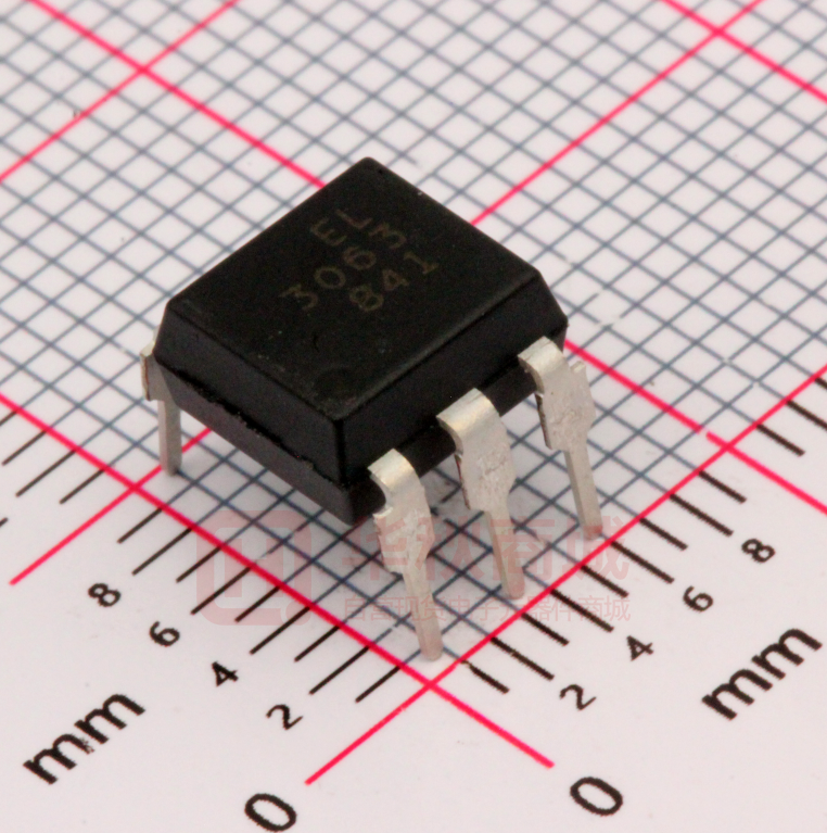

    6针DIP零交叉双向晶闸管驱动器光电耦合器 OC_7.12X6.5MM_TM
EL3063 数据手册
6 PIN DIP ZERO-CROSS TRIAC DRIVER PHOTOCOUPLER EL303X, EL304X, EL306X, EL308X Series Schematic 1 6 2 5 3 Features: • Peak breakdown voltage - 250V: EL303X - 400V: EL304X - 600V: EL306X - 800V: EL308X • High isolation voltage between input and output • Zero voltage crossing • Pb free and RoHS compliant. • UL approved (No. E214129) • VDE approved (No.132249) • SEMKO approved • NEMKO approved • DEMKO approved • FIMKO approved • CSA approved (Viso=5000 V rms ) Zero Crossing Circuit 4 Pin Configuration 1. Anode 2. Cathode 3. No Connection 4. Terminal 5. Substrate (do not connect) 6. Terminal Description The EL303X, EL304X, EL306X and EL308X series of devices each consist of a GaAs infrared emitting diode optically coupled to a monolithic silicon zero voltage crossing photo triac. They are designed for use with a discrete power triac in the interface of logic systems to equipment powered from 110 to 380 VAC lines, such as solid-state relays, industrial controls, motors, solenoids and consumer appliances. Applications        Solenoid/valve controls Light controls Static power switch AC motor drivers E.M. contactors Temperature controls AC Motor starters 1 Copyright Revision :4 © LifecyclePhase: Date:2013-12-11 15:48:54.0 2010, Everlight All Rights Reserved. Release Date : May 13, 2013. Issue Release No: DPC-0000208 Rev.4 www.everlight.com Expired Period: Forever DATASHEET 6 PIN DIP ZERO-CROSS TRIAC DRIVER PHOTOCOUPLER EL303X, EL304X, EL306X, EL308X Series Absolute Maximum Ratings (Ta=25℃) Parameter Input Symbol Rating Unit Forward current IF 60 mA Reverse voltage VR 6 V 100 mW 3.8 mW /°C Power dissipation Derating factor (above Ta = 85°C) Output PD EL303X Off-state Output Terminal Voltage 250 EL304X 400 VDRM V EL306X 600 EL308X 800 Peak Repetitive Surge Current (pw=1ms,120pps) ITSM 1 A IT(RMS) 100 mA 300 mW 7.6 mW/℃ PTOT 330 mW VISO 5000 Vrms Operating temperature TOPR -55 to 100 ℃ Storage temperature TSTG -55 to 125 ℃ TSOL 260 ℃ On-State RMS Current Power dissipation Derating factor (above Ta = 85°C) Total power dissipation Isolation voltage *1 Soldering Temperature* 2 PC Notes: *1 AC for 1 minute, R.H.= 40 ~ 60% R.H. In this test, pins 1, 2&3 are shorted together, and pins 4, 5 & 6 are shorted together. *2 For 10 seconds 2 Copyright Revision :4 © LifecyclePhase: Date:2013-12-11 15:48:54.0 2010, Everlight All Rights Reserved. Release Date : May 13, 2013. IssueRelease No: DPC-0000208 Rev.4 www.everlight.com Expired Period: Forever DATASHEET 6 PIN DIP ZERO-CROSS TRIAC DRIVER PHOTOCOUPLER EL303X, EL304X, EL306X, EL308X Series Electro-Optical Characteristics (Ta=25℃ unless specified otherwise) Input Symbol Min. Typ.* Max. Unit Forward Voltage VF - - 1.5 V IF = 30mA Reverse Leakage current IR - - 10 µA VR = 6V Min. Typ.* Max. Unit Parameter Condition Output Parameter Peak Blocking EL303X EL304X EL306X EL308X Current Peak On-state Voltage Rise off-state EL303X EL304X EL306X Voltage EL308X Critical Rate of Symbo l 100 IDRM1 - - nA VDRM = Rated VDRM IF = 0mA V ITM=100mA peak, IF=Rated IFT 500 VTM - - 3 1000 - - dv/dt Condition V/µs VPEAK =Rated VDRM, IF=0 (Fig. 10) 600 - - VINH - - 20 V IF= Rated IFT IDRM2 - - 500 µA IF= Rated IFT, VDRM=Rated VDRM, off state Min. Typ.* Max. Unit Condition - - 15 - - 10 mA Main terminal Voltage=3V - - 5 - 280 - Inhibit Voltage (MT1-MT2 voltage above which device will not trigger) Leakage in lnhibited State Transfer Characteristics Parameter EL3031 EL3041 EL3061 EL3081 EL3032 EL3042 EL3062 EL3082 EL3033 EL3043 EL3063 EL3083 LED Trigger Current Holding Current Symbol IFT IH µA * Typical values at Ta = 25°C 3 Copyright Revision :4 © LifecyclePhase: Date:2013-12-11 15:48:54.0 2010, Everlight All Rights Reserved. Release Date : May 13, 2013. IssueRelease No: DPC-0000208 Rev.4 www.everlight.com Expired Period: Forever DATASHEET 6 PIN DIP ZERO-CROSS TRIAC DRIVER PHOTOCOUPLER EL303X, EL304X, EL306X, EL308X Series Typical Electro-Optical Characteristics Curves 4 Copyright Revision :4 © LifecyclePhase: Date:2013-12-11 15:48:54.0 2010, Everlight All Rights Reserved. Release Date : May 13, 2013. IssueRelease No: DPC-0000208 Rev.4 www.everlight.com Expired Period: Forever DATASHEET 6 PIN DIP ZERO-CROSS TRIAC DRIVER PHOTOCOUPLER EL303X, EL304X, EL306X, EL308X Series 5 Copyright Revision :4 © LifecyclePhase: Date:2013-12-11 15:48:54.0 2010, Everlight All Rights Reserved. Release Date : May 13, 2013. IssueRelease No: DPC-0000208 Rev.4 www.everlight.com Expired Period: Forever DATASHEET 6 PIN DIP ZERO-CROSS TRIAC DRIVER PHOTOCOUPLER EL303X, EL304X, EL306X, EL308X Series Figure 10. Static dv/dt Test Circuit & Waveform D.U.T. RTEST 10 kΩ T1 A K CTEST VT Zero Crossing Circuit 50 Ω High Voltage Pulse Source T2 Applied VT Waveform VPEAK 0.632 x VPEAK 0 RC Measurement Method The high voltage pulse is set to the required VPEAK value and applied to the D.U.T. output side through the RC circuit above. LED current is not applied. The waveform VT is monitored using a x100 scope probe. By varying RTEST, the dv/dt (slope) is increased, until the D.U.T. is observed to trigger (waveform collapses). The dv/dt is then decreased until the D.U.T. stops triggering. At this point, RC is recorded and the dv/dt calculated. dv/dt = 0.632 x VPEAK RC For example, VPEAK = 600V for EL306X series. dv/dt = 6 Copyright Revision :4 © LifecyclePhase: The dv/dt value is calculated as follows: 0.63 x 600 RC = 378 RC Date:2013-12-11 15:48:54.0 2010, Everlight All Rights Reserved. Release Date : May 13, 2013. IssueRelease No: DPC-0000208 Rev.4 www.everlight.com Expired Period: Forever DATASHEET 6 PIN DIP ZERO-CROSS TRIAC DRIVER PHOTOCOUPLER EL303X, EL304X, EL306X, EL308X Series Order Information Part Number EL303XY(Z)-V EL304XY(Z)-V EL306XY(Z)-V EL308XY(Z)-V or or or Note X = Part No. (1, 2 or 3) Y = Lead form option (S, S1, M or none) Z = Tape and reel option (TA, TB or none). V = VDE safety approved option Option Description Packing quantity None Standard DIP-6 65 units per tube M Wide lead bend (0.4 inch spacing) 65 units per tube S (TA) Surface mount lead form + TA tape & reel option 1000 units per reel S (TB) Surface mount lead form + TB tape & reel option 1000 units per reel S1 (TA) Surface mount lead form (low profile) + TA tape & reel option 1000 units per reel S1 (TB) Surface mount lead form (low profile) + TB tape & reel option 1000 units per reel 7 Copyright Revision :4 © LifecyclePhase: Date:2013-12-11 15:48:54.0 2010, Everlight All Rights Reserved. Release Date : May 13, 2013. IssueRelease No: DPC-0000208 Rev.4 www.everlight.com Expired Period: Forever DATASHEET 6 PIN DIP ZERO-CROSS TRIAC DRIVER PHOTOCOUPLER EL303X, EL304X, EL306X, EL308X Series Package Dimension (Dimensions in mm) Standard DIP Type Option M Type 8 Copyright Revision :4 © LifecyclePhase: Date:2013-12-11 15:48:54.0 2010, Everlight All Rights Reserved. Release Date : May 13, 2013. IssueRelease No: DPC-0000208 Rev.4 www.everlight.com Expired Period: Forever DATASHEET 6 PIN DIP ZERO-CROSS TRIAC DRIVER PHOTOCOUPLER EL303X, EL304X, EL306X, EL308X Series Option S Type Option S1 Type 9 Copyright Revision :4 © LifecyclePhase: Date:2013-12-11 15:48:54.0 2010, Everlight All Rights Reserved. Release Date : May 13, 2013. IssueRelease No: DPC-0000208 Rev.4 www.everlight.com Expired Period: Forever DATASHEET 6 PIN DIP ZERO-CROSS TRIAC DRIVER PHOTOCOUPLER EL303X, EL304X, EL306X, EL308X Series Recommended pad layout for surface mount leadform Device Marking EL 3083 YWWV Notes EL 3083 Y WW V denotes Everlight denotes Device Number denotes 1 digit Year code denotes 2 digit Week code denotes VDE option 10 Copyright Revision :4 © LifecyclePhase: Date:2013-12-11 15:48:54.0 2010, Everlight All Rights Reserved. Release Date : May 13, 2013. IssueRelease No: DPC-0000208 Rev.4 www.everlight.com Expired Period: Forever DATASHEET 6 PIN DIP ZERO-CROSS TRIAC DRIVER PHOTOCOUPLER EL303X, EL304X, EL306X, EL308X Series Tape & Reel Packing Specifications Option TB Option TA Direction of feed from reel Direction of feed from reel Tape dimensions Dimension No. A B Do D1 E F Dimension (mm) 10.4±0.1 7.5±0.1 1.5±0.1 1.5+0.1/-0 1.75±0.1 7.5±0.1 Dimension No. Po P1 P2 t W K Dimension (mm) 4.0±0.15 12±0.1 2.0±0.1 0.35±0.03 16.0±0.2 4.5±0.1 11 Copyright Revision :4 © LifecyclePhase: Date:2013-12-11 15:48:54.0 2010, Everlight All Rights Reserved. Release Date : May 13, 2013. IssueRelease No: DPC-0000208 Rev.4 www.everlight.com Expired Period: Forever DATASHEET 6 PIN DIP ZERO-CROSS TRIAC DRIVER PHOTOCOUPLER EL303X, EL304X, EL306X, EL308X Series Precautions for Use 1. Soldering Condition 1.1 (A) Maximum Body Case Temperature Profile for evaluation of Reflow Profile Note: Reference: IPC/JEDEC J-STD-020D Preheat Temperature min (Tsmin) 150 °C Temperature max (Tsmax) 200°C Time (Tsmin to Tsmax) (ts) Average ramp-up rate (Tsmax to Tp) 60-120 seconds 3 °C/second max Other Liquidus Temperature (TL) 217 °C Time above Liquidus Temperature (t L) 60-100 sec Peak Temperature (TP) 260°C Time within 5 °C of Actual Peak Temperature: TP - 5°C 30 s Ramp- Down Rate from Peak Temperature 6°C /second max. Time 25°C to peak temperature Reflow times 8 minutes max. 3 times . 12 Copyright Revision :4 © LifecyclePhase: Date:2013-12-11 15:48:54.0 2010, Everlight All Rights Reserved. Release Date : May 13, 2013. IssueRelease No: DPC-0000208 Rev.4 www.everlight.com Expired Period: Forever DATASHEET 6 PIN DIP ZERO-CROSS TRIAC DRIVER PHOTOCOUPLER EL303X, EL304X, EL306X, EL308X Series DISCLAIMER 1. Above specification may be changed without notice. EVERLIGHT will reserve authority on material change for above specification. 2. When using this product, please observe the absolute maximum ratings and the instructions for using outlined in these specification sheets. EVERLIGHT assumes no responsibility for any damage resulting from use of the product which does not comply with the absolute maximum ratings and the instructions included in these specification sheets. 3. These specification sheets include materials protected under copyright of EVERLIGHT corporation. Please don’t reproduce or cause anyone to reproduce them without EVERLIGHT’s consent. 13 Copyright Revision :4 © LifecyclePhase: Date:2013-12-11 15:48:54.0 2010, Everlight All Rights Reserved. Release Date : May 13, 2013. IssueRelease No: DPC-0000208 Rev.4 www.everlight.com Expired Period: Forever
