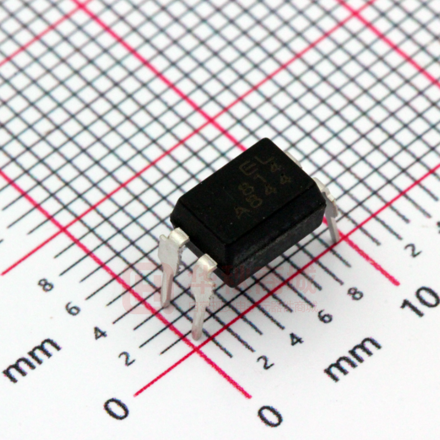

    双向光耦 Viso=5000Vrms VF(typ)=1.2V IF=60mA Vo=80V CTR=50~150% DIP4
EL814(A) 数据手册
4 PIN DIP PHOTOTRANSISTOR PHOTOCOUPLER AC INPUT PHOTOCOUPLER EL814 Series Schematic Features: •AC input response • Current transfer ratio (CTR: Min. 20% at IF =±1mA ,VCE =5V) • High isolation voltage between input and output (Viso=5000 V rms ) • Wide Operating temperature range -55~110ºC • High collector-emitter voltage VCEO=80V • Compact dual-in-line package • Pb free and RoHS compliant. • UL approved (No. E214129) • VDE approved (No. 132249) • SEMKO approved • NEMKO approved • DEMKO approved • FIMKO approved • CSA approved • CQC approved Pin Configuration 1. Anode / Cathode 2. Cathode / Anode 3. Emitter 4. Collector Description The EL814 series of devices each consist of two infrared emitting diodes, connected in inverse parallel, optically coupled to a phototransistor detector. They are packaged in a 4-pin DIP package and available in side-lead spacing and SMD option. Applications • AC line monitor • Programmable controllers • Telephone line interface • Unknown polarity DC sensor 1 Copyright Revision :5 © LifecyclePhase: Release Date:2014-03-06 17:38:31.0 2010, Everlight All Rights Reserved. Release Date : February 25, 2014. Issue No: DPC-0000043 Rev.5 www.everlight.com Expired Period: Forever DATASHEET 4 PIN DIP PHOTOTRANSISTOR PHOTOCOUPLER AC INPUT PHOTOCOUPLER EL814 Series Absolute Maximum Ratings (Ta=25℃) Parameter Symbol Rating Unit Forward current IF ±60 mA Peak forward current (t = 10µs) IFM 1 A 100 mW 2.9 mW/ºC 150 mW 5.8 mW/ºC Input Power dissipation PD Derating factor (above 100 ºC) Power dissipation Derating factor (above 100 ºC) PC Output Collector-Emitter voltage VCEO 80 V Emitter-Collector voltage VECO 6 V PTOT 200 mW Isolation Voltage* VISO 5000 V rms Operating Temperature TOPR -55 to 110 °C Storage Temperature TSTG -55 to 125 °C TSOL 260 °C Total Power Dissipation 1 Soldering Temperature* 2 Notes: *1 AC for 1 minute, R.H.= 40 ~ 60% R.H. In this test, pins 1, 2 are shorted together, and pins 3, 4 are shorted together. *2 For 10 seconds 2 Copyright Revision :5 © LifecyclePhase: Release Date:2014-03-06 17:38:31.0 2010, Everlight All Rights Reserved. Release Date : February 25, 2014. Issue No: DPC-0000043 Rev.5 www.everlight.com Expired Period: Forever DATASHEET 4 PIN DIP PHOTOTRANSISTOR PHOTOCOUPLER AC INPUT PHOTOCOUPLER EL814 Series Electro-Optical Characteristics (Ta=25℃ unless specified otherwise) Input Symbol Min. Typ. Max. Unit Condition Forward Voltage VF - 1.2 1.4 V IF = ± 20mA Input capacitance Cin - 50 250 pF V = 0, f = 1KHz Symbol Min Typ. Max. Unit Condition ICEO - - 100 nA VCE = 20V,IF = 0mA BVCEO 80 - - V IC = 0.1mA BVECO 6 - - V IE = 0.1mA Min Typ. Max. Unit Condition 20 - 300 % IF = ±1mA ,VCE = 5V 50 - 150 Parameter Output Parameter Collector-Emitter dark current Collector-Emitter breakdown voltage Emitter-Collector breakdown voltage Transfer Characteristics Parameter Current Transfer ratio Symbol EL814 CTR EL814A CTR Symmetry Collector-emitter saturation voltage Isolation resistance Cut-off frequency 0.7 VCE(sat) RIO 1.3 5×10 0.05 10 11 10 IF = ±1mA ,VCE = 5V 0.2 V IF = ±20mA ,Ic = 1mA -  VIO = 500Vdc, 40~60%R.H VCE=5V, IC=2 mA, RL=100, -3dB fc - 80 - kHz CIO - 0.6 1.0 pF Rise time Tr - 7 18 µs Fall time Tf - 11 18 µs Floating capacitance VIO = 0, f = 1MHz VCE=2V, IC=2mA, RL=100 * Typical values at Ta = 25°C 3 Copyright Revision :5 © LifecyclePhase: Release Date:2014-03-06 17:38:31.0 2010, Everlight All Rights Reserved. Release Date : February 25, 2014. Issue No: DPC-0000043 Rev.5 www.everlight.com Expired Period: Forever DATASHEET 4 PIN DIP PHOTOTRANSISTOR PHOTOCOUPLER AC INPUT PHOTOCOUPLER EL814 Series Typical Electro-Optical Characteristics Curves 4 Copyright Revision :5 © LifecyclePhase: Release Date:2014-03-06 17:38:31.0 2010, Everlight All Rights Reserved. Release Date : February 25, 2014. Issue No: DPC-0000043 Rev.5 www.everlight.com Expired Period: Forever DATASHEET 4 PIN DIP PHOTOTRANSISTOR PHOTOCOUPLER AC INPUT PHOTOCOUPLER EL814 Series VCC IF IC RL Output Input Pulse Input RIN 10% Output Pulse 90% tr tf toff ton Figure 9. Switching Time Test Circuit & Waveforms 5 Copyright Revision :5 © LifecyclePhase: Release Date:2014-03-06 17:38:31.0 2010, Everlight All Rights Reserved. Release Date : February 25, 2014. Issue No: DPC-0000043 Rev.5 www.everlight.com Expired Period: Forever DATASHEET 4 PIN DIP PHOTOTRANSISTOR PHOTOCOUPLER AC INPUT PHOTOCOUPLER EL814 Series Order Information Part Number EL814X(Y)(Z)-V Note X Y Z V = Lead form option (S, S1, M or none) = CTR Rank (A or none) = Tape and reel option (TA, TB, TU, TD or none). = VDE safety (optional). Option Description Packing quantity None Standard DIP-4 100 units per tube M Wide lead bend (0.4 inch spacing) 100 units per tube S (TA) Surface mount lead form + TA tape & reel option 1000 units per reel S (TB) Surface mount lead form + TB tape & reel option 1000 units per reel S1 (TA) Surface mount lead form (low profile) + TA tape & reel option 1000 units per reel S1 (TB) Surface mount lead form (low profile) + TB tape & reel option 1000 units per reel S (TU) Surface mount lead form + TU tape & reel option 1500 units per reel S (TD) Surface mount lead form + TD tape & reel option 1500 units per reel S1 (TU) Surface mount lead form (low profile) + TU tape & reel option 1500 units per reel S1 (TD) Surface mount lead form (low profile) + TD tape & reel option 1500 units per reel 6 Copyright Revision :5 © LifecyclePhase: Release Date:2014-03-06 17:38:31.0 2010, Everlight All Rights Reserved. Release Date : February 25, 2014. Issue No: DPC-0000043 Rev.5 www.everlight.com Expired Period: Forever DATASHEET 4 PIN DIP PHOTOTRANSISTOR PHOTOCOUPLER AC INPUT PHOTOCOUPLER EL814 Series Package Dimension (Dimensions in mm) Standard DIP Type Option M Type 7 Copyright Revision :5 © LifecyclePhase: Release Date:2014-03-06 17:38:31.0 2010, Everlight All Rights Reserved. Release Date : February 25, 2014. Issue No: DPC-0000043 Rev.5 www.everlight.com Expired Period: Forever DATASHEET 4 PIN DIP PHOTOTRANSISTOR PHOTOCOUPLER AC INPUT PHOTOCOUPLER EL814 Series Option S Type Option S1 Type 8 Copyright Revision :5 © LifecyclePhase: Release Date:2014-03-06 17:38:31.0 2010, Everlight All Rights Reserved. Release Date : February 25, 2014. Issue No: DPC-0000043 Rev.5 www.everlight.com Expired Period: Forever DATASHEET 4 PIN DIP PHOTOTRANSISTOR PHOTOCOUPLER AC INPUT PHOTOCOUPLER EL814 Series Recommended pad layout for surface mount leadform Device Marking EL 814 RYWWV Notes EL 814 R Y WW V denotes EVERLIGHT denotes Device Number denotes CTR Rank (A or none) denotes 1 digit Year code denotes 2 digit Week code denotes VDE (optional) 9 Copyright Revision :5 © LifecyclePhase: Release Date:2014-03-06 17:38:31.0 2010, Everlight All Rights Reserved. Release Date : February 25, 2014. Issue No: DPC-0000043 Rev.5 www.everlight.com Expired Period: Forever DATASHEET 4 PIN DIP PHOTOTRANSISTOR PHOTOCOUPLER AC INPUT PHOTOCOUPLER EL814 Series Tape & Reel Packing Specifications Option TA Option TB Direction of feed from reel Direction of feed from reel Tape dimensions Dimension No. Dimension (mm) S Dimension (mm) S1 Dimension No. Dimension (mm) S Dimension (mm) S1 10 Copyright Revision :5 © LifecyclePhase: A B Do D1 E F 10.5±0.1 4.65±0.1 1.55±0.1 1.50±0.1 1.75±0.1 7.5±0.1 10.5±0.1 4.65±0.1 1.55±0.1 1.50±0.1 1.75±0.1 7.5±0.1 Po P1 P2 t W K 4.0±0.1 12.0±0.1 2.0±0.1 0.4±0.1 16.0±0.3 5.05±0.1 4.0±0.1 12.0±0.1 2.0±0.1 0.4±0.1 16.0±0.3 4.75±0.1 Release Date:2014-03-06 17:38:31.0 2010, Everlight All Rights Reserved. Release Date : February 25, 2014. Issue No: DPC-0000043 Rev.5 www.everlight.com Expired Period: Forever DATASHEET 4 PIN DIP PHOTOTRANSISTOR PHOTOCOUPLER AC INPUT PHOTOCOUPLER EL814 Series Tape & Reel Packing Specifications Option TD Option TU Direction of feed from reel Direction of feed from reel Tape dimensions Dimension No. A B C D E F Dimension(mm) 16.00±0.3 7.5±0.1 1.75±0.1 8.0±0.1 2.0±0.1 4.0±0.1 Dimension No. G H I J K Dimension(mm) 1.5±0.1 10.4±0.1 0.4±0.1 4.60±0.1 5.1±0.1 11 Copyright Revision :5 © LifecyclePhase: Release Date:2014-03-06 17:38:31.0 2010, Everlight All Rights Reserved. Release Date : February 25, 2014. Issue No: DPC-0000043 Rev.5 www.everlight.com Expired Period: Forever DATASHEET 4 PIN DIP PHOTOTRANSISTOR PHOTOCOUPLER AC INPUT PHOTOCOUPLER EL814 Series Precautions for Use 1. Soldering Condition 1.1 (A) Maximum Body Case Temperature Profile for evaluation of Reflow Profile Note: Reference: IPC/JEDEC J-STD-020D Preheat Temperature min (Tsmin) 150 °C Temperature max (Tsmax) 200°C Time (Tsmin to Tsmax) (ts) Average ramp-up rate (Tsmax to Tp) 60-120 seconds 3 °C/second max Other Liquidus Temperature (TL) 217 °C Time above Liquidus Temperature (t L) 60-100 sec Peak Temperature (TP) 260°C Time within 5 °C of Actual Peak Temperature: TP - 5°C 30 s Ramp- Down Rate from Peak Temperature 6°C /second max. Time 25°C to peak temperature Reflow times 8 minutes max. 3 times . 12 Copyright Revision :5 © LifecyclePhase: Release Date:2014-03-06 17:38:31.0 2010, Everlight All Rights Reserved. Release Date : February 25, 2014. Issue No: DPC-0000043 Rev.5 www.everlight.com Expired Period: Forever DATASHEET 4 PIN DIP PHOTOTRANSISTOR PHOTOCOUPLER AC INPUT PHOTOCOUPLER EL814 Series DISCLAIMER 1. Above specification may be changed without notice. EVERLIGHT will reserve authority on material change for above specification. 2. When using this product, please observe the absolute maximum ratings and the instructions for using outlined in these specification sheets. EVERLIGHT assumes no responsibility for any damage resulting from use of the product which does not comply with the absolute maximum ratings and the instructions included in these specification sheets. 3. These specification sheets include materials protected under copyright of EVERLIGHT corporation. Please don’t reproduce or cause anyone to reproduce them without EVERLIGHT’s consent. 13 Copyright Revision :5 © LifecyclePhase: Release Date:2014-03-06 17:38:31.0 2010, Everlight All Rights Reserved. Release Date : February 25, 2014. Issue No: DPC-0000043 Rev.5 www.everlight.com Expired Period: Forever
