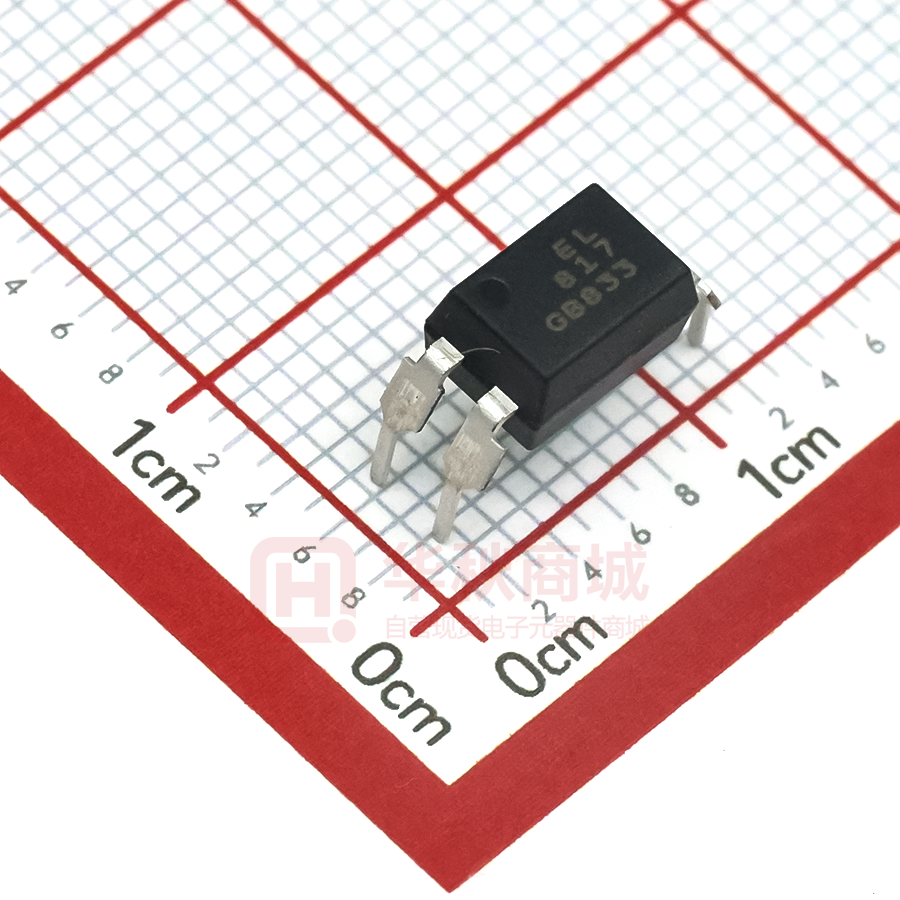

4 PIN DIP PHOTOTRANSISTOR PHOTOCOUPLER EL817-G Series Schematic Features: .• Compliance Halogens Free (Br < 900 ppm, Cl < 900 ppm, Br+Cl < 1500 ppm) • Current transfer ratio (CTR: 50~600% at IF = 5mA, VCE = 5V) • High isolation voltage between input and output (Viso = 5000Vrms ) • Creepage distance > 7.62mm • Operating temperature up to +110°C • Compact small outline package • Compliance with EU REACH. •The product itself will remain within RoHS compliant version • UL and cUL approved(No.E214129) • VDE approved (No.132249) • SEMKO approved • NEMKO approved • DEMKO approved • FIMKO approved • CQC approved Pin Configuration 1. Anode 2. Cathode 3. Emitter 4. Collector Description The EL817-G series of devices each consist of an infrared emitting diodes, optically coupled to a phototransistor detector. They are packaged in a 4-pin DIP package and available in wide-lead spacing and SMD option. Applications • Programmable controllers • System appliances, measuring instruments • Telecommunication equipments • Home appliances, such as fan heaters, etc. • Signal transmission between circuits of different potentials and impedances 1 Copyright © 2010, Everlight All Rights Reserved. Release Date :Dec 25, 2017. Issue No : DPC-0000011 Rev.11 Ver.:11 Release Date:01/02/2018   狀態:Approved(正式發行) www.everlight.com DATASHEET 4PIN DIP PHOTOTRANSISTOR PHOTOCOUPLER EL817-G Series Absolute Maximum Ratings (Ta=25°C) Parameter Symbol Rating Unit Forward current IF 60 mA Peak forward current (1us, pulse) IFP 1 A Reverse voltage VR 6 V 100 mW 2.9 mW/°C 150 mW 5.8 mW/°C IC 50 mA Collector-Emitter voltage VCEO 80 V Emitter-Collector voltage VECO 7 V PTOT 200 mW Isolation Voltage* VISO 5000 V rms Operating Temperature TOPR -55 to 110 °C Storage Temperature TSTG -55 to 125 °C TSOL 260 °C Input Power dissipation Derating factor (above Ta = 100°C) Power dissipation Derating factor (above Ta = 100°C) Output Collector current Total Power Dissipation 1 2 Soldering Temperature* PD PC Notes: *1 AC for 1 minute, R.H.= 40 ~ 60% R.H. In this test, pins 1, 2 are shorted together, and pins 3, 4 are shorted together. *2 For 10 seconds 2 Copyright © 2010, Everlight All Rights Reserved. Release Date : Dec 25, 2017. Issue No : DPC-0000011 Rev.11 Ver.:11 Release Date:01/02/2018   狀態:Approved(正式發行) www.everlight.com DATASHEET 4PIN DIP PHOTOTRANSISTOR PHOTOCOUPLER EL817-G Series Electro-Optical Characteristics (Ta=25°C unless specified otherwise) Input Parameter Symbol Min. Typ. Max. Unit Condition Forward Voltage VF - 1.2 1.4 V IF = 20mA Reverse Current Input capacitance IR - 30 10 250 µA pF VR = 4V V = 0, f = 1kHz Symbol Min Typ. Max. Unit Condition ICEO - - 100 nA VCE = 20V, IF = 0mA BVCEO 80 - - V IC = 0.1mA BVECO 7 - - V IE = 0.1mA Symbol Min Typ. Max. Unit Condition EL817 50 - 600 EL817A 80 - 160 EL817B 130 - 260 200 - 400 % IF = 5mA ,VCE = 5V EL817D 300 - 600 EL817X 100 - 200 EL817Y 150 - 300 - 0.1 0.2 V IF = 20mA ,IC = 1mA - -  VIO = 500Vdc, 40~60% R.H. Cin Output Parameter Collector-Emitter dark current Collector-Emitter breakdown voltage Emitter-Collector breakdown voltage Transfer Characteristics Parameter Current Transfer ratio CTR EL817C Collector-Emitter saturation voltage VCE(sat) RIO Floating capacitance CIO - 0.6 1.0 pF VIO = 0, f = 1MHz Cut-off frequency fc - 80 - kHz VCE = 5V, IC = 2mA RL = 100, -3dB Rise time tr - 6 18 µs tf - 8 18 µs Fall time 5×10 10 Isolation resistance VCE = 2V, IC = 2mA, RL = 100 * Typical values at Ta = 25°C 3 Copyright © 2010, Everlight All Rights Reserved. Release Date : Dec 25, 2017. Issue No : DPC-0000011 Rev.11 Ver.:11 Release Date:01/02/2018   狀態:Approved(正式發行) www.everlight.com DATASHEET 4PIN DIP PHOTOTRANSISTOR PHOTOCOUPLER EL817-G Series Typical Electro-Optical Characteristics Curves 4 Copyright © 2010, Everlight All Rights Reserved. Release Date : Dec 25, 2017. Issue No : DPC-0000011 Rev.11 Ver.:11 Release Date:01/02/2018   狀態:Approved(正式發行) www.everlight.com DATASHEET 4PIN DIP PHOTOTRANSISTOR PHOTOCOUPLER EL817-G Series VCC IF IC RL Output Input Pulse Input 10% RIN Output Pulse tr ton 90% tf toff Figure 7. Switching Time Test Circuit & Waveforms 5 Copyright © 2010, Everlight All Rights Reserved. Release Date : Dec 25, 2017. Issue No : DPC-0000011 Rev.11 Ver.:11 Release Date:01/02/2018   狀態:Approved(正式發行) www.everlight.com DATASHEET 4PIN DIP PHOTOTRANSISTOR PHOTOCOUPLER EL817-G Series Order Information Part Number EL817X(Y)(Z)-FVG Note X Y Z F V G = Lead form option (S1, S2, M or none) = CTR Rank (A, B, C, D, X , Y or none) = Tape and reel option (TU, TD or none) = Lead frame option (F: Iron, None: copper) = VDE safety (optional) = Halogens free Option 6 Description Packing quantity None Standard DIP-4 100 units per tube M Wide lead bend (0.4 inch spacing) 100 units per tube S1 (TU) Surface mount lead form (low profile) + TU tape & reel option 1500 units per reel S1 (TD) Surface mount lead form (low profile) + TD tape & reel option 1500 units per reel S2 (TU) Surface mount lead form (low profile) + TU tape & reel option 2000 units per reel S2 (TD) Surface mount lead form (low profile) + TD tape & reel option 2000 units per reel Copyright © 2010, Everlight All Rights Reserved. Release Date : Dec 25, 2017. Issue No : DPC-0000011 Rev.11 Ver.:11 Release Date:01/02/2018   狀態:Approved(正式發行) www.everlight.com DATASHEET 4PIN DIP PHOTOTRANSISTOR PHOTOCOUPLER EL817-G Series Package Dimension (Dimensions in mm) Standard DIP Type Option M Type 7 Copyright © 2010, Everlight All Rights Reserved. Release Date : Dec 25, 2017. Issue No : DPC-0000011 Rev.11 Ver.:11 Release Date:01/02/2018   狀態:Approved(正式發行) www.everlight.com DATASHEET 4PIN DIP PHOTOTRANSISTOR PHOTOCOUPLER EL817-G Series Option S1 Type Option S2 Type 8 Copyright © 2010, Everlight All Rights Reserved. Release Date : Dec 25, 2017. Issue No : DPC-0000011 Rev.11 Ver.:11 Release Date:01/02/2018   狀態:Approved(正式發行) www.everlight.com DATASHEET 4PIN DIP PHOTOTRANSISTOR PHOTOCOUPLER EL817-G Series Recommended pad layout for surface mount leadform For S1 option For S2 option Notes Suggested pad dimension is just for reference only. Please modify the pad dimension based on individual need. Device Marking EL 817 FRYWWV Notes EL 817 F R Y WW V 9 denotes EVERLIGHT denotes Device Number denotes Factory Code (G: China and Green part) denotes CTR Rank (A, B, C, D , X , Y or none) denotes 1 digit Year code denotes 2 digit Week code denotes VDE (optional) Copyright © 2010, Everlight All Rights Reserved. Release Date : Dec 25, 2017. Issue No : DPC-0000011 Rev.11 Ver.:11 Release Date:01/02/2018   狀態:Approved(正式發行) www.everlight.com DATASHEET 4PIN DIP PHOTOTRANSISTOR PHOTOCOUPLER EL817-G Series Tape & Reel Packing Specifications Option TD Option TU Direction of feed from reel Direction of feed from reel Tape dimensions Dimension No. Dimension (mm) S1 Dimension (mm) S2 Dimension No. Dimension (mm) S1 Dimension (mm) S2 10 Ao Bo Do D1 E F 4.90±0.1 10.40±0.1 1.5±0.1 1.50±0.1 1.75±0.1 7.50±0.1 4.88±0.1 12.55±0.1 1.5±0.1 1.50±0.1 1.75±0.1 11.5±0.1 Po P1 P2 t W Ko 4.00±0.1 8.00±0.1 2.00±0.1 0.40±0.1 16.00±0.3 4.60±0.1 4.00±0.1 8.00±0.1 2.00±0.1 0.40±0.1 24.00±0.3 4.00±0.1 Copyright © 2010, Everlight All Rights Reserved. Release Date : Dec 25, 2017. Issue No : DPC-0000011 Rev.11 Ver.:11 Release Date:01/02/2018   狀態:Approved(正式發行) www.everlight.com DATASHEET 4PIN DIP PHOTOTRANSISTOR PHOTOCOUPLER EL817-G Series Precautions for Use 1. Soldering Condition 1.1 (A) Maximum Body Case Temperature Profile for evaluation of Reflow Profile Note: Reference: IPC/JEDEC J-STD-020D Preheat Temperature min (Tsmin) 150 °C Temperature max (Tsmax) 200°C Time (Tsmin to Tsmax) (ts) Average ramp-up rate (Tsmax to Tp) 60-120 seconds 3 °C/second max Other Liquidus Temperature (TL) 217 °C Time above Liquidus Temperature (t L) 60-100 sec Peak Temperature (TP) 260°C Time within 5 °C of Actual Peak Temperature: T P - 5°C 30 s Ramp- Down Rate from Peak Temperature 6°C /second max. Time 25°C to peak temperature Reflow times 8 minutes max. 3 times . 11 Copyright © 2010, Everlight All Rights Reserved. Release Date : Dec 25, 2017. Issue No : DPC-0000011 Rev.11 Ver.:11 Release Date:01/02/2018   狀態:Approved(正式發行) www.everlight.com DATASHEET 4PIN DIP PHOTOTRANSISTOR PHOTOCOUPLER EL817-G Series DISCLAIMER 1. Above specification may be changed without notice. EVERLIGHT will reserve authority on material change for above specification. 2. The graphs shown in this datasheet are representing typical data only and do not show guaranteed values. 3. When using this product, please observe the absolute maximum ratings and the instructions for use outlined in these specification sheets. EVERLIGHT assumes no responsibility for any damage resulting from use of the product which does not comply with the absolute maximum ratings and the instructions included in these specification sheets. 4. These specification sheets include materials protected under copyright of EVERLIGHT. Reproduction in any form is prohibited without the specific consent of EVERLIGHT. 5. This product is not intended to be used for military, aircraft, automotive, medical, life sustaining or life saving applications or any other application which can result in human injury or death. Please contact authorized Everlight sales agent for special application request. 6. Statements regarding the suitability of products for certain types of applications are based on Everlight’s knowledge of typical requirements that are often placed on Everlight products in generic applications. Such statements are not binding statements about the suitability of products for a particular application. It is the customer’s responsibility to validate that a particular product with the properties described in the product specification is suitable for use in a particular application. Parameters provided in datasheets and/or specifications may vary in different applications and performance may vary over time. All operating parameters, including typical parameters, must be validated for each customer application by the customer’s technical experts. Product specifications do not expand or otherwise modify Everlight’s terms and conditions of purchase, including but not limited to the warranty expressed therein. 12 Copyright © 2010, Everlight All Rights Reserved. Release Date : Dec 25, 2017. Issue No : DPC-0000011 Rev.11 Ver.:11 Release Date:01/02/2018   狀態:Approved(正式發行) www.everlight.com

物料型号:EL817-G系列
器件简介:该系列由一个红外发射二极管和一个光电晶体管探测器组成,封装在4引脚DIP封装中,提供宽引脚间距和SMD选项。
引脚分配:1. 阳极,2. 阴极,3. 发射极,4. 集电极
参数特性: - 符合欧盟REACH法规,无卤素 - 电流传输比(CTR):在IF=5mA, VCE=5V时为50~600% - 高隔离电压:Viso = 5000Vrms - 工作温度高达+110°C - 符合RoHS标准 - 获得UL、cUL、VDE等认证
功能详解: - 用于不同电位和阻抗电路之间的信号传输 - 应用在可编程控制器、系统设备、测量仪器、通信设备、家用电器等
应用信息: - 可编程控制器 - 系统设备、测量仪器 - 通信设备 - 家用电器,如风扇加热器等
