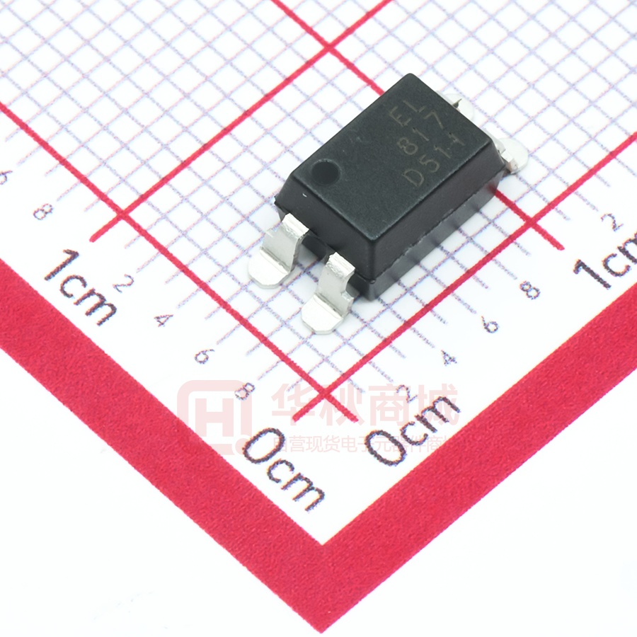

EL817S1(D)(TU)
EL817S1(D)(TU)
    EVERLIGHT(台湾亿光)
    OC-4P_6.5X4.58MM_SM
    5KVrms 1.2V 200mW 6V 60mA 1Channel 4.58 x 6.50mm
EL817S1(D)(TU) 数据手册
4 PIN DIP PHOTOTRANSISTOR PHOTOCOUPLER EL817 Series Schematic Features: • Current transfer ratio (CTR: 50~600% at IF = 5mA, VCE = 5V) • High isolation voltage between input and output (Viso = 5000Vrms) • Creepage distance > 7.62mm • Operating temperature up to +110°C • Compact small outline package •The product itself will remain within RoHS compliant version • Compliance with EU REACH • UL and cUL approved(No.E214129) • VDE approved (No. 132249) • SEMKO approved • NEMKO approved • DEMKO approved • FIMKO approved • CQC approved Pin Configuration 1. Anode 2. Cathode 3. Emitter 4. Collector Description The EL817series of devices each consist of an infrared emitting diodes, optically coupled to a phototransistor detector. They are packaged in a 4-pin DIP package and available in wide-lead spacing and SMD option. Applications • Programmable controllers • System appliances, measuring instruments • Telecommunication equipments • Home appliances, such as fan heaters, etc. • Signal transmission between circuits of different potentials and impedances 1 Copyright © 2010, Everlight All Rights Reserved. Release Date :July 20, 2016. Issue No: DPC-0000046 Rev.15 www.everlight.com DATASHEET 4PIN DIP PHOTOTRANSISTOR PHOTOCOUPLER EL817 series Absolute Maximum Ratings (Ta=25℃) Parameter Symbol Rating Unit Forward current IF 60 mA Peak forward current (1us, pulse) IFP 1 A Reverse voltage VR 6 V 100 mW 2.9 mW/°C 150 mW 5.8 mW/°C IC 50 mA Collector-Emitter voltage VCEO 35 V Emitter-Collector voltage VECO 6 V PTOT 200 mW Isolation Voltage* VISO 5000 V rms Operating Temperature TOPR -55 to 110 °C Storage Temperature TSTG -55 to 125 °C TSOL 260 °C Input Power dissipation Derating factor (above Ta = 100°C) Power dissipation Derating factor (above Ta = 100°C) Output Collector current Total Power Dissipation 1 2 Soldering Temperature* PD PC Notes: *1 AC for 1 minute, R.H.= 40 ~ 60% R.H. In this test, pins 1, 2 are shorted together, and pins 3, 4 are shorted together. *2 For 10 seconds 2 Copyright © 2010, Everlight All Rights Reserved. Release Date :July 20, 2016. Issue No: DPC-0000046 Rev.15 www.everlight.com DATASHEET 4PIN DIP PHOTOTRANSISTOR PHOTOCOUPLER EL817 series Electro-Optical Characteristics (Ta=25℃ unless specified otherwise) Input Parameter Symbol Min. Typ. Max. Unit Condition Forward Voltage VF - 1.2 1.4 V IF = 20mA Reverse Current Input capacitance IR - 30 10 250 µA pF VR = 4V V = 0, f = 1kHz Symbol Min Typ. Max. Unit Condition ICEO - - 100 nA VCE = 20V, IF = 0mA BVCEO 35 - - V IC = 0.1mA BVECO 6 - - V IE = 0.1mA Symbol Min Typ. Max. Unit Condition EL817 50 - 600 EL817A 80 - 160 EL817B 130 - 260 EL817C 200 - 400 % IF = 5mA ,VCE = 5V EL817D 300 - 600 EL817X 100 - 200 EL817Y 150 - 300 - 0.1 0.2 V IF = 20mA ,IC = 1mA - -  VIO = 500Vdc, 40~60% R.H. Cin Output Parameter Collector-Emitter dark current Collector-Emitter breakdown voltage Emitter-Collector breakdown voltage Transfer Characteristics Parameter Current Transfer ratio Collector-Emitter saturation voltage CTR VCE(sat) 5×10 10 Isolation resistance RIO Floating capacitance CIO - 0.6 1.0 pF VIO = 0, f = 1MHz Cut-off frequency fc - 80 - kHz VCE = 5V, IC = 2mA RL = 100, -3dB Rise time tr - - 18 µs Fall time tf - - 18 µs VCE = 2V, IC = 2mA, RL = 100 * Typical values at Ta = 25°C 3 Copyright © 2010, Everlight All Rights Reserved. Release Date :July 20, 2016. Issue No: DPC-0000046 Rev.15 www.everlight.com DATASHEET 4PIN DIP PHOTOTRANSISTOR PHOTOCOUPLER EL817 series Typical Electro-Optical Characteristics Curves 4 Copyright © 2010, Everlight All Rights Reserved. Release Date :July 20, 2016. Issue No: DPC-0000046 Rev.15 www.everlight.com DATASHEET 4PIN DIP PHOTOTRANSISTOR PHOTOCOUPLER EL817 series VCC IF IC RL Output Input Pulse Input 10% RIN Output Pulse tr ton 90% tf toff Figure 7. Switching Time Test Circuit & Waveforms 5 Copyright © 2010, Everlight All Rights Reserved. Release Date :July 20, 2016. Issue No: DPC-0000046 Rev.15 www.everlight.com DATASHEET 4PIN DIP PHOTOTRANSISTOR PHOTOCOUPLER EL817 series Order Information Part Number EL817X(Y)(Z)-FV Note X Y Z F V = Lead form option (S, S1, S2, M or none) = CTR Rank (A, B, C, D, X , Y or none) = Tape and reel option (TA, TB, TU, TD or none) = Lead frame option (F: Iron, None: copper) = VDE safety (optional). Option 6 Description Packing quantity None Standard DIP-4 100 units per tube M Wide lead bend (0.4 inch spacing) 100 units per tube S (TA) Surface mount lead form + TA tape & reel option 1000 units per reel S (TB) Surface mount lead form + TB tape & reel option 1000 units per reel S1 (TA) Surface mount lead form (low profile) + TA tape & reel option 1000 units per reel S1 (TB) Surface mount lead form (low profile) + TB tape & reel option 1000 units per reel S2 (TA) Surface mount lead form (Gull-wing) + TA tape & reel option 1000 units per reel S2 (TB) Surface mount lead form (Gull-wing) + TB tape & reel option 1000 units per reel S (TU) Surface mount lead form + TU tape & reel option 1500 units per reel S (TD) Surface mount lead form + TD tape & reel option 1500 units per reel S1 (TU) Surface mount lead form (low profile) + TU tape & reel option 1500 units per reel S1 (TD) Surface mount lead form (low profile) + TD tape & reel option 1500 units per reel S2 (TU) Surface mount lead form (low profile) + TU tape & reel option 2000 units per reel S2 (TD) Surface mount lead form (low profile) + TD tape & reel option 2000 units per reel Copyright © 2010, Everlight All Rights Reserved. Release Date :July 20, 2016. Issue No: DPC-0000046 Rev.15 www.everlight.com DATASHEET 4PIN DIP PHOTOTRANSISTOR PHOTOCOUPLER EL817 series Package Dimension (Dimensions in mm) Standard DIP Type Option M Type 7 Copyright © 2010, Everlight All Rights Reserved. Release Date :July 20, 2016. Issue No: DPC-0000046 Rev.15 www.everlight.com DATASHEET 4PIN DIP PHOTOTRANSISTOR PHOTOCOUPLER EL817 series Option S Type Option S1 Type 8 Copyright © 2010, Everlight All Rights Reserved. Release Date :July 20, 2016. Issue No: DPC-0000046 Rev.15 www.everlight.com DATASHEET 4PIN DIP PHOTOTRANSISTOR PHOTOCOUPLER EL817 series Option S2 Type Recommended pad layout for surface mount leadform For S option For S1 option For S2 option Notes Suggested pad dimension is just for reference only. Please modify the pad dimension based on individual need. 9 Copyright © 2010, Everlight All Rights Reserved. Release Date :July 20, 2016. Issue No: DPC-0000046 Rev.15 www.everlight.com DATASHEET 4PIN DIP PHOTOTRANSISTOR PHOTOCOUPLER EL817 series Device Marking EL 817 FRYWWV Notes EL 817 F R Y WW V 10 denotes EVERLIGHT denotes Device Number denotes Factory Code (G: China and Green part) denotes CTR Rank (A, B, C, D , X , Y or none) denotes 1 digit Year code denotes 2 digit Week code denotes VDE (optional) Copyright © 2010, Everlight All Rights Reserved. Release Date :July 20, 2016. Issue No: DPC-0000046 Rev.15 www.everlight.com DATASHEET 4PIN DIP PHOTOTRANSISTOR PHOTOCOUPLER EL817 series Tape & Reel Packing Specifications Option TA Option TB Direction of feed from reel Direction of feed from reel Tape dimensions Dimension No. B Do D1 E F 10.7±0.1 4.65±0.1 1.5±0.1 1.50±0.1 1.75±0.1 7.5±0.1 Dimension (mm) S Dimension (mm) S1 Dimension (mm) S2 10.7±0.1 4.65±0.1 1.5±0.1 1.50±0.1 1.75±0.1 7.5±0.1 12.15±0.1 4.65±0.1 1.5±0.1 1.50±0.1 1.75±0.1 7.5±0.1 Dimension No. Po P1 P2 t W K 4.0±0.1 12.0±0.1 2.0±0.1 0.4±0.1 16.0±0.3 4.75±0.1 4.0±0.1 12.0±0.1 2.0±0.1 0.4±0.1 16.0±0.3 3.90±0.1 4.0±0.1 16.0±0.1 2.0±0.1 0.4±0.1 16.0±0.3 3.90±0.1 Dimension (mm) S Dimension (mm) S1 Dimension (mm) S2 11 A Copyright © 2010, Everlight All Rights Reserved. Release Date :July 20, 2016. Issue No: DPC-0000046 Rev.15 www.everlight.com DATASHEET 4PIN DIP PHOTOTRANSISTOR PHOTOCOUPLER EL817 series Tape & Reel Packing Specifications Option TD Option TU Direction of feed from reel Direction of feed from reel Tape dimensions Dimension No. Dimension (mm) S.S1 Dimension (mm) S2 Dimension No. Dimension (mm) S.S1 Dimension (mm) S2 12 Ao Bo Do D1 E F 4.90±0.1 10.40±0.1 1.5±0.1 1.50±0.1 1.75±0.1 7.50±0.1 4.88±0.1 12.55±0.1 1.5±0.1 1.50±0.1 1.75±0.1 11.5±0.1 Po P1 P2 t W Ko 4.00±0.1 8.00±0.1 2.00±0.1 0.40±0.1 16.00±0.3 4.60±0.1 4.00±0.1 8.00±0.1 2.00±0.1 0.40±0.1 24.00±0.3 4.00±0.1 Copyright © 2010, Everlight All Rights Reserved. Release Date :July 20, 2016. Issue No: DPC-0000046 Rev.15 www.everlight.com DATASHEET 4PIN DIP PHOTOTRANSISTOR PHOTOCOUPLER EL817 series Precautions for Use 1. Soldering Condition 1.1 (A) Maximum Body Case Temperature Profile for evaluation of Reflow Profile Note: Reference: IPC/JEDEC J-STD-020D Preheat Temperature min (Tsmin) 150 °C Temperature max (Tsmax) 200°C Time (Tsmin to Tsmax) (ts) 60-120 seconds Average ramp-up rate (Tsmax to Tp) 3 °C/second max Other Liquidus Temperature (TL) 217 °C Time above Liquidus Temperature (t L) 60-100 sec Peak Temperature (TP) 260°C Time within 5 °C of Actual Peak Temperature: T P - 5°C 30 s Ramp- Down Rate from Peak Temperature 6°C /second max. Time 25°C to peak temperature 8 minutes max. Reflow times 3 times 13 Copyright © 2010, Everlight All Rights Reserved. Release Date :July 20, 2016. Issue No: DPC-0000046 Rev.15 www.everlight.com DATASHEET 4PIN DIP PHOTOTRANSISTOR PHOTOCOUPLER EL817 series DISCLAIMER 1. Above specification may be changed without notice. EVERLIGHT will reserve authority on material change for above specification. 2. The graphs shown in this datasheet are representing typical data only and do not show guaranteed values. 3. When using this product, please observe the absolute maximum ratings and the instructions for use outlined in these specification sheets. EVERLIGHT assumes no responsibility for any damage resulting from use of the product which does not comply with the absolute maximum ratings and the instructions included in these specification sheets. 4. These specification sheets include materials protected under copyright of EVERLIGHT. Reproduction in any form is prohibited without the specific consent of EVERLIGHT. 5. This product is not intended to be used for military, aircraft, automotive, medical, life sustaining or life saving applications or any other application which can result in human injury or death. Please contact authorized Everlight sales agent for special application request. 14 Copyright © 2010, Everlight All Rights Reserved. Release Date :July 20, 2016. Issue No: DPC-0000046 Rev.15 www.everlight.com
