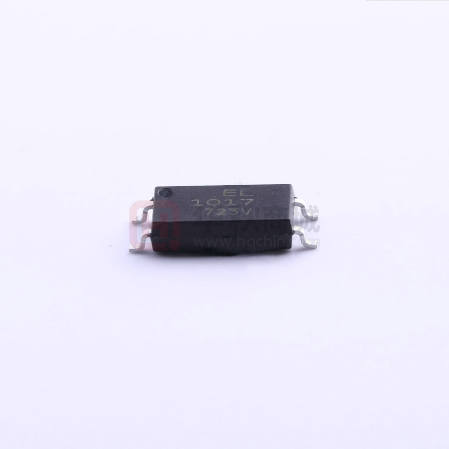

    4-DIP 单向光耦 Viso=5000Vrms VF(typ)=1.2V IF=60mA Vo=350V CTR=1000-15000%
EL852 数据手册
4 PIN DIP HIGH VOLTAGE PHOTODARLINGTON PHOTOCOUPLER EL852 Series Schematic Features: •High collector- emitter voltage (VCEO=350V) • Current transfer ratio (CTR: 1000% min. at IF =1mA, VCE =2V) • High isolation voltage between input and output (Viso=5000 V rms ) • Creepage distance >7.62 mm • Operating temperature up to +100°C • Compact small outline package • Pb free and RoHS compliant. • UL approved • VDE approved • SEMKO approved • NEMKO approved • DEMKO approved • FIMKO approved Pin Configuration 1. Anode 2. Cathode 3. Emitter 4. Collector Description The EL852 series consists an infrared emitting diodes, optically coupled to a high voltage photo Darlington detector. It is packaged in a 4-pin DIP package and available in wide-lead spacing and SMD option. Applications • Telephone set, telephone exchangers • Sequence controllers • System appliances, measuring instruments • Signal transmission between circuits of different potentials and impedances 1 Copyright © 2010, Everlight All Rights Reserved. Release Date : May 27, 2014. Issue No: DPC-0000056 Rev. 6 www.everlight.com DATASHEET 4 PIN DIP HIGH VOLTAGE PHOTODARLINGTON PHOTOCOUPLER EL852 series Absolute Maximum Ratings (Ta=25℃ ℃) Parameter Input Symbol Rating Unit Forward current IF 60 mA Peak forward current (1us, pulse) IFP 1 A Reverse voltage VR 6 V PD 100 mW 300 mW 5.8 mW/°C IC 150 mA Collector-Emitter voltage VCEO 350 V Emitter-Collector voltage VECO 0.1 V PTOT 320 mW VISO 5000 V rms TOPR -55 ~ +100 °C TSTG -55 ~ +125 °C TSOL 260 °C Power dissipation No derating required up to Ta = 100°C Output Power dissipation PC Derating factor (above Ta = 80°C) Collector current Total power dissipation Isolation voltage *1 Operating temperature Storage temperature 2 Soldering Temperature* Notes: *1 AC for 1 minute, R.H.= 40 ~ 60% R.H. In this test, pins 1 & 2 are shorted together, and pins 3 & 4 are shorted together. *2 For 10 seconds 2 Copyright © 2010, Everlight All Rights Reserved. Release Date : May 27, 2014. Issue No: DPC-0000056 Rev. 6 www.everlight.com DATASHEET 4 PIN DIP HIGH VOLTAGE PHOTODARLINGTON PHOTOCOUPLER EL852 series Electro-Optical Characteristics (Ta=25℃ ℃ unless specified otherwise) Input Symbol Min. Typ.* Max. Unit Forward Voltage VF - 1.2 1.4 V IF = 10mA Reverse Current IR - - 10 µA VR = 4V Input capacitance Cin - 30 250 pF V = 0, f = 1kHz Symbol Min. Typ.* Max. Unit ICEO - - 200 nA VCE = 200V, IF = 0mA BVCEO 350 - - V IC = 0.1mA BVECO 0.1 - - V IE = 0.1mA Symbol Min. Typ.* Max. Unit CTR 1000 - 15000 % IF = 1mA ,VCE = 2V VCE(sat) - - 1.2 V IF = 20mA ,IC = 100mA - - Ω VIO = 500Vdc, 40~60% R.H. Parameter Condition Output Parameter Collector-Emitter dark current Collector-Emitter breakdown voltage Emitter-Collector breakdown voltage Condition Transfer Characteristics Parameter Current Transfer ratio Collector-Emitter saturation voltage 10 5×10 Condition Isolation resistance RIO Floating capacitance CIO - 0.6 1.0 pF VIO = 0, f = 1MHz Cut-off frequency fc - 7 - kHz VCE = 2V, IC = 20mA RL = 100Ω, -3dB Rise time tr - - 300 µs Fall time tf - - 100 µs VCE = 2V, IC = 20mA, RL = 100Ω * Typical values at Ta = 25°C 3 Copyright © 2010, Everlight All Rights Reserved. Release Date : May 27, 2014. Issue No: DPC-0000056 Rev. 6 www.everlight.com DATASHEET 4 PIN DIP HIGH VOLTAGE PHOTODARLINGTON PHOTOCOUPLER EL852 series Typical Electro-Optical Characteristics Curves 4 Copyright © 2010, Everlight All Rights Reserved. Release Date : May 27, 2014. Issue No: DPC-0000056 Rev. 6 www.everlight.com DATASHEET 4 PIN DIP HIGH VOLTAGE PHOTODARLINGTON PHOTOCOUPLER EL852 series 5 Copyright © 2010, Everlight All Rights Reserved. Release Date : May 27, 2014. Issue No: DPC-0000056 Rev. 6 www.everlight.com DATASHEET 4 PIN DIP HIGH VOLTAGE PHOTODARLINGTON PHOTOCOUPLER EL852 series Order Informatio Part Number EL852X(Y)-V Note X Y V 6 = Lead form option (S, S1, M or none) = Tape and reel option (TA, TB ,TU, TD or none). = VDE safety (optional). Option Description Packing quantity None Standard DIP-4 100 units per tube M Wide lead bend (0.4 inch spacing) 100 units per tube S (TA) Surface mount lead form + TA tape & reel option 1000 units per reel S (TB) Surface mount lead form + TB tape & reel option 1000 units per reel S1 (TA) Surface mount lead form (low profile) + TA tape & reel option 1000 units per reel S1 (TB) Surface mount lead form (low profile) + TB tape & reel option 1000 units per reel S (TU) Surface mount lead form + TU tape & reel option 1500 units per reel S (TD) Surface mount lead form + TD tape & reel option 1500 units per reel S1 (TU) Surface mount lead form (low profile) + TU tape & reel option 1500 units per reel S1 (TD) Surface mount lead form (low profile) + TD tape & reel option 1500 units per reel Copyright © 2010, Everlight All Rights Reserved. Release Date : May 27, 2014. Issue No: DPC-0000056 Rev. 6 www.everlight.com DATASHEET 4 PIN DIP HIGH VOLTAGE PHOTODARLINGTON PHOTOCOUPLER EL852 series Package Dimension (Dimensions in mm) Standard DIP Type Option M Type 7 Copyright © 2010, Everlight All Rights Reserved. Release Date : May 27, 2014. Issue No: DPC-0000056 Rev. 6 www.everlight.com DATASHEET 4 PIN DIP HIGH VOLTAGE PHOTODARLINGTON PHOTOCOUPLER EL852 series Option S Type Option S1 Type 8 Copyright © 2010, Everlight All Rights Reserved. Release Date : May 27, 2014. Issue No: DPC-0000056 Rev. 6 www.everlight.com DATASHEET 4 PIN DIP HIGH VOLTAGE PHOTODARLINGTON PHOTOCOUPLER EL852 series Recommended pad layout for surface mount leadform Device Marking EL 852 YWWV Notes EL 852 Y WW V 9 denotes EVERLIGHT denotes Device Number denotes 1 digit Year code denotes 2 digit Week code denotes VDE optional Copyright © 2010, Everlight All Rights Reserved. Release Date : May 27, 2014. Issue No: DPC-0000056 Rev. 6 www.everlight.com DATASHEET 4 PIN DIP HIGH VOLTAGE PHOTODARLINGTON PHOTOCOUPLER EL852 series Tape & Reel Packing Specifications Option TA Option TB Direction of feed from reel Direction of feed from reel Tape dimensions Dimension No. A B Do D1 E F Dimension (mm) S 10.5±0.1 4.65±0.1 1.5±0.1 1.50±0.1 1.75±0.1 7.5±0.1 Dimension (mm) S1 10.5±0.1 4.65±0.1 1.5±0.1 1.50±0.1 1.75±0.1 7.5±0.1 Dimension No. Po P1 P2 t W K Dimension (mm) S 4.0±0.1 12.0±0.1 2.0±0.1 0.4±0.1 16.0±0.3 5.05±0.1 Dimension (mm) S1 4.0±0.1 12.0±0.1 2.0±0.1 0.4±0.1 16.0±0.3 4.75±0.1 10 Copyright © 2010, Everlight All Rights Reserved. Release Date : May 27, 2014. Issue No: DPC-0000056 Rev. 6 www.everlight.com DATASHEET 4 PIN DIP HIGH VOLTAGE PHOTODARLINGTON PHOTOCOUPLER EL852 series Tape & Reel Packing Specifications Option TD Option TU Direction of feed from reel Direction of feed from reel Tape dimensions Dimension No. Ao Bo Do D1 E F Dimension (mm) S.S1 4.90±0.1 10.40±0.1 1.5±0.1 1.50±0.1 1.75±0.1 7.50±0.1 Dimension No. Po P1 P2 t W Ko Dimension (mm) S.S1 4.00±0.1 8.00±0. 2.00±0.1 0.40±0.1 16.00±0.3 4.60±0.1 11 Copyright © 2010, Everlight All Rights Reserved. Release Date : May 27, 2014. Issue No: DPC-0000056 Rev. 6 www.everlight.com DATASHEET 4 PIN DIP HIGH VOLTAGE PHOTODARLINGTON PHOTOCOUPLER EL852 series Precautions for Use 1. Soldering Condition 1.1 (A) Maximum Body Case Temperature Profile for evaluation of Reflow Profile Note: Reference: IPC/JEDEC J-STD-020D Preheat Temperature min (Tsmin) 150 °C Temperature max (Tsmax) 200°C Time (Tsmin to Tsmax) (ts) Average ramp-up rate (Tsmax to Tp) 60-120 seconds 3 °C/second max Other Liquidus Temperature (TL) 217 °C Time above Liquidus Temperature (t L) 60-100 sec Peak Temperature (TP) 260°C Time within 5 °C of Actual Peak Temperature: TP - 5°C 30 s Ramp- Down Rate from Peak Temperature 6°C /second max. Time 25°C to peak temperature Reflow times 8 minutes max. 3 times . 12 Copyright © 2010, Everlight All Rights Reserved. Release Date : May 27, 2014. Issue No: DPC-0000056 Rev. 6 www.everlight.com DATASHEET 4 PIN DIP HIGH VOLTAGE PHOTODARLINGTON PHOTOCOUPLER EL852 series DISCLAIMER 1. Above specification may be changed without notice. EVERLIGHT will reserve authority on material change for above specification. 2. When using this product, please observe the absolute maximum ratings and the instructions for using outlined in these specification sheets. EVERLIGHT assumes no responsibility for any damage resulting from use of the product which does not comply with the absolute maximum ratings and the instructions included in these specification sheets. 3. These specification sheets include materials protected under copyright of EVERLIGHT corporation. Please don’t reproduce or cause anyone to reproduce them without EVERLIGHT’s consent. 13 Copyright © 2010, Everlight All Rights Reserved. Release Date : May 27, 2014. Issue No: DPC-0000056 Rev. 6 www.everlight.com
