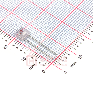

Technical Data Sheet Opto Interrupter ITR9608 █ Features ․Fast response time ․High analytic ․Cut-off visible wavelength λp=940nm ․High sensitivity ․Pb free ․The product itself will remain within RoHS compliant version. █ Descriptions The ITR9608 consist of an infrared emitting diode and an NPN silicon phototransistor, encased side-by-side on converging optical axis in a black Thermoplastic Housing The phototransistor receives radiation from the IRED only .This is the normal Situation. But when an object is in between , phototransistor could not receives the radiation. For additional component information , please refer to IR928-6C and PT928-6C █ Applications ․Mouse Copier ․Switch Scanner ․Floppy disk driver ․Non-contact Switching ․For Direct Board █ Device Selection Guide Device No. IR928-6C PT928-6C Chip Material GaAlAs Silicon LENS COLOR Water clear Water clear Everlight Electronics Co., Ltd. Device No:CDRX-096-006 http:\\www.everlight.com Prepared date:08-08-2005 Rev 2 Page: 1 of 6 Prepared by:Denky ITR9608 █ Package Dimensions Notes: 1.All dimensions are in millimeters 2.Tolerances unless dimensions ±0.2mm 3.Lead spacing is measured where the lead emerge from the package 4.Above specification may be changed without notice. EVERLIGHT will reserve authority on material change for above specification 5.These specification sheets include materials protected under copyright of EVERLIGHT corporation . Please don't reproduce or cause anyone to reproduce them without EVERLIGHT's consent 6.When using this product , please observe the absolute maximum ratings and the instructions for use outlined in these specification sheets. EVERIGHT assumes no responsibility for any damage resulting from use of the product which does not comply with the absolute maximum ratings and the instructions included in these specification sheets. Everlight Electronics Co., Ltd. Device No:CDRX-096-006 http:\\www.everlight.com Prepared date:08-08-2005 Rev 2 Page: 2 of 6 Prepared by:Denky ITR9608 █ Absolute Maximum Ratings (Ta=25℃) Parameter Power Dissipation at(or below) 25℃ Free Air Temperature Input Reverse Voltage Forward Current Peak Forward Current (*1) Pulse width ≦100μs, Duty cycle=1% Collector Power Dissipation Output Collector Current Collector-Emitter Voltage Emitter-Collector Voltage Operating Temperature Storage Temperature Lead Soldering Temperature (*2) (1/16 inch form body for 5 seconds) (*1) tw=100 μsec. , T=10 msec. Parameter Forward Voltage Input Reverse Current Peak Wavelength View Angle Dark Current Output C-E Saturation Voltage Collect Current Transfer Rise time Characteristics Fall time Symbol VF1 VF2 VF3 IR λP 2θ1/2 ICEO VCE(sat) IC(ON) tr tf Symbol Pd VR IF IFP PC IC B VCEO B VECO Topr Tstg Tsol (*2) t=5 Sec Max. 1.6 1.85 4.0 10 ----100 0.4 --- Ratings 100 5 50 1 75 50 30 5 -25~+85 -40~+85 260 Unit mW V mA A mW mA V V ℃ ℃ ℃ █ Electro-Optical Characteristics (Ta=25℃) Min. Typ. ----------------0.7 ----1.2 1.4 2.6 --940 60 ----- Unit V μA nm Deg nA V mA μsec μsec Conditions IF=20mA IF=100mA,tp=100μs,tp/T=0.01 IF=1A,tp=100μs,tp/T=0.01 VR=5V IF=20mA IF=20mA VCE=20V,Ee=0mW/cm2 IC=2mA ,Ee=1mW/cm2 VCE=5V IF=20mA VCE=5V IC=1mA RL=1KΩ --- 15 15 ----- Everlight Electronics Co., Ltd. Device No:CDRX-096-006 http:\\www.everlight.com Prepared date:08-08-2005 Rev 2 Page: 3 of 6 Prepared by:Denky ITR9608 █ Typical Electrical/Optical/Characteristics Curves for IR Fig.1 Forward Current vs. Ambient Temperature 140 120 100 80 60 40 20 0 Fig.2 Spectral Distribution 100 80 60 40 20 IF=20mA Ta=25°C -40 -20 0 20 40 60 80 100 0 Fig.5 Relative Intensity vs. Forward Current 1000 Ie-Radiant Intensity(mW/sr) Fig.6 Relative Radiant Intensity vs. Angular Displacement -20 -10 0 10 20 30 100 1.0 10 40 50 60 70 80 0.6 0.4 0.2 0 0.2 0.4 0.6 0.9 0.8 0.7 0 10 0 10 1 10 2 10 3 10 4 IF-Forward Current (mA) Fig.7 Relative Intensity vs. Ambient Temperature(°C) 15 Ie-Radiant Intensity (mW/sr) Fig.8 Forward Current vs. Ambient Temperature(°C) 1.3 10 1.2 IF=20mA IF=20mA 5 1.1 0 25 50 75 100 120 1 25 50 75 100 120 Everlight Electronics Co., Ltd. Device No:CDRX-096-006 http:\\www.everlight.com Prepared date:08-08-2005 Rev 2 Page: 4 of 6 Prepared by:Denky ITR9608 █ Typical Electrical/Optical/Characteristics Curves for PT Fig.1Collector Power Dissipation vs. Ambient Temperature 100 80 60 40 20 0 Fig.2 Spectral Sensitivity 1.0 Ta=25 C 0.8 0.6 0.4 0.2 0 -25 0 25 50 75 85 100 100 300 500 700 900 1100 1300 Fig.3 Relative Collector Current vs. Ambient Temperature 160 140 120 100 80 60 40 20 0 0 10 20 30 40 50 60 70 2 Fig.4 Collector Current vs. Irradiance 100 C 10 1 0.1 0.01 0.5 1 1.5 2 3 Fig.5 Collector Dark Current vs. Ambient Temperature 10 Fig.6 Collector Current vs. Collector-Emitter Voltage 14 12 10 10 10 8 6 10 10 0 25 50 75 100 4 2 0 0 1 2 3 4 Everlight Electronics Co., Ltd. Device No:CDRX-096-006 http:\\www.everlight.com Prepared date:08-08-2005 Rev 2 Page: 5 of 6 Prepared by:Denky ITR9608 █ Reliability Test Item And Condition The reliability of products shall be satisfied with items listed below. Confidence level:90% LTPD:10% NO. Item Test Condition Test Sample Hours/ Size Cycle Failure Judgement Criteria Ac/Re 1 Solder Heat TEMP : 260℃ ± 5 ℃ 10 sec More than 90% of lead to 22 PCs be covered by soldering IR≧U×2 22 PCs Ee≦L×0.8 VF≧U×1.2 U :Upper specification limit L :Lower specification limit 0/1 H : +100℃ 15 mins 5 min 2 Temperature Cycle L : -40℃ H : +100℃ 300 cycle 0/1 15 min 5 min 3 Thermal Shock L : -10℃ 10 sec 5 min 300 cycle 22 PCs 0/1 4 5 6 7 High Temperature TEMP. : +100℃ Storage Low Temperature TEMP. : -40℃ Storage DC Operating Life VCE=5V IF=20mA 1000 hrs 1000 hrs 1000 hrs 1000 hrs 22 PCs 22 PCs 22 PCs 22 PCs 0/1 0/1 0/1 0/1 High Temperature / 85℃ / 85% R.H. High Humidity EVERLIGHT ELECTRONICS CO., LTD. Office: No 25, Lane 76, Sec 3, Chung Yang Rd, Tucheng, Taipei 236, Taiwan, R.O.C Tel: 886-2-2267-2000, 2267-9936 Fax: 886-2267-6244, 2267-6189, 2267-6306 http:\\www.everlight.com Everlight Electronics Co., Ltd. Device No:CDRX-096-006 http:\\www.everlight.com Prepared date:08-08-2005 Rev 2 Page: 6 of 6 Prepared by:Denky
