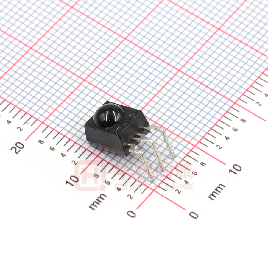

    IRD_6X6.95MM_TM
    工作电压:2.5V~5.5V 工作电流:1mA 接收距离:6m 中心频率:40kHz 接收角度:±35°@垂直;±35°@水平 工作温度:-25℃~+85℃
IRM-3640CF45 数据手册
Infrared Receiver Control Receiver Module IRM-36xxCF45series Features ‧ High protection ability against EMI ‧ Circular lens for improved reception characteristics ‧ Min burst length: 400us ‧ Min gap length: 450us ‧ Low operating voltage (Vcc = 2.5V) ‧ High immunity against ambient light ‧ Long reception range ‧ High sensitivity ‧ Pb free and RoHS compliant 1 2 3 Description The IRM-36xxCF45 devices are miniature type infrared receivers which have been developed and designed by using the latest IC technology, with high immunity against optical interferences and power supply noise. The photo diode and preamplifier are assembled onto a lead frame and molded into an epoxy package which operates as an IR filter. The demodulated output signal can directly be decoded by a microprocessor. Pin Configuration 1. OUT 2. GND 3. VCC Applications • AV equipment such as TV, VCR, DVD, CD, MD, etc. • Toy applications • CATV set top boxes • Multi-media Equipment Application Circuit Block Diagram The RC Filter must be connected as close as possible to Vcc and GND pins. Everlight Electronics Co., Ltd. Document No: DMO-0000211 Rev. 3 1 http://www.everlight.com November 1 ,2011 Infrared Receiver Control Receiver Module IRM-36xxCF45 series Parts Table Model No. Carrier Frequency IRM-3638CF45 38 kHz IRM-3640CF45 40 kHz Package Dimensions (Dimensions in mm) Everlight Electronics Co., Ltd. Document No: DMO-0000211 Rev. 3 2 http://www.everlight.com November 1 ,2011 Infrared Receiver Control Receiver Module IRM-36xxCF45series Absolute Maximum Ratings (Ta=25°C) Parameter Symbol Rating Unit Supply Voltage Vcc 6 V Operating Temperature Topr -25 ~ +85 Storage Temperature Tstg -40 ~ +85 Tsol 260 Soldering Temperature *1 *1 ℃ ℃ ℃ 4mm from mold body for less than 10 seconds Electro-Optical Characteristics (Ta=25℃ ℃, Vcc=3V) Parameter Symbol MIN. TYP. MAX. Unit Condition Current consumption Icc --- 1.0 1.3 mA No input signal Supply voltage VCC 2.5 - 5.5 V λp --- 940 --- nm L0 14 --- --- L45 6 --- --- Peak wavelength Reception range m See chapter ‚Test method’ Half angle(horizontal) φh --- ±35 --- deg Half angle(vertical) φv --- ±35 --- deg High level pulse width TH 450 --- 750 µs Low level pulse width TL 450 --- 750 µs Test signal according to figure 1 High level output voltage VOH Vcc-0.4 --- --- V Open circuit Low level output voltage VOL --- 0.2 0.5 V ISINK Internal pull up resistor RPU 40 50 60 kΩ Everlight Electronics Co., Ltd. Document No: DMO-0000211 Rev. 3 3 ≦2mA http://www.everlight.com November 1 ,2011 Infrared Receiver Control Receiver Module IRM-36xxCF45series Test method The specified electro-optical characteristics are valid under the following conditions. 1. Measurement environment A place without extreme light reflections. 2. External light The environment contains an ordinary, white fluorescent lamp without high frequency modulation. The ≦10Lux). color temperature is 2856K and the illumination at the IR receiver is less than 10 Lux (Ev 3. Standard transmitter The test transmitter is calibrated by using the circuit shown in figure 2. The radiation intensity of the transmitter is adjusted until Vo=400mVp-p. Both, the test transmitter and the photo diode, have a peak wavelength of 940nm. The photo diode for calibration is PD438B (λp=940nm, Vr=5V). 4. The measurement system is shown in Fig.-3 Fig.-1 Transmitter Wave Form D.U.T output Pulse Fig.-3 Fig.-2 standard transmitter calibration Everlight Electronics Co., Ltd. Document No: DMO-0000211 Rev. 3 4 Measuring System http://www.everlight.com November 1 ,2011 Infrared Receiver Control Receiver Module IRM-36xxCF45series Typical Electro-Optical Characteristic Curves Everlight Electronics Co., Ltd. Document No: DMO-0000211 Rev. 3 5 http://www.everlight.com November 1 ,2011 Infrared Receiver Control Receiver Module IRM-36xxCF45 series Code information Protocol Suitable Protocol Suitable JVC Yes RCA No Matsushita No Sharp No Mitsubishi No Sony 12 Bit Yes NEC Yes Sony 15 Bit Yes RC5 Yes Sony 20Bit No RC6 Yes Toshiba Yes RCMM No Zenith Yes RCS-80 No Continuous Code No Packing Quantity 1500 pcs / Box 10 Boxes / Carton Everlight Electronics Co., Ltd. Document No: DMO-0000211 Rev. 3 6 http://www.everlight.com November 1 ,2011 Infrared Receiver Control Receiver Module IRM-36xxCF45 series DISCLAIMER 1. Above specification may be changed without notice. EVERLIGHT will reserve authority on material change for above specification. 2. When using this product, please observe the absolute maximum ratings and the instructions for use outlined in these specification sheets. EVERLIGHT assumes no responsibility for any damage resulting from use of the product which does not comply with the absolute maximum ratings and the instructions included in these specification sheets. 3. These specification sheets include materials protected under copyright of EVERLIGHT. Reproduction in any form is prohibited without the specific consent of EVERLIGHT. Everlight Electronics Co., Ltd. Document No: DMO-0000211 Rev. 3 7 http://www.everlight.com November 1 ,2011
