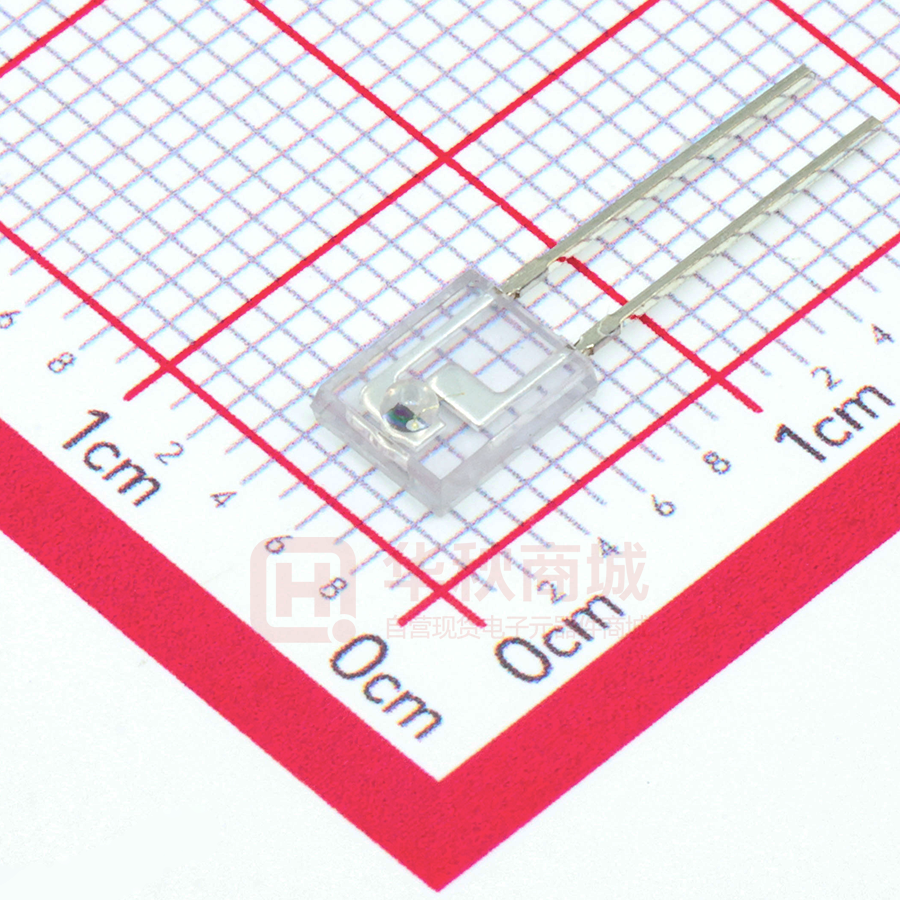

PT908-7C-F is a phototransistor in miniature package which
is molded in a water clear plastic with spherical top view lens.
The device is spectrally matched to infrared emitting diode.
