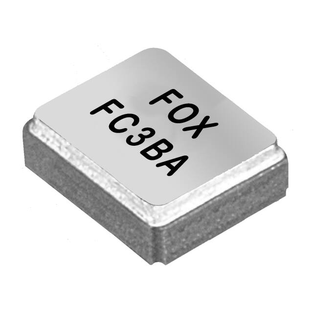

FC3BA 3.2mm x 2.5mm Auto Grade Crystal (Former FXA3225B) Features AEC Q200 Qualified IATF-16949 QMS Tolerances down to ±10 PPM Stabilities down to ±20 PPM • • • • STANDARD SPECIFICATIONS PARAMETERS Frequency Range MAX (Unless otherwise noted) 8.000 ~ 150.000 MHz Frequency Tolerance @ 25°C Frequency Stability, ref 25°C Temperature Range Operating (TOPR) Storage (TSTG) Shunt Capacitance (CO) Load Capacitance (CL) (See options below) (See options below) Drive Level Aging per year (@ 25°C) Maximum Soldering Temp / Time Moisture Sensitivity Level (MSL) per J-STD-033 Termination Finish 100µW ±5 PPM 260°C / 10 Seconds x 2 N/A DIMENSIONS / MECHANICAL SPECIFICATIONS (See options below) -55°C ~ +150°C 3 pF (See options below) Seal Method Au (0.3~1µm) over Ni (1.27~8.89µm) Seam Lead (Pb) Free RoHS Compliant REACH Compliant (latest version) Yes Yes, no exemptions Yes Frequency Range (MHz) Operating Mode Max ESR Ω 8.000 ~ 9.999999 10.000 ~ 11.999999 12.000 ~ 15.999999 16.000 ~ 19.999999 20.000 ~ 24.999999 25.000 ~ 53.999999 54.000 ~ 64.000 54.000 ~ 99.999999 100.000 ~ 124.999999 125.000 ~ 150.000 Fundamental Fundamental Fundamental Fundamental Fundamental Fundamental Fundamental 3RD OT 3RD OT 3RD OT 500 150 80 60 50 40 30 150 100 80 Note: Dimensional drawing is for reference to critical specifications defined by size measurements. AVAILABLE OPERATING TEMPERATURES AND STABILITIES1 Operating Temperature -40°C ~ +85°C -40°C ~ +105°C -40°C ~ +125°C -55°C ~ +125°C Revised A: 07/21/2020 ±20 PPM ±25 PPM ±30 PPM O O O X X O X X X X X X Key: O = Available, X = Not Available, Page 1 of 2 ±50 PPM O O O O ±100 PPM O O O O www.foxonline.com FC3BA 3.2mm x 2.5mm Auto Grade Crystal (Former FXA3225B) TAPE SPECIFICATIONS (mm) A B C D E F ø1.55 4.0 4.0 3.5 8.0 1.4 REEL SPECIFICATIONS (mm) REEL QTY -T3 = 3,000 -T2 = 2,000 -T1 = 1,000 G H I J K L M 2.5 Ø13 Ø21 Ø60 Ø180 9.0 2.0 Available Options & Part Identification for Automotive Crystal Model C3BA1 Sample PN: FC3BABCVI40.0 F C3BA Fox Model Number B C Tolerance Stability B = ±50 PPM A= ±100 PPM C = ±30 PPM B = ±50 PPM D = ±25 PPM C = ±30 PPM E = ±20 PPM D = ±25 PPM F = ±15 PPM E = ±20 PPM H = ±10 PPM V I 40.0 -T1 Load Capacitance2 V = 7pF D = 8pF E = 10pF G = 12pF J = 15pF K = 16pF L = 18pF M = 20pF Operating Temperature M = -40 to +85°C P = -40 to +105°C I = -40 to +125°C T = -55 to +125°C Frequency (MHz) Values Added Options Blank = Bulk T1 = 1,000 pcs T2 = 2,000 pcs T3 = 3,000 pcs 1 Not all frequency, tolerance, stability, load, and operating temperature combinations may be available. 2 Listed load capacitances represent the most commonly used. Other load capacitances are available. Contact us for assistance Reliability Test Conditions Please contact Abracon Quality Assurance department Revised A: 07/21/2020 Page 2 of 2 www.foxonline.com
FC3BACCGM20.0-T3
物料型号:FC3BA(原型号FXA3225B)
器件简介:汽车级晶体振荡器,尺寸为3.2mm x 2.5mm。
引脚分配:1号引脚为晶体,2号引脚为盖子/地线;3号引脚为晶体,4号引脚为盖子/地线。
参数特性: - 频率范围:8.000~150.000 MHz - 频率容差:具体选项见文档 - 频率稳定性:参考25°C时的具体选项 - 工作温度范围:具体选项见文档 - 存储温度范围:-55°C~+150°C - 电容:串联3pF,负载电容见选项 - 驱动级别:100 W - 年老化率:±5 PPM - 最大焊接温度/时间:260°C/10秒 x 2 - 表面处理:金(0.3~1um)覆盖镍(1.27~8.89 m) - 密封方法:接缝 - 无铅:是 - 符合RoHS:是,无豁免 - 符合REACH(最新版):是
功能详解:文档提供了详细的频率范围、操作模式、最大等效串联电阻(ESR)的表格。
应用信息:适用于汽车级应用,具有AEC Q200认证和IATF-16949质量管理体系。
