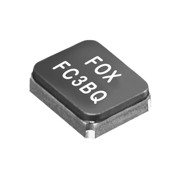

    无源晶振 25MHz ±50ppm 20pF 80Ω -10℃~+70℃
FC3BQBBME25.0-T3 数据手册
FC3BQ 3.2mm x 2.5mm SMD Crystal (Former FQ3225B) Features • • Tolerances down to ±20 PPM Stabilities down to ±10 PPM STANDARD SPECIFICATIONS PARAMETERS Frequency Range Frequency Tolerance @ 25°C Frequency Stability, ref 25°C Over Operating Temp Range Temperature Range Operating (TOPR) Storage (TSTG) Shunt Capacitance (CO) Load Capacitance (CL) Drive Level MAX (Unless otherwise noted) 12.000 ~ 50.000 MHz (See options below) Aging per year (@ 25°C) Maximum Soldering Temp / Time Moisture Sensitivity Level (MSL) per J-STD-033 Termination Finish Seal Method Lead (Pb) Free RoHS Compliant ±5 PPM 260°C / 10 Seconds 1 DIMENSIONS / MECHANICAL SPECIFICATIONS (See options below) (See options below) -55°C ~ +125°C 3 pF (See options below) 100µW Frequency Range (MHz) 12.000 ~ 15.999999 16.000 ~ 20.000 20.000001 ~ 25.000 25.000001 ~ 30.000 30.000001 ~ 50.000 Ag Resin YES YES Chamfer may be on pad 1 of pad 3 Operating Mode Max ESR Ω Fundamental Fundamental Fundamental Fundamental Fundamental 120 100 80 60 50 Note: Dimensional drawing is for reference to critical specifications defined by size measurements. Certain noncritical visual attributes, such as side castellations, cover shape, etc. may vary. AVAILABLE OPERATING TEMPERATURES AND STABILITIES* Operating Temperature ±10 PPM ±15 PPM ±20 PPM ±25 PPM ±30 PPM -10°C ~ +70°C O O O O O -20°C ~ +70°C O O O O O -40°C ~ +85°C X X X X O Key: O = Available, X = Not Available, ∆ = Consult Fox Technical Support *Does not imply a stocked part. Revised B: 12/01/2021 Page 1 of 2 ±50 PPM O O O www.foxonline.com FC3BQ 3.2mm x 2.5mm SMD Crystal (Former FQ3225B) TAPE SPECIFICATIONS (mm) REEL SPECIFICATIONS (mm) A B C D E F REEL QTY G H I J K L M ø1.5 4.0 4.0 3.5 8.0 1.25 -T3 = 3,000 2.0 Ø13 Ø21 Ø62 Ø178 9.0 1.2 Available Options & Part Identification for SMD Crystal FC3BQ1 Sample PN: FC3BQBBME25.0-T3 F C3BQ B B M E 25.0 -T3 Fox Model Number Tolerance B = ±50 PPM C = ±30 PPM D = ±25 PPM E = ±20 PPM Stability B = ±50 PPM C = ±30 PPM D = ±25 PPM E = ±20 PPM F = ±15 PPM H = ±10 PPM Load Capacitance2 V = 7pF D = 8pF E = 10pF G = 12pF K = 16pF M = 20pF Operating Temperature E = -10 to +70°C F = -20 to +70°C M = -40 to +85°C Frequency (MHz) Values Added Options Blank = Bulk T3 = 3,000 pcs 1 Not all frequency, tolerance, stability, load, and operating temperature combinations may be available. 2 Listed load capacitances represent the most commonly used. Other load capacitances are available. Contact us for assistance Reliability Test Conditions Please contact Abracon Quality Assurance department Revised B: 12/01/2021 Page 2 of 2 www.foxonline.com

物料型号:FC3BQ,曾用型号FQ3225B。
器件简介:SMD晶体振荡器,具有±20 PPM的容差和±10 PPM的稳定性。
引脚分配:文档中未明确列出引脚分配,但提到了推荐焊盘布局,可能暗示了引脚的位置。
参数特性: - 频率范围:12.000~50.000 MHz - 频率容差:根据选项不同而变化 - 频率稳定性:参考25°C时的稳定性,根据选项不同而变化 - 工作温度范围:根据选项不同而变化 - 存储温度范围:-55°C~+125°C - 并联电容:3pF - 负载电容:根据选项不同而变化 - 驱动电平:100 mW - 年老化率:±5 PPM - 最大焊接温度/时间:260°C/10秒 - 湿度敏感等级:1(根据J-STD-033) - 镀层:银 - 封装方法:树脂密封 - 无铅:是 - 符合RoHS:是
功能详解:文档提供了频率范围与工作模式下的最大功率电阻(ESR)的关系。
应用信息:文档未明确提供应用信息,但晶体振荡器通常用于时钟信号生成,适用于各种电子设备。
封装信息:3.2mm x 2.5mm的SMD封装,文档还提供了尺寸和机械规格的详细图表。
