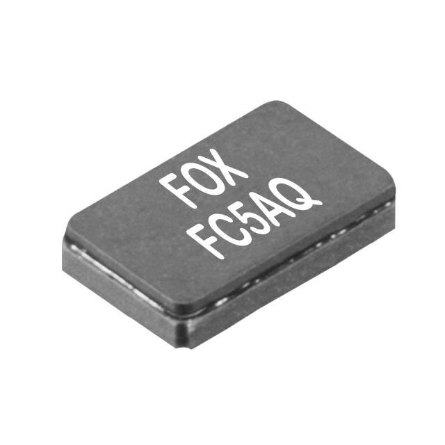

FC5AQ 5.0mm x 3.2mm SMD Crystal (Former FQ5032A) Features • • Tolerances down to ±20 PPM Stabilities down to ±10 PPM STANDARD SPECIFICATIONS PARAMETERS Frequency Range Frequency Tolerance @ 25°C Frequency Stability, ref 25°C Temperature Range Operating (TOPR) Storage (TSTG) Shunt Capacitance (CO) Load Capacitance (CL) Drive Level Aging per year (@ 25°C) Termination Finish Seal Method Lead (Pb) Free RoHS Compliant MAX (Unless otherwise noted) 8.000 ~ 48.000 MHz (See options below) (See options below) DIMENSIONS / MECHANICAL SPECIFICATIONS (See options below) -40°C ~ +85°C 5 pF (See options below) 0.5mW ±5 PPM Ag Resin Yes Yes Frequency Range (MHz) 8.000000 ~ 11.999999 12.000000 ~ 16.000 16.000001 ~ 48.000 Operating Mode Max ESR Ω Fundamental Fundamental Fundamental 100 80 50 Note: Dimensional drawing is for reference to critical specifications defined by size measurements. Certain non-critical visual attributes, such as side castellations, etc. may vary. AVAILABLE OPERATING TEMPERATURES AND STABILITIES* Operating Temperature ±10 PPM ±15 PPM ±20 PPM ±25 PPM 0°C ~ +70°C O O O O -20°C ~ +70°C O O O O -40°C ~ +85°C X X X X Key: O = Available, X = Not Available *Does not imply a stocked part. Revised B: 07/30/2021 Page 1 of 2 ±30 PPM O O O ±50 PPM O O O www.foxonline.com FC5AQ 5.0mm x 3.2mm SMD Crystal (Former FQ5032A) TAPE SPECIFICATIONS (mm) REEL SPECIFICATIONS (mm) A B C D E F REEL QTY G H I J K L M ø1.5 4.0 8.0 5.5 12.0 1.5 -T1 = 1,000 2.0 Ø13 Ø21 Ø62 Ø180 13.5 2.0 Available Options & Part Identification for SMD Crystal FC5AQ1 Sample PN: FC5AQCCMC25.0-T1 F C5AQ C C M C 25.0 -T1 Fox Model Number Tolerance B = 50 PPM C = 30 PPM D = 25 PPM E = 20 PPM Stability A = 100 PPM B = 50 PPM C = 30 PPM D = 25 PPM E = 20 PPM F = 15PPM H = 10 PPM Load Capacitance2 A= Series V = 7pF D = 8pF E = 10pF G = 12pF K = 16pF L = 18 pF M = 20pF Operating Temperature C = 0 to +70°C E = -10 to +70°C F = -20 to +70°C M = -40 to +85°C Frequency (MHz) Values Added Options Blank = Bulk T1 = 1,000 pcs 1 Not all frequency, tolerance, stability, load, and operating temperature combinations may be available. 2 Listed load capacitances represent the most commonly used. Other load capacitances are available. Contact us for assistance Reliability Test Conditions Please contact Abracon Quality Assurance department Revised B: 07/30/2021 Page 2 of 2 www.foxonline.com
FC5AQECLM25.0-T1
物料型号:FC5AQ(前称FQ5032A)
器件简介:5.0mm x 3.2mm SMD晶体振荡器,FUX系列。
引脚分配:文档中未明确提供引脚分配信息。
参数特性: - 频率范围:8.000~48.000 MHz - 频率容差:根据选项不同而变化 - 频率稳定性:根据选项不同而变化 - 工作温度范围:根据选项不同而变化 - 存储温度范围:-40°C~+85°C - 并联电容:根据选项不同而变化 - 负载电容:根据选项不同而变化 - 驱动电平:0.5mW - 年老化率:+5 PPM - 镀层:银 - 封装方法:树脂 - 无铅:是 - 符合RoHS:是
功能详解:文档中未提供详细的功能解释。
应用信息:文档中未明确提供应用信息
封装信息:5+0.2mm x 3.2+0.2mm x 1.2mm,底部视图,推荐焊盘布局。
可靠性测试条件:请联系Abracon质量保证部门。
