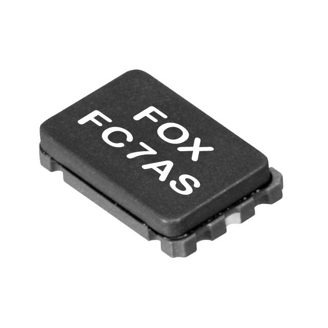

FC7AS 7.5mm x 5.0mm Ceramic SMD Crystal (Former FE) Features • • • • Tolerances down to ±30 PPM Stabilities down to ±15 PPM Temperature Ranges as wide as -40◦C to +85◦C Available above 28MHz (3rd & 5th Overtone Modes) STANDARD SPECIFICATIONS PARAMETERS Frequency Range Frequency Tolerance @ 25°C Frequency Stability, ref 25°C Temperature Range Operating (TOPR) Storage (TSTG) Shunt Capacitance (CO) Load Capacitance (CL) Drive Level Aging per year (@ 25°C) Maximum Soldering Temp / Time Moisture Sensitivity Level (MSL) per J-STD-033 Termination Finish Seal Method Lead (Pb) Free RoHS Compliant MAX (Unless otherwise noted) DIMENSIONS / MECHANICAL SPECIFICATIONS 6.000 ~ 160.000 MHz (See options below) (See options below) (See options below) -40°C ~ +85°C 5 pF (See options below) 0.5 mW ±5 PPM 260°C / 10 Seconds x 2 1 Au over Ni Resin Yes Yes Frequency Range (MHz) Operating Mode Max ESR Ω 6.000 ~ 7.999 8.000 ~ 9.999 10.000 ~ 15.999 16.000 ~ 50.000 28.000 ~ 84.000 >84.000 ~ 160.000 Fundamental Fundamental Fundamental Fundamental 3rd Overtone 5th Overtone 80 60 50 40 60 80 Note: Dimensional drawing is for reference to critical specifications defined by size measurements. Certain non-critical visual attributes, such as side castellations, etc. may vary. AVAILABLE OPERATING TEMPERATURES AND STABILITIES* Operating Temperature ±15 PPM ±20 PPM ±25 PPM ±30 PPM ±50 PPM -0°C ~ +75°C O O O O O -10°C ~ +60°C O O O O O -10°C ~ +70°C O O O O O -20°C ~ +70°C O O O O O -30°C ~ +85°C X O O O O -40°C ~ +85°C X O O O O Key: O = Available, X = Not Available, ∆ = Consult Fox Technical Support, *Does not imply a stocked part. Revised A: 10/24/2019 Page 1 of 2 www.foxonline.com FC7AS 7.5mm x 5.0mm Ceramic SMD Crystal (Former FE) TAPE SPECIFICATIONS (mm) A B ø1.5 C 4.0 8.0 D E 7.5 16.0 F REEL SPECIFICATIONS (mm) REEL QTY -T1 = 1,000 -T2 = 2,000 Default 2.3 G 2.0 H Ø13 I Ø21 J K L M Ø80 Ø180 Ø250 17.5 2.0 Available Options & Part Identification for Ceramic SMD Crystal C7AS1 Sample PN: FC7ASCCL40.0-T2 F C7AS C C L M 40.0 -T2 Fox Model Number Tolerance B = ±50 PPM C = ±30 PPM Stability B = ±50 PPM C = ±30 PPM D = ±25 PPM E = ±20 PPM F = ±15 PPM Load Capacitance2 E = 10pF G = 12pF J = 15pF L = 18pF M = 20pF Operating Temperature C = 0 to +70˚C D = -10 to +60˚C E = -10 to +70˚C F = -20 to +70˚C K = -30 to +85˚C M = -40 to +85˚C Frequency (MHz) Values Added Options Blank = Bulk T1 = 1,000 pcs T2 = 2,000 pcs 1 Not all frequency, tolerance, stability, load, and operating temperature combinations may be available. 2 Listed load capacitances represent the most commonly used. Other load capacitances are available. Contact us for assistance Reliability Test Conditions Please contact Abracon Quality Assurance department Revised A: 10/24/2019 Page 2 of 2 www.foxonline.com

物料型号:FC7AS
器件简介:该晶体振荡器具有以下特点: - 频率范围从6.000至160.000 MHz - 频率容差和稳定性选项多样 - 工作温度范围宽,从-40°C至+85°C - 适用于28MHz以上的第三和第五泛音模式
引脚分配:文档中未明确提供引脚分配信息。
参数特性: - 频率容差在25°C时有多种选项 - 频率稳定性参考25°C也有多种选项 - 存储温度范围为-40°C至+85°C - 并联电容为5pF - 负载电容有多种选项 - 驱动电平为0.5mW - 年老化率为±5 PPM - 最大焊接温度/时间为260°C/10秒×2 - 表面处理为金层覆盖镍层 - 密封方法为树脂 - 无铅且符合RoHS标准
功能详解:文档中未提供具体的功能详解
应用信息:文档中未明确提供应用信息
封装信息:提供了推荐的焊盘布局和尺寸,以及频率范围与最大等效串联电阻(ESR)的关系。
