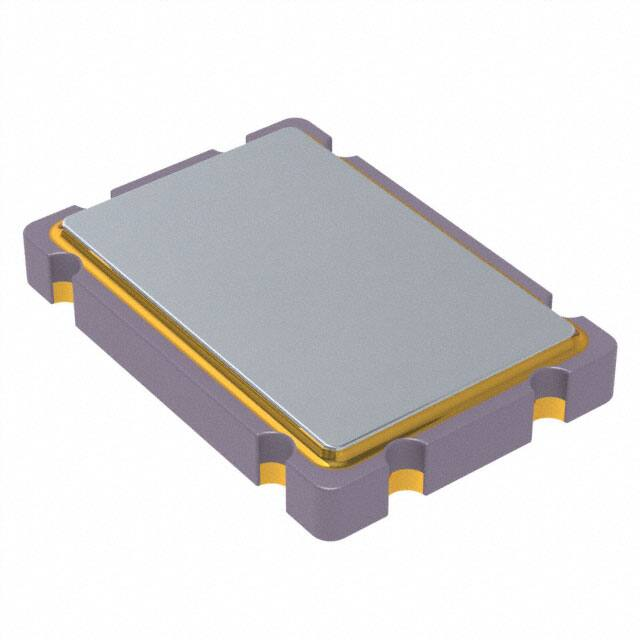

    无源晶振 20pF 10MHz ±30ppm 110Ω SMD7050_4P
FC7BSCCMC10.0-T1 数据手册
FC7BS 7mm x 5mm Ceramic SMD Crystal (Former FD) Features • • • Tolerances down to ±10 PPM Stabilities down to ±5 PPM Operating Temperature Range to –55°C ~ +125° STANDARD SPECIFICATIONS PARAMETERS Frequency Range Frequency Tolerance @ 25°C Frequency Stability, ref 25°C Temperature Range Operating (TOPR) Storage (TSTG) Shunt Capacitance (CO) Load Capacitance (CL) Drive Level 6.000 ~ 50.000 MHz Aging per year (@ 25°C) Maximum Soldering Temp / Time Moisture Sensitivity Level (MSL) per J-STD-033 Termination Finish Seal Method Lead (Pb) Free RoHS Compliant MAX (Unless otherwise noted) 6.000 ~ 50.000 MHz (See options below) (See options below) (See options below) -55°C ~ +125°C 5 pF (See options below) 0.5 mW ±3 PPM 260°C / 10 Seconds x 2 Not Applicable Au over Ni Seam Yes Yes Frequency Range (MHz) Operating Mode Max ESR Ω 6.000 ~ 9.999999 10.000 ~ 15.999999 16.000 ~ 31.999999 32.000 ~ 39.999999 40.000 ~ 50.000000 Fundamental Fundamental Fundamental Fundamental Fundamental 80 50 40 30 20 Revised B: 11/16/2021 DIMENSIONS / MECHANICAL SPECIFICATIONS Page 1 of 3 Note: Dimensional drawing is for reference to critical specifications defined by size measurements. Certain non-critical visual attributes, such as side castellations, etc. may vary. Cut corner/rounded pad not shown. Crystal has no polarity and cannot be placed incorrectly; pin numbers are for reference only. www.foxonline.com FC7BS 7mm x 5mm Ceramic SMD Crystal (Former FD) Operating Temperature -0°C ~ +70°C -10°C ~ +60°C -10°C ~ +70°C -20°C ~ +70°C -30°C ~ +85°C -40°C ~ +85°C -40°C ~ +105°C -40°C ~ +125°C -55°C ~ +155°C AVAILABLE OPERATING TEMPERATURES AND STABILITIES* ±5 PPM X O X X X X X X X ±10 PPM O O O O X X X X X ±15 PPM O O O O O O X X X ±20 PPM O O O O O O X X X ±25 PPM O O O O O O X X X ±30 PPM O O O O O O X X X ±50 PPM ±100 PPM O N/A O N/A O N/A O N/A O N/A O N/A O O O O O O Key: O = Available, X = Not Available, N/A = Not Applicable TAPE SPECIFICATIONS (mm) A B C D E F REEL QTY -T1 = 1,000 -T2 = 2,000 ø1.55 4.0 8.0 7.5 16.0 1.7 G H I J K L M 2.0 Ø13 Ø21 Ø80 Ø250 17.5 2.0 REEL SPECIFICATIONS (mm) Revised B: 11/16/2021 Page 2 of 3 www.foxonline.com FC7BS 7mm x 5mm Ceramic SMD Crystal (Former FD) Available Options & Part Identification for Crystal Model C7BS1 Sample PN: FC7BSBBMD25.0-T1 F C7BS B B M D 25.0 -T1 Fox Model Number Tolerance B = ±50 PPM C = ±30 PPM D = ±25 PPM E = ±20 PPM F = ±15 PPM H = ±10 PPM Stability A = ±100 PPM B = ±50 PPM C = ±30 PPM D = ±25 PPM E = ±20 PPM F = ±15 PPM H = ±10 PPM L = ±5 PPM Load Capacitance2 E = 10pF G = 12pF J = 15pF K = 16pF L = 18pF M = 20pF Operating Temperature C = 0 to +70˚C D = -10 to +60°C E = -10 to +70°C F = -20 to +70°C K = -30 to +85°C M = -40 to +85°C P = -40 to +105°C I = -40 to +125°C T = -55 to +125°C Frequency (MHz) Values Added Options Blank = Bulk T1 = 1,000 pcs T2 = 2,000 pcs 1 Not all frequency, tolerance, stability, load, and operating temperature combinations may be available. 2 Listed load capacitances represent the most commonly used. Other load capacitances are available. Contact us for assistance Reliability Test Conditions Please contact Abracon Quality Assurance department Revised B: 11/16/2021 Page 3 of 3 www.foxonline.com
FC7BSCCMC10.0-T1
- 物料型号: FC7BS - 器件简介: 7mm x 5mm尺寸的陶瓷SMD晶体振荡器,具有高精度和稳定性。 - 引脚分配: 引脚1为晶体引脚,引脚2为接地/盖子引脚。 - 参数特性: - 频率范围: 6.000~50.000 MHz - 频率容差: 根据选项不同 - 频率稳定性: 根据选项不同 - 工作温度范围: -55°C~+125°C - 负载电容: 根据选项不同 - 老化率: 每年±3 PPM - 最大焊接温度/时间: 260°C/10秒 x 2 - 表面处理: 金层覆盖镍 - 密封方法: 接缝 - 无铅: 是 - 符合RoHS: 是 - 功能详解: 提供了详细的频率稳定性和工作温度范围的选项,以及推荐的焊盘布局。 - 应用信息: 适用于需要高精度时钟源的应用。 - 封装信息: 7mm x 5mm的SMD封装,提供了胶带规格和卷轴规格的详细信息。
