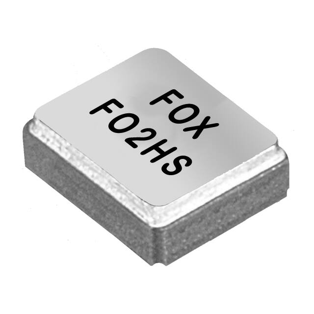

FO2HS (Former F200, F210, F230, F240) 2.5mm x 2.0mm HCMOS SMD Oscillator Features • • • • HCMOS Output Stabilities to ±20 PPM Temperature Ranges as wide as -40°C to +125°C Supply Voltages: 1.0V; 1.5V; 1.8V; 2.5V; 3.3V; Variable (1.6V ~ 3.63V; 2.25V ~ 3.63V) 1.0V ELECTRICAL CHARACTERISTICS PARAMETERS Frequency Range (FO) Temperature Range Storage (TSTG) Supply Voltage (VDD) Input Current (IDD) 1.8 ~ 32.1 MHz >32.1 ~ 50.0 MHz Standby Current Output Symmetry (50% VDD) Rise/Fall Time (20%/80% VDD Levels) (TR/TF) Output Voltage (VOL) (VOH) Output Load (HCMOS) Start-up Time (TS) Output Disable Time 1 Output Enable Time 1 MAX (Unless otherwise noted) 1.8~ 50.0 MHz -55°C ~ +125°C 1.0V±5% 2.5 mA 3.5 mA 100µA 40 % ~ 60 % 5 nS 20 % VDD 80 % VDD Min 15 pF 10 mS 50 µS 10 mS ENABLE / DISABLE FUNCTION Pin1 OPEN 1 ‘1’ Level VIH ≥ 70%VDD ‘0’ Level VIL ≤ 30%VDD Output (pin 3) Active Active High Z Available Options by Stability & Operating Temp for 1.0V Frequency Stability2 ±100PPM ±100PPM ±50PPM ±50PPM ±25PPM ±25PPM ±20PPM Operating Temperature (°C) -10 ~ +70 -40 ~ +85 -10 ~ +70 -40 ~ +85 -10 ~ +70 -40 ~ +85 -10 ~ +70 Frequency Range (MHz) 1.8 ~ 50.0 1.8 ~ 50.0 1.8 ~ 50.0 1.8 ~ 50.0 1.8 ~ 50.0 1.8 ~ 50.0 1.8 ~ 50.0 An internal pull-up resistor from pin 1 to pin 4 allows active output if pin 1 is left open Inclusive of 25°C tolerance, operating temperature range, input voltage change, load change, shock, Vibration, reflow, and one-year aging. 3 Inclusive of 25°C tolerance and operating temperature range. 1 2 Revised L: 12/17/2020 Page 2 of 13 www.foxonline.com FO2HS (Former F200, F210, F230, F240) 2.5mm x 2.0mm HCMOS SMD Oscillator 1.5V ELECTRICAL CHARACTERISTICS PARAMETERS Frequency Range (FO) Temperature Range Storage (TSTG) Supply Voltage (VDD) Input Current (IDD) 1.25 ~ 10.0 MHz >10.0 ~ 20.0 MHz >20.0 ~ 30.0 MHz >30.0 ~ 40.0 MHz >40.0 ~ 50.0 MHz Standby Current Output Symmetry (50% VDD) Rise/Fall Time (10%/90% VDD Levels) (TR/TF) MAX (Unless otherwise noted) 1.25 ~ 50.0 MHz -55°C ~ +125°C 1.5V±5% 2.5 mA 3.5 mA 4.0 mA 4.5 mA 6.0 mA 100µA 45 % ~ 55 % 10 nS Output Voltage (VOL) (VOH) Output Load (HCMOS) Start-up Time (TS) Output Disable Time 1 Output Enable Time 1 10 % VDD 90 % VDD Min 15 pF 10 mS 50 µS 10 mS ENABLE / DISABLE FUNCTION Pin1 OPEN 1 ‘1’ Level VIH ≥ 70%VDD ‘0’ Level VIL ≤ 30%VDD Output (pin 3) Active Active High Z Available Options by Stability & Operating Temp for 1.5V Frequency Stability2 ±100PPM ±100PPM ±50PPM ±50PPM ±25PPM ±25PPM3 Operating Temperature (°C) -20 ~ +70 -40 ~ +85 -20 ~ +70 -40 ~ +85 -20 ~ +70 -40 ~ +85 Frequency Range (MHz) 1.25 ~ 50.0 1.25 ~ 50.0 1.25 ~ 50.0 1.25 ~ 50.0 1.25 ~ 50.0 1.25 ~ 50.0 An internal pull-up resistor from pin 1 to pin 4 allows active output if pin 1 is left open Inclusive of 25°C tolerance, operating temperature range, input voltage change, load change, shock, Vibration, reflow, and one-year aging. 3 Inclusive of 25°C tolerance and operating temperature range. 1 2 Revised L: 12/17/2020 Page 3 of 13 www.foxonline.com FO2HS (Former F200, F210, F230, F240) 2.5mm x 2.0mm HCMOS SMD Oscillator 1.8V ELECTRICAL CHARACTERISTICS PARAMETERS Frequency Range (FO) Temperature Range Storage (TSTG) Supply Voltage (VDD) Input Current (IDD) 1.25 ~ 10.0 MHz >10.0 ~ 20.0 MHz >20.0 ~ 30.0 MHz >30.0 ~ 40.0 MHz >40.0 ~ 60.0 MHz >60.0 ~ 100.0 MHz >100.0 ~ 133.0 MHz Standby Current Output Symmetry (50% VDD) 1.25 ~ 50.0 MHz >50.0 MHz Rise/Fall Time (10%/90% VDD Levels) (TR/TF) Output Voltage (VOL) (VOH) Output Load (HCMOS) Start-up Time (TS) Output Disable Time 1 Output Enable Time 1 MAX (Unless otherwise noted) 1.25 ~ 133.0MHz -55°C ~ +125°C 1.8V±5% 2.5 mA 3.5 mA 4.0 mA 4.5 mA 6.0 mA 10.0 mA 20.0 mA 10µA 45 % ~ 55 % 40 % ~ 60 % 10 nS 10 % VDD 90 % VDD Min 15 pF 10 mS 10µA 10 mS ENABLE / DISABLE FUNCTION Pin1 OPEN 1 ‘1’ Level VIH ≥ 70%VDD ‘0’ Level VIL ≤ 30%VDD Output (pin 3) Active Active High Z Available Options by Stability & Operating Temp for 1.8V Frequency Stability2 ±100PPM ±100PPM ±50PPM ±50PPM ±25PPM ±25PPM3 Operating Temperature (°C) -10 ~ +70 -40 ~ +85 -10 ~ +70 -40 ~ +85 -10 ~ +70 -40 ~ +85 Frequency Range (MHz) 1.25 ~ 133.0 1.25 ~ 133.0 1.25 ~ 133.0 1.25 ~ 133.0 1.25 ~ 133.0 1.25 ~ 133.0 An internal pull-up resistor from pin 1 to pin 4 allows active output if pin 1 is left open Inclusive of 25°C tolerance, operating temperature range, input voltage change, load change, shock, Vibration, reflow, and one-year aging. 3 Inclusive of 25°C tolerance and operating temperature range. 1 2 Revised L: 12/17/2020 Page 4 of 13 www.foxonline.com FO2HS 2.5mm x 2.0mm HCMOS SMD Oscillator (Former F200, F210, F230, F240) 2.5V ELECTRICAL CHARACTERISTICS PARAMETERS Frequency Range (FO) Temperature Range Storage (TSTG) Supply Voltage (VDD) Input Current (IDD) 1.25 ~ 19.999999 MHz 20.0 ~ 39.999999 MHz 40.0 ~ 50.0 MHz >50.0MHz ~ 170MHz Standby Current Output Symmetry (50% VDD) 1.25 ~ 50.0 MHz >50.0 MHz Rise/Fall Time (10%/90% VDD Levels) (TR/TF) MAX (Unless otherwise noted) 1.25 ~ 170.0 MHz Output Voltage 10 % VDD 90 % VDD Min 15 pF 10 mS 200 µS 10 mS (VOL) (VOH) Output Load (HCMOS) Start-up Time (TS) Output Disable Time 1 Output Enable Time 1 -55°C ~ +125°C 2.5V±5% 5 mA 9 mA 11 mA 30 mA 10µA 45 % ~ 55 % 40 % ~ 60 % 10 nS ENABLE / DISABLE FUNCTION Pin1 OPEN 1 ‘1’ Level VIH ≥ 80%VDD ‘0’ Level VIL ≤ 20%VDD Output (pin 3) Active Active High Z Available Options by Stability & Operating Temp for 1.5V Frequency Stability2 ±100PPM ±100PPM ±50PPM ±50PPM ±25PPM ±25PPM3 Operating Temperature (°C) -20 ~ +70 -40 ~ +85 -20 ~ +70 -40 ~ +85 -20 ~ +70 -40 ~ +85 Frequency Range (MHz) 1.25 ~ 170.0 1.25 ~ 170.0 1.25 ~ 170.0 1.25 ~ 170.0 1.25 ~ 170.0 1.25 ~ 170.0 An internal pull-up resistor from pin 1 to pin 4 allows active output if pin 1 is left open Inclusive of 25°C tolerance, operating temperature range, input voltage change, load change, shock, Vibration, reflow, and one-year aging. 3 Inclusive of 25°C tolerance and operating temperature range. 1 2 Revised L: 12/17/2020 Page 5 of 13 www.foxonline.com FO2HS 2.5mm x 2.0mm HCMOS SMD Oscillator (Former F200, F210, F230, F240) 3.3V ELECTRICAL CHARACTERISTICS PARAMETERS Frequency Range (FO) Temperature Range Storage (TSTG) Supply Voltage (VDD) Input Current (IDD) 1.00 ~ 19.999999 MHz 20.0 ~ 39.999999 MHz 40.0 ~ 50.0 MHz >50.0 ~ 170MHz Standby Current (-20 to 70˚C; -40 to 85˚C) (-40 to +105˚C) Output Symmetry (50% VDD) 1.00 ~ 50.0 MHz >50.0 MHz Rise/Fall Time (10%/90% VDD Levels) (TR/TF) MAX (Unless otherwise noted) 1.00 ~ 170.0 MHz Output Voltage 10 % VDD 90 % VDD Min 15 pF 10 mS 200 µS 10 mS (VOL) (VOH) Output Load (HCMOS) Start-up Time (TS) Output Disable Time 1 Output Enable Time 1 -55°C ~ +125°C 3.3V±5% 7 mA 13 mA 19 mA 40 mA 10µA 20µA 45 % ~ 55 % 40 % ~ 60 % 10 nS ENABLE / DISABLE FUNCTION Pin1 OPEN 1 ‘1’ Level VIH ≥ 80%VDD ‘0’ Level VIL ≤ 20%VDD Output (pin 3) Active Active High Z Available Options by Stability & Operating Temp for 3.3V Frequency Stability2 ±100PPM ±100PPM ±100PPM ±50PPM ±50PPM ±50PPM ±25PPM ±25PPM3 Operating Temperature (°C) -20 ~ +70 -40 ~ +85 -40 ~ +105 -20 ~ +70 -40 ~ +85 -40 ~ +105 -20 ~ +70 -40 ~ +85 Frequency Range (MHz) 1.00 ~ 170.0 1.00 ~ 170.0 2 ~ 50.0 1.00 ~ 170.0 1.00 ~ 170.0 2 ~ 50.0 1.00 ~ 170.0 1.00 ~ 170.0 An internal pull-up resistor from pin 1 to pin 4 allows active output if pin 1 is left open Inclusive of 25°C tolerance, operating temperature range, input voltage change, load change, shock, Vibration, reflow, and one-year aging. 3 Inclusive of 25°C tolerance and operating temperature range. 1 2 Revised L: 12/17/2020 Page 6 of 13 www.foxonline.com FO2HS 2.5mm x 2.0mm HCMOS SMD Oscillator (Former F200, F210, F230, F240) VARIABLE VOLTAGE ELECTRICAL CHARACTERISTICS PARAMETERS Frequency Range (FO) Temperature Range Storage (TSTG) Supply Voltage (VDD) 0.75 ~ 135.0 MHz >135.0 ~ 156.25 MHz Input Current (IDD) 0.75 ~ 19.999 MHz 20.0 ~ 39.999 MHz 40.0 ~ 59.999 MHz 60.0 ~ 84.999 MHz 85.0 ~ 135.0 MHz >135.0 ~ 156.250 MHz Standby Current TOPR= -40 ~ +85°C TOPR= -40 ~ +105°C / -40 ~ +125°C Output Symmetry (50% VDD) 0.75 ~ 84.999 MHz 85.0 ~ 156.25 MHz Rise/Fall Time (10%/90% VDD Levels) (TR/TF) Output Voltage (VOL) (VOH) Output Load (HCMOS) Start-up Time (TS) Output Disable Time 1 Output Enable Time 1 MAX (Unless otherwise noted) 0.75 ~ 156.25 MHz -55°C ~ +125°C 1.6V ~ 3.63V 2.25V ~ 3.63V 4 mA 6 mA 10 mA 15 mA 30 mA 40 mA 10 µA 20 µA 45 % ~ 55 % 40 % ~ 60 % 6 nS 10 % VDD 90 % VDD Min 15 pF 5 mS 200nS 5 mS ENABLE / DISABLE FUNCTION Pin1 OPEN 1 ‘1’ Level VIH ≥ 70%VDD ‘0’ Level VIL ≤ 30%VDD Revised L: 12/17/2020 Output (pin 3) Active Active High Z Page 7 of 13 www.foxonline.com FO2HS (Former F200, F210, F230, F240) 2.5mm x 2.0mm HCMOS SMD Oscillator Available Options by Stability & Operating Temp For Variable Voltage Frequency Stability2 ±100PPM ±100PPM ±100PPM ±100PPM ±50PPM ±50PPM ±50PPM ±50PPM ±25PPM ±25PPM3 ±25PPM3 Operating Temperature (°C) -20 ~ +70 -40 ~ +85 -40 ~ +105 -40 ~ +125 -20 ~ +70 -40 ~ +85 -40 ~ +105 -40 ~ +125 -20 ~ +70 -40 ~ +85 -20 ~ +70 Frequency Range (MHz) 0.75 ~ 156.25 0.75 ~ 156.25 1.25 ~ 135.0 1.25 ~ 135.0 0.75 ~ 156.25 0.75 ~ 156.25 1.25 ~ 135.0 1.25 ~ 135.0 0.75 ~ 156.25 0.75 ~ 156.25 0.75 ~ 156.25 An internal pull-up resistor from pin 1 to pin 4 allows active output if pin 1 is left open Inclusive of 25°C tolerance, operating temperature range, input voltage change, load change, shock, Vibration, reflow, and one-year aging. 3 Inclusive of 25°C tolerance and operating temperature range. 1 2 Revised L: 12/17/2020 Page 8 of 13 www.foxonline.com FO2HS 2.5mm x 2.0mm HCMOS SMD Oscillator (Former F200, F210, F230, F240) DIMENSIONS / MECHANICAL SPECIFICATIONS ` Note: 1, A 0.01μF capacitor should be placed between VDD (Pin 4) and GND (Pin2) to minimize power supply line noise. 2, Dimensional drawing is for reference to critical specifications defined by size measurements. Certain non-critical visual attributes, such as side castellation’s, etc. may vary. STANDARD SPECIFICATIONS PARAMETERS Maximum Soldering Temp / Time Moisture Sensitivity Level (MSL) Termination Finish Seal Method Lead (Pb) Free RoHS Compliant REACH Compliant (latest version) Revised L: 12/17/2020 MAX (Unless otherwise noted) 260°C / 10 Seconds x 2 N/A Au (0.3~1µm) over Ni (1.27~8.89µm) Seam Yes Yes, no exemptions Yes Page 9 of 13 www.foxonline.com FO2HS 2.5mm x 2.0mm HCMOS SMD Oscillator (Former F200, F210, F230, F240) TAPE SPECIFICATIONS (mm) A B C D E F ø1.55 4.0 4.0 3.5 8.0 1.15 REEL SPECIFICATIONS (mm) REEL QTY -T3 = 3,000 -T2 = 2,000 -T1 = 1,000 G H I J K L M 2.0 Ø13 Ø21 Ø60 Ø180 9.0 2.0 Available Options & Part Identification* Sample PN: FO2HSBBM25.0-T3 F O2HS B B M 25.0 -T3 Fox Model Number Voltage M = 1.0V±5% I = 1.5V±5% K = 1.8V±5% H = 2.5V±5% B = 3.3V±5% V = 1.6V to 3.63V W = 2.25V to 3.63V Stability A = ±100 PPM B = ±50 PPM D = ±25 PPM E = ±20 PPM Operating Temperature E = -10 to +70˚c F = -20 to +70˚C M = -40 to +85˚C P = -40 to +105˚C I = -40 to +125˚C Frequency (MHz) Values Added Options Blank = Bulk T1 = 1,000 pcs T2 = 2,000 pcs T3 = 3,000 pcs * Not all frequencies in the frequency range, or every combination of stability, temp range, and voltage available. See stabilities and op temps for each VDD. Reliability Test Conditions Please contact Abracon Quality Assurance department Revised L: 12/17/2020 Page 10 of 13 www.foxonline.com
FO2HSBAP16.0-T1
物料型号:FO2HS
器件简介:这是一个2.5mm x 2.0mm的HCMOS表面贴装振荡器,之前型号为F200, F210, F230, F240。
引脚分配:文档中提到了引脚1作为输出(连接到引脚3),并且有一个使能/禁用功能。
参数特性: - 工作温度范围宽,从-40°C到+125°C。 - 供电电压多样,包括1.0V、1.5V、1.8V、2.5V、3.3V和可变电压(1.6V至3.63V或2.25V至3.63V)。 - 频率范围从1.00MHz至170.0MHz,具体取决于供电电压。 - 输入电流、待机电流、输出对称性、上升/下降时间、输出电压、启动时间和输出使能/禁用时间等电气特性详细列出。
功能详解:包括详细的电气特性表,展示了不同供电电压下的参数,如输入电流、频率范围、存储温度等。
应用信息:虽然文档中没有直接提到应用信息,但从振荡器的参数特性可以推断,它适用于需要小型化和精确时钟源的电子设备。
封装信息:提供了尺寸和机械规格,包括焊接温度/时间、湿度敏感等级、端接表面处理、密封方法、无铅和RoHS合规性。
