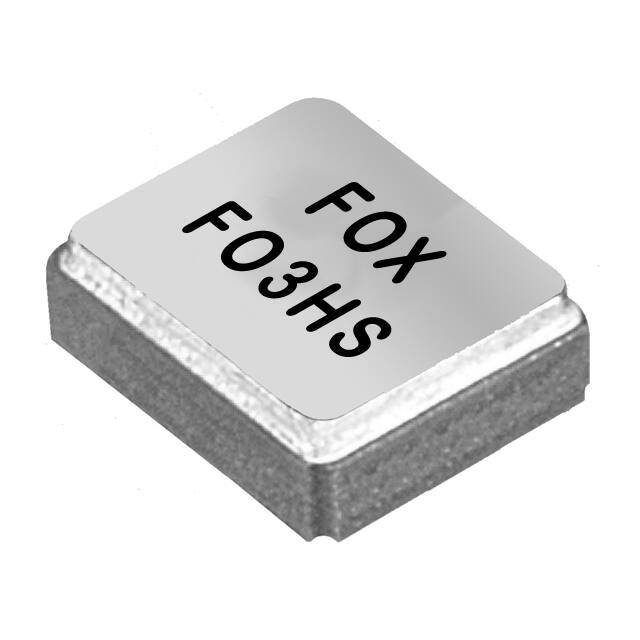

FO3HSCBE40.0-T1 数据手册
FO3HS (Former F300, F310, F330, F340 Series) 3.2mm x 2.5mm HCMOS SMD Oscillator Features • • • • HCMOS Output Stabilities to ±20 PPM Temperature Ranges as wide as -40°C to +125°C Supply Voltages: 1.0V, 1.8V, 2.5V, 3.3V, Variable (1.6V ~ 3.63V; 2.25V ~ 3.63V) 1.0V ELECTRICAL CHARACTERISTICS PARAMETERS Frequency Range Temperature Range Storage (TSTG) Supply Voltage (VDD) Input Current (IDD) 1.800 ~ 32.100 MHz >32.100 ~ 50.000 MHz Standby Current Output Symmetry (50% VDD) Rise/Fall Time (20%/80% VDD Levels) (TR/TF) Output Voltage (VOL) (VOH) Output Load (HCMOS) Start-up Time (TS) Output Disable Time 1 Output Enable Time 1 MAX (Unless otherwise noted) 1.800 ~ 50.000 MHz -55°C ~ +125°C 1.0V±5% 2.5 mA 3.5 mA 100 µA 40 % ~ 60 % 5 nS 20 % VDD 80 % VDD Min 15 pF 10 mS 50 µS 10 mS ENABLE / DISABLE FUNCTION Pin1 OPEN 1 ‘1’ Level VIH ≥ 70%VDD ‘0’ Level VIL ≤ 30%VDD Output (pin 3) Active Active High Z Available Options by Stability & Operating Temp for 1.0V Frequency Stability2 ±100PPM ±100PPM ±50PPM ±50PPM ±25PPM ±25PPM3 ±20PPM3 Operating Temperature (°C) -10 ~ +70 -40 ~ +85 -10 ~ +70 -40 ~ +85 -10 ~ +70 -40 ~ +85 -10 ~ +70 Frequency Range (MHz) 1.800 ~ 50.000 1.800 ~ 50.000 1.800 ~ 50.000 1.800 ~ 50.000 1.800 ~ 50.000 1.800 ~ 50.000 1.800 ~ 50.000 An internal pull-up resistor from pin 1 to pin 4 allows active output if pin 1 is left open Inclusive of 25°C tolerance, operating temperature range, input voltage change, load change, Shock, vibration, reflow, and one-year aging. 3 Inclusive of 25°C tolerance and operating temperature range. 1 2 Revised E: 12/17/2020 Page 1 of 7 www.foxonline.com FO3HS 3.2mm x 2.5mm HCMOS SMD Oscillator (Former F300, F310, F330, F340 Series) 1.8V ELECTRICAL CHARACTERISTICS PARAMETERS Frequency Range Temperature Range Storage (TSTG) Supply Voltage (VDD) Input Current (IDD) 0.625 ~ 32.000 MHz >32.000 ~ 80.000 MHz >80.000 ~ 133.000 MHz Standby Current Output Symmetry (50% VDD) 0.625 ~ 84.999999MHz 85.000 ~ 133MHz Rise/Fall Time (20%/80% VDD Levels) (TR/TF) 0.625 ~ 32.000 MHz >32.000 ~ 133.000 MHz Output Voltage (VOL) (VOH) Output Load (HCMOS) Start-up Time (TS) Output Disable Time 1 Output Enable Time 1 MAX (Unless otherwise noted) 0.625 ~ 133.000 MHz -55°C ~ +125°C 1.8V±5% 6 mA 15 mA 20 mA 10 µA 45 % ~ 55 % 40 % ~ 60 % 5 nS 3.5 nS 20 % VDD 80 % VDD Min 15 pF 10 mS 300 µS 10 mS ENABLE / DISABLE FUNCTION Pin1 OPEN 1 ‘1’ Level VIH ≥ 70%VDD ‘0’ Level VIL ≤ 30%VDD Output (pin 3) Active Active High Z Available Options by Stability & Operating Temp for 1.8V Frequency Stability2 ±100PPM ±100PPM ±50PPM ±50PPM ±25PPM ±25PPM3 ±20PPM3 Operating Temperature (°C) -10 ~ +70 -40 ~ +85 -10 ~ +70 -40 ~ +85 -10 ~ +70 -40 ~ +85 -10 ~ +70 Frequency Range (MHz) 0.625 ~ 133.000 0.625 ~ 133.000 0.625 ~ 133.000 0.625 ~ 133.000 0.625 ~ 133.000 0.625 ~ 133.000 0.625 ~ 133.000 An internal pull-up resistor from pin 1 to pin 4 allows active output if pin 1 is left open Inclusive of 25°C tolerance, operating temperature range, input voltage change, load change, Shock, vibration, reflow, and one-year aging. 3 Inclusive of 25°C tolerance and operating temperature range. 1 2 Revised E: 12/17/2020 Page 2 of 7 www.foxonline.com FO3HS 3.2mm x 2.5mm HCMOS SMD Oscillator (Former F300, F310, F330, F340 Series) 2.5V ELECTRICAL CHARACTERISTICS PARAMETERS Frequency Range Temperature Range Storage (TSTG) Supply Voltage (VDD) Input Current (IDD) 0.625 ~ 20.000 MHz >20.000 ~ 40.000 MHz >40.000 ~ 60.000 MHz >60.000 ~ 80.000MHz >80.000 ~ 170.000 MHz Standby Current Output Symmetry (50% VDD) 0.625 ~ 84.999999MHz 85.000 ~ 170MHz Rise/Fall Time (10%/90% VDD Levels) (TR/TF) Output Voltage (VOL) (VOH) Output Load (HCMOS) Start-up Time (TS) Output Disable Time 1 Output Enable Time 1 MAX (Unless otherwise noted) 0.625 ~ 170.000 MHz -55°C ~ +125°C 2.5V±5% 5 mA 9 mA 11 mA 20 mA 30 mA 10 µA 45 % ~ 55 % 40 % ~ 60 % 6 nS 10 % VDD 90 % VDD Min 15 pF 5 mS 150 nS 5 mS ENABLE / DISABLE FUNCTION Pin1 OPEN 1 ‘1’ Level VIH ≥ 70%VDD ‘0’ Level VIL ≤ 30%VDD Output (pin 3) Active Active High Z Available Options by Stability & Operating Temp for 2.5V Frequency Stability2 ±100PPM ±100PPM ±100PPM ±50PPM ±50PPM ±50PPM ±25PPM ±25PPM ±25PPM3 ±20PPM3 ±20PPM3 Operating Temperature (°C) -10 ~ +70 -20 ~ +70 -40 ~ +85 -10 ~ +70 -20 ~ +70 -40 ~ +85 -10 ~ +70 -20 ~ +70 -40 ~ +85 -10 ~ +70 -20 ~ +70 Frequency Range (MHz) 0.625 ~ 170.000 0.625 ~ 170.000 0.625 ~ 170.000 0.625 ~ 170.000 0.625 ~ 170.000 0.625 ~ 170.000 0.625 ~ 170.000 0.625 ~ 170.000 0.625 ~ 170.000 0.625 ~ 170.000 0.625 ~ 170.000 An internal pull-up resistor from pin 1 to pin 4 allows active output if pin 1 is left open Inclusive of 25°C tolerance, operating temperature range, input voltage change, load change, Shock, vibration, reflow, and one-year aging. 3 Inclusive of 25°C tolerance and operating temperature range. 1 2 Revised E: 12/17/2020 Page 3 of 7 www.foxonline.com FO3HS 3.2mm x 2.5mm HCMOS SMD Oscillator (Former F300, F310, F330, F340 Series) 3.3V ELECTRICAL CHARACTERISTICS PARAMETERS Frequency Range Temperature Range Storage (TSTG) Supply Voltage (VDD) Input Current (IDD) 0.625 ~ 20.000 MHz >20.000 ~ 40.000 MHz >40.000 ~ 60.000 MHz >60.000 ~ 75.000MHz >75.000 ~ 80.000 MHz >80.000 ~ 125.000 MHz >125.000 ~ 170.000 MHz Standby Current Output Symmetry (50% VDD) 0.625 ~ 84.999999MHz 85.000 ~ 170MHz Rise/Fall Time (10%/90% VDD Levels) (TR/TF) Output Voltage (VOL) (VOH) Output Load (HCMOS) Start-up Time (TS) Output Disable Time 1 Output Enable Time 1 MAX (Unless otherwise noted) 0.625 ~ 170 MHz -55°C ~ +125°C 3.3V±10% 7 mA 13 mA 19 mA 24 mA 30 mA 40 mA 50 mA 10 µA 45 % ~ 55 % 40 % ~ 60 % 6 nS 10 % VDD 90 % VDD Min 15 pF 5 mS 150 nS 5 mS ENABLE / DISABLE FUNCTION Pin1 OPEN 1 ‘1’ Level VIH ≥ 70%VDD ‘0’ Level VIL ≤ 30%VDD Output (pin 3) Active Active High Z Available Options by Stability & Operating Temp for 3.3V Frequency Stability2 ±100PPM ±100PPM ±100PPM ±50PPM ±50PPM ±50PPM ±25PPM ±25PPM ±25PPM3 ±20PPM3 ±20PPM3 Operating Temperature (°C) -10 ~ +70 -20 ~ +70 -40 ~ +85 -10 ~ +70 -20 ~ +70 -40 ~ +85 -10 ~ +70 -20 ~ +70 -40 ~ +85 -10 ~ +70 -20 ~ +70 Frequency Range (MHz) 0.625 ~ 170.000 0.625 ~ 170.000 0.625 ~ 170.000 0.625 ~ 170.000 0.625 ~ 170.000 0.625 ~ 170.000 0.625 ~ 170.000 0.625 ~ 170.000 0.625 ~ 170.000 0.625 ~ 170.000 0.625 ~ 170.000 An internal pull-up resistor from pin 1 to pin 4 allows active output if pin 1 is left open Inclusive of 25°C tolerance, operating temperature range, input voltage change, load change, Shock, vibration, reflow, and one year aging. 3 Inclusive of 25°C tolerance and operating temperature range. 1 2 Revised E: 12/17/2020 Page 4 of 7 www.foxonline.com FO3HS 3.2mm x 2.5mm HCMOS SMD Oscillator (Former F300, F310, F330, F340 Series) VARIABLE VOLTAGE ELECTRICAL CHARACTERISTICS PARAMETERS Frequency Range Temperature Range Storage (TSTG) Supply Voltage (VDD) 1.25 ~ 135.0 MHz >135.0 ~ 156.25 MHz Input Current (IDD) 0.750 ~ 19.999 MHz 20.000 ~ 39.999 MHz 40.000 ~ 59.999 MHz 60.000 ~ 84.999 MHz 85.000 ~ 135.000 MHz >135.000 ~ 156.250 MHz Standby Current TOPR= -40 ~ +85°C TOPR= -40 ~ +105°C / -40 ~ +125°C Output Symmetry (50% VDD) 0.75 ~ 84.999 MHz 85.0 ~ 156.25 MHz Rise/Fall Time (10%/90% VDD Levels) (TR/TF) Output Voltage (VOL) (VOH) Output Load (HCMOS) Start-up Time (TS) Output Disable Time 1 Output Enable Time 1 MAX (Unless otherwise noted) 0.75 ~ 156.25 MHz -55°C ~ +125°C 1.6V ~ 3.63V 2.25V ~ 3.63V 4 mA 6 mA 10 mA 15 mA 23 mA 30 mA 10 µA 20 µA ENABLE / DISABLE FUNCTION Pin1 OPEN 1 ‘1’ Level VIH ≥ 70%VDD ‘0’ Level VIL ≤ 30%VDD 45 % ~ 55 % 40 % ~ 60 % 6 nS 10 % VDD 90 % VDD Min 15 pF 5 mS 200 nS 5 mS Output (pin 3) Active Active High Z Available Options by Stability & Operating Temp Frequency Stability2 ±100PPM ±100PPM ±100PPM ±100PPM ±50PPM ±50PPM ±50PPM ±50PPM ±25PPM ±20PPM3 ±20PPM3 Operating Temperature (°C) -20 ~ +70 -40 ~ +85 -40 ~ +105 -40 ~ +125 -20 ~ +70 -40 ~ +85 -40 ~ +105 -40 ~ +125 -20 ~ +70 -40 ~ +85 -20 ~ +70 Frequency Range (MHz) 0.75 ~ 156.25 0.75 ~ 156.25 1.25 ~ 135.0 1.25 ~ 135.0 0.75 ~ 156.25 0.75 ~ 156.25 1.25 ~ 135.0 1.25 ~ 135.0 0.75 ~ 156.25 0.75 ~ 156.25 0.75 ~ 156.25 An internal pull-up resistor from pin 1 to pin 4 allows active output if pin 1 is left open of 25°C tolerance, operating temperature range, input voltage change, load change, Shock, vibration, reflow, and one-year aging. 3 Inclusive of 25°C tolerance and operating temperature range. 1 2 Inclusive Revised E: 12/17/2020 Page 5 of 7 www.foxonline.com FO3HS (Former F300, F310, F330, F340 Series) 3.2mm x 2.5mm HCMOS SMD Oscillator DIMENSIONS / MECHANICAL SPECIFICATIONS ` Note: 1, A 0.01μF capacitor should be placed between VDD (Pin 4) and GND (Pin2) to minimize power supply line noise. 2, Dimensional drawing is for reference to critical specifications defined by size measurements. Certain non-critical visual attributes, such as side castellation’s, etc. may vary. STANDARD SPECIFICATIONS PARAMETERS Maximum Soldering Temp / Time Moisture Sensitivity Level (MSL) Termination Finish Seal Method Lead (Pb) Free RoHS Compliant REACH Compliant (latest version) Revised E: 12/17/2020 MAX (Unless otherwise noted) 260°C / 10 Seconds x 2 1 Au over Ni Seam Yes Yes, no exemptions Yes Page 6 of 7 www.foxonline.com FO3HS 3.2mm x 2.5mm HCMOS SMD Oscillator (Former F300, F310, F330, F340 Series) TAPE SPECIFICATIONS (mm) A B C D E F ø1.55 4.0 4.0 3.5 8.0 1.4 REEL SPECIFICATIONS (mm) REEL QTY -T2 = 2,000 Default -T1 = 1,000 -T3 = 3,000 G H I J K L M 2.0 Ø13 Ø21 Ø60 Ø180 9.0 1.2 Available Options & Part Identification for SMD Oscillator O3HS* Sample PN: FO3HSCBM25.0-T2 F O3HS C B M 25.0 -T2 Fox Model Number Voltage M = 1.0V±5% K = 1.8V±5% H = 2.5V±5% C = 3.3V±10% V = 1.6V to 3.63V W = 2.25V to 3.63V Stability A = ±100 PPM B = ±50 PPM D = ±25 PPM E = ±20 PPM Operating Temperature E = -10 to +70°C F = -20 to +70°C M = -40 to +85°C P = 40 to +105°C I = -40 to +125°C Frequency (MHz) Values Added Options Blank = Bulk T1 = 1,000 pcs T2 = 2,000 pcs T3 = 3,000 pcs * Not all frequencies in the frequency range, or every combination of stability, temp range, and voltage available. See stabilities and op temps for each VDD. Reliability Test Conditions Please contact Abracon Quality Assurance department Revised E: 12/17/2020 Page 7 of 7 www.foxonline.com
FO3HSCBE40.0-T1
物料型号:FO3HS
器件简介:这是一个3.2mm x 2.5mm封装的HCMOS表面贴装振荡器,之前称为F300, F310, F330, F340系列。
引脚分配: - #1 E/D:使能/禁用功能 - #2 GND:地 - #3 输出:HCMOS输出 - #4 VDD:供电电压
参数特性: - 工作频率范围:1.800~50.000 MHz(1.0V供电);0.625~133.000 MHz(1.8V供电);0.625~170.000 MHz(2.5V供电);0.625~170 MHz(3.3V供电);0.75~156.25 MHz(可变电压) - 温度范围:-40°C 至 +125°C - 供电电压:1.0V, 1.8V, 2.5V, 3.3V, 可变(1.6V ~ 3.63V; 2.25V ~ 3.63V) - 输入电流:根据频率和供电电压不同而变化 - 启动时间:10ms(1.0V, 1.8V)或5ms(2.5V, 3.3V, 可变电压) - 输出禁用时间:50us(1.0V)或150ns(2.5V, 3.3V, 可变电压) - 输出使能时间:10ms
功能详解: - HCMOS输出 - 稳定性:±20 PPM - 使能/禁用功能:通过Pin2控制,'1' 级别激活输出,'0' 级别高阻态
应用信息:适用于需要稳定振荡频率的应用,如通信设备、数据转换器等。
封装信息:3.2mm x 2.5mm的SMD封装,符合RoHS和REACH标准。
