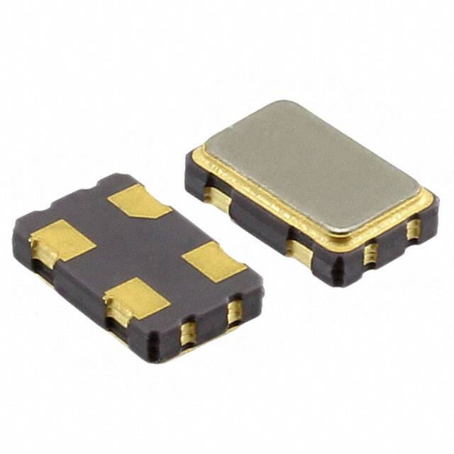

FO5HS 5mm x 3.2mm HCMOS SMD Oscillator (Former F510L, F540L, F530L, F550L) Features • • • • HCMOS Output Stabilities to ±20 PPM Temperature Ranges from -40°C to +85°C Supply Voltages: 1.8V, 2.5V, 3.3V, 5.0V 1.8V ELECTRICAL CHARACTERISTICS PARAMETERS Frequency Range (FO) Temperature Range Storage (TSTG) Supply Voltage (VDD) Input Current (IDD) 1.000 ~ 32.000MHz >32.000 ~ 70.000MHz >70.000 ~ 120.000MHz >120.000 ~ 160.000MHz Standby Current Output Symmetry (50% VDD) Rise/Fall Time (20%~80%VDD Levels) (TR/TF) 1.000 ~ 32.000MHz >32.000 ~ 120.000MHz >120.000 ~ 160.000MHz Output Voltage (VOL) (VOH) Output Load (HCMOS) Start-up Time (TS) Output Disable Time 1 Output Enable Time 1 MAX (Unless otherwise noted) 1.000 ~ 160 MHz -55°C ~ +125°C 1.8V±5% 5 mA 10 mA 15 mA 30 mA 10µA 40 % ~ 60 % 5 nS 3.5 nS 3 nS 20 % VDD 80 % VDD Min 15 pF 10 mS 300 nS 10 mS ENABLE / DISABLE FUNCTION Pin1 OPEN 1 ‘1’ Level VIH ≥ 70%VDD ‘0’ Level VIL ≤ 30%VDD Revised F: 11/12/2020 Output (pin 3) Active Active High Z Page 1 of 7 www.foxonline.com FO5HS (Former F510L, F540L, F530L, F550L) 5mm x 3.2mm HCMOS SMD Oscillator Available Options by Stability & Operating Temp for 1.8V Frequency Stability ±100PPM2 ±100PPM2 ±100PPM2 ±50PPM2 ±50PPM2 ±50PPM2 ±25PPM2 ±25PPM2 ±25PPM3 ±20PPM3 ±20PPM3 Operating Temperature (°C) -10 ~ +70 -20 ~ +70 -40 ~ +85 -10 ~ +70 -20 ~ +70 -40 ~ +85 -10 ~ +70 -20 ~ +70 -40 ~ +85 -10 ~ +70 -20 ~ +70 Frequency Range (MHz) 1.000 ~ 160.000 1.000 ~ 160.000 1.000 ~ 160.000 1.000 ~ 160.000 1.000 ~ 160.000 1.000 ~ 160.000 1.000 ~ 160.000 1.000 ~ 160.000 1.000 ~ 160.000 1.000 ~ 160.000 1.000 ~ 160.000 An internal pull-up resistor from pin 1 to pin 4 allows active output if pin 1 is left open Inclusive of 25°C tolerance, operating temperature range, input voltage change, load change, Reflow, one-year aging, shock, and vibration. 3 Inclusive of 25°C tolerance and operating temperature range. 1 2 Revised F: 11/12/2020 Page 2 of 7 www.foxonline.com FO5HS 5mm x 3.2mm HCMOS SMD Oscillator (Former F510L, F540L, F530L, F550L) 2.5V ELECTRICAL CHARACTERISTICS PARAMETERS Frequency Range (FO) Temperature Range Storage (TSTG) Supply Voltage (VDD) Input Current (IDD) 1.000 ~ 32.000MHz >32.000 ~ 50.000MHz >50.000 ~ 125.000MHz >125.000 ~ 160.000MHz Standby Current (IST) Output Symmetry (50% VDD) 1.000 ~ 50.000MHz > 50.000 ~ 160.000MHz Rise/Fall Time (10%~90%VDD Levels) (TR/TF) MAX (Unless otherwise noted) 1 ~ 160 MHz Output Voltage 10 % VDD 90 % VDD Min 15 pF 10 mS 150 nS 10 mS (VOL) (VOH) Output Load (HCMOS) Start-up Time (TS) Output Disable Time 1 Output Enable Time 1 -55°C ~ +125°C 2.5V±5% 7 mA 12 mA 26 mA 35 mA 10µA 45 % ~ 55 % 40 % ~ 60 % 5 nS ENABLE / DISABLE FUNCTION Pin1 OPEN 1 ‘1’ Level VIH ≥ 70%VDD ‘0’ Level VIL ≤ 30%VDD Output (pin 3) Active Active High Z Available Options by Stability & Operating Temp for 2.5V Frequency Stability Operating Temperature (°C) ±100PPM2 -10 ~ +70 ±100PPM2 -20 ~ +70 ±100PPM2 -40 ~ +85 ±50PPM2 -10 ~ +70 ±50PPM2 -20 ~ +70 2 ±50PPM -40 ~ +85 ±25PPM2 -10 ~ +70 ±25PPM2 -20 ~ +70 ±25PPM2 -40 ~ +85 ±20PPM3 -10 ~ +70 3 ±20PPM -20 ~ +70 Frequency Range (MHz) 1.000 ~ 160.000 1.000 ~ 160.000 1.000 ~ 160.000 1.000 ~ 160.000 1.000 ~ 160.000 1.000 ~ 160.000 1.000 ~ 160.000 1.000 ~ 160.000 1.000 ~ 160.000 1.000 ~ 160.000 1.000 ~ 160.000 An internal pull-up resistor from pin 1 to pin 4 allows active output if pin 1 is left open Inclusive of 25°C tolerance, operating temperature range, input voltage change, load change, Reflow, one-year aging, shock, and vibration. 3 Inclusive of 25°C tolerance and operating temperature range. 1 2 Revised F: 11/12/2020 Page 3 of 7 www.foxonline.com FO5HS 5mm x 3.2mm HCMOS SMD Oscillator (Former F510L, F540L, F530L, F550L) 3.3V ELECTRICAL CHARACTERISTICS PARAMETERS Frequency Range (FO) Temperature Range Storage (TSTG) Supply Voltage (VDD) Input Current (IDD) 1.000 ~ 32.000MHz >32.000 ~ 50.000MHz >50.000 ~ 67.000MHz >67.000 ~ 170.000MHz Standby Current (IST) Output Symmetry (50% VDD) 1.000 ~ 50.000MHz >50.000 ~ 170.000MHz Rise/Fall Time (10%~90%VDD Levels) (TR/TF) 1.000 ~ 80.000MHz >80.000 ~ 125.000MHz >125.000 ~ 170.000MHz Output Voltage (VOL) (VOH) Output Load (HCMOS) Start-up Time (TS) Output Disable Time 1 Output Enable Time 1 MAX (Unless otherwise noted) 1 ~ 170MHz -55°C ~ +125°C 3.3V±10% 15 mA 20 mA 25 mA 40 mA 10µA 45 % ~ 55 % 40 % ~ 60 % 6 nS 4 nS 3 nS 10 % VDD 90 % VDD Min 15 pF 10 mS 150 nS 10 mS ENABLE / DISABLE FUNCTION Pin1 OPEN 1 ‘1’ Level VIH ≥ 70%VDD ‘0’ Level VIL ≤ 30%VDD Output (pin 3) Active Active High Z Available Options by Stability & Operating Temp for 3.3V Frequency Stability Operating Temperature (°C) ±100PPM2 -10 ~ +70 2 ±100PPM -20 ~ +70 ±100PPM2 -40 ~ +85 ±50PPM2 -10 ~ +70 ±50PPM2 -20 ~ +70 ±50PPM2 -40 ~ +85 ±25PPM2 -10 ~ +70 2 ±25PPM -20 ~ +70 ±25PPM2 -40 ~ +85 ±20PPM3 -10 ~ +70 ±20PPM3 -20 ~ +70 1 2 Frequency Range (MHz) 1.000 ~ 170.000 1.000 ~ 170.000 1.000 ~ 170.000 1.000 ~ 170.000 1.000 ~ 170.000 1.000 ~ 170.000 1.000 ~ 170.000 1.000 ~ 170.000 1.000 ~ 170.000 1.000 ~ 170.000 1.000 ~ 170.000 An internal pull-up resistor from pin 1 to pin 4 allows active output if pin 1 is left open Inclusive of 25°C tolerance, operating temperature range, input voltage change, load change, Reflow, one-year aging, shock, and vibration. Revised F: 11/12/2020 Page 4 of 7 www.foxonline.com FO5HS 5mm x 3.2mm HCMOS SMD Oscillator (Former F510L, F540L, F530L, F550L) 3 Inclusive of 25°C tolerance and operating temperature range. 5.0V ELECTRICAL CHARACTERISTICS PARAMETERS Frequency Range (FO) Temperature Range Storage (TSTG) Supply Voltage (VDD) Input Current (IDD) Output Symmetry (50% VDD) Rise/Fall Time (10%~90%VDD Levels) (TR/TF) Output Voltage (VOL) (VOH) Output Load (HCMOS) Start-up Time (TS) Output Disable Time 1 Output Enable Time 1 MAX (Unless otherwise noted) 1.544 ~ 50MHz -55 ~ +125°C 5.0V ± 10% 35 mA 40% ~ 60% 10 nS 10% VDD 90% VDD Min 15 pF 10 mS 100 nS 100 nS ENABLE / DISABLE FUNCTION Pin1 OPEN 1 ‘1’ Level VIH ≥ 70%VDD ‘0’ Level VIL ≤ 30%VDD Output (pin 3) Active Active High Z Available Options by Stability & Operating Temp for 5.0V Frequency Stability Operating Temperature (°C) ±100PPM2 -10 ~ +70 ±100PPM2 -40 ~ +85 ±50PPM2 -10 ~ +70 2 ±50PPM -40 ~ +85 ±25PPM2 -10 ~ +70 ±25PPM3 -40 ~ +85 ±25PPM3 -10 ~ +70 Frequency Range (MHz) 1.544 ~ 50.000 1.544 ~ 50.000 1.544 ~ 50.000 1.544 ~ 50.000 1.544 ~ 50.000 1.544 ~ 50.000 1.544 ~ 50.000 An internal pull-up resistor from pin 1 to pin 4 allows active output if pin 1 is left open Inclusive of 25°C tolerance, operating temperature range, input voltage change, load change, Reflow, one-year aging, shock, and vibration. 3 Inclusive of 25°C tolerance and operating temperature range. 1 2 Revised F: 11/12/2020 Page 5 of 7 www.foxonline.com FO5HS 5mm x 3.2mm HCMOS SMD Oscillator (Former F510L, F540L, F530L, F550L) DIMENSIONS / MECHANICAL SPECIFICATIONS ` Note: 1, A 0.01μF capacitor should be placed between VDD (Pin 4) and GND (Pin2) to minimize power supply line noise. 2, Dimensional drawing is for reference to critical specifications defined by size measurements. Certain non-critical visual attributes, such as side castellation’s, etc. may vary. STANDARD SPECIFICATIONS PARAMETERS Maximum Soldering Temp / Time Moisture Sensitivity Level (MSL) Termination Finish Seal Method Lead (Pb) Free ROHS Compliant Revised F: 11/12/2020 MAX (Unless otherwise noted) 260°C / 10 Seconds x 2 N/A Au (0.3~1µm) over Ni (1.27~8.89µm) Seam Yes Yes Page 6 of 7 www.foxonline.com FO5HS (Former F510L, F540L, F530L, F550L) 5mm x 3.2mm HCMOS SMD Oscillator TAPE SPECIFICATIONS (mm) REEL SPECIFICATIONS (mm) A B C D E F REEL QTY G H I J K L M ø1.5 4.0 8.0 5.5 12.0 1.5 -T1 = 1,000 2.0 Ø13 Ø21 Ø62 Ø180 13.5 2.0 Available Options & Part Identification* Sample PN: FO5HSCBM25.0-T1 F O5HS Fox Model Number C B M 25.0 -T1 Voltage Stability Operating Frequency Values Added K = 1.8V±5% A = ±100 PPM Temperature (MHz) Options E = -10 to +70˚C H = 2.5V±5% B = ±50 PPM Blank = Bulk F = -20 to +70˚C C = 3.3V±10% D = ±25 PPM T1 = 1,000 pcs A = 5.0V±10% E = ±20 PPM M = -40 to +85˚C *Not all frequencies in the frequency range, or every combination of stability, temp range, and voltage available See stabilities and op temps for each VDD. Reliability Test Conditions Please contact Abracon Quality Assurance department Revised F: 11/12/2020 Page 7 of 7 www.foxonline.com

物料型号:FO5HS
器件简介:这是一个5mm x 3.2mm的HCMOS表面贴装振荡器,具有多种供电电压选项,包括1.8V、2.5V、3.3V和5.0V。
引脚分配: - Pin 1: 使能/禁用功能 - Pin 2: 地(GND) - Pin 3: 输出 - Pin 4: 供电(VDD)
参数特性: - 频率范围:1.000MHz至160MHz(1.8V和2.5V)或1.544MHz至170MHz(3.3V)或1.544MHz至50MHz(5.0V) - 温度范围:-40°C至+85°C - 供电电压:1.8V±5%,2.5V±5%,3.3V±10%,5.0V±10% - 输入电流:根据频率和供电电压不同,范围从5mA至40mA - 启动时间:10ms - 输出禁用时间:100ns至300ns - 输出使能时间:10ms
功能详解: - HCMOS输出 - 稳定性:±20PPM至±100PPM - 使能/禁用功能:当Pin 1为高电平时,输出激活;为低电平时,输出高阻态。
应用信息:文档中未明确提供应用信息,但通常此类振荡器用于需要精确时钟信号的电子设备中。
封装信息: - 尺寸:5mm x 3.2mm - 引脚连接:1-E/D, 2-GND, 3-Output, 4-VDD - 标准规格包括最大焊接温度/时间、湿度敏感度等级、镀金层、密封方法等。
