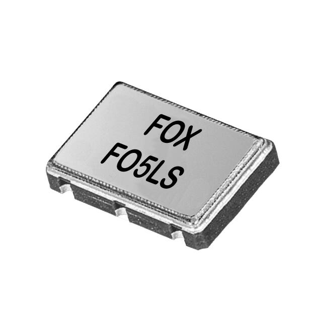

FO5LS 5.0mm x 3.2mm SMD LVDS Oscillator (Former F530D/F540D families) Features • • • • LVDS Output Stabilities to ±20 PPM Operating Temperature Ranges to -40°C to +85°C Supply Voltages: 1.8V, 2.5V, 3.3V 2.5/3.3V SPECIFICATIONS PARAMETERS Frequency Range Temperature Range Storage (TSTG) Supply Voltage (VDD) Input Current (IDD) Standby Current Output Symmetry (50% VP-P) Rise Time (20%~80% VP-P) Fall Time (80%~20% VP-P) Differential Output Voltage (VOD) Differential Offset Voltage (VOS) Differential Output Voltage Swing (Vopp) Output Load (HCMOS) Start-up Time (TS) Output Disable Time 1 Output Enable Time 1 Aging (per year @ 25C) Phase Jitter (12kHz~20MHz) MAX (Unless otherwise noted) 13.5 ~ 250MHz -55°C ~ +125°C 2.5V±10% 50 mA 15 µA 45 % ~ 55 % 0.5 nS 0.5 nS 0.247V ~ 0.454V 1.125V ~ 1.375V 0.25Vpp min 100 Ohms Typical 10 mS 200 µS 10 mS ±3 PPM 1 pS 3.3V±10% 0.35Vpp min ENABLE / DISABLE FUNCTION Pin1 OPEN 1 ‘1’ Level VIH ≥ 70%VDD ‘0’ Level VIL ≤ 30%VDD Out 1 (pin 4), Out 2 (pin 5) Active Active High Z Available Options by Stability & Operating Temp Frequency Stability2 ±100PPM ±100PPM ±100PPM ±50PPM ±50PPM ±50PPM ±25PPM ±25PPM ±25PPM3 ±20PPM3 Revised A: 05/06/2020 Operating Temperature (°C) -10 ~ +70 -20 ~ +70 -40 ~ +85 -10 ~ +70 -20 ~ +70 -40 ~ +70 -10 ~ +85 -20 ~ +70 -40 ~ +85 -20 ~ +70 Frequency Range (MHz) 13.500 ~ 250.000 13.500 ~ 250.000 13.500 ~ 250.000 13.500 ~ 250.000 13.500 ~ 250.000 13.500 ~ 250.000 13.500 ~ 250.000 13.500 ~ 250.000 13.500 ~ 250.000 13.500 ~ 250.000 Page 1 of 4 www.foxonline.com FO5LS 5.0mm x 3.2mm SMD LVDS Oscillator (Former F530D/F540D families) 1.8V SPECIFICATIONS PARAMETERS Frequency Range Temperature Range Storage (TSTG) Supply Voltage (VDD) Input Current (IDD) Standby Current Output Symmetry (50% Vp-p) Rise Time (20%~80% VP-P) Fall Time (80%~20% VP-P) Differential Output Voltage (VOD) Differential Offset Voltage (VOS) Differential Output Voltage Swing (Vopp) Output Load (HCMOS) Start-up Time (TS) Output Disable Time 1 Output Enable Time 1 Aging (per year @ 25C) Phase Jitter (12kHz~20MHz) MAX (Unless otherwise noted) 100 ~ 170MHz -55°C ~ +125°C 1.8V±10% 66 mA 30 µA 45% ~ 55% 0.7 nS 0.7 nS 0.33V typ 1.125V ~ 1.375V (1.25V typ) 0.25Vp-p min 100 Ohms Typical 10 mS 200 nS 10 mS ±3 PPM 1 pS (0.5pS typ) ENABLE / DISABLE FUNCTION Pin1 OPEN 1 ‘1’ Level VIH ≥ 70%VDD ‘0’ Level VIL ≤ 30%VDD Out 1 (pin 4), Out 2 (pin 5) Active Active High Z Available Options by Stability & Operating Temp Frequency Stability2 ±100PPM ±100PPM ±50PPM ±50PPM ±25PPM ±25PPM3 Operating Temperature (°C) -20 ~ +70 -40 ~ +85 -20 ~ +70 -40 ~ +85 -20 ~ +70 -40 ~ +85 Frequency Range (MHz) 100.0 ~ 170.0 100.0 ~ 170.0 100.0 ~ 170.0 100.0 ~ 170.0 100.0 ~ 170.0 100.0 ~ 170.0 An internal pull-up resistor from pin 1 to pin 6 allows active output if pin 1 is left open Inclusive of 25°C tolerance, operating temperature range, input voltage change, load change, Reflow, one-year aging, shock, and vibration. 3 Inclusive of 25°C tolerance and operating temperature range. 1 2 Revised A: 05/06/2020 Page 2 of 4 www.foxonline.com FO5LS 5.0mm x 3.2mm SMD LVDS Oscillator (Former F530D/F540D families) DIMENSIONS / MECHANICAL SPECIFICATIONS ` Note: 1. A 0.01μF capacitor should be placed between VDD (Pin 6) and GND (Pin3) to minimize power supply line noise. 2. Dimensional drawing is for reference to critical specifications defined by size measurements. Certain non-critical visual attributes, such as side castellation’s, pin shape etc. may vary. STANDARD SPECIFICATIONS PARAMETERS Maximum Soldering Temp / Time Moisture Sensitivity Level (MSL) Termination Finish Seal Method Lead (Pb) Free REACH/REACH Compliant Revised A: 05/06/2020 MAX (Unless otherwise noted) 260°C / 10 Seconds x 2 1 Au over Ni Seam Yes Yes Page 3 of 4 www.foxonline.com FO5LS 5.0mm x 3.2mm SMD LVDS Oscillator (Former F530D/F540D families) TAPE SPECIFICATIONS (mm) REEL SPECIFICATIONS (mm) A B C D E F REEL QTY G H I J K L M ø1.5 4.0 480 3.5 16.0 1.4 -T1 = 1,000 2.0 Ø13 Ø21 Ø60 Ø180 13.0 2.0 Available Options & Part Identification for SMD LVDS Oscillator O5LS* Sample PN: FO5LSCDM125.0 -T1 F O5LS C D M 125.0 -T1 Fox Model Number Voltage K = 1.8V±5% J = 2.5V±10% C = 3.3V±10% Stability A = ±100 PPM B = ±50 PPM D = ±25 PPM E = ±20 PPM Operating Temperature E = -10 to +70°C F = -20 to +70°C M = -40 to +85°C Frequency (MHz) Reel Quantity Blank = Bulk T1 = 1,000 pcs * Not all frequencies in the frequency range, or every combination of stability, temp range, and voltage available. See stabilities and op temps for each VDD. Reliability Test Conditions Please contact Abracon Quality Assurance department Revised A: 05/06/2020 Page 4 of 4 www.foxonline.com

1. 物料型号:SMD LVDS Oscillator FO5LS,曾用型号F530D/F540D。 2. 器件简介:文档描述了一种小型尺寸的表面贴装LVDS振荡器,具有多种特性和参数。 3. 引脚分配:文档中提到了引脚1用于使能/禁用功能,引脚4和5为输出,引脚6为供电电压,引脚3为地。 4. 参数特性: - 频率范围:13.5 ~ 250MHz(2.5/3.3V)和100 ~ 170MHz(1.8V)。 - 工作温度范围:-40°C 至 +85°C。 - 供电电压:1.8V, 2.5V, 3.3V。 - 输入电流:50 mA(2.5/3.3V)和66 mA(1.8V)。 - 输出电压摆幅、上升时间、下降时间等详细参数。 5. 功能详解:包括使能/禁用功能,通过引脚1控制,以及内部上拉电阻的说明。 6. 应用信息:文档提供了不同稳定性和工作温度下的频率范围选项。 7. 封装信息:5.0mm x 3.2mm的封装尺寸,包括机械规格和标准规格,如最大焊接温度、湿度敏感等级、端接镀层、密封方法等。
