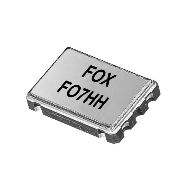

FO7HH 7mm x 5mm HCMOS SMD Oscillator (Former F3345 Series) Features • • • • HCMOS Output Stabilities to ±20 PPM Temperature Ranges to -40°C to +85°C Supply Voltage: 5.0V ELECTRICAL CHARACTERISTICS PARAMETERS Frequency Range (FO) Temperature Range Storage (TSTG) Supply Voltage (VDD) Input Current (IDD) 1.000 ~ 25.000MHz 25.000+ ~ 50.000MHz 50.000+ ~ 67.000MHz 67.000+ ~ 80.000MHz 80.000+ ~ 125.000MHz Output Symmetry (50% VDD) 1 ~ 80MHz 80+ ~ 125MHz Rise/Fall Time (10%/90% VDD Levels) (TR/TF) 1 ~ 80.000MHz 80+ ~ 100MHz 100+ ~ 125MHz Output Voltage (VOL) (VOH) Output Load (HCMOS) Start-up Time (TS) Output Disable Time 1 Output Enable Time 1 MAX (Unless otherwise noted) 1 ~ 125MHz -55°C ~ +125°C 5.0V ±10% 25 mA 40 mA 60 mA 73 mA 90 mA 45/55% 40/60% 7nS 5nS 4nS 10 % VDD 90 % VDD Min 50 pF 10 mS 100 nS 100 nS ENABLE / DISABLE FUNCTION Pin1 OPEN 1 ‘1’ Level VIH ≥ 70%VDD ‘0’ Level VIL ≤ 30%VDD Output (pin 3) Active Active High Z Available Options by Stability & Operating Temp Frequency Stability ±100PPM2 ±100PPM2 ±50PPM2 ±50PPM2 ±25PPM2 ±25PPM3 ±20PPM3 Operating Temperature (°C) -10 ~ +70 -40 ~ +85 -10 ~ +70 -40 ~ +85 -10 ~ +70 -40 ~ +85 -10 ~ +70 Frequency Range (MHz) 1.000 ~ 125.000 1.000 ~ 125.000 1.000 ~ 125.000 1.000 ~ 125.000 1.000 ~ 125.000 1.000 ~ 80.000 1.000 ~ 80.000 An internal pull-up resistor from pin 1 to pin 4 allows active output if pin 1 is left open Inclusive of 25°C tolerance, operating temperature range, input voltage change, load change, Reflow, one year aging, shock, and vibration. 3 Inclusive of 25°C tolerance and operating temperature range. 1 2 Revised A: 10/03/2019 Page 1 of 3 www.foxonline.com FO7HH 7mm x 5mm HCMOS SMD Oscillator (Former F3345 Series) DIMENSIONS / MECHANICAL SPECIFICATIONS ` Note: 1, A 0.01μF capacitor should be placed between VDD (Pin 4) and GND (Pin2) to minimize power supply line noise. 2, Dimensional drawing is for reference to critical specifications defined by size measurements. Certain non-critical visual attributes, such as side castellation’s, etc. may vary. STANDARD SPECIFICATIONS PARAMETERS Maximum Soldering Temp / Time Moisture Sensitivity Level (MSL) Termination Finish Seal Method Lead (Pb) Free RoHS Compliant REACH Compliant (latest version) Revised A: 10/03/2019 MAX (Unless otherwise noted) 260°C / 10 Seconds x 2 N/A Au (0.3~1µm) over Ni (1.27~8.89µm) Seam Yes Yes, no exemptions Yes Page 2 of 3 www.foxonline.com FO7HH 7mm x 5mm HCMOS SMD Oscillator (Former F3345 Series) TAPE SPECIFICATIONS (mm) A B ø1.5 4.0 C D 8.0 7.5 E 16.0 REEL SPECIFICATIONS (mm) F REEL QTY G H I J K L M 2.15 -T1 = 1,000 -T2 = 2,000 2.0 Ø13 Ø21 Ø80 Ø255 17.5 2.0 Available Options & Part Identification* Sample PN: FO7HHABM25.0-T2 F O7HH A B M 25.0 -T2 Fox Model Number Voltage Stability A = ±100 PPM B = ±50 PPM D = ±25 PPM E = ±20 PPM Operating Temperature E = -10 to +70°C M = -40 to +85°C Frequency (MHz) Values Added Options Blank = Bulk T1 = 1,000 pcs T2 = 2,000 pcs A = 5V±10% * Not all frequencies in the frequency range, or every combination of stability, temp range, and voltage available. See stabilities and op temps for each VDD. Reliability Test Conditions Please contact Abracon Quality Assurance department Revised A: 10/03/2019 Page 3 of 3 www.foxonline.com
FO7HHAAE20.0-T1
物料型号:FO7HH 封装尺寸:7mm x 5mm 器件简介:HCMOS SMD Oscillator,具有HCMOS输出,稳定性达到±20 PPM,温度范围从-40°C到+85°C,供电电压为5.0V。
引脚分配: - Pin1:使能/禁用功能 - Pin2:地 - Pin3:输出 - Pin4:供电
参数特性: - 频率范围:125MHz - 存储温度范围:-55°C~+125°C - 供电电压:5.0V±10% - 输入电流:根据频率不同,范围从25 mA到90 mA - 输出对称性:1~80MHz为45/55%,80+~125MHz为40/60% - 上升/下降时间:1~80MHz为7nS,80+~100MHz为5nS,100+~125MHz为4nS - 输出电压:低电平(VoL)为10%VDD,高电平(VOH)为90%VDD最小值 - 输出负载:HCMOS为50pF - 启动时间:10ms - 输出禁用时间:100nS - 输出使能时间:100nS
功能详解: - 使能/禁用功能:当Pin1为'1'时,输出为活跃状态;为'0'时,输出为高阻态。
应用信息: - 内部上拉电阻从Pin1到Pin4允许如果Pin1未连接时输出为活跃状态。
封装信息: - 尺寸和机械规格:提供了详细的尺寸图和引脚连接信息。 - 标准规格:包括最大焊接温度/时间、湿度敏感等级、端接完成、密封方法、无铅、RoHS合规和REACH合规。
