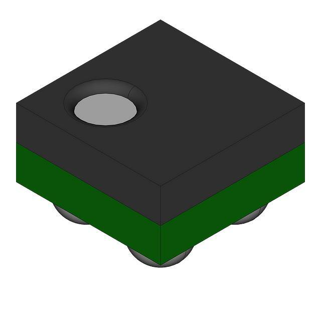

Freescale Semiconductor Technical Data MPXC2011DT1 Rev 5, 10/2006 High Volume Sensor for Low Pressure Applications Freescale Semiconductor has developed a low cost, high volume, miniature pressure sensor package which is ideal as a sub-module component or a disposable unit. The unique concept of the Chip Pak allows great flexibility in system design while allowing an economic solution for the designer. This new chip carrier package uses Freescale Semiconductor's unique sensor die with its piezoresistive technology, along with the added feature of on-chip, thin-film temperature compensation and calibration. NOTE: Freescale Semiconductor is also offering the Chip Pak package in application-specific configurations, which will have an “SPX” prefix, followed by a four-digit number, unique to the specific customer Features • • • • • • • • • Low Cost Integrated Temperature Compensation and Calibration Ratiometric to Supply Voltage Polysulfone Case Material (Medical, Class V Approved) Provided in Easy-to-Use Tape and Reel Respiratory Diagnostics Air Movement Control Controllers Pressure Switching MPXC2011DT1 MPXC2012DT1 PRESSURE SENSORS 0 to 75 mm HG (0 TO 10 kPA CHIP PAK PACKAGE MPXC2011DT1/MPXC2012DT1 CASE 423A-03 Typical Applications PIN NUMBER 1 2 GND S+ 3 4 VS S- NOTE: The die and wire bonds are exposed on the front side of the Chip Pak (pressure is applied to the backside of the device). Front side die and wire protection must be provided in the customer's housing. Use caution when handling the devices during all processes. Freescale Semiconductor's MPXC2011DT1/ MPXC2012DT1 Pressure Sensor has been designed for medical usage by combining the performance of Freescale Semiconductor's shear stress pressure sensor design and the use of biomedically approved materials. Materials with a proven history in medical situations have been chosen to provide a sensor that can be used with confidence in applications, such as invasive blood pressure monitoring. It can be sterilized using ethylene oxide. The portions of the pressure sensor that are required to be biomedically approved are the rigid housing and the gel coating. The rigid housing is molded from a white, medical grade polysulfone that has passed extensive biological testing including: tissue culture test, rabbit implant, hemolysis, intracutaneous test in rabbits, and system toxicity, USP. The MPXC2011DT1 contains a silicone dielectric gel which covers the silicon piezoresistive sensing element. The gel is a nontoxic, nonallergenic elastomer system which meets all USP XX Biological Testing Class V requirements. The properties of the gel allow it to transmit pressure uniformly to the diaphragm surface, while isolating the internal electrical connections from the corrosive effects of fluids, such as saline solution. The gel provides electrical isolation sufficient to withstand defibrillation testing, as specified in the proposed Association for the Advancement of Medical Instrumentation (AAMI) Standard for blood pressure transducers. A biomedically approved opaque filler in the gel prevents bright operating room lights from affecting the performance of the sensor. The MPXC2012DT1 is a no-gel option. ORDERING INFORMATION Device Order No. MPXC2011DT1 MPXC2012DT1 Case No. 423A 423A Device Description Chip Pak, 1/3 Gel Chip Pak, No Gel Device Marking Date Code, Lot ID Date Code, Lot ID Packaging Information Tape and Reel Reel Size 330 mm Tape Width 24 mm Quantity 1000 pc/reel © Freescale Semiconductor, Inc., 2006. All rights reserved. Table 1. Maximum Ratings(1) Rating Maximum Pressure (Backside) Storage Temperature Operating Temperature Symbol Pmax Tstg TA Value 75 -25 to +85 +15 to +40 Unit kPa °C °C 1. Exposure beyond the specified limits may cause permanent damage or degradation to the device. Table 2. Operating Characteristics (VS = 10 Vdc, TA = 25°C unless otherwise noted, P1 > P2) Characteristic Pressure Range(1) Supply Voltage(2) Supply Current Full Scale Span(3) Offset(4) Sensitivity Linearity(5) Pressure Hysteresis(5) (0 to 10 kPa) Temperature Hysteresis(5) (+15°C to +40°C) Temperature Effect on Full Scale Span(5) Temperature Effect on Offset(5) Input Impedance Output Impedance Response Time(6) (10% to 90%) Warm-Up Offset Stability(7) 1. 1.0 kPa (kiloPascal) equals 0.145 psi. 2. Device is ratiometric within this specified excitation range. Operating the device above the specified excitation range may induce additional error due to device self-heating. 3. Full Scale Span (VFSS) is defined as the algebraic difference between the output voltage at full rated pressure and the output voltage at the minimum rated pressure. 4. Offset (Voff) is defined as the output voltage at the minimum rated pressure. 5. Accuracy (error budget) consists of the following: • Linearity: • • • • Output deviation from a straight line relationship with pressure, using end point method, over the specified pressure range. Temperature Hysteresis: Output deviation at any temperature within the operating temperature range, after the temperature is cycled to and from the minimum or maximum operating temperature points, with zero differential pressure applied. Pressure Hysteresis: Output deviation at any pressure within the specified range, when this pressure is cycled to and from the minimum or maximum rated pressure, at 25°C. TcSpan: Output deviation at full rated pressure over the temperature range of 0 to 85°C, relative to 25°C. TcOffset: Output deviation with minimum rated pressure applied, over the temperature range of 0 to 85°C, relative to 25°C. Symbol POP VS Io VFSS Voff ∆V/∆P — — — TCVFSS TCVoff Zin Zout tR — — Min 0 — — 24 -1.0 — -1.0 — — -1.0 -1.0 1300 1400 — — — Typ — 3 6.0 25 — 2.5 — ± 0.1 ± 0.1 — — — — 1.0 20 ± 0.5 Max 10 10 — 26 1.0 — 1.0 — — 1.0 1.0 2550 3000 — v — Unit kPa Vdc mAdc mV mV mV/kPa %VFSS %VFSS %VFSS %VFSS mV W W ms ms %VFSS 6. Response Time is defined as the time for the incremental change in the output to go from 10% to 90% of its final value when subjected to a specified step change in pressure. 7. Offset stability is the product's output deviation when subjected to 1000 hours of Pulsed Pressure, Temperature Cycling with Bias Test. MPXC2011DT1 2 Sensors Freescale Semiconductor PACKAGE DIMENSIONS A M C L N F B 123 4 V K DETAIL A D1 G H FRONT VIEW E -TJ END VIEW AC F AA AB NOTES: 1. DIMENSIONING AND TOLERANCING PER ANSI Y14.5M, 1982. 2. CONTROLLING DIMENSION: INCH. DIM A B C D1 D2 E F G H J K L M N V AA AB AC AD INCHES MILLIMETERS MIN MAX MIN MAX 0.240 0.260 6.10 6.60 0.350 0.370 8.89 9.40 0.140 0.150 3.56 3.81 0.012 0.020 0.30 0.51 0.014 0.022 0.36 0.56 0.088 0.102 2.24 2.59 0.123 0.128 3.12 3.25 0.045 0.055 1.14 1.40 0.037 0.047 0.94 1.19 0.007 0.011 0.18 0.28 0.120 0.140 3.05 3.56 0.095 0.105 2.41 2.67 0.165 0.175 4.19 4.45 0.223 0.239 5.66 6.07 0.105 0.115 2.67 2.92 0.095 0.107 2.41 2.72 0.015 0.035 0.38 0.89 0.120 0.175 3.05 4.45 0.100 0.115 2.54 2.92 AD D2 DETAIL A BACK VIEW CASE 423A-03 ISSUE C CHIP PAK PACKAGE MPXC2011DT1 Sensors Freescale Semiconductor 3 How to Reach Us: Home Page: www.freescale.com Web Support: http://www.freescale.com/support USA/Europe or Locations Not Listed: Freescale Semiconductor, Inc. Technical Information Center, EL516 2100 East Elliot Road Tempe, Arizona 85284 +1-800-521-6274 or +1-480-768-2130 www.freescale.com/support Europe, Middle East, and Africa: Freescale Halbleiter Deutschland GmbH Technical Information Center Schatzbogen 7 81829 Muenchen, Germany +44 1296 380 456 (English) +46 8 52200080 (English) +49 89 92103 559 (German) +33 1 69 35 48 48 (French) www.freescale.com/support Japan: Freescale Semiconductor Japan Ltd. Headquarters ARCO Tower 15F 1-8-1, Shimo-Meguro, Meguro-ku, Tokyo 153-0064 Japan 0120 191014 or +81 3 5437 9125 support.japan@freescale.com Asia/Pacific: Freescale Semiconductor Hong Kong Ltd. Technical Information Center 2 Dai King Street Tai Po Industrial Estate Tai Po, N.T., Hong Kong +800 2666 8080 support.asia@freescale.com For Literature Requests Only: Freescale Semiconductor Literature Distribution Center P.O. Box 5405 Denver, Colorado 80217 1-800-441-2447 or 303-675-2140 Fax: 303-675-2150 LDCForFreescaleSemiconductor@hibbertgroup.com Information in this document is provided solely to enable system and software implementers to use Freescale Semiconductor products. There are no express or implied copyright licenses granted hereunder to design or fabricate any integrated circuits or integrated circuits based on the information in this document. Freescale Semiconductor reserves the right to make changes without further notice to any products herein. Freescale Semiconductor makes no warranty, representation or guarantee regarding the suitability of its products for any particular purpose, nor does Freescale Semiconductor assume any liability arising out of the application or use of any product or circuit, and specifically disclaims any and all liability, including without limitation consequential or incidental damages. “Typical” parameters that may be provided in Freescale Semiconductor data sheets and/or specifications can and do vary in different applications and actual performance may vary over time. All operating parameters, including “Typicals”, must be validated for each customer application by customer’s technical experts. Freescale Semiconductor does not convey any license under its patent rights nor the rights of others. Freescale Semiconductor products are not designed, intended, or authorized for use as components in systems intended for surgical implant into the body, or other applications intended to support or sustain life, or for any other application in which the failure of the Freescale Semiconductor product could create a situation where personal injury or death may occur. Should Buyer purchase or use Freescale Semiconductor products for any such unintended or unauthorized application, Buyer shall indemnify and hold Freescale Semiconductor and its officers, employees, subsidiaries, affiliates, and distributors harmless against all claims, costs, damages, and expenses, and reasonable attorney fees arising out of, directly or indirectly, any claim of personal injury or death associated with such unintended or unauthorized use, even if such claim alleges that Freescale Semiconductor was negligent regarding the design or manufacture of the part. Freescale™ and the Freescale logo are trademarks of Freescale Semiconductor, Inc. All other product or service names are the property of their respective owners. © Freescale Semiconductor, Inc. 2007. All rights reserved. MPXC2011DT1 Rev. 5 10/2006
MPXC2012DT1
1. 物料型号: - MPXC2011DT1 - MPXC2012DT1
2. 器件简介: - 该传感器由Freescale Semiconductor开发,是一种低成本、高容量、微型压力传感器,适合作为子模块组件或一次性单元。它采用独特的Chip Pak封装,允许在系统设计中具有很大的灵活性,同时为设计者提供经济的解决方案。这种新芯片载体封装使用了Freescale Semiconductor的压阻技术传感器芯片,并增加了片上薄膜温度补偿和校准功能。
3. 引脚分配: - PIN 1: GND(地) - PIN 2: S+(信号正) - PIN 3: Vs(供电电压) - PIN 4: S-(信号负)
4. 参数特性: - 最大压力(背面):75 kPa - 存储温度:-25°C至+85°C - 工作温度:+15°C至+40°C - 供电电压:3Vdc至10Vdc - 供电电流:6.0 μA - 全量程跨度:24 mV至26 mV - 偏移量:-1.0 mV至1.0 mV - 灵敏度:2.5 mV/kPa - 线性度:-1.0%至1.0% VFss - 压力滞后:±0.1% VFss - 温度对全量程跨度的影响:-1.0%至1.0% VFss - 温度对偏移量的影响:-1.0 mV至1.0 mV - 输入阻抗:1300 Ω至2550 Ω - 输出阻抗:1400 Ω至3000 Ω - 响应时间(10%至90%):1.0 ms - 预热时间:20 ms - 偏移稳定性:±0.5% VFss
5. 功能详解: - 该传感器设计用于医疗用途,结合了Freescale Semiconductor的剪切应力压力传感器设计和生物医学批准材料的使用。它可以选择使用胶体或无胶体版本(MPXC2011DT1和MPXC2012DT1),胶体版本覆盖了硅压阻传感元件的硅胶介质凝胶,提供电气隔离并保护内部电气连接免受腐蚀性液体的影响。
6. 应用信息: - 典型应用包括呼吸诊断、空气流动控制和压力开关。
7. 封装信息: - 封装类型为Chip Pak,具体尺寸和公差按照ANSI Y14.5M, 1982标准。控制尺寸单位为英寸。
