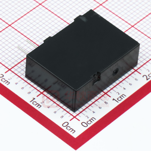

FTR-K1 SERIES POWER RELAY 1 POLE - 6A Slim Type (Medium Load Control) FTR-LY Series n FEATURES Slim 15.0mm (h) x 5.0 mm (w) x 28.0mm (l) 1 form C and right angle type available 2 l Mounting space: 140mm , weight: 5.0g l High insulation in small package Insulation distance (between coil and contacts): 8mm (creepage/clearance) Dielectric strength: 4,000 VAC Surge strength: 6,000V l Plastic sealed type RTIII l UL, CSA, VDE, SEMKO, FIMKO, DEMKO, NEMKO compliance l Socket type available l RoHS compliant Please see page 7 for more information l l n PARTNUMBER INFORMATION FTR-LY (a) A (b) A (c) [Example] 005 Y - SK (d) (e) (f ) (a) (b) Relay type Contact configuration FTR-LY : FTR-LY-Series A C P R A 005 E Y V Nil SK : 1 form A : 1 form C : 1 form A (right angle type) : 1 form C (right angle type) : Standard type (170mW) : 5.....60 VDC Coil rating table at page 3 : AgNi : AgSnO2 : AgSnO2 + Au (0.3µm) : PCB mounting type : Socket mounting type (only contact configuration A and C (c) (d) (e) Coil type Coil rated voltage Contact material (f) Special type Actual marking does not carry the type name : "FTR" and "SK" E.g.: Ordering code: FTR-LYAA005Y-SK Actual marking: LYAA005Y 1 FTR-K1 SERIES FTR-LY SERIES n SPECIFICATION Item Contact Data Configuration Construction Material Resistance (initial) Contact rating Max. carrying current Max. switching voltage Max. switching power Min. switching load * Life Mechanical Electrical Coil Data Rated power Operate power Operating temperature range Timing Data Insulation Operate (at nominal voltage) Release (at nominal voltage) Resistance (initial) Dielectric strength Surge strength Clearance Creepage EN61810-1, VDE0435 Voltage Pollution degree Material group Category Other Vibration resistance Shock Weight Sealing Misoperation Endurance Misoperation Endurance Open contacts Contacts to coil Coil to contacts LY (C,R) A ( ) (Y,E,V) 1 form C (SPDT) Single Y: AgSnO2 / E: AgNi / V: AgSnO2 + Au 0.3µm Y, E: Max. 100 mΩ at 6 VDC, 1 A V: Max. 30 mΩ at 6 VDC, 1A 6A, 250VAC / 24VDC 6A 250VAC 1,500VA / 144W Y, E: 100 mA 5 VDC V: 10mA 5 VDC Min. 10 x 106 operations Min. 50 x 103 operations (N.O.) Min. 30 x 103 operations (N.C.) at 6A, 250VAC / 30VDC resistive 170 to 217 mW 74 to 76 mW -40 °C to +85 °C (no frost) Max. 8ms (no diode, without bounce) Max. 4ms (no diode, without bounce) Min. 1,000MΩ at 500VDC 1,000VAC (50/60Hz) 1min.,10mA detection current 4,000VAC (50/60Hz) 1min.,10mA detection current 6,000V / 1.2 x 50µs standard wave 8 mm 8 mm 250V 3 III a C / 250V 10 to 55Hz double amplitude 1.0mm 10 to 55Hz double amplitude 1.5mm Min. 50m/s² (11 ± 1ms) Min. 1,000m/s² (6 ± 1ms) Approximately 5 g Plastic sealed RTIII Min. 100m/s² (11 ± 1ms) LY (A,P) A ( ) (Y,E,V) 1 form A (SPST-NO) * Minimum switching loads mentioned above are reference values. Please perform the confirmation test with actual load before production since reference values may vary according to switching frequencies, environmental conditions and expected reliability levels. 2 FTR-K1 SERIES FTR-LY SERIES n COIL RATING Coil Code 005 006 009 012 018 024 048 060 Rated Coil Voltage (VDC) 5 6 9 12 18 24 48 60 Coil Resistance +/- 10% (Ohm) 147 211 476 847 1,910 3,390 10,600 20,570 Must Operate Voltage (VDC) * 3.3 4 5.9 7.9 11.9 15.9 31.7 39.6 Must ReleaseVoltage (VDC) * 0.25 0.3 0.45 0.6 0.9 1.2 2.4 3 Max. Coil Voltage (VDC) 11.5 13.8 20.7 27.6 41.4 55.2 110.4 138 217 175 170 Rated Power (mW) Note: All values in the table are valid for 20°C and zero contact current. * Specified operate values are valid for pulse wave voltage. n UL SAFETY STANDARDS Compliance UL 508 E63614 Contact rating Flammability: UL 94-V0 (plastics) 5A, 277 VAC (resistive) 5A, 30 VDC (resistive) 1/10 HP, 277VAC /125VAC Pilot duty: D300, C300, R300, B300 250VAC; 6A / 30VDC; 6A : - 10K ops. FTR-LY(A;P)A...(E;Y;V) -40 °C to +85 °C - 5K ops. FTR-LY(C;R)A...(E;Y;V) -40 °C to +85 °C 250VAC; 6(1,5)A, 30K ops. : FTR-LY(A;P)A...(Y;V) +85 °C 250VAC; 3(1,5)A, 100K ops. : FTR-LY(A;P)A...(Y;V) +85 °C Type CSA VDE 40006591 C22.2 No. 14 LR 40304 EN 61810-1 (VDE 0435-Part 201) 2004-07 EN 60730-1 (VDE 0631-Part 1) EN 61984 (VDE 0627) EN 60335-1 (VDE 0700-Part 1) - 3 FTR-K1 SERIES FTR-LY SERIES n CHARACTERISTIC DATA 4 FTR-K1 SERIES FTR-LY SERIES n DIMENSIONS Straight terminal type l Dimensions l Schematics l PC board mounting hole layout (BOTTOM VIEW) Right angle type l Dimensions l Schematics l PC board mounting hole layout (BOTTOM VIEW) Unit: mm * This terminal is not applicable for 1 form A type. 5 FTR-K1 SERIES FTR-LY SERIES Socket type l Dimensions l Schematics l PC board mounting hole layout (BOTTOM VIEW) JM-6N l Dimensions l Schematics 6 FTR-K1 SERIES FTR-LY SERIES RoHS Compliance and Lead Free Information 1. General Information l l l l All signal and power relays produced by Fujitsu Components are compliant with RoHS directive 2002/95EC including amendments. Cadmium as used in electrical contacts is exempted from the RoHS directives on October 21st, 2005. (Amendment to Directive 2002/95/EC) All of our signal and power relays are lead-free. Please refer to Lead-Free Status Info for older date codes at: http://www.fujitsu.com/us/downloads/MICRO/fcai/relays/lead-free-letter.pdf Lead free solder plating on relay terminals is Sn-3.0Ag-0.5Cu, unless otherwise specified. This material has been verified to be compatible with PbSn assembly process. 2. Recommended Lead Free Solder Profile l Recommended solder Sn-3.0Ag-0.5Cu. Flow Solder condition: Pre-heating: Soldering: maximum 120˚C dip within 5 sec. at 260˚C solder bath Solder by Soldering Iron: Soldering Iron Temperature: Duration: maximum 360˚C maximum 3 sec. We highly recommend that you confirm your actual solder conditions 3. Moisture Sensitivity l Moisture Sensitivity Level standard is not applicable to electromechanical relays, unless otherwise indicated. 4. Tin Whiskers l Dipped SnAgCu solder is known as presenting a low risk to tin whisker development. No considerable length whisker was found by our in house test. 7 FTR-K1 SERIES FTR-LY SERIES Fujitsu Components International Headquarter Offices Japan Fujitsu Component Limited Gotanda-Chuo Building 3-5, Higashigotanda 2-chome, Shinagawa-ku Tokyo 141, Japan Tel: (81-3) 5449-7010 Fax: (81-3) 5449-2626 Email: promothq@ft.ed.fujitsu.com Web: www.fcl.fujitsu.com North and South America Fujitsu Components America, Inc. 250 E. Caribbean Drive Sunnyvale, CA 94089 U.S.A. Tel: (1-408) 745-4900 Fax: (1-408) 745-4970 Email: components@us.fujitsu.com Web: http://us.fujitsu.com/components Europe Fujitsu Components Europe B.V. Diamantlaan 25 2132 WV Hoofddorp Netherlands Tel: (31-23) 5560910 Fax: (31-23) 5560950 Email: info@fceu.fujitsu.com Web: emea.fujitsu.com/components/ Asia Pacific Fujitsu Components Asia Ltd. 102E Pasir Panjang Road #01-01 Citilink Warehouse Complex Singapore 118529 Tel: (65) 6375-8560 Fax: (65) 6273-3021 Email: fcal@fcal.fujitsu.com Web: http://www.fujitsu.com/sg/services/micro/components/ ©2011 Fujitsu Components Europe B.V. All rights reserved. All trademarks or registered trademarks are the property of their respective owners. The contents, data and information in this datasheet are provided by Fujitsu Component Ltd. as a service only to its user and only for general information purposes. The use of the contents, data and information provided in this datasheet is at the users’ own risk. Fujitsu has assembled this datasheet with care and will endeavor to keep the contents, data and information correct, accurate, comprehensive, complete and up to date. Fujitsu Components Europe B.V. and affiliated companies do however not accept any responsibility or liability on their behalf, nor on behalf of its employees, for any loss or damage, direct, indirect or consequential, with respect to this datasheet, its contents, data, and information and related graphics and the correctness, reliability, accuracy, comprehensiveness, usefulness, availability and completeness thereof. Nor do Fujitsu Components Europe B.V. and affiliated companies accept on their behalf, nor on behalf of its employees, any responsibility or liability for any representation or warrant of any kind, express or implied, including warranties of any kind for merchantability or fitness for particular use, with respect to these datasheets, its contents, data, information and related graphics and the correctness, reliability, accuracy, comprehensiveness, usefulness, availability and completeness thereof. Rev. June 08, 2011 8
